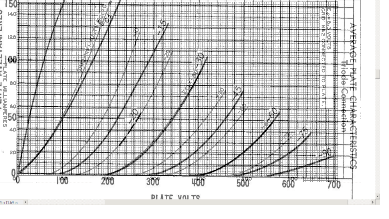

Here is the triode-connected curve sheet for the 5881. Unfortunately, no such curves seem available for either the 6973, nor its supposed equivalent the 6CZ5.

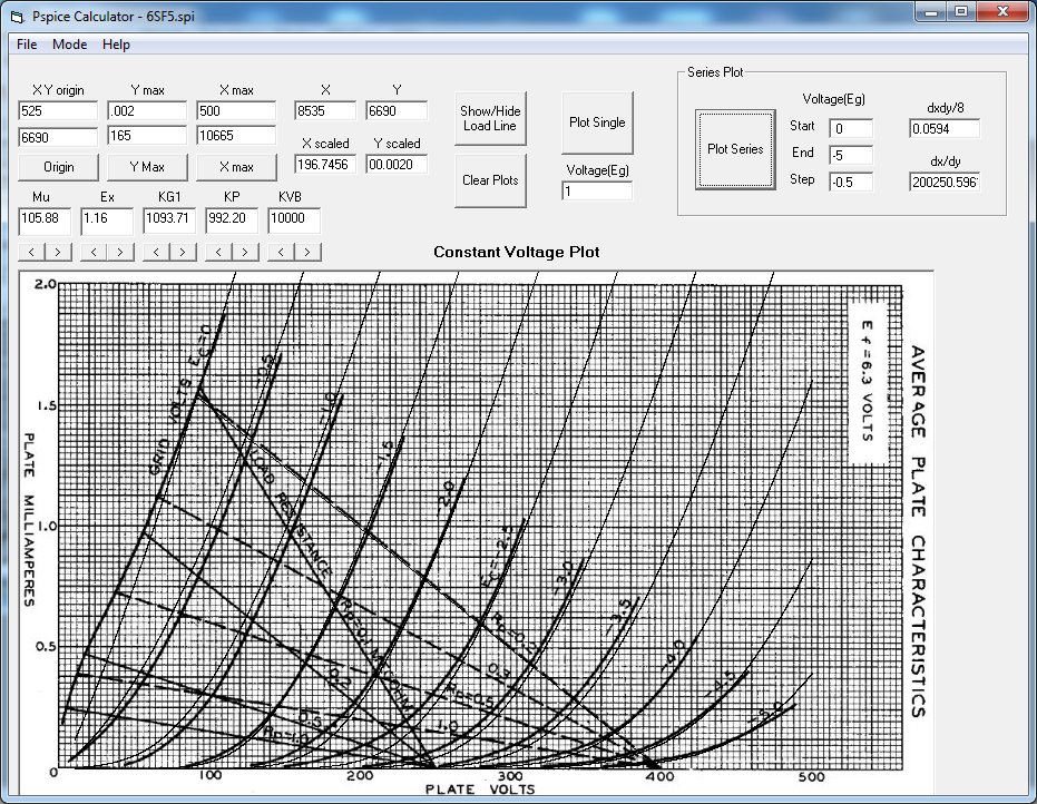

If you want to make your own triode models, I wrote a program to for this. It is an interactive solution that allows you to change parameters until you get a good fit for a particular triode.
The parameters follow the improved formulas outlined on the Norman Koren audio page. There are a few examples in the download. I think you can figure it out from those.

A bit of graphics work seems to have revealed that the 5881 and 6L6GC triode-connected curves may be close enough that a 5881 model is unnecessary.
The -30V and -60V grid lines match almost perfectly, while the 0V curve is probably close enough. Only these 3 values are comparable between the two due to different grid sweeps used.

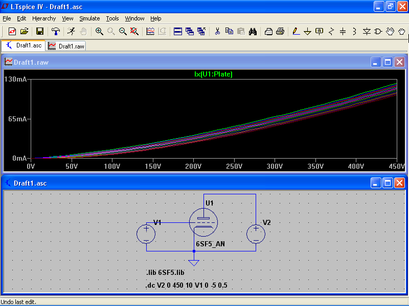

DO NOT USE this model, it is highly inaccurate, plate current is about two orders of magnitude higher.
See for yourself
https://frank.pocnet.net/sheets/049/6/6SF5.pdf

Try this. I just made this quickly but it seems like a good fit.
so:
Good catch, I must have copied the wrong file, the correct SPICE model is as follow:

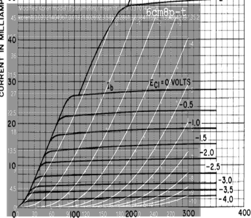

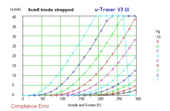

here the triode strapped 6cm8 pentode, can you calculate the spice model?
Apart from error from computation in your curve tracer there are useful plot points which will allow forward correction in Curve Capator. In addition, the original screen data is also used as a reference. So altogether this produce the pentode curve, see any good.
Code:
**** 6CM8P ******************************************
* Created on 05/08/2018 18:35 using paint_kip.jar
* [url=http://www.dmitrynizh.com/tubeparams_image.htm]Model Paint Tools: Trace Tube Parameters over Plate Curves, Interactively[/url]

Code:
* 6cm8p-t LTSpice model
.subckt 6cm8p-t  P G K
    Bp  P K  I=(0.03921404967m)*uramp(V(P,K)*ln(1.0+(0.01321802692)+exp((3.583832861)+(3.583832861)*((38.98411962)+(-139.8642937m)*V(G,K))*V(G,K)/sqrt((35.2957383)**2+(V(P,K)-(1.495413314))**2)))/(3.583832861))**(1.371612463)
.ends 6cm8p-t

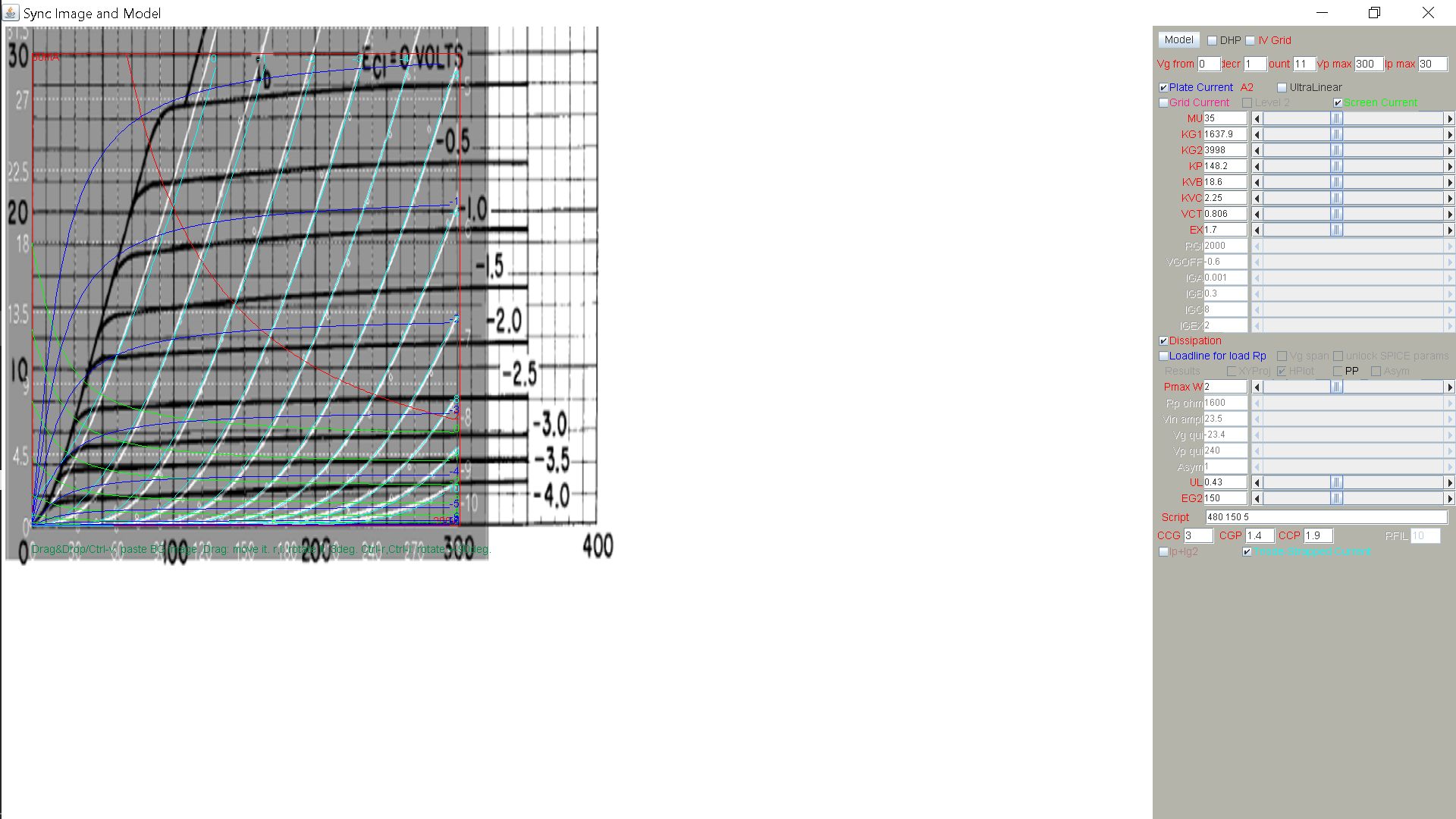

A slight adjustment in plate current of previous post:
Code:
**** 6CM8P******************************************
* Created on 05/08/2018 19:27 using paint_kip.jar

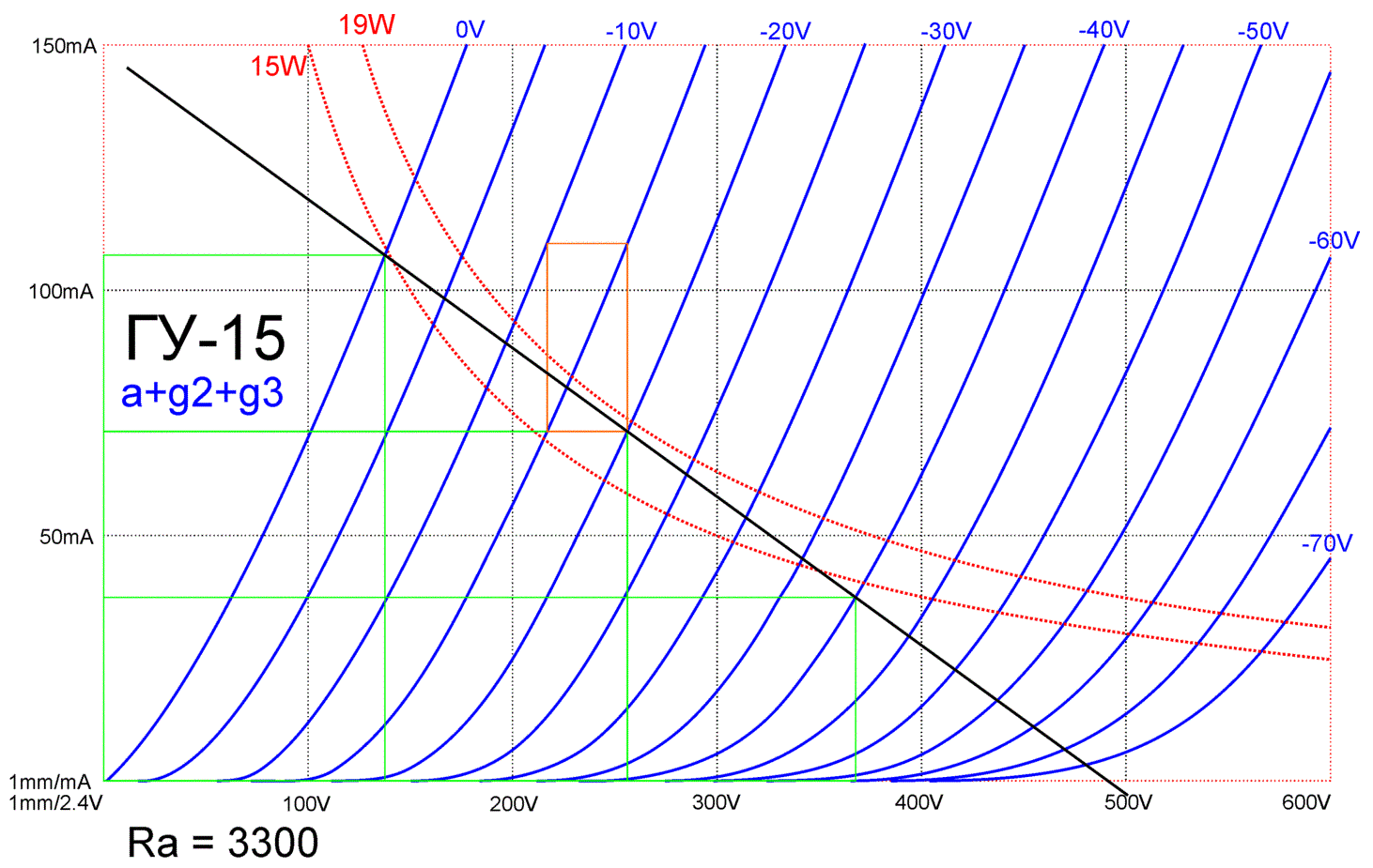

Can I make a request? Russian GU15 - Triode model desired
I searched high and low for a model, found this on diyAudio, Posted By matejsirk:
Code:
**** GU15TRIODE ******************************************
* Created on 07/30/2014 10:24 using paint_kit.jar
* Model Paint Tools: Trace Tube Parameters over Plate Curves, Interactively
* Curves image file: gu15triode.gif
* Data source link:
.SUBCKT GU15T 1 2 3 ; Plate Grid Cathode
+ PARAMS: CCG=3P CGP=1.4P CCP=1.9P RGI=2000
+ MU=7.81 KG1=900 KP=86 KVB=297 VCT=0.206 EX=1.34
* Vp_MAX=600 Ip_MAX=150 Vg_step=5 Vg_start=0 Vg_count=14
* Rp=4000 Vg_ac=55 P_max=18.8 Vg_qui=-48
* X_MIN=110 Y_MIN=47 X_SIZE=1306 Y_SIZE=785 FSZ_X=1936 FSZ_Y=1176 XYGrid=false
E1 7 0 VALUE={V(1,3)/KP*LOG(1+EXP(KP*(1/MU+(VCT+V(2,3))/SQRT(KVB+V(1,3)*V(1,3)))))}
RE1 7 0 1G ; TO AVOID FLOATING NODES
G1 1 3 VALUE={(PWR(V(7),EX)+PWRS(V(7),EX))/KG1}
RCP 1 3 1G ; TO AVOID FLOATING NODES
C1 2 3 {CCG} ; CATHODE-GRID
C2 2 1 {CGP} ; GRID=PLATE
C3 1 3 {CCP} ; CATHODE-PLATE
D3 5 3 DX ; POSITIVE GRID CURRENT
R1 2 5 {RGI} ; POSITIVE GRID CURRENT
.MODEL DX D(IS=1N RS=1 CJO=10PF TT=1N)
.ENDS
I haven't tried it yet.
I did find triode plate curves; hopefully they'll be useful (attached).
Incomplete data sheet
I can't seem to find inter-electrode capacitances in any data sheets, but matejsirk used CCG=3P CGP=1.4P CCP=1.9P.
I hope that's enough info for a good model. Or perhaps the model above is all that is needed; in which case, add it to the collection!
