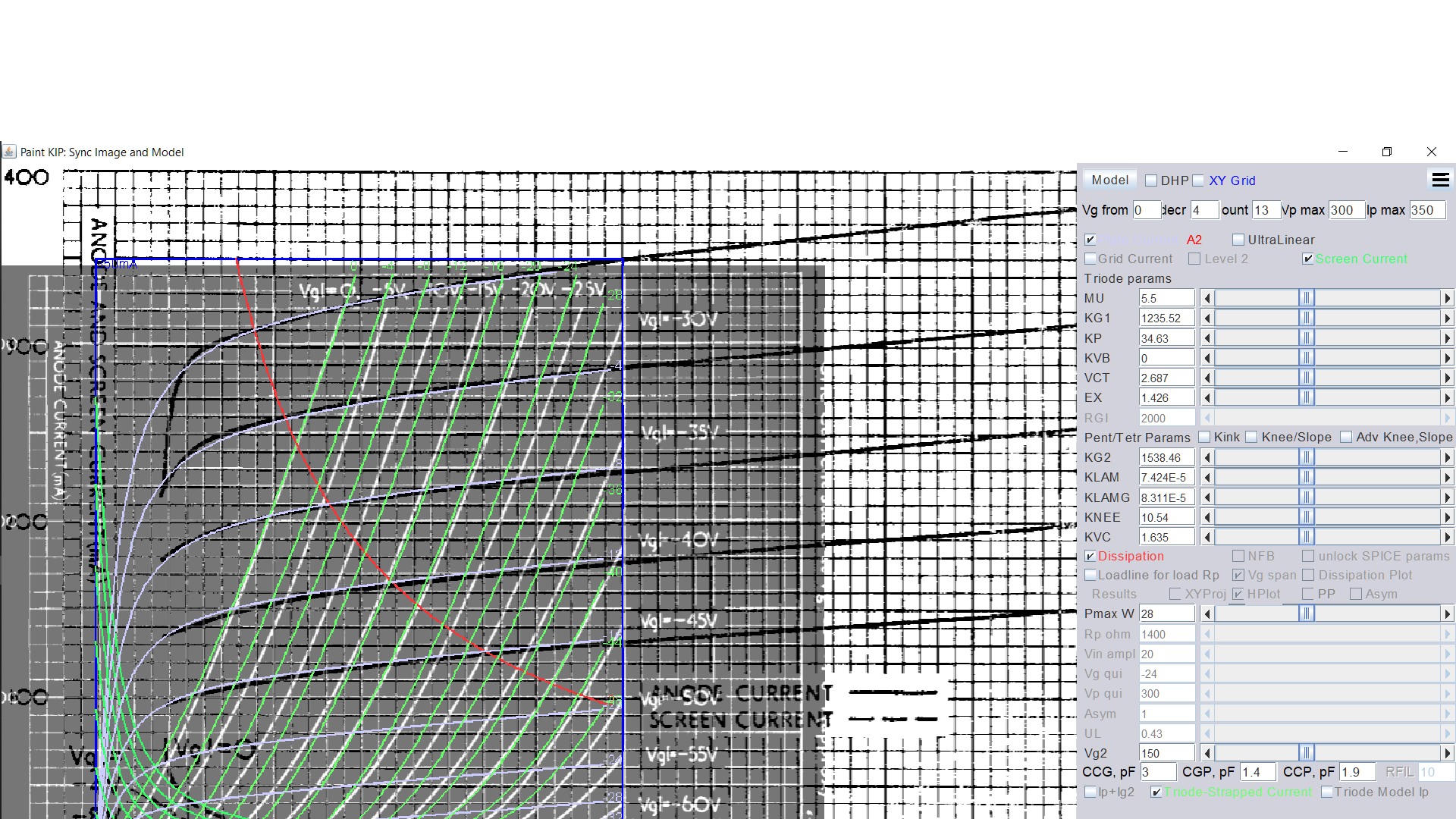

The triode one seems to work fine. But the "pentode" only has 4 elements, where's the supressor grid? Also, need a symbol to go with it, as the 813 has no seperate cathode, but a filament instead, which is also the cathode.The following models are generated from a curve traced sample of 813, so they do not match up well with the GK-71 nor the 813 datasheets, use them at your risk...
The suppressor grid is usually not modeled as it is typically tied to the cathode. You can also make your own schematic symbol for the filament/cathode if that's what you want to see, it does not matter to the model.
