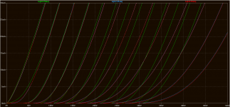

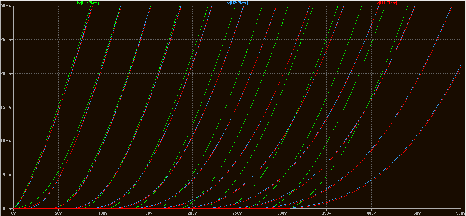

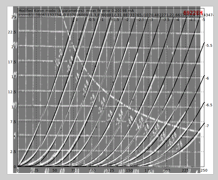

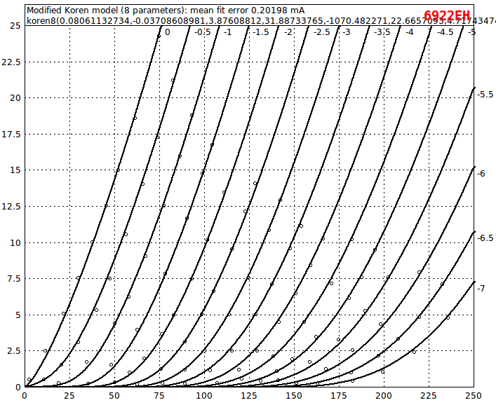

I made model from a set of curves that are supposedly for a 6922EH that compare to a set for for a 6N23P that I have. Who knows...
I made a comparison in LTspice in the image below.
U1 = Philips E88CC
U2 = Supposed 6922EH
U3 = 6N23P from Soviet data sheet.
U1 = Philips E88CC
Code:
* 6922EH LTSpice model
* Modified Koren model (8 parameters) mean fit error 0.20198mA
* Traced by Wayne Clay on 05/29/2016 using Curve Captor v0.9.1
* and Engauge Digitizer
.subckt 6922EH P G K
Bp P K I=
+ (0.08061132734m)*uramp(V(P,K)*ln(1.0+(-0.03708608981)+exp((3.87608812)+
+ (3.87608812)*((31.88733765)+(-1070.482271m)*V(G,K))*V(G,K)/sqrt((22.6657093)**2+
+ (V(P,K)-(4.717434742))**2)))/(3.87608812))**(1.322643185)
Cgp G P 2.2p ; 0.7p added (1.5p)
Cgk G K 4.2p ; 0.7p added (3.5p)
Cpk P K 2.2p ; 0.2p added (2.0p)
Rpk P K 1G ; to avoid floating nodes
d3 G K dx1
.model dx1 d(is=1n rs=2k cjo=1pf N=1.5 tt=1n)
.ends 6922EH

I compared the actual 6N23p with supposed 6922eh you attached, is it close, esp. towards the end. But I still think 6922eh plot is derived from the original 6N23p curve which looks so much alike but actually has much differences. Electroharmonix provides 6922eh datasheet with data only no curve plots at all (that I can find). So one must plot the 6922eh curve to see the real differences!!
Both models are very close, maybe the 6922EH is based on the 6N23P or is the same valve.
The 6N23P model from post#1833 is far better than the one available on Russian forums.

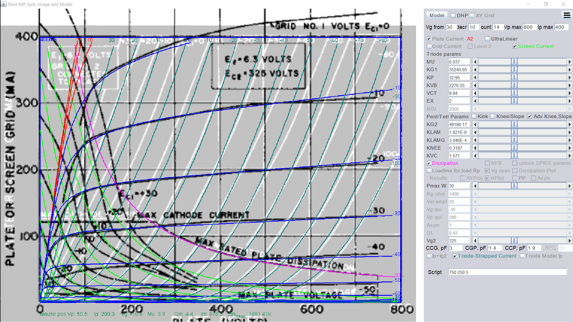

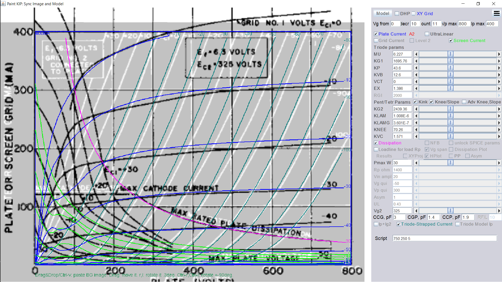

A very difficult curve to paint.
Code:
**** 6384P ******************************************
* Created on 11/21/2018 16:59 using paint_kip.jar
* [url=http://www.dmitrynizh.com/tubeparams_image.htm]Model Paint Tools: Trace Tube Parameters over Plate Curves, Interactively[/url]
* Plate Curves image file: 6384p.png
* Data source link: <plate curves URL>
.SUBCKT 6384P P G2 G K ; LTSpice tetrode.asy pinout
* .SUBCKT 6384P P G K G2 ; Koren Pentode Pspice pinout
+ PARAMS: MU=6.42 KG1=1695.76 KP=43.17 KVB=12 VCT=0 EX=1.386 KG2=2541 KNEE=59.04 KVC=1.571
+ KLAM=1.44E-5 KLAMG=1.359E-6 KNEE2=20 KNEX=30 KNK=-0.044 KNG=0.006
+ CCG=3P CGP=1.4P CCP=1.9P RGI=2000.0
* Vp_MAX=800 Ip_MAX=400 Vg_step=10 Vg_start=0 Vg_count=11
* X_MIN=108 Y_MIN=74 X_SIZE=966 Y_SIZE=715 FSZ_X=1550 FSZ_Y=878 XYGrid=false
* Rp=1400 Vg_ac=20 P_max=30 Vg_qui=-50 Vp_qui=300
* showLoadLine=n showIp=y isDHP=n isPP=n isAsymPP=n isUL=n showDissipLimit=y
* showIg1=n isInputSnapped=y addLocalNFB=n
* XYProjections=n harmonicPlot=y dissipPlot=n
* UL=0.43 EG2=325 gridLevel2=n addKink=n isTanhKnee=y advSigmoid=n
RE1 7 0 1G ; DUMMY SO NODE 7 HAS 2 CONNECTIONS
E1 7 0 VALUE= ; E1 BREAKS UP LONG EQUATION FOR G1.
+{V(G2,K)/KP*LOG(1+EXP((1/MU+(VCT+V(G,K))/SQRT(KVB+V(G2,K)*V(G2,K)))*KP))}
RE2 6 0 1G ; DUMMY SO NODE 6 HAS 2 CONNECTIONS
E2 6 0 VALUE={(PWR(V(7),EX)+PWRS(V(7),EX))} ; Kg1 times KIT current
G1 P K VALUE={V(6)/KG1*ATAN((V(P,K)+KNEX)/KNEE)*TANH(V(P,K)/KNEE2)*(1+KLAMG*V(P,K))+KLAM*V(P,K)}
* Alexander Gurskii screen current, see audioXpress 2/2011
RE4K 4K K 1G ; Dummy, per Alex request
E4K 4K 4 VALUE={0} ; Dummy, per Alex request
G4K 4K K VALUE={V(6)/KG2*(KVC-ATAN((V(P,K)+KNEX)/KNEE)*TANH(V(P,K)/KNEE2))/(1+KLAMG*V(P,K))}
RCP P K 1G ; FOR CONVERGENCE
C1 K G {CCG} ; CATHODE-GRID 1
C2 G P {CGP} ; GRID 1-PLATE
C3 K P {CCP} ; CATHODE-PLATE
R1 G 5 {RGI} ; FOR GRID CURRENT
D3 5 K DX ; FOR GRID CURRENT }
.MODEL DX D(IS=1N RS=1 CJO=10PF TT=1N)

This one with G2 current and no kink.
Code:
* Created on 11/21/2018 19:44 using paint_kip.jar
+ PARAMS: MU=6.289 KG1=10060.6 KP=34.13 KVB=12.6 VCT=6.44 EX=1.774 KG2=20295.48 KNEE=1.877 KVC=1.697
+ KLAM=4.922E-11 KLAMG=1.728E-7 KD=0.44 KC=0.14 KR1=0.0013 KR2=0.064 KVBG=0.015 KNK=-0.044 KNG=0.006
* UL=0.43 EG2=325 gridLevel2=n addKink=n isTanhKnee=n advSigmoid=y
E4 8 0 VALUE={PWR(V(1,3)/KNEE/(V(6)*KVBG),2)}
E5 9 0 VALUE={SQRT(1-EXP(-V(8)*(KC+KR1*V(8))/(KD+KR2*V(8))))*1.5708}
RE4 8 0 1
RE5 9 0 1
G1 P K VALUE={V(6)/KG1*V(9)*(1+KLAMG*V(P,K))+KLAM*V(P,K)}
G2 G2 K VALUE={V(6)/KG2*(KVC-V(9))/(1+KLAMG*V(P,K))}
.ENDS
* The following triode model is derived from pentode model, see above.
* In the triode model, all spice parameters come directly from the pentode model, except for Kg1,
* which for triode-strapped pentodes is derived from pentode's Kg1, Kg2 and Kvc as
* 4Kg1Kg2 / ((2Kvc-Pi)(2Kg1+PiKg2))
* Created on 11/21/2018 19:44 using paint_kit.jar 4.7
.SUBCKT TRIODE_6384P 1 2 3 ; Plate Grid Cathode
+ PARAMS: CCG=3P CGP=1.4P CCP=1.9P RGI=2000
+ MU=6.289 KG1=38576.94 KP=34.13 KVB=12.6 VCT=6.44 EX=1.774
* showLoadLine=n showIp=y isDHT=n isPP=n isAsymPP=n showDissipLimit=y
* showIg1=n gridLevel2=n isInputSnapped=y
E1 7 0 VALUE={V(1,3)/KP*LOG(1+EXP(KP*(1/MU+(VCT+V(2,3))/SQRT(KVB+V(1,3)*V(1,3)))))}
RE1 7 0 1G ; TO AVOID FLOATING NODES
G1 1 3 VALUE={(PWR(V(7),EX)+PWRS(V(7),EX))/KG1}
RCP 1 3 1G ; TO AVOID FLOATING NODES
C1 2 3 {CCG} ; CATHODE-GRID
C2 2 1 {CGP} ; GRID=PLATE
C3 1 3 {CCP} ; CATHODE-PLATE
D3 5 3 DX ; POSITIVE GRID CURRENT
R1 2 5 {RGI} ; POSITIVE GRID CURRENT
.ENDS

This one goes up to +30V A2: Because there are some updates for paint tools it takes awhile to understand all the features to use to paint more accurate model. In this one KVB is used to align plot above 0 (A2).
Code:
* Created on 11/21/2018 23:49 using paint_kip.jar
+ PARAMS: MU=6.037 KG1=35240.65 KP=32.95 KVB=2276.55 VCT=9.94 EX=2 KG2=49180.17 KNEE=0.3187 KVC=1.571
+ KLAM=1.621E-6 KLAMG=3.046E-4 KD=0.44 KC=0.14 KR1=0.0013 KR2=0.064 KVBG=0.015 KNK=-0.044 KNG=0.006
* Vp_MAX=800 Ip_MAX=400 Vg_step=10 Vg_start=30 Vg_count=14
* X_MIN=108 Y_MIN=78 X_SIZE=966 Y_SIZE=711 FSZ_X=1550 FSZ_Y=878 XYGrid=false
* Rp=1400 Vg_ac=20 P_max=30 Vg_qui=-35 Vp_qui=300
RE4 8 0 1
RE5 9 0 1
.ENDS
* Created on 11/21/2018 23:49 using paint_kit.jar 4.7
+ MU=6.037 KG1=7.703E7 KP=32.95 KVB=2276.55 VCT=9.94 EX=2
.ENDS

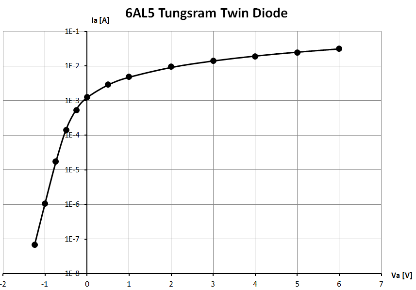

Hi all,
good news for all who does signal conditioning with vacuum diodes: I just released a 5AL6 spice model fitted to a measured Tungsram sample, able to accurate consider the "Anlauf" current.
You may now simulate audion circuits, signal level detection circuits and this stuff.
download is here:
http://adrianimmler.simplesite.com/440951057
kind regards, Adrian
download is here:
By the way, I just noticed that I spelled the vacuum diodes' name wrong in my post #1843.
I meant the 6AL5!!
I meant the 6AL5!!
