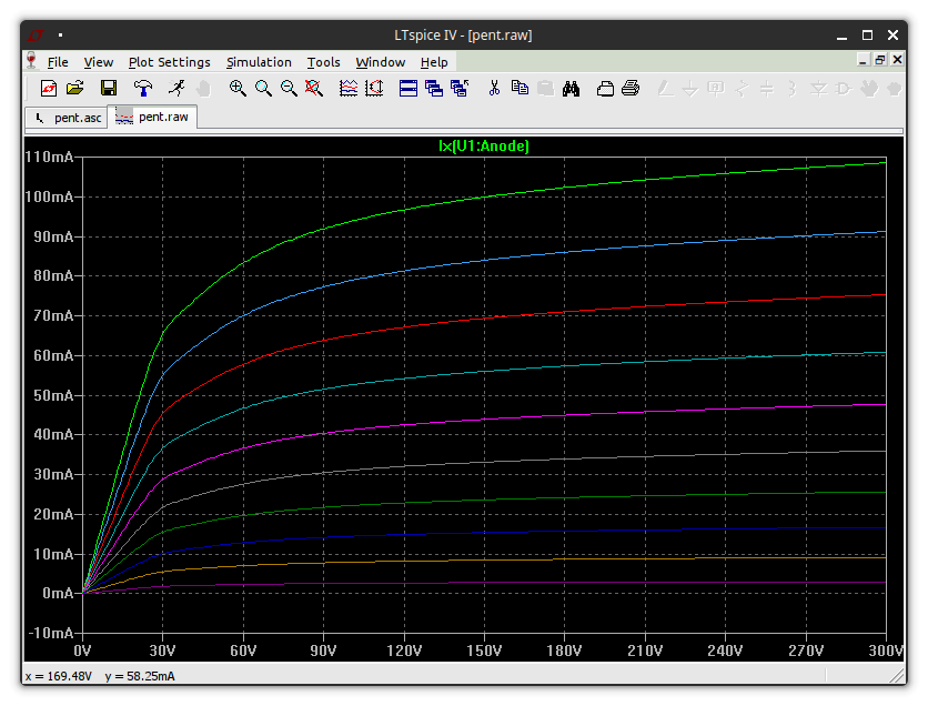

I'm sorry, yes. It's for the 6V6GT -- I had the 6AT6 on my brain owing to the Webcor guitar amp thread. Will ask the moderator to change it.
The model is not yet adapted for screen current as Weaver had mentioned. Will work on that next week.

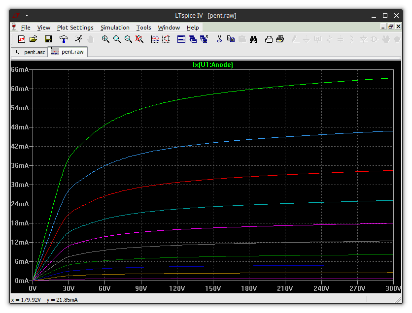

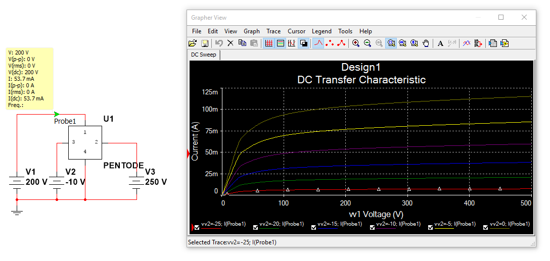

Looking forward to seeing the screen grid current... btw, I could not get the above model to run under LTSpice.
Then the syntax needs to be changed for LTSpice, anyway, I will wait for the screen current model. Thanks.
Needed some curly braces in just the right spots.Looking forward to seeing the screen grid current... btw, I could not get the above model to run under LTSpice.
E1, E2, E3, G1 lines.
Code:
.subckt PENT 1 2 3 4
+params: KG1=0.003751 kp1=-2.491 kp2=3.935 kp3=3.716e-5 kp4=0.1675 kt1=29 kt2=0.2549 kc1=7.829e-4 kc2=6.068e-2 kc3=1.098 ks1=-3.567e-6 ks2=3.267e-3 ks3=-1.38e-2 kcs=0.09196 ecref=0 esref=250
E1 7 0 Value={V(1,4)}
E2 8 0 Value={V(3,4)}
E3 9 0 Value={V(2,4)}
RE1 7 0 1e12
G1 1 4 VALUE={(KG1*V(7)+((kp1/(kp2+v(7))+(kp3*v(7))+kp4)-KG1*V(7))/(1+EXP((KT1-V(7))*KT2)))*((kc1*V(8)**2)+kc2*v(8)+kc3)*((ks1*V(9 )**2)+ks2*v(9)+ks3)*(1/(1-kcs*(V(8)-ecref)*(1-V(9)/esref)))}
RCP 1 4 1e12
C1 2 3 2.4e-12
C2 1 2 3.9e-12
C3 1 3 0.7e-12
R1 2 5 2000
D3 5 3 dx
.model dx d(is=1e-9 rs=1 cjo=10e-12)
.ends

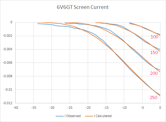

So am I, it's giving me a serious headache. Not nearly as straightforward...

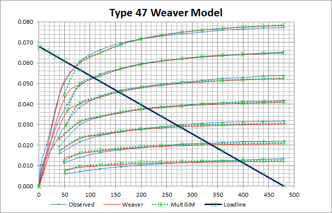

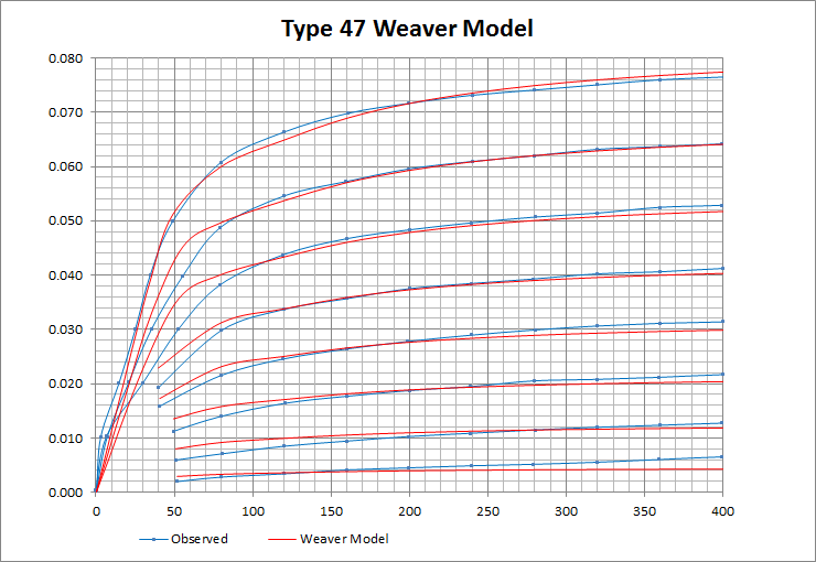

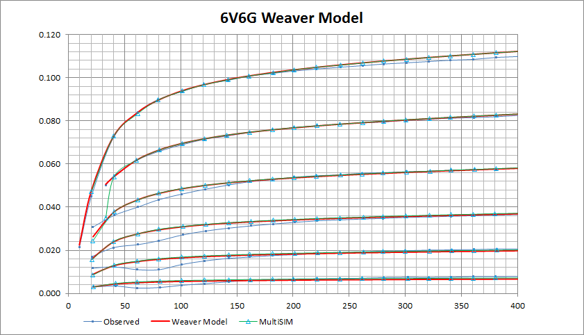

Yup that looks pretty good, did you do an acid-test? Try adding the anode and screen curves together, do they match up with 6V6GT's triode curves?This seems to approximate well:
y = 1.705*w^2 - 0.0011545*w*z - 0.0088955*x*w
where W is the anode current, Z the screen voltage and X the Control Grid Voltage.

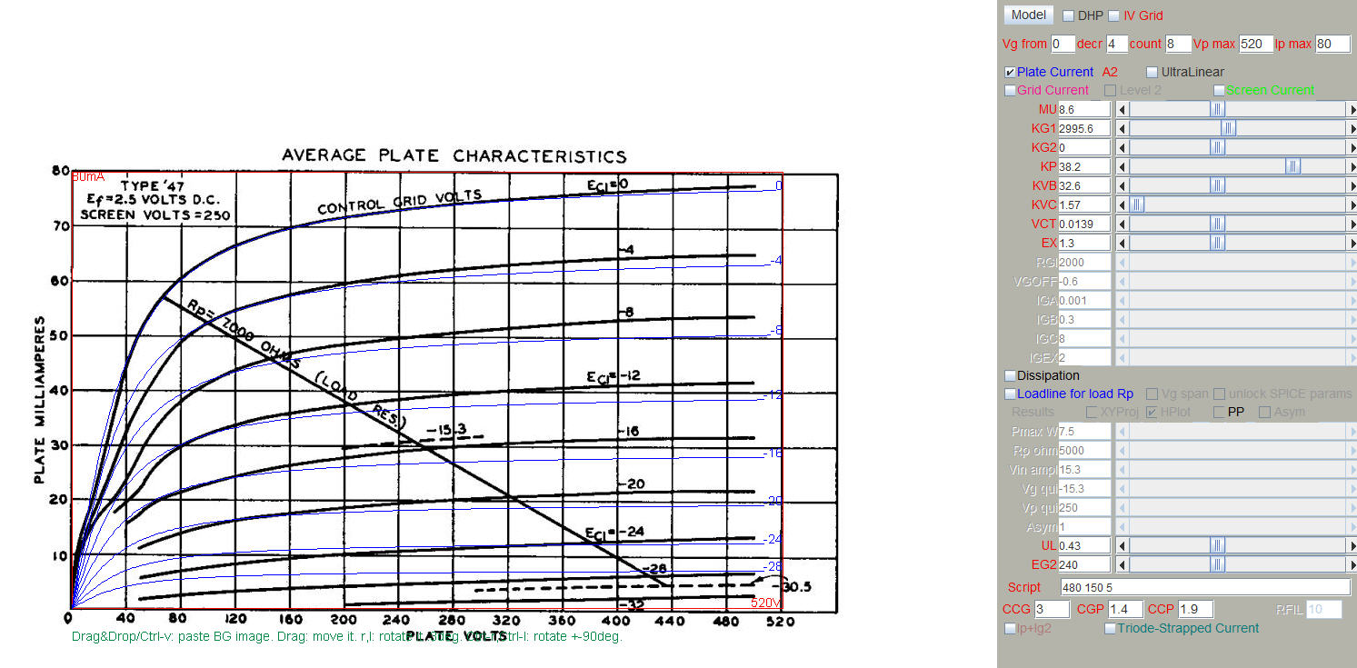

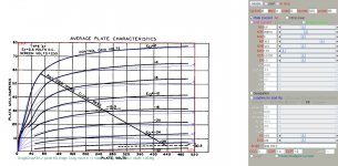

A mediocre type 47 pentode model attached.
If anyone has better model, please inform.

.SUBCKT PENT_47 1 2 3 4 ; P G K G2
+ PARAMS: CCG=3P CGP=1.4P CCP=1.9P RGI=2000
+ MU=8.6 KG1=2995.6 KP=38.2 KVB=32.6 KVC=1.57 VCT=0.0139 EX=1.3 KG2=0
* Vp_MAX=520 Ip_MAX=80 Vg_step=4 Vg_start=0 Vg_count=8
* Rp=5000 Vg_ac=15.3 P_max=7.5 Vg_qui=-15.3 Vp_qui=250 UL=0.43 EG2=240
* X_MIN=182 Y_MIN=191 X_SIZE=782 Y_SIZE=480 FSZ_X=1616 FSZ_Y=876 XYGrid=false
* showLoadLine=n showIp=y isDHP=n isPP=n isAsymPP=n isUL=n showDissipLimit=n
* showIg1=n gridLevel2=n isInputSnapped=n
* XYProjections=n harmonicPlot=y harmonics=y
RE1 7 0 1G ; DUMMY SO NODE 7 HAS 2 CONNECTIONS
E1 7 0 VALUE= ; E1 BREAKS UP LONG EQUATION FOR G1.
+{V(4,3)/KP*LOG(1+EXP((1/MU+(VCT+V(2,3))/V(4,3))*KP))}
G1 1 3 VALUE={(PWR(V(7),EX)+PWRS(V(7),EX))/KG1*ATAN(V(1,3)/KVB)}
* Alexander Gurskii screen current, see audioXpress 2/2011
RE2 8 3 1G ; Dummy
G2 8 3 VALUE={(PWR(V(7),EX)+PWRS(V(7),EX))/KG2*(KVC-ATAN(V(1,3)/KVB))}
E2 8 4 VALUE={0} ; Dummy
RCP 1 3 1G ; FOR CONVERGENCE
C1 2 3 {CCG} ; CATHODE-GRID 1
C2 1 2 {CGP} ; GRID 1-PLATE
C3 1 3 {CCP} ; CATHODE-PLATE
R1 2 5 {RGI} ; FOR GRID CURRENT
D3 5 3 DX ; FOR GRID CURRENT
.MODEL DX D(IS=1N RS=1 CJO=10PF TT=1N)
.ENDS
