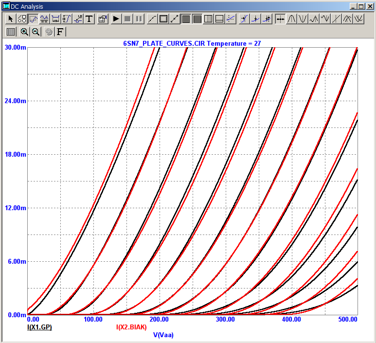

6SN7 vs 6CG7 model
I just used a 6SN7 model and 6CG7 model on the same circuit and got different results. The DC analysis comes out almost identical, but not the AC. Huge difference in THD.
So, is is this a legit difference between the 2 types? And if not, can someone point me to models for the 2 types that have been verified (reasonably) accurate? Thanks.

Here's a quick comparison of my 6CG7 model and Ayumi's 6SN7. Black curves = 6CG7, red curves = Ayumi's 6SN7 model. But first a screenshot of my 6CG7 model in CurveCaptor. The dots (circles) are the actual traced curves from the GE datasheet.I can't remember for sure, I added them to my library a while back.

I've noticed that different timestep values in a simulation can give differing THD levels, especially from the Ayumi models... One reason I don't give much weight to THD simulation results. Add a little salt. 😉
Real tubes will never align perfectly with published curves and will measure differently in actual circuits. All we can hope for is reasonably accurate models.
Cogs, if you're Wayne, I have it the other way around, I have a CG7 by Ayumi and SN7 by Wayne Clay. Regardless, doesn't matter, thanks for posting that info, I'd like to use the Wayne version. Can you verify that this is correct? Thanks much

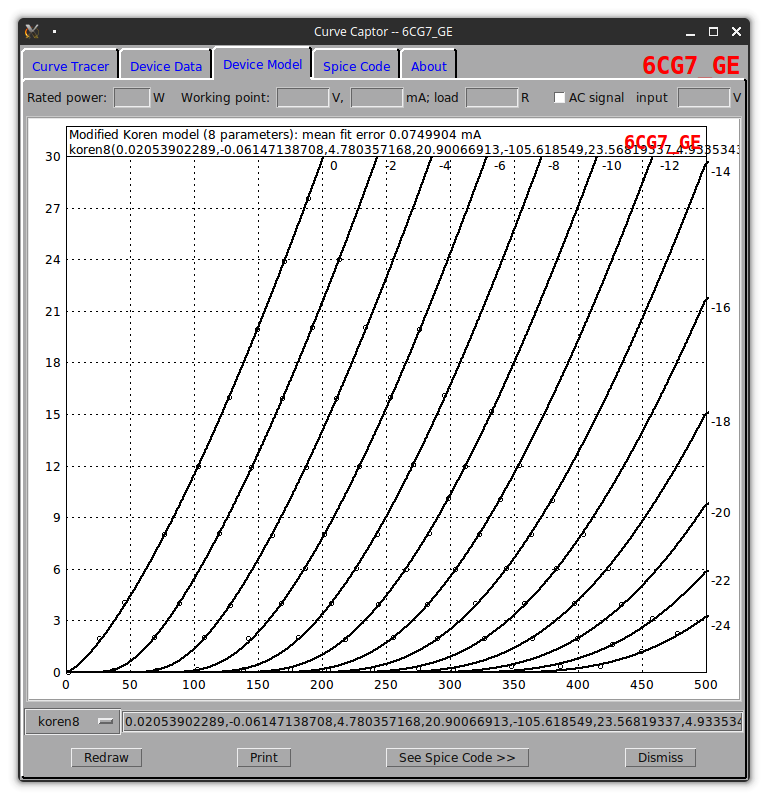

Code:
* 6CG7_GE LTSpice model
* Modified Koren model (8 parameters): mean fit error 0.0749904mA
* Traced by Wayne Clay on 10/03/2013 using Curve Captor v0.9.1
* from General Electric data sheet
.subckt 6CG7_GE P G K
Bp P K I=
+ (0.02053902262m)*uramp(V(P,K)*ln(1.0+(-0.06147138054)+exp((4.780357089)+
+ (4.780357089)*((20.90066891)+(-105.6185609m)*V(G,K))*V(G,K)/sqrt((23.56820043)**2+
+ (V(P,K)-(4.933537229))**2)))/(4.780357089))**(1.37367599)
Cgk G K 3.0p ; 0.7p added
Cpk P K 2.7p ; 0.5p added
Cgp G P 4.7p ; 0.7p added
Rpk P K 1G ; to avoid floating nodes
d3 G K dx1
.model dx1 d(is=1n rs=2k cjo=1pf N=1.5 tt=1n)
.ends 6CG7_GE
Cheers from Wayne in Wayne County.
