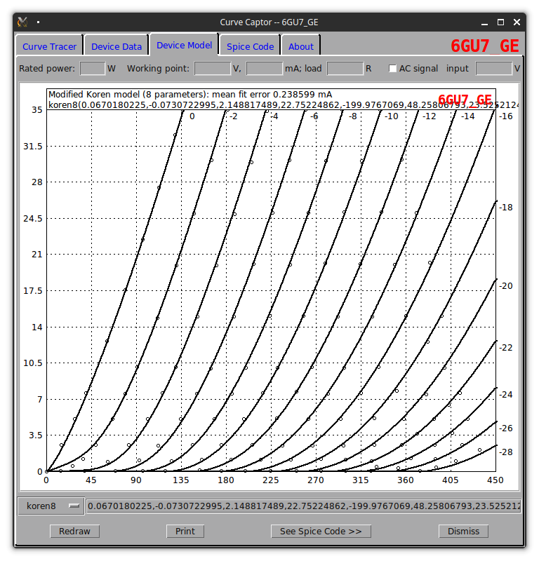

Not super accurate, but fairly close. 😉
Code:
* 6GU7_GE LTSpice model
* Modified Koren model (8 parameters): mean fit error 0.238599mA
* Traced by Wayne Clay on 10/25/2013 using Curve Captor v0.9.1

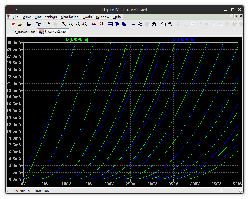

Why not use the Ayumi N model for 12BH7? That's the same tube, but with a 6.3V heater instead of a center tapped 12.6V heater.
My model is somewhat more accurate and Micro Cap pukes (matrix is singular error) on Ayumi's models.
#1
6GU7 Curve Captor
#2
Green = 6GU7_GE
Blue = 12BH7_AN
I get an error. It says, "Singular matrix: check node m1#source iteration No. 6"

Do you see anything in there that would generate this error?
PS: I use your 6SN7_GE model all the time, and that works great. I tried taking my 6SN7_GE.asy file and modifying it to point to 6GU7_GE.inc. Same error. So I think the incompatibility must be somewhere in the 6GU7_GE.inc file (which is just your model copied-pasted straight from your post).
I made a file 6GU7_GE.asy to pick this model from a list of triodes within LTspice. Here's my .asy file -- that is NOT WORKING (so don't try to use it yet):
I've found the typo; missing "p" in this line:
Cgp G P 3.7 ; 0.7p added
Should be:
Cgp G P 3.7p ; 0.7p added
Corrected here:
