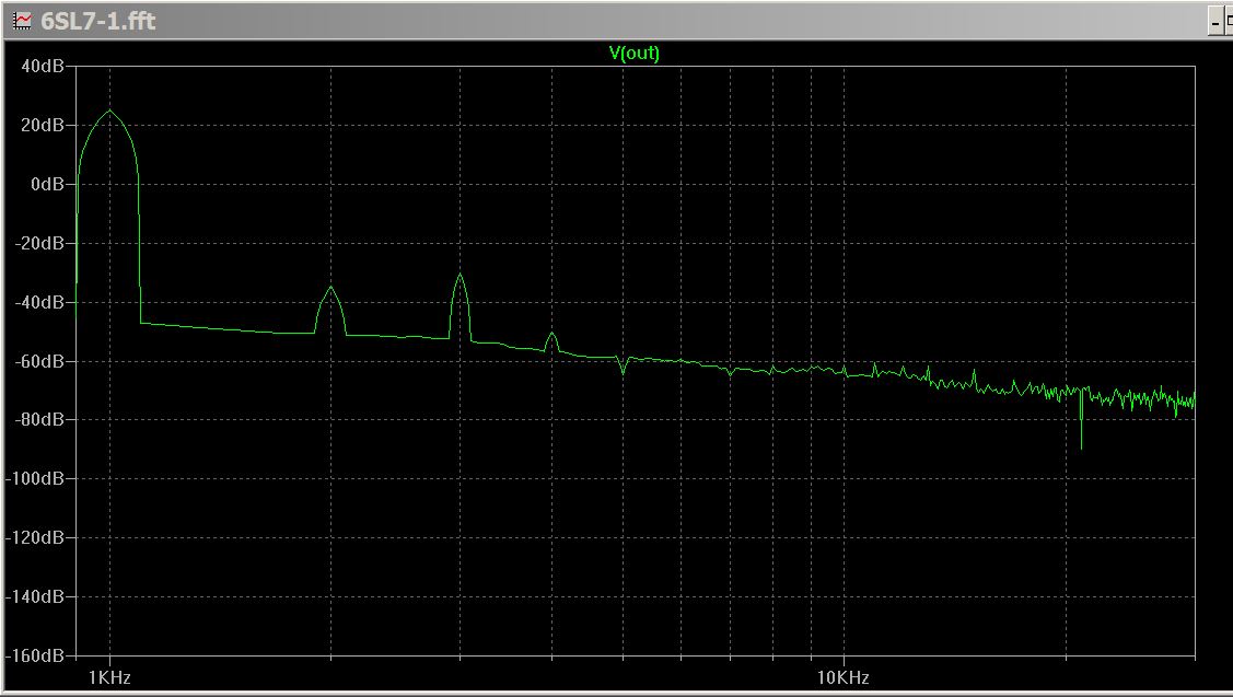

Newbie question: Looking at an FFT plot, the fundamental (1khz in pic below) shows not as a sharp spike but sort of a wider shape with a peak at some +20dB. Is this just a LTspice inaccuracy, is it the result of less than optimal tube models, or ??? I get this behavior with a variety of tubes.
And does this indicate that all other peaks (f2, f3, etc) are similarly off?
It has nothing to do with the tube models, it seems the window function in LTSpice isn't set up properly, BTW, in the future, please post LTSpice related questions to this thread.
Thank you, I will. I posted here thinking there may be an issue with the models.
Have a look at post #19 in the LT thread jazbo linked to 🙂

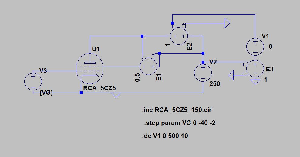

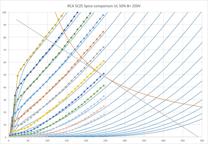

I was asked by Bondini to measure a few 5CZ5 pentodes on the uTracer which I duly did. I then extracted the Spice model using Derk Reedman's extractmodel for the beam pentode using DERKE. One set of triode connected curves and 4 sets of pentode curves for different values of Vs were used. The visual correlation between simulated and measured data looked pretty good.
I then built a simple Spice circuit that simulates what the uTracer does in UL mode, and measured the same on the uTracer. The comparison is shown in the attached file, with the solid blue lines being the Spice curves and the other coloured curves being the measured ones.
You can see some deviation in the area of interest, which is probably due to the inclusion of too many low current data points in the optimisation.
Any views on this?
