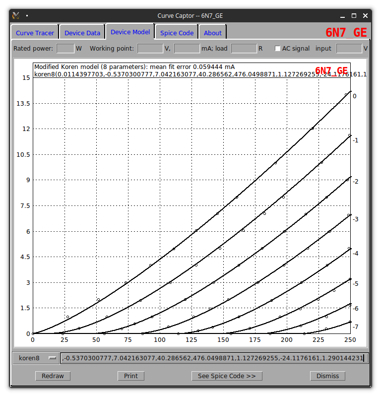

Hey Gang, does anyone have a 6N7 model they would like to post for me?
I have been using one section of an ECC33 in LTSpice to model the two sections of a 6N7 in parallel, it's the closest thing I have but I would like a real model of a 6N7 before I rip my amp apart.
I want to thank Thomas from Vinylsavor blog for giving me the idea of trying a 6N7 to drive my 6HJ5 amp. I plan to current source the plate @10mA and use a blue LED on the cathode.

I found the model below among my models, but cannot guarantee accuracy.

Is it accurate enough? You be the judge...
The above 6N7 SPICE model vs. the GE datasheet:
Looks accurate enough to me but I can't seem to get it to work in LTSpice correctly. I mean I don't get any errors but I am getting weird readings like the same voltage at the cathode is appearing on the grid in a simple common cathode gain stage. The model looks different then the ones I am use to so maybe I need to change something in the txt file?

Above 6N7 model traced over GE datasheet (circles) in Curve Captor.
You are welcome!cogsncogs, thank you that works perfect!!!
I've just added a diode model to give some semblance of grid current and to insure covergence. Didn't notice it wasn't there before.

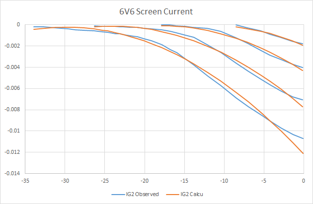

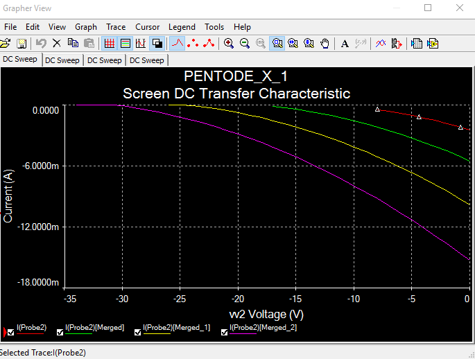

This is related to 47 pentode model.
I took your advice and end up with the following model
However, when i tried to simulate, it ran very slowly.. i don't think it works? Where did i go wrong?

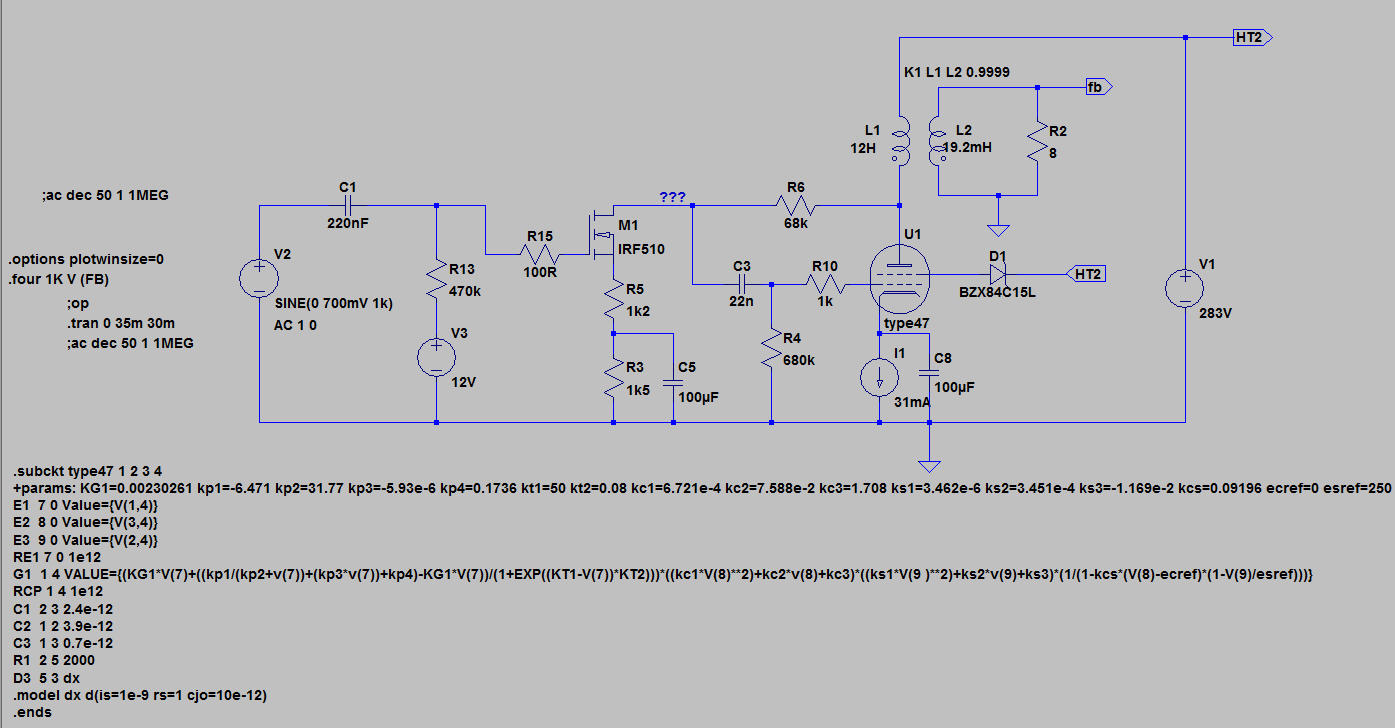

.subckt type47 1 2 3 4
+params: KG1=0.00230261 kp1=-6.471 kp2=31.77 kp3=-5.93e-6 kp4=0.1736 kt1=50 kt2=0.08 kc1=6.721e-4 kc2=7.588e-2 kc3=1.708 ks1=3.462e-6 ks2=3.451e-4 ks3=-1.169e-2 kcs=0.09196 ecref=0 esref=250
E1 7 0 Value={V(1,4)}
E2 8 0 Value={V(3,4)}
E3 9 0 Value={V(2,4)}
RE1 7 0 1e12
G1 1 4 VALUE={(KG1*V(7)+((kp1/(kp2+v(7))+(kp3*v(7))+kp4)-KG1*V(7))/(1+EXP((KT1-V(7))*KT2)))*((kc1*V(8)**2)+kc2*v(8)+kc3)*((ks1*V(9 )**2)+ks2*v(9)+ks3)*(1/(1-kcs*(V(8)-ecref)*(1-V(9)/esref)))}
RCP 1 4 1e12
C1 2 3 2.4e-12
C2 1 2 3.9e-12
C3 1 3 0.7e-12
R1 2 5 2000
D3 5 3 dx
.model dx d(is=1e-9 rs=1 cjo=10e-12)
.ends

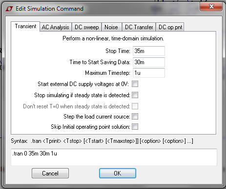

Try changing the Maximum Time Step to 1u in the Transient analysis, it should run pretty fast, although as jackinnj mentioned, this particular model does not contain screen current.However, when i tried to simulate, it ran very slowly.
I didn't pay a lot of attention to the capacitance and diode when i did the model.
In playing around with the 6V6GT you could add an entire new level of complexity to model the "tetrode kinkiness".
How fast is "pretty fast"? Been running the simulation for about 10 minutes and i haven't got past 1.5% progress.
