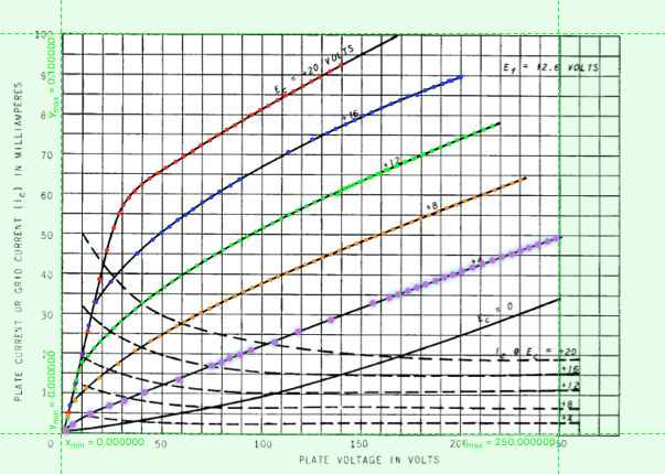

Alternative 7859 Triode Model
Code:
* SPIEC Model Generated with Curve Captor Copyright (C) 2001-2005 Andrei Frolov
* 7895 model based on RCA datasheet by jazbo8 on April 18, 2016
.SUBCKT 7895_AF P G K
Bp P K I=(0.002792114283m)*uramp(V(P,K)*ln(1.0+(-0.007921377953)+exp((0.029581058)+(0.029581058)*((3947.799129)+(-275542.0296m)*V(G,K))*V(G,K)/sqrt((46.11727264)**2+(V(P,K)-(14.43981838))**2)))/(0.029581058))**(1.146266009)
CGA G P 0.9p
CGK G K 4.2p
CAK P K 1.7p
D3 5 K DX ;
R1 G 5 2000 ;
.MODEL DX D(IS=1N RS=1 CJO=10PF TT=1N)
.ENDS

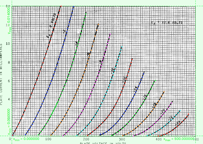

12J5 model (negative bias only)
Code:
* Generic triode model: 12J5
* Copyright 2003--2008 by Ayumi Nakabayashi, All rights reserved.
* Version 3.10, Generated on Wed Apr 20 07:18:20 2016
* Plate
* | Grid
* | | Cathode
.SUBCKT 12J5 A G K
BGG GG 0 V=V(G,K)+0.7884484
BM1 M1 0 V=(0.013715092*(URAMP(V(A,K))+1e-10))**-0.47044075
BM2 M2 0 V=(0.761251*(URAMP(V(GG)+URAMP(V(A,K))/17.407757)+1e-10))**1.9704407
BP P 0 V=0.00089453094*(URAMP(V(GG)+URAMP(V(A,K))/22.867302)+1e-10)**1.5
BIK IK 0 V=U(V(GG))*V(P)+(1-U(V(GG)))*0.00051842727*V(M1)*V(M2)
BIG IG 0 V=0.00044726547*URAMP(V(G,K))**1.5*(URAMP(V(G,K))/(URAMP(V(A,K))+URAMP(V(G,K)))*1.2+0.4)
BIAK A K I=URAMP(V(IK,IG)-URAMP(V(IK,IG)-(0.00050657988*URAMP(V(A,K))**1.5)))+1e-10*V(A,K)
BIGK G K I=V(IG)
* CAPS
CGA G A 3.4p
CGK G K 3.4p
CAK A K 3.6p

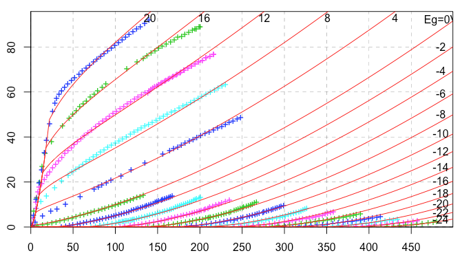

12J5 model (including positive bias)
Code:
* Generic triode model: 12J5_positive
* Version 3.10, Generated on Wed Apr 20 07:36:06 2016
* Plate
* | Grid
* | | Cathode
.SUBCKT 12J5_positive A G K
BGG GG 0 V=V(G,K)+0.81657826
BM1 M1 0 V=(0.012045594*(URAMP(V(A,K))+1e-10))**-0.40203768
BM2 M2 0 V=(0.78862791*(URAMP(V(GG)+URAMP(V(A,K))/17.547669)+1e-10))**1.9020377
BP P 0 V=0.00081633583*(URAMP(V(GG)+URAMP(V(A,K))/22.250885)+1e-10)**1.5
BIK IK 0 V=U(V(GG))*V(P)+(1-U(V(GG)))*0.00048081041*V(M1)*V(M2)
BIG IG 0 V=0.00040816791*URAMP(V(G,K))**1.5*(URAMP(V(G,K))/(URAMP(V(A,K))+URAMP(V(G,K)))*1.2+0.4)
BIAK A K I=URAMP(V(IK,IG)-URAMP(V(IK,IG)-(0.00046381335*URAMP(V(A,K))**1.5)))+1e-10*V(A,K)
BIGK G K I=V(IG)
* CAPS
CGA G A 3.4p
CGK G K 3.4p
CAK A K 3.6p
.ENDS

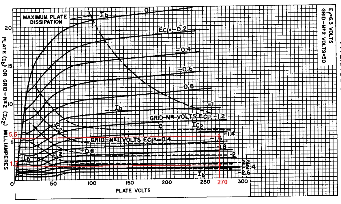

I tried the 7587 tetrode model in my circuit, but I was unable to make it behave in a way that seems to make sense. The circuit is a push-pull line output amplifier using an output transformer. I was attempting to use a current mirror in place of the separate 300 Ohm cathode resistors to force the DC bias currents to be identical in both tubes. No matter how I adjust the values, the tetrode will not do more than 4 mA bias, and the screen grid voltage is dropping to as low as 23 V due to excessive current flow from B+ through the 120K screen grid isolation resistor. The Ampex schematic shows 52V at the screen grids. I tried it on the factory circuit, which shows 1.5V at the junction of each cathode and its 300 Ohm resistor (5mA), but the model doesn't respond like the Ampex schematic says.
Is it possible to tweak the Spice model to help it behave more like the real thing? or am I doomed to trying all the ideas out on the bench?
Thanks for all your help.
While the 7587 model is not perfectly accurate, it should still give you useful results in the simulations. Please take a look at the bias conditions below, if the Ampex figures are correct, then Ip=5.5mA, Ig2=1.7mA, so Ik = 7.2mA, but that would make Vk = 2.16V, which can't be right... Working it another way, Ig2 = (275-52)/120k = 1.858mA, since the Ig2 is proportional to Ip, that means Ip has to be greater than 5.5mA, thus making Vk even higher than before, which does not make sense either...

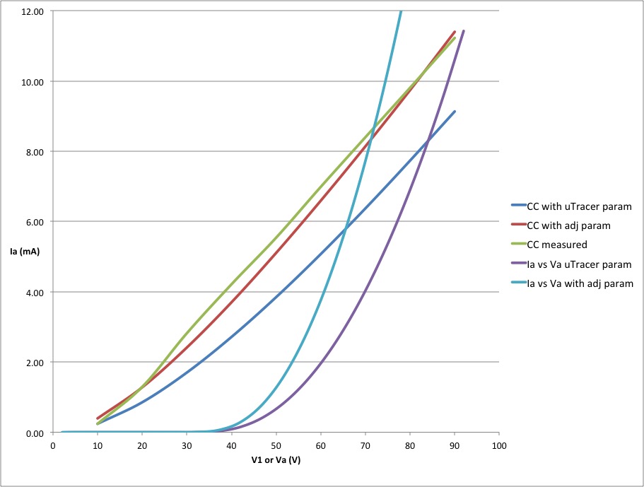

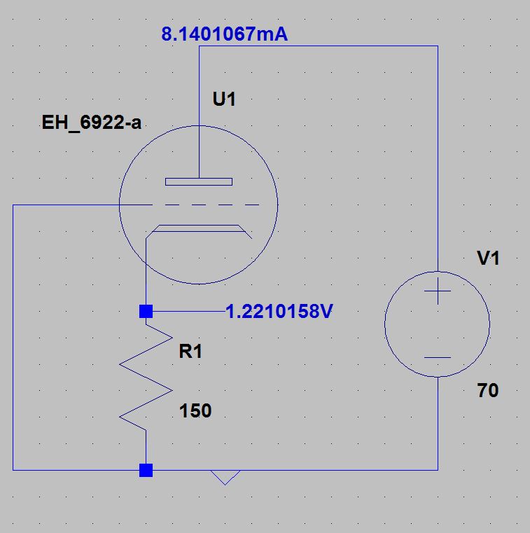

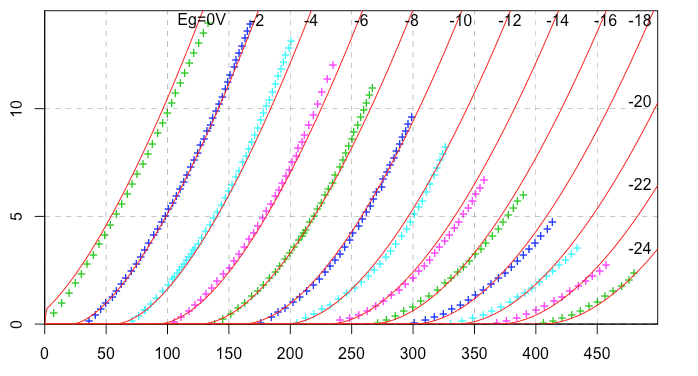

I have done a few more measurements using the KG1 "adjustment" described above ^^^
I used a simple common cathode (CC) circuit shown, and made static measurements of Ia as the supply V1 varies. The results are shown in the graph.
The dark blue line "CC with uTracer param" is the simulated curve using the Koren triode parameters generated by the uTracer; the red "CC with adj param" is the simulated curve with KG1 changed as described; the green "CC measured" curve is the bench test actual measured curve. You can see the closer correlation between the measured and adjusted parameter curves.
The other 2 curves show Ia vs Va for the triode with uTracer and adjusted parameters and shows the marked differences when KG1 is changed.
I have conducted some small and large (1V pk-pk) signal simulation vs tests and again get greater agreement with the simulation using the adjusted parameter than with the original uTracer parameters.
Finally I tried to "preheat" the tube by applying dc quiescent conditions to the tube then quickly moving it to the uTracer to test! I tried to keep it "toasty" with a cloth, but to no avail. Although there was a change it was not significant.
