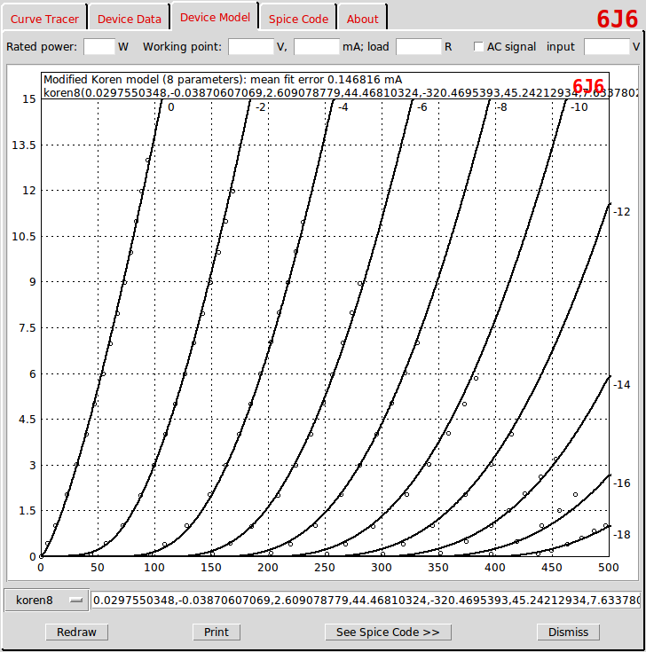

Try this 6J6 model, it is very similar to the 6n15p.Hello all,
Does any of you have a model for the soviet 6N15P double triode?
It's this: https://frank.pocnet.net/sheets/113/6/6N15P.pdf
http://tubedata.milbert.com/sheets/093/6/6J6.pdf
You didn't state what simulator you are using, so I've attached a .txt file that includes 6J6 models for various simulators. Here's the LTspice version in the code box below:
Code:
* 6J6 LTSpice model
* Modified Koren model (8 parameters): mean fit error 0.146816 mA
* Traced by Wayne Clay on 2/12/2014 using Curve Captor v0.9.1
* from General Electric data sheet
.subckt 6J6 P G K
Bp P K I=
+ (0.02975503554m)*uramp(V(P,K)*ln(1.0+(-0.03870606743)+exp((2.609078816)+
+ (2.609078816)*((44.4681031)+(-320.4695508m)*V(G,K))*V(G,K)/sqrt((45.24212568)**2+
+ (V(P,K)-(7.633778567))**2)))/(2.609078816))**(1.325356539)
Cgp G P 1.8p ; 0.2p added
Cgk G K 2.4p ; 0.2p added
Cpk P K 0.9p ; 0.2p added
Rpk P K 1G ; to avoid floating nodes
d3 G K dx1
.model dx1 d(is=1n rs=2k cjo=1pf N=1.5 tt=1n)
.ends 6J6
Code:* 6J6 LTSpice model * Modified Koren model (8 parameters): mean fit error 0.146816 mA * Traced by Wayne Clay on 2/12/2014 using Curve Captor v0.9.1 * from General Electric data sheet .subckt 6J6 P G K Bp P K I= + (0.02975503554m)*uramp(V(P,K)*ln(1.0+(-0.03870606743)+exp((2.609078816)+ + (2.609078816)*((44.4681031)+(-320.4695508m)*V(G,K))*V(G,K)/sqrt((45.24212568)**2+ + (V(P,K)-(7.633778567))**2)))/(2.609078816))**(1.325356539) Cgp G P 1.8p ; 0.2p added Cgk G K 2.4p ; 0.2p added Cpk P K 0.9p ; 0.2p added Rpk P K 1G ; to avoid floating nodes d3 G K dx1 .model dx1 d(is=1n rs=2k cjo=1pf N=1.5 tt=1n) .ends 6J6
Thank you very much!
I'm using Simetrix, therefore it's easy to adapt.

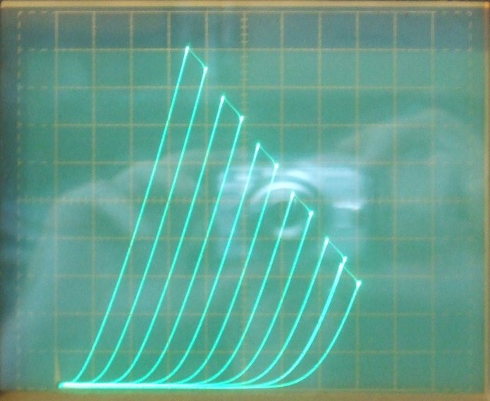

Here's another one for which there are no spice models: 12HL7
diyAudio member smoking-amp posted curve traces of a triode strapped 12HL7, here:
"...pic is in "pseudo" triode mode (screen to plate): 0.5 V/step on g1, 5 mA/div vertical, 20V/div horizontal."
From thread http://www.diyaudio.com/forums/tubes-valves/271134-schade-cfb-exactly-equivalent-3.html#post4256614
Is that enough info to be able to make a spice model?

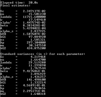

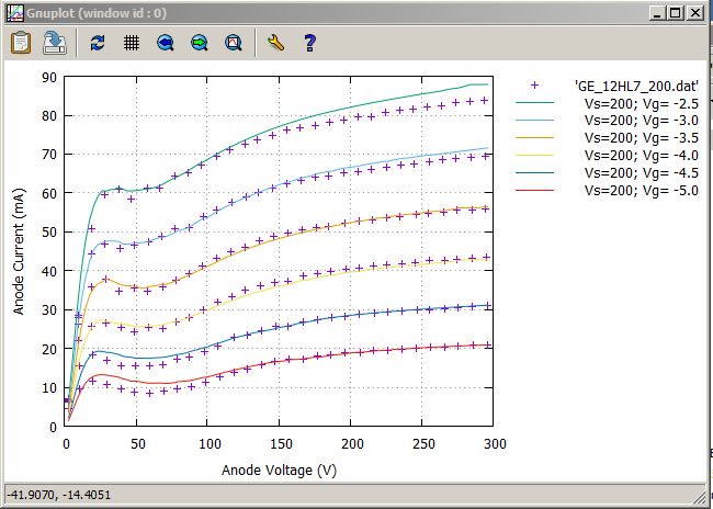

12HL7
I did some measurements earlier in the year for Bondini who supplied me with a GE 12HL7.
I attach the "DerkE" model I extracted, with the parameters and standard variances (in %) as well as a sample model vs measured match for Vs = 200V
Yes, but i am having adult beverage with wifey, watching "Death in Paradise" on the PBS. Remind me in the morning!
I missed that when you posted it. Thanks!

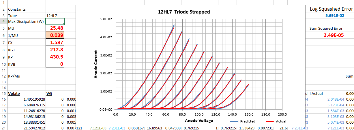

Thanks. But I'm afraid I feel a bit, er... behind the curve. I lack the know-how to convert the data from that image to a working (text file) spice model in LTspice. I usually use the Ayumi models jazbo8 and others have posted to this thread.
Is there a guide somewhere for converting the data in the image you posted to a .subckt file for LTspice?
