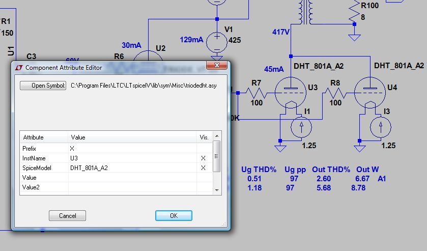

mogliaa said:
Just make sure you have a 4-element DHT symbol as the model is for 4 pin triodes (2 for filament).
Ale, can you post the 4-element DHT symbol you use with LTspice? Is it a .asy file? Thanks.
added later:
I'd like to make a .asy model for a 4-element DHT, so I can save your found parameters for various DHTs in text files in my LTspice /sub folder, and call them up within a schematic from the devices pick list. (I hope that makes sense.) Is this as simple as taking a pre-existing .asy file for a tetrode (for example) and renaming pin elements 1, 2, 3, and 4 from P, G2, G1, and K to P, G, K1, and K2?
thanks for any help with this.
Joined 2004
I use triodedht.asy.
Version 4
SymbolType CELL
LINE Normal -48 0 -28 0
LINE Normal -20 0 -12 0
LINE Normal -4 0 4 0
LINE Normal 12 0 20 0
LINE Normal 28 0 36 0
LINE Normal 0 -48 0 -16
LINE Normal -20 -16 20 -16
LINE Normal -20 -12 20 -12
LINE Normal -20 -16 -20 -12
LINE Normal 20 -16 20 -12
LINE Normal 16 32 16 65
LINE Normal -16 33 -16 65
LINE Normal 1 24 16 32
LINE Normal -16 33 1 24
CIRCLE Normal -48 -48 48 48
WINDOW 0 8 -64 Left 0
WINDOW 3 62 -29 Left 0
SYMATTR Value TriodeDHT
SYMATTR Prefix X
SYMATTR Description This symbol is for use with a subcircuit macromodel that you supply.
PIN 0 -48 NONE 0
PINATTR PinName P
PINATTR SpiceOrder 1
PIN -48 0 NONE 0
PINATTR PinName G
PINATTR SpiceOrder 2
PIN -16 64 NONE 0
PINATTR PinName K1
PINATTR SpiceOrder 3
PIN 16 64 NONE 8
PINATTR PinName K2
PINATTR SpiceOrder 4

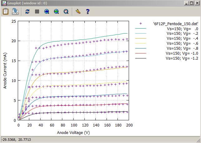

Looking for Spice model of 6F12P (6Ф12П) both Triode and Pentode;
found that pentode model here, but does not emulate IG2 very well, too low;
and no triode model at all;
.SUBCKT 6F12PP 1 2 3 4 ; P G1 C G2 (Pentode) 28-Feb-2008
+ PARAMS: MU= 71.45 EX= 1.350 KG1= 260.8 KP=7396.95 KC= 4000
+ KVB= 17.9 VCT= 0.00 RGI= 4500k
+ CCG=6.6P CPG1=0.02P CCP=1.9P
RE1 7 0 1G
RE2 8 4 1G
E1 7 0 VALUE={V(2,4)/KP*LOG(1+EXP((1/MU+V(3,4)/V(2,4))*KP))}
G1 1 4 VALUE={(PWR(V(7),EX)+PWRS(V(7),EX))/KG1*1.57*TANH(2*V(1,4)/(KVB*3.14159))}
G2 8 4 VALUE={(PWR(V(7),EX)+PWRS(V(7),EX))/KC*(2.57-1.57*TANH(2*V(1,4)/(KVB*3.14159)))}
E2 8 2 VALUE={0}
RCP 1 4 1G ; FOR CONVERGENCE
C1 3 4 {CCG} ; CATHODE-GRID 1
C2 1 3 {CPG1} ; GRID 1-PLATE
C3 1 4 {CCP} ; CATHODE-PLATE
R1 3 5 {RGI} ; FOR GRID CURRENT
D3 5 4 DX ; FOR GRID CURRENT
.MODEL DX D(IS=1N RS=1 CJO=10PF TT=1N)
.ENDS
it also seems that there are several typos in the data-sheet on the net:
http://frank.pocnet.net/sheets/112/6/6F12P.pdf
cathode resistors for both triode and pentode are given as 68 kohm (!) this should be 68 ohm I guess;
output capacitance of the triode is given as 0.26pF ... very low, my guess is that it is more like 2.6pF;
the pentode's voltage limit is given as 3000v, 300v it should be.

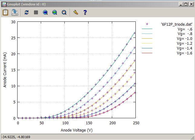

Found these by Koonw: http://www.diyaudio.com/forums/tubes-valves/286561-new-d3a-equivalent-marked.html#post4609774
Code:
A) Pentode Section
**** 6F12PI_P ******************************************
* Created on 02/07/2016 22:40 using paint_kip.jar
* Model Paint Tools: Trace Tube Parameters over Plate Curves, Interactively
* Plate Curves image file: 6f12pi-p.png
* Data source link: <plate curves URL>
.SUBCKT 6F12P-P 1 2 3 4 ; P G K G2
+ PARAMS: CCG=6.6P CGP=1.4P CCP=1.9P RGI=1030
+ MU=112 KG1=101.8 KP=361.1 KVB=1.92 KVC=1.6 VCT=0.00863 EX=0.664 KG2=12
* Vp_MAX=320 Ip_MAX=37.5 Vg_step=0.5 Vg_start=0 Vg_count=8
* Rp=1600 Vg_ac=23.5 P_max=5 Vg_qui=-23.4 Vp_qui=240 UL=0.43 EG2=120
* X_MIN=102 Y_MIN=74 X_SIZE=699 Y_SIZE=646 FSZ_X=1359 FSZ_Y=856 XYGrid=true
* showLoadLine=n showIp=y isDHP=n isPP=n isAsymPP=n isUL=n showDissipLimit=y
* showIg1=n gridLevel2=n isInputSnapped=n
* XYProjections=n harmonicPlot=y harmonics=y
RE1 7 0 1G ; DUMMY SO NODE 7 HAS 2 CONNECTIONS
E1 7 0 VALUE= ; E1 BREAKS UP LONG EQUATION FOR G1.
+{V(4,3)/KP*LOG(1+EXP((1/MU+(VCT+V(2,3))/V(4,3))*KP))}
G1 1 3 VALUE={(PWR(V(7),EX)+PWRS(V(7),EX))/KG1*ATAN(V(1,3)/KVB)}
* Alexander Gurskii screen current, see audioXpress 2/2011
RE2 8 3 1G ; Dummy
G2 8 3 VALUE={(PWR(V(7),EX)+PWRS(V(7),EX))/KG2*(KVC-ATAN(V(1,3)/KVB))}
E2 8 4 VALUE={0} ; Dummy
RCP 1 3 1G ; FOR CONVERGENCE
C1 2 3 {CCG} ; CATHODE-GRID 1
C2 1 2 {CGP} ; GRID 1-PLATE
C3 1 3 {CCP} ; CATHODE-PLATE
R1 2 5 {RGI} ; FOR GRID CURRENT
D3 5 3 DX ; FOR GRID CURRENT
.ENDS
B) Triode section
.SUBCKT 6F12P-T 1 2 3 ; P G C (Triode)
+ PARAMS: MU=112.5 EX= 1.66 KG1= 94 KP=760
+ KVB=12100.0 VCT= 0.00 RGI=4500
+ CCG=4.6P CGP=1.6P CCP=0.26P
E1 7 0 VALUE=
+{V(1,3)/KP*LN(1+EXP(KP*(1/MU+(V(2,3)+VCT)/SQRT(KVB+V(1,3)*V(1,3)))))}
RE1 7 0 1G
G1 1 3 VALUE={(PWR(V(7),EX)+PWRS(V(7),EX))/KG1}
RCP 1 3 1G ; TO AVOID FLOATING NODES IN MU-FOLLOWER
C1 2 3 {CCG} ; CATHODE-GRID;
C2 2 1 {CGP} ; GRID-PLATE;
C3 1 3 {CCP} ; CATHODE-PLATE;
.ENDS

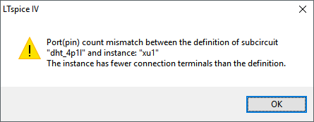

Thanks for this, but I still couldn't get it to work. I've attached the error msg I got.
I tried to make a symbol (.asy) for DHT_4P1L. I'm able to do this with the Ayumi and cogsnsnogs models, but I often can't get others to work.
This is the DHT_4P1L.asy file I made. It's probably riddled with mistakes.
* NOT WORKING - DO NOT USE
Version 4
SymbolType CELL
SYMATTR Value 4P1L-T
SYMATTR Prefix X
SYMATTR SpiceModel DHT_4P1L.inc
SYMATTR Value2 DHT_4P1L
PIN 0 -48 NONE 0
PINATTR PinName P
PIN -48 0 NONE 0
PINATTR PinName G
PIN -16 64 NONE 0
PINATTR PinName K1
PIN 16 64 NONE 8
PINATTR PinName K2
Also, on this line in the sub file,
.SUBCKT DHT_4P1L 4_A2 1 2 3 4 ; P G K1 K2
Should I move the characters "P G K1 K2" so they come right after the SYMMATR Value2 ("DHT_4P1L")?
And what is "4_A2"?
Joined 2004
Use underscore everywhere!
DHT_4P1L_4_A2 with DHT_4P1L_4_A2.asy or delete 4_A2 subfix from name for using DHT_4P1L.asy.
I generally use triodedht.asy, and manually edit (right click) component's SpiceModel attribute to actual name (in my example to DHT_801A_A2).

6F12P uTracer measurements
Earlier in the year I was sent a few 6F12P's by Bondini to measure.
For all the tubes, I found the variation to the data sheet to be considerable, for both the triode and pentode sections. Generally emission was significantly lower.
I have attached the files and sample curve matches (pentode Vg2=150V).
Note the deviation in the triode section above 10mA. Also be aware that mu had to be set to an unrealistic high value to get a good curve fit. I have not tried this in a circuit simulation.

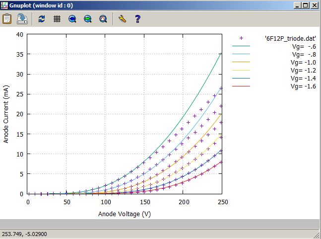

Update to 6F12P uTracer models
Apologies, I have now used a more recent version 3.0 of Derk Reefman's extractmodel which gives a better match and more realistic parameter values for the triode section (but measurements remain quite off the manufacturer's)
