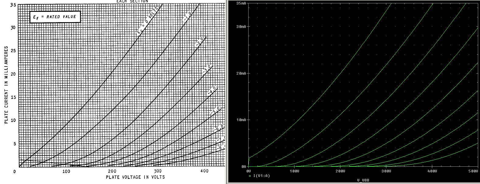

I've got a final version for the 12AT7 that I like and that seems to match pretty close to the GE datasheet. Grid current model is an exponent-modified version from Rydel/Excem as it fits better and is easier to tweak by hand than Ayumi's.
See next post.
See next post.
Here's my 12AT7(AY) using Ayumi's model as a base. Removed and tweaked statements are present but commented out. Tweaked Rydel Ig model added in the "Gg" statement.

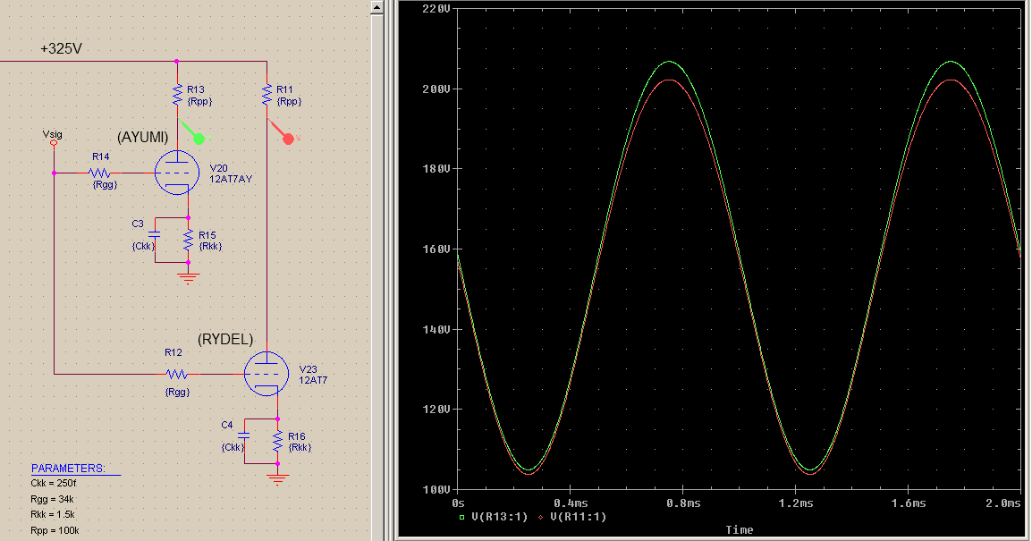

mmm...Here's my 12AT7(AY) using Ayumi's model as a base. Removed and tweaked statements are present but commented out. Tweaked Rydel Ig model added in the "Gg" statement.
check if this model can actually work in a simple common cathode gain stage, there must be some typo somewhere
Here is one test. Compared with a RYDEL 5-parameter model. The AYUMI model does not match so well at higher plate voltages, which is why the positive side is higher in amplitude than the RYDEL model. Vsig=2Vp.

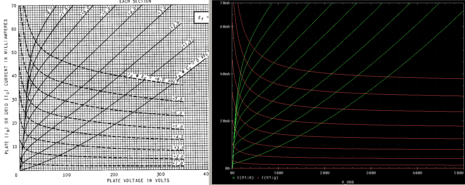

Try this. I took Ayumi's original model and tweaked a few parameters. I didn't add Rydel's grid current model, as my tweak to the parameters of Ayumi's grid model is pretty close.
My changes are in bold.
My changes/additions are in bold.

Yes, you should notice a slight change in the plate curves due to the exponent change for the plate current (1.54 from 1.50).
The biggest change is for the grid current, but you won't see that unless you run the grid current curves or you overdrive the amplifier stage. The grid current is much higher so for Vgk values greater than 0V, Ig will increase at a faster rate than the original. In real applications, this means grid limiting will be more flat or abrupt.
