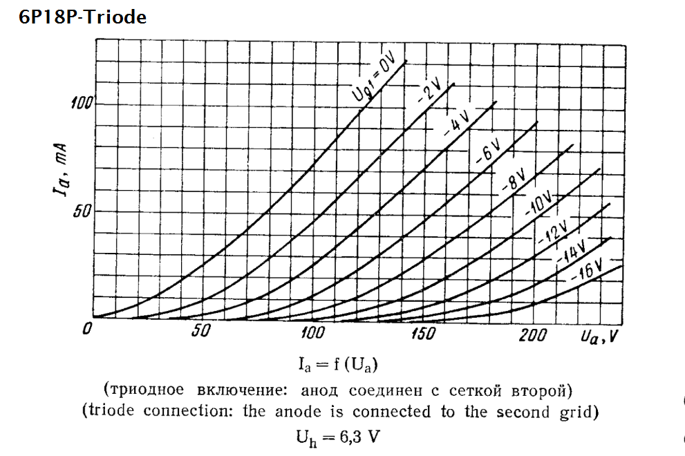

EL82 or 6P18P model?
I'm hoping for a triode model for 6P18P. I'd settle for EL82, as that is supposed to be the equivalent. I haven't been able to find either one. Maybe someone has a good model they'd like to share? If not, I wonder if I can go to the well again...
EL82 data sheet:
https://frank.pocnet.net/sheets/030/e/EL82.pdf
6P18P data sheet is attached (pdf).
Thanks!

6P18P Triode SPICE Model
Code:
* Generic triode model: 6P18P_T_AN
* Copyright 2003--2008 by Ayumi Nakabayashi, All rights reserved.
* Version 3.10, Generated on Tue Oct 25 09:10:51 2016
* Anode
* | Grid
* | | Cathode
.SUBCKT 6P18P_T_AN A G K
BGG GG 0 V=V(G,K)+0.29755965
BM1 M1 0 V=(0.05636276*(URAMP(V(A,K))+1e-10))**-1.2853515
BM2 M2 0 V=(0.53853168*(URAMP(V(GG)+URAMP(V(A,K))/8.1874685)+1e-10))**2.7853515
BP P 0 V=0.0041796459*(URAMP(V(GG)+URAMP(V(A,K))/15.203318)+1e-10)**1.5
BIK IK 0 V=U(V(GG))*V(P)+(1-U(V(GG)))*0.0034271395*V(M1)*V(M2)
BIG IG 0 V=0.0020898229*URAMP(V(G,K))**1.5*(URAMP(V(G,K))/(URAMP(V(A,K))+URAMP(V(G,K)))*1.2+0.4)
BIAK A K I=URAMP(V(IK,IG)-URAMP(V(IK,IG)-(0.0025089064*URAMP(V(A,K))**1.5)))+1e-10*V(A,K)
BIGK G K I=V(IG)
* CAPS
CGA G A 11p
CGK G K 6p
CAK A K 0.2p
.ENDS

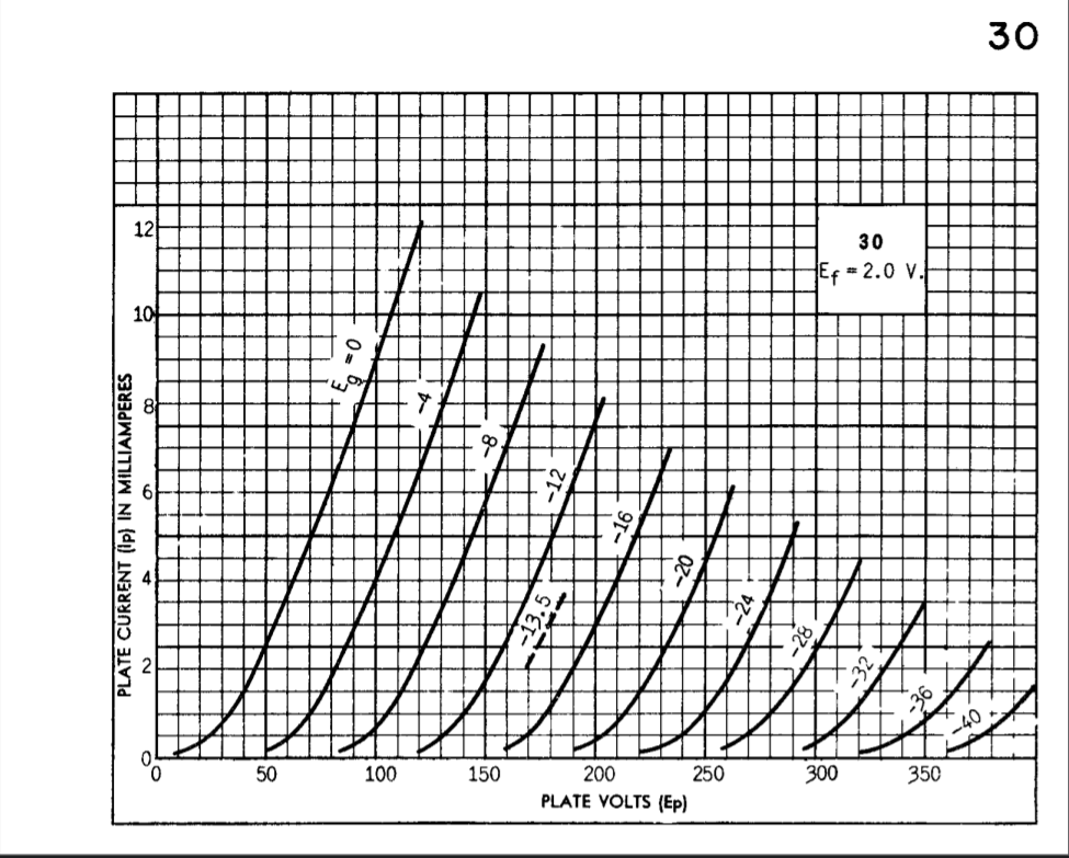

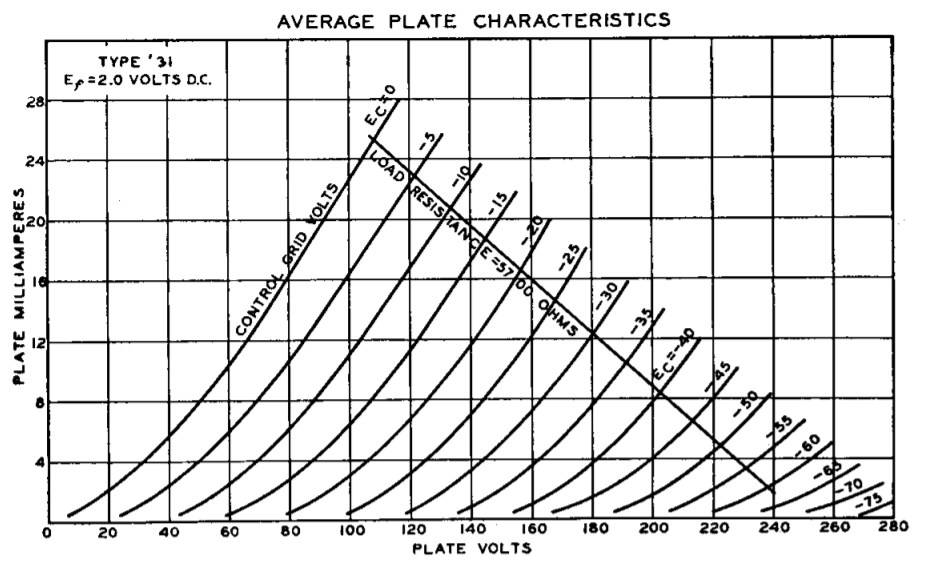

Does anyone know if there are LTspice models for DHT types 30 and 31? These are triodes meant for use with battery powered filament supplies, probably for portable radios. Might be fun to play with for audio, right?
CX-331 (Cunningham): https://frank.pocnet.net/sheets/029/3/31.pdf
RCA 31: https://frank.pocnet.net/sheets/049/3/31.pdf
CX-330 (Cunningham): https://frank.pocnet.net/sheets/029/3/30.pdf
Tung Sol 30: https://frank.pocnet.net/sheets/127/3/30.pdf

Type 30 SPICE Model
Code:
* Generic triode model: 30_AN
* Version 3.10, Generated on Wed Dec 07 06:58:37 2016
* Anode
* | Grid
* | | Cathode
.SUBCKT 30_AN A G K
BGG GG 0 V=V(G,K)+-0.99984937
BM1 M1 0 V=(0.017746886*(URAMP(V(A,K))+1e-10))**-0.27002178
BM2 M2 0 V=(0.8474472*(URAMP(V(GG)+URAMP(V(A,K))/8.5960321)+1e-10))**1.7700218
BP P 0 V=0.00034871006*(URAMP(V(GG)+URAMP(V(A,K))/10.143443)+1e-10)**1.5
BIK IK 0 V=U(V(GG))*V(P)+(1-U(V(GG)))*0.0002194731*V(M1)*V(M2)
BIG IG 0 V=0.00017435503*URAMP(V(G,K))**1.5*(URAMP(V(G,K))/(URAMP(V(A,K))+URAMP(V(G,K)))*1.2+0.4)
BIAK A K I=URAMP(V(IK,IG)-URAMP(V(IK,IG)-(0.00022717265*URAMP(V(A,K))**1.5)))+1e-10*V(A,K)
BIGK G K I=V(IG)
* CAPS
CGA G A 5.7p
CGK G K 3.5p
CAK A K 2.7p
.ENDS
Type 31 SPICE Model
Code:
* Generic triode model: 31_AN
* Version 3.10, Generated on Wed Dec 07 06:58:58 2016
* Anode
* | Grid
* | | Cathode
.SUBCKT 31_AN A G K
BGG GG 0 V=V(G,K)+0.40965691
BM1 M1 0 V=(0.039301583*(URAMP(V(A,K))+1e-10))**-0.23955032
BM2 M2 0 V=(0.86229182*(URAMP(V(GG)+URAMP(V(A,K))/3.5038839)+1e-10))**1.7395503
BP P 0 V=0.00018231552*(URAMP(V(GG)+URAMP(V(A,K))/4.0634549)+1e-10)**1.5
BIK IK 0 V=U(V(GG))*V(P)+(1-U(V(GG)))*0.00011748305*V(M1)*V(M2)
BIG IG 0 V=9.1157759e-05*URAMP(V(G,K))**1.5*(URAMP(V(G,K))/(URAMP(V(A,K))+URAMP(V(G,K)))*1.2+0.4)
BIAK A K I=URAMP(V(IK,IG)-URAMP(V(IK,IG)-(0.0001624432*URAMP(V(A,K))**1.5)))+1e-10*V(A,K)
BIGK G K I=V(IG)
* CAPS
CGA G A 5.7p
CGK G K 3.5p
CAK A K 2.7p
.ENDS
