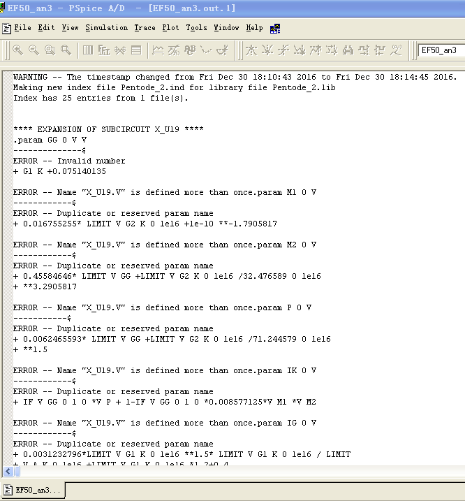

Dear jazbo8,
I am using the PSpice 8.0(student version),the library like as this format then working
.SUBCKT EL34 1 2 3 4 ; P G1 C G2;
+ PARAMS: MU=11 EX=1.32 KG1=650 KG2=4200 KP=60 KVB=28
+ CCG=14P CPG1=.85P CCP=12P RGI=1k
RE1 7 0 1MEG ...............
thx!

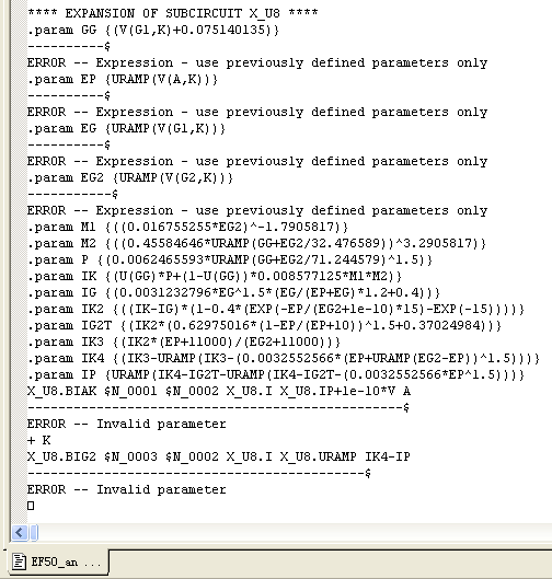

EF50 PSpice Model
Code:
* Generic pentode model: EF50_AN
* Copyright 2003--2008 by Ayumi Nakabayashi, All rights reserved.
* Version 3.10, Generated on Tue Jul 15 13:48:26 2014
* Plate
* | Screen Grid
* | | Control Grid
* | | | Cathode
.SUBCKT EF50_AN A G2 G1 K
.param GG {(V(G1,K)+0.075140135)}
.param EP {URAMP(V(A,K))}
.param EG {URAMP(V(G1,K))}
.param EG2 {URAMP(V(G2,K))}
.param M1 {((0.016755255*EG2)^-1.7905817)}
.param M2 {((0.45584646*URAMP(GG+EG2/32.476589))^3.2905817)}
.param P {(0.0062465593*URAMP(GG+EG2/71.244579)^1.5)}
.param IK {(U(GG)*P+(1-U(GG))*0.008577125*M1*M2)}
.param IG {(0.0031232796*EG^1.5*(EG/(EP+EG)*1.2+0.4))}
.param IK2 {((IK-IG)*(1-0.4*(EXP(-EP/(EG2+1e-10)*15)-EXP(-15))))}
.param IG2T {(IK2*(0.62975016*(1-EP/(EP+10))^1.5+0.37024984))}
.param IK3 {(IK2*(EP+11000)/(EG2+11000))}
.param IK4 {(IK3-URAMP(IK3-(0.0032552566*(EP+URAMP(EG2-EP))^1.5)))}
.param IP {URAMP(IK4-IG2T-URAMP(IK4-IG2T-(0.0032552566*EP^1.5)))}
BIAK A K I=IP+1e-10*V(A,K)
BIG2 G2 K I=URAMP(IK4-IP)
BIGK G1 K I=IG
* CAPS
CGA G1 A 0.003p
CGK G1 K 6p
C12 G1 G2 4p
CAK A K 5.3p
.ENDS
This should work in PSpice:

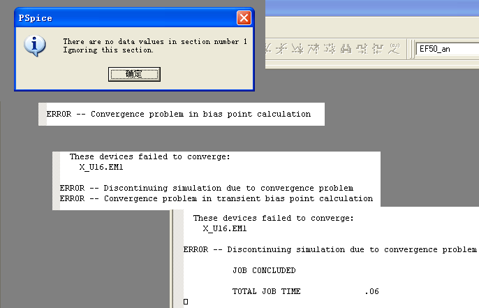

Dear cogsncogs, Thanks for your support, the lib still shown the errors as below
Try this one, we will get it eventually...
Code:
* Plate
* | Screen Grid
* | | Control Grid
* | | | Cathode
.param GG 0 V=V(G1,K)+0.075140135
.param M1 0 V=(0.016755255*(LIMIT(V(G2,K),0,1e16)+1e-10))**-1.7905817
.param M2 0 V=(0.45584646*(LIMIT(V(GG)+LIMIT(V(G2,K),0,1e16)/32.476589,0,1e16)))**3.2905817
.param P 0 V=0.0062465593*(LIMIT(V(GG)+LIMIT(V(G2,K),0,1e16)/71.244579,0,1e16))**1.5
.param IK 0 V=IF(V(GG)>0,1,0)*V(P)+(1-IF(V(GG)>0,1,0))*0.008577125*V(M1)*V(M2)
.param IG 0 V=0.0031232796*LIMIT(V(G1,K),0,1e16)**1.5*(LIMIT(V(G1,K),0,1e16)/(LIMIT(V(A,K),0,1e16)+LIMIT(V(G1,K),0,1e16))*1.2+0.4)
.param IK2 0 V=V(IK,IG)*(1-0.4*(EXP(-LIMIT(V(A,K),0,1e16)/LIMIT(V(G2,K),0,1e16)*15)-EXP(-15)))
.param IG2T 0 V=V(IK2)*(0.62975016*(1-LIMIT(V(A,K),0,1e16)/(LIMIT(V(A,K),0,1e16)+10))**1.5+0.37024984)
.param IK3 0 V=V(IK2)*(LIMIT(V(A,K),0,1e16)+11000)/(LIMIT(V(G2,K),0,1e16)+11000)
.param IK4 0 V=V(IK3)-LIMIT(V(IK3)-(0.0032552566*(LIMIT(V(A,K),0,1e16)+LIMIT(V(G2,K),0,1e16)-LIMIT(V(A,K),0,1e16))**1.5),0,1e16)
.param IP 0 V=LIMIT(V(IK4,IG2T)-LIMIT(V(IK4,IG2T)-(0.0032552566*LIMIT(V(A,K),0,1e16)**1.5),0,1e16),0,1e16)
BIAK A K I=V(IP)+1e-10*V(A,K)
BIG2 G2 K I=LIMIT(V(IK4,IP),0,1e16)
BIGK G1 K I=V(IG)
* CAPS
CGA G1 A 0.003p
CGK G1 K 6p
C12 G1 G2 4p
CAK A K 5.3p
.ENDS
May be a floating point error...
In the model I posted (post 1276) try replacing this line:
with this to see if it will converge:
Code:
EM1 M1 0 VALUE={(0.016755255*(LIMIT(V(G2,K),0,1e16)+1e-10))**-1.7905817}
Code:
EM1 M1 0 VALUE={(0.016755255*(LIMIT(V(G2,K),0,1e16)+1e-03))**-1.7905817}
