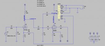

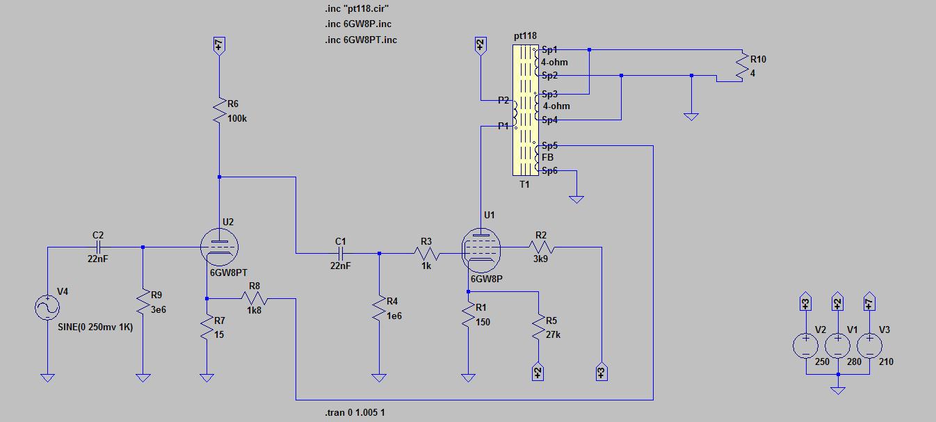

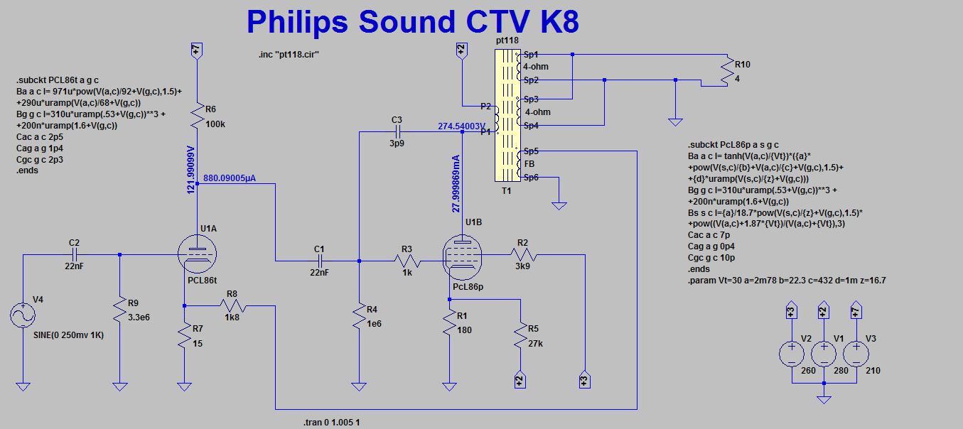

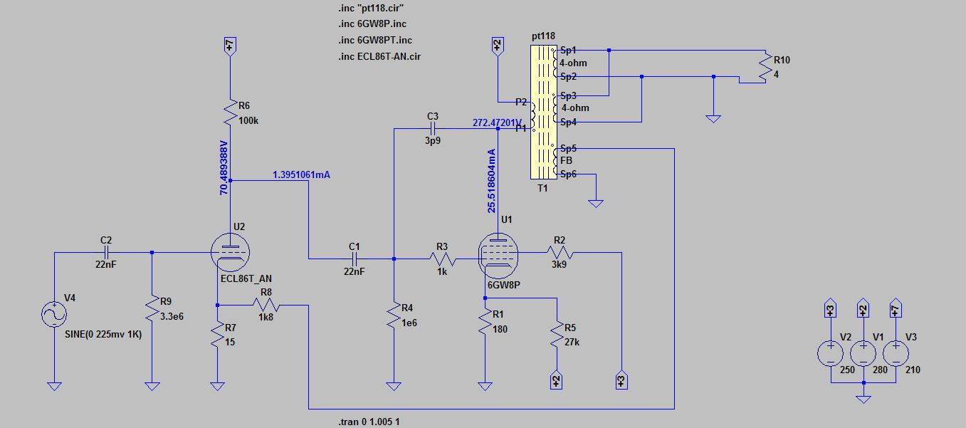

I tried the triode model provided by jazbo8 however the anode voltage is very low phlilips has it on 120 volt is this a mistake in the philips drawing or is the model not oke
I think you are confusing the triode section of this tube with the pentode section strapped for triode operation. The two are not the same, and I think you are trying to use the triode strapped pentode model where you should be using the triode section model.
Try the attached triode section model: file 6GW8T.txt (rename to 6GW8T.inc), and match the name of the first triode (6GW8T). When I run the simulation, I get about 70.5 volts at the plate of the first triode.

Yes i got the same with the model from jazbo8

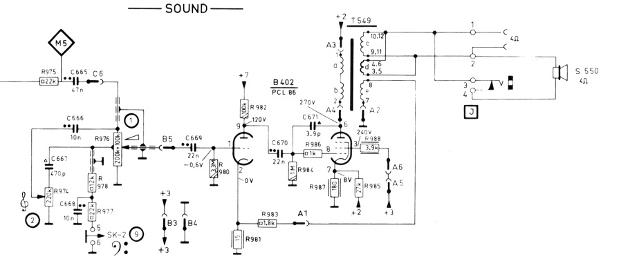

But philips says in the drawing that the plate is about 120 Volts

I simulated a set of plate curves for this model and they compare quite well to the published curves for the triode section of this tube (see attached data sheet).
Plotting a manual load line also shows close agreement with the simulated results. I believe the problem is the cathode resistor R7. Are you sure this is supposed to be 15 ohms? That small value provides very little (negative) bias for the tube (only about 20 mV). A cathode resistor of 1.5k produces a much more normal operating point for this tube. With R7 = 1.5k, the tube operates with 117.8 volts on the plate at 920 uA, with a (negative) grid bias of 760 mV. With these values, I get a good clean output signal up to 4 volts peak (2 watts into 4 ohms). Of course, if you want more closed loop gain then you will also need to increase the value of feedback resistor R8.

Yes, I saw that. Just commenting that the triode section model looks like a good match to the published plate curves, and a manual paper load line will give results similar to the simulation with the components indicated. I can't explain how to get 120 volts at the plate with this circuit; maybe someone else can.
Good very wel be that philips made a mistake here i can't control this i don,t have the TV anymore

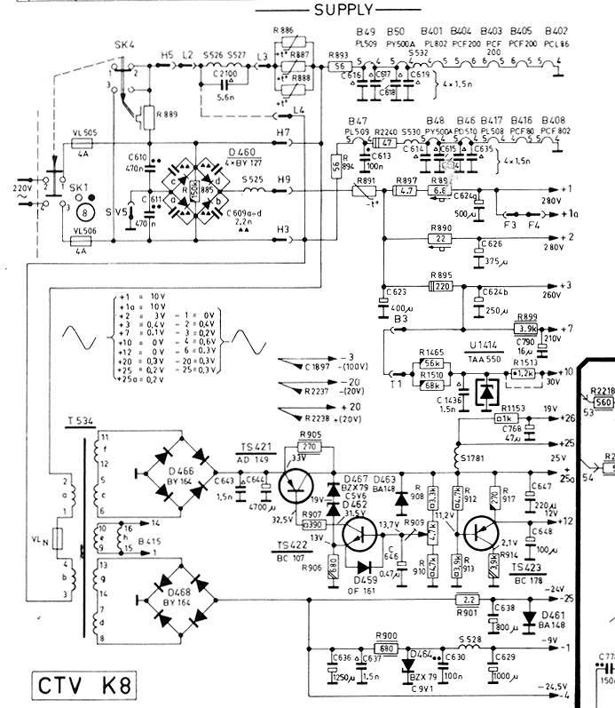

There is nothing wrong with Philip's schematic, except the B+ voltages are wrong, the +2, +3, +7 most likely refer to nodes on the power supply and not the actual voltages. In any case, the Ayumi triode section model for the ECL86 does not do a good job of modeling the reverse grid current, which is needed for the grid leak bias used in the Philips schematic, to do so, you need to get or build a model that does. So for this particular circuit, the Ayumi model should not be used.
My bad, missed the notations on the asc file... anyway, you need to find a triode model that has an accurate grid current code.the voltages i got indeed from the schematic
Thanks for that insight. I guess I was stuck on the idea that the input stage was intended to work like a typical common cathode gain stage with cathode bias. This makes sense now, although I personally wouldn't approach the design that way.
