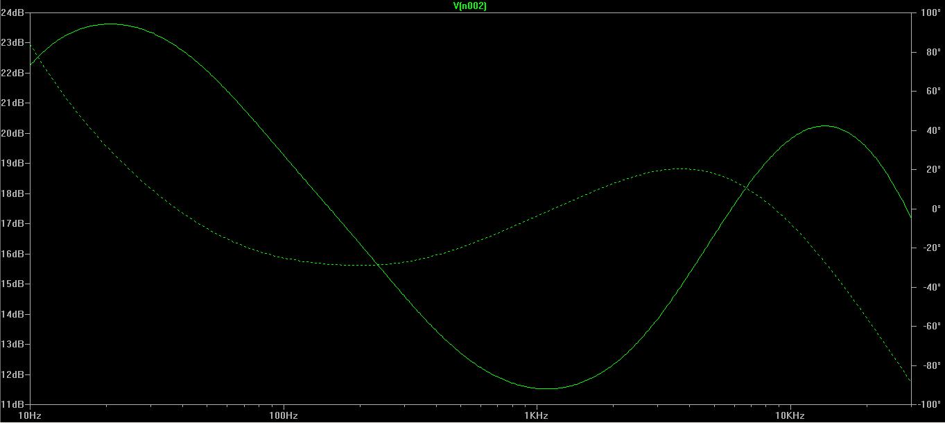

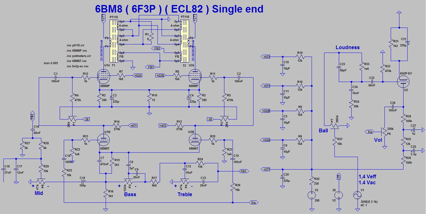

Yess i did
  • ecl82-single-end-project-005.zip
