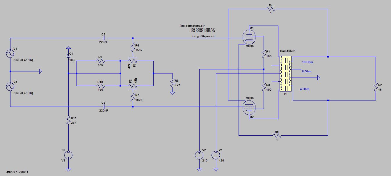

I just lookt at the model i have it seems that i forgot to change one of the ^ to ** my bad
Now it's workin
Code:
* Generic pentode model: GU50_AN

It work's

jazbo,
I looked at the LTspice schematic and see that there are two version of the GU50 pentode model. I assume the one with the underscore (GU50_P) is for LTspice and the other one (GU50P) is for another simulator. If this is correct, can you provide an LTspice model for the triode-connected GU50? The GU50T model appears to be for the "other" simulator.
Thanks.

If you mean the file uploaded by RajkoM, then yes, you should discard all of the Ayumi models in that file, as none of them is considered accurate. I made a new triode-strapped model for the GU50 as follows:

I will try to make a new one for the pentode when I get a chance.
