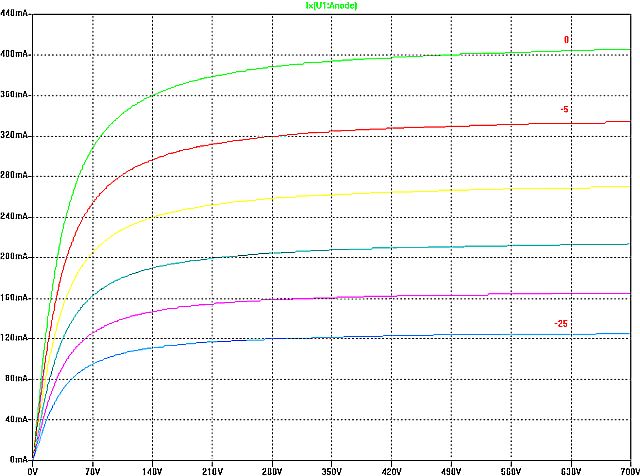

LS50 curves from post 617 🙂
Curves by Matejs model (from -5 to -25 V) looks good.

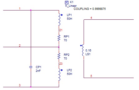

What primary inductance do you usually have with simulations ?
The permeability of the transformer core is increased when the voltage accross the primary is increased. This change can be some 4..5 times when the voltage varies from 5 V to 200 V.

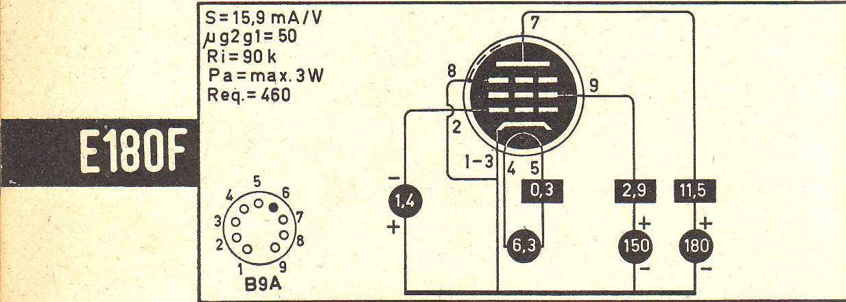

E180F SPICE Model
Yes i alreddy a'm using that one
now for somthing else i tried to find the model voor the E180F ( 6J9P ) if it is posted on what page can i find it
Here you go:

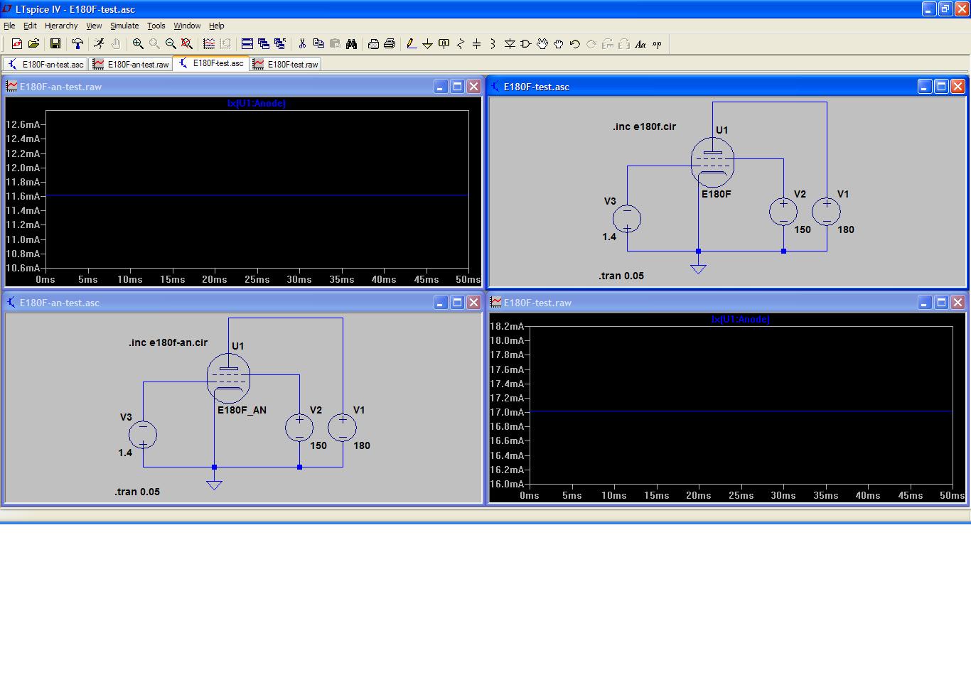

I have this one:
.SUBCKT E180F 1 4 2 3
+ PARAMS: MU= 56.00 EX= 1.350 KG1= 250.0 KP=6709.19 KC= 850
+ KVB= 7.9 VCT= 0.00 RGI=2k
+ CCG=8.5P CPG1=0.03P CCP=3P
RE1 7 0 1G
RE2 8 3 1G
E1 7 0 VALUE= ; E1 BREAKS UP LONG EQUATION FOR G1.
+{V(4,3)/KP*LOG(1+EXP((1/MU+V(2,3)/V(4,3))*KP))}
G1 1 3 VALUE={(PWR(V(7),EX)+PWRS(V(7),EX))/KG1*ATAN(V(1,3)/KVB)}
G2 8 3 VALUE={(PWR(V(7),EX)+PWRS(V(7),EX))/KC*(2.5708-ATAN(V(1,3)/KVB))}
E2 8 4 VALUE={0}
RCP 1 3 1G ; FOR CONVERGENCE
C1 2 3 {CCG} ; CATHODE-GRID 1
C2 1 2 {CPG1} ; GRID 1-PLATE
C3 1 3 {CCP} ; CATHODE-PLATE
R1 2 5 {RGI} ; FOR GRID CURRENT
D3 5 3 DX ; FOR GRID CURRENT
.MODEL DX D(IS=1N RS=1 CJO=10PF TT=1N)
.ENDS
Please check which one is better.
When available, the L's are based on the data provided by the manufacturers, else, they are based on the measurements e.g., as shown by Yves M. and others.
Some manufacturers provide the primary inductance (obviously) based on on the "old" test procedure (5 Vrms/50Hz), some, like Edcor does not provide this info at all and some. like Amplimo gives the "maximum" value, whic refers to some 200 Vrms tets voltage.
The primary inductance value can vary from, say 25 H to 125 H depending on the test voltage.
As an example, I measured the Lp of Indel TGL40/001, which is a OPT I have used a lot.
The results with different test voltage (50 Hz):
1Vrms......6.8 H
5 -"- .......9.4 H
50 -"-..... 23 H
100 -"- ....32 H
200 Vrms...43 H
When simulating, the results with 6.8 H and 43 H are very, very different.
So, this is not that simple matter.
