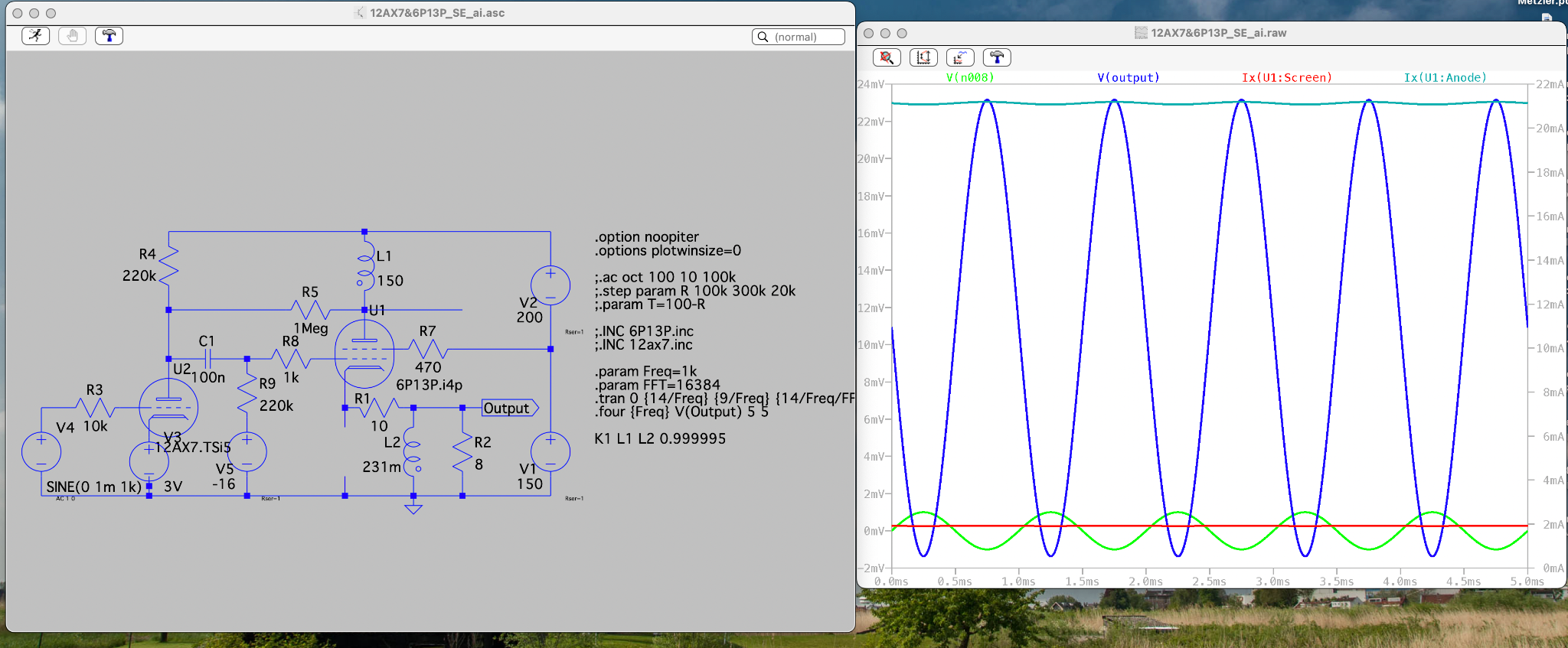

Hi Zintolo
Thanks for your .asc file. I just gave it a spin, and it worked fine after the following mods:
1) I had to replace the LED by a 3V voltage source, because I don't have the spice model of your LED (BTW: Qspice makes the boring "don't have your spice model" problem obsolete - I love Qspice!!)
2) Same for the 12AX7 - Replaced it another one
3) I blanked out your "INC 6P13P.inc" command, and instead took the 6P13P spice model from #2672
So, perhaps it is worth to freshly integrate the model from #2672 into your sim?
BR Adrian

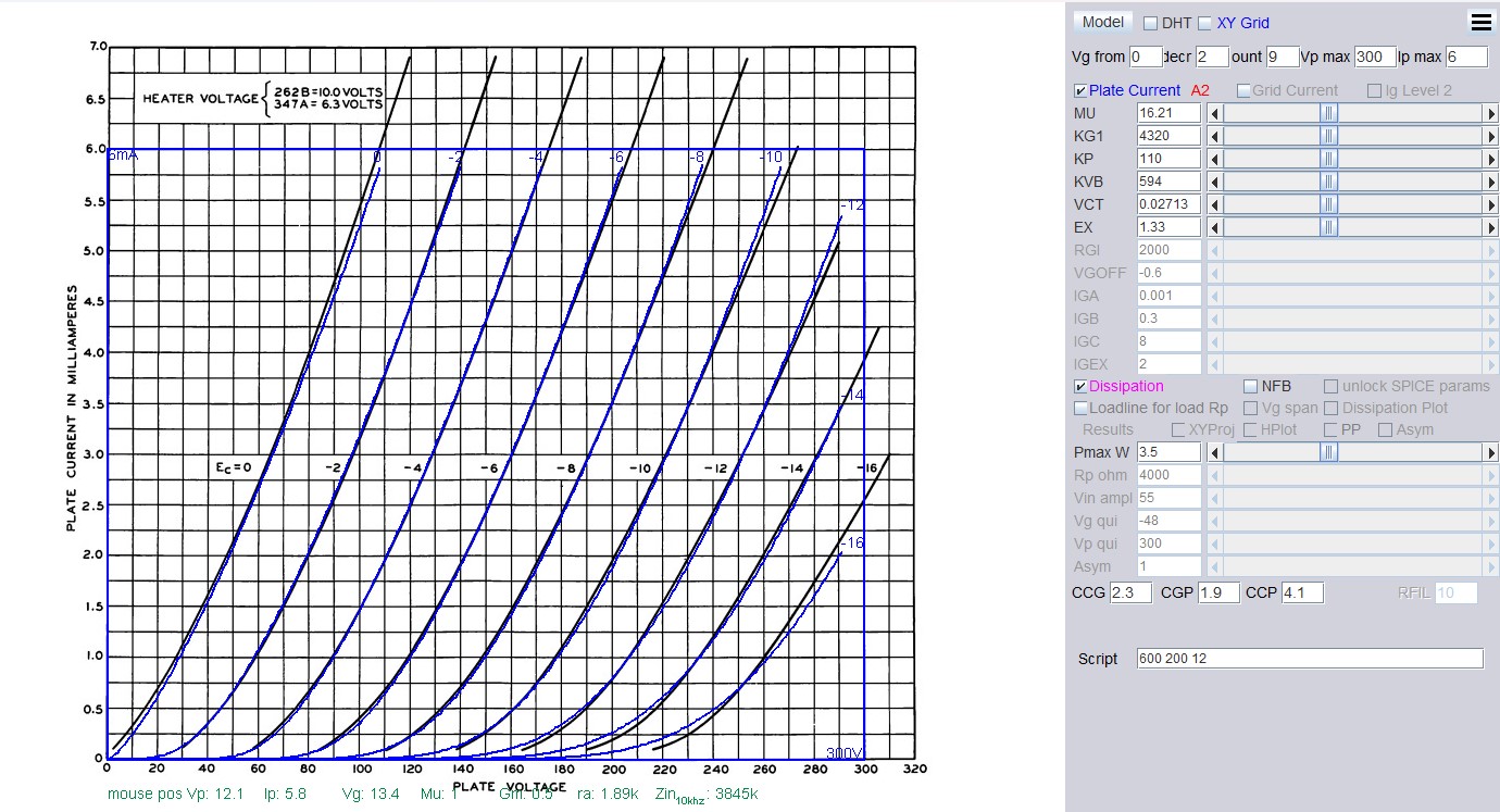

347A SPICE Models
Code:
**** 347A ******************************************
* Created on 11/08/2024 16:50 using paint_kit.jar 3.1
* www.dmitrynizh.com/tubeparams_image.htm

.SUBCKT TRIODE_347A 1 2 3 ; Plate Grid Cathode
+ PARAMS: CCG=2.3P  CGP=1.9P CCP=4.1P RGI=2000
+ MU=16.21 KG1=4320 KP=110 KVB=594 VCT=0.02713 EX=1.33
* Vp_MAX=300 Ip_MAX=6 Vg_step=2 Vg_start=0 Vg_count=9
* Rp=4000 Vg_ac=55 P_max=3.5 Vg_qui=-48 Vp_qui=300
* X_MIN=113 Y_MIN=135 X_SIZE=696 Y_SIZE=562 FSZ_X=1410 FSZ_Y=791 XYGrid=false

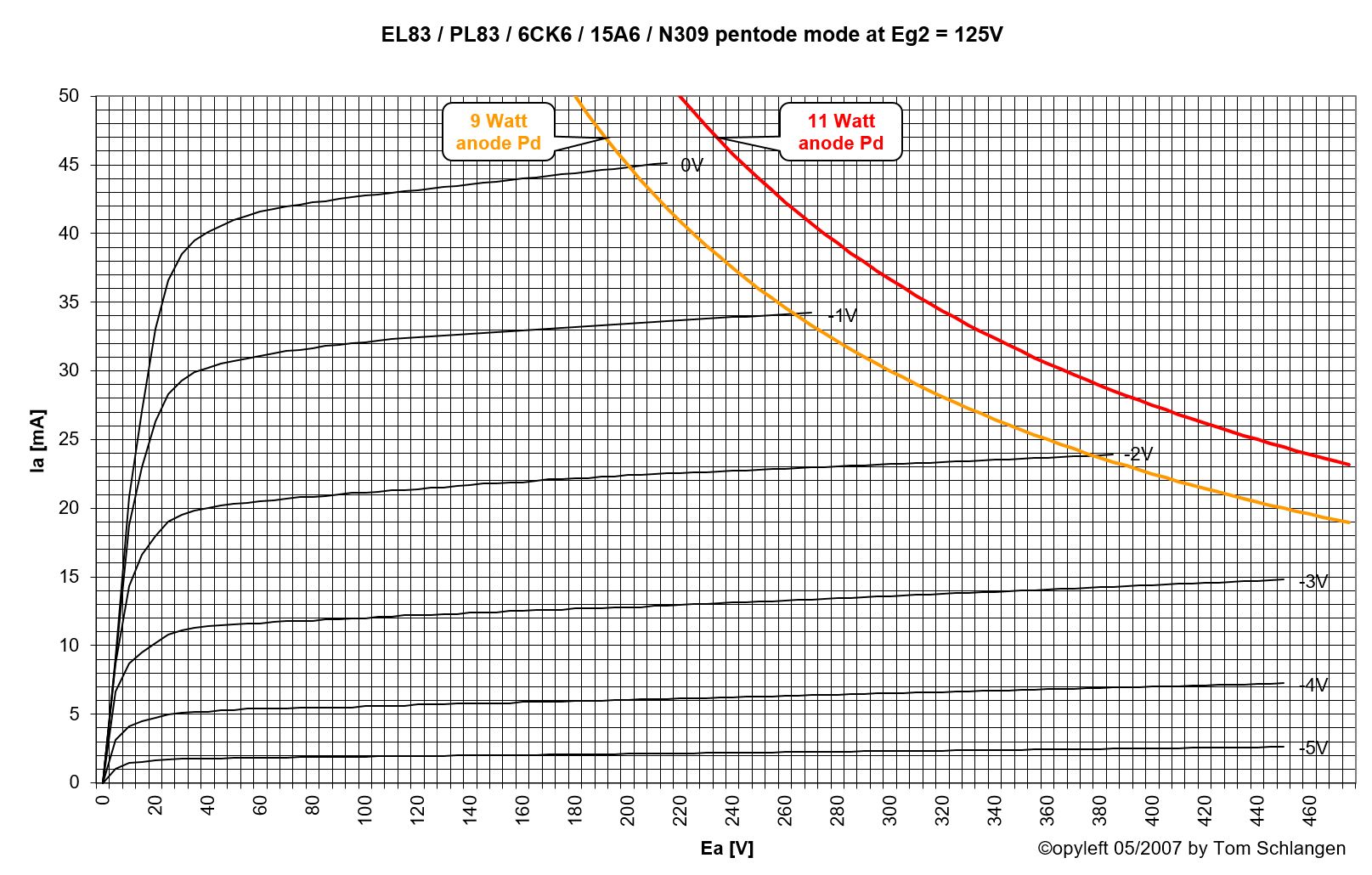

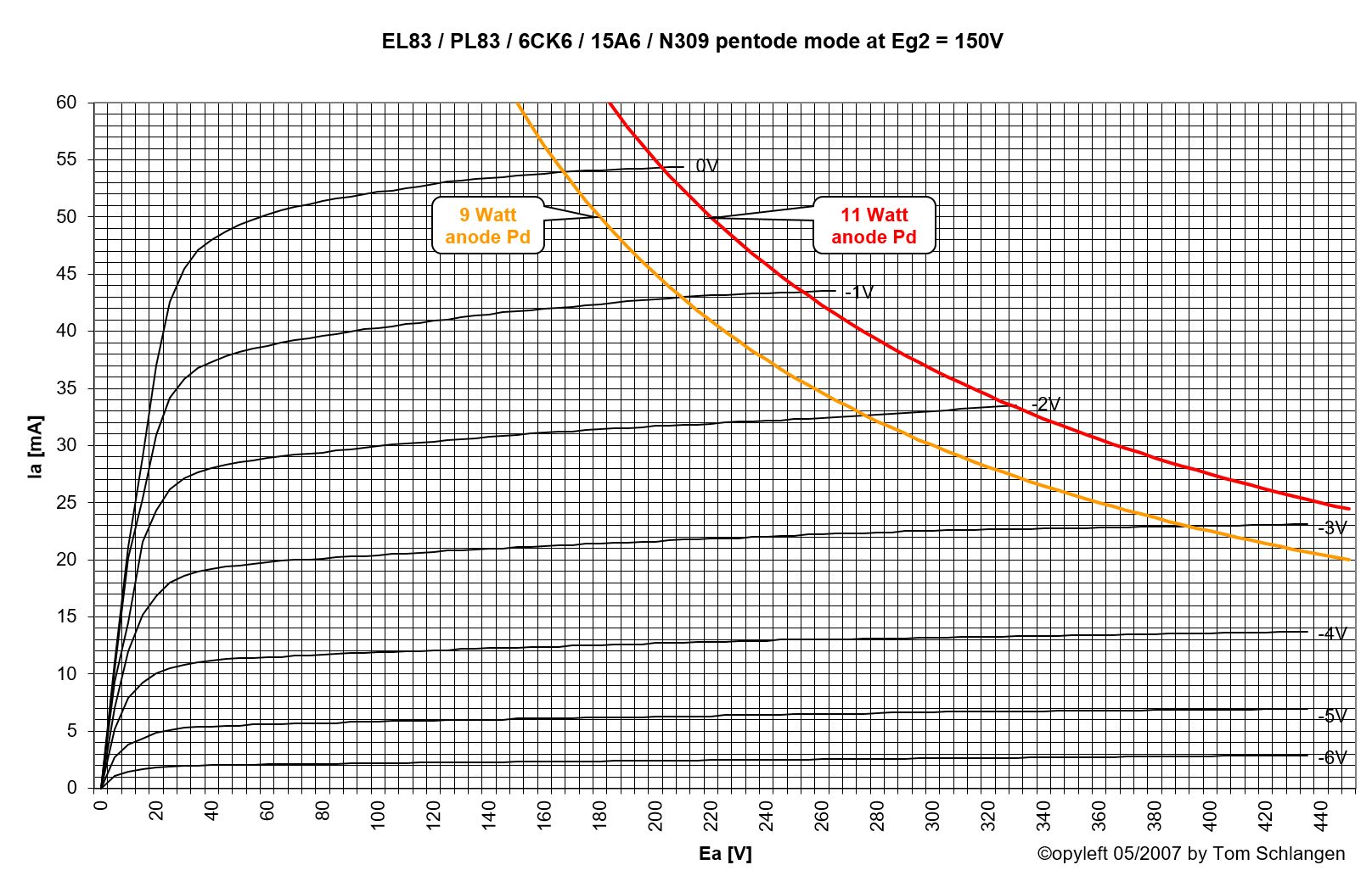

EL83 / PL83 / 6CK6 / 15A6 / N309 LTSpice models request
Gentlemen,
I would like to draw your attention to type EL83 / PL83 / 6CK6 / 15A6 / N309 (there also are at least two Russian substitution types). Unfortunally I can´t find any LTSpice models for it.
This is a very linear and sensitive video wideband amplifier used in millions of European TV sets. Especially its 300 mA series heater version PL83 / 15A6 still can be found plentiful and cheap in Europe. Quite some datasheets can be found @ frank.pocnet.net
Please note that this valve was made both as a true pentode and as beam power tetrode, the later version being much more common. For practical purposes they are interchangeable, but the plots are noticably different at low anode voltages (see the Marconi N309 sheet for true pentode curves).
In most datasheets, plots for the BPT type can be found, usually given for Eg2 = 170, 200 and 220 Volts. To give the community something back I also attached my own plots at Eg2 = 125V and 150V.
A triode strapped plot can be found in the Marconi N309 data sheet.
Besides using it as a final stage audio output tube, please note that this valve makes an extremely capable and linear pentode driver for much bigger output tubes, see load line example attached.
I would be happy if somebody could supply LTSpice models for the (much more common) BPT type and also in triode strapped operation
Thank you very much!
Tom
