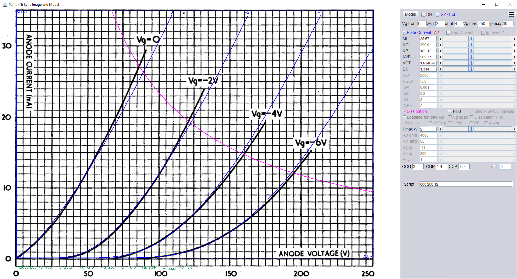

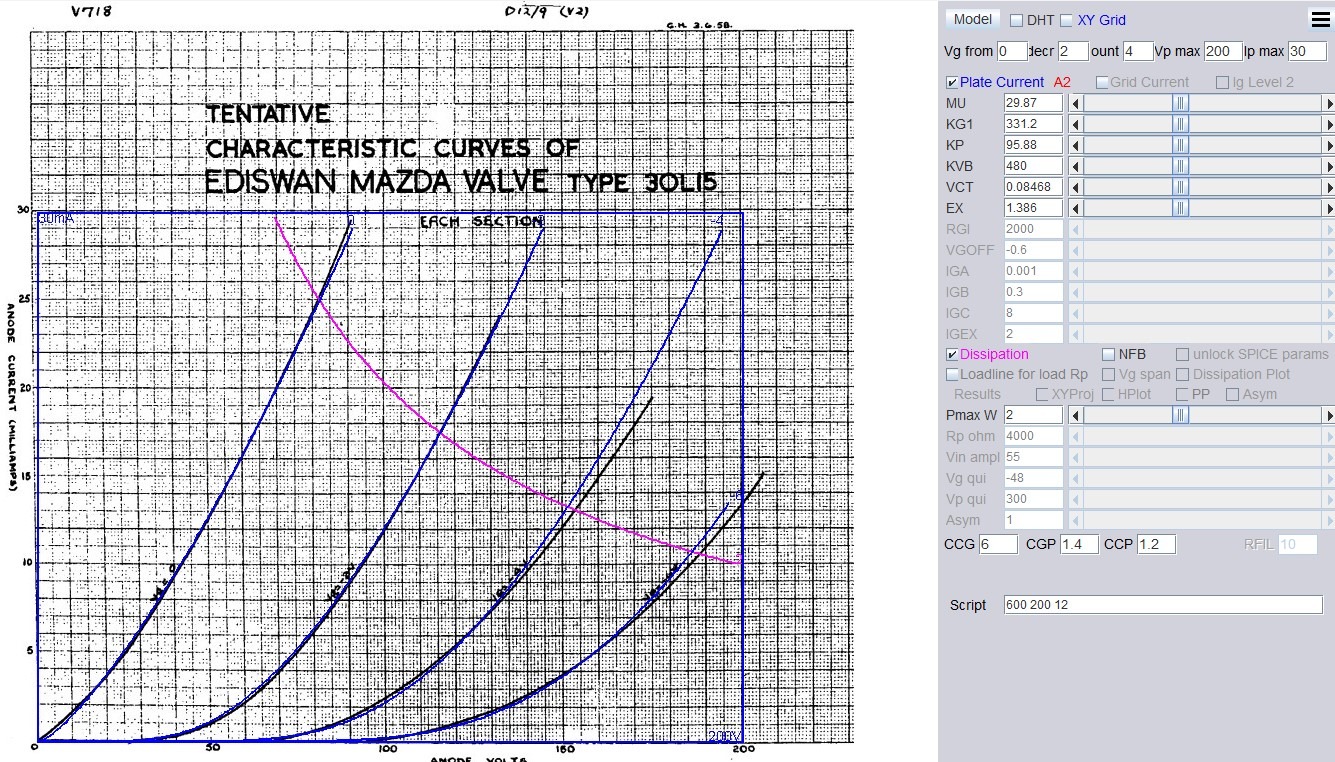

7EK7(30L15) SPICE Models.
Code:
**** 7EK7 ******************************************
* Created on 09/26/2024 17:18 using paint_kit.jar 3.1
* www.dmitrynizh.com/tubeparams_image.htm
* Plate Curves image file: 7EK7.jpg
* Data source link:
.SUBCKT TRIODE_7EK7 1 2 3 ; Plate Grid Cathode
+ PARAMS: CCG=6P CGP=1.4P CCP=1.2P RGI=2000
+ MU=29.87 KG1=331.2 KP=95.88 KVB=480 VCT=0.08468 EX=1.386
* Vp_MAX=200 Ip_MAX=30 Vg_step=2 Vg_start=0 Vg_count=4
* Rp=4000 Vg_ac=55 P_max=2 Vg_qui=-48 Vp_qui=300
* X_MIN=41 Y_MIN=212 X_SIZE=705 Y_SIZE=529 FSZ_X=1357 FSZ_Y=805 XYGrid=false
* showLoadLine=n showIp=y isDHT=n isPP=n isAsymPP=n showDissipLimit=y
* showIg1=n gridLevel2=n isInputSnapped=n
* XYProjections=n harmonicPlot=n dissipPlot=n
E1 7 0 VALUE={V(1,3)/KP*LOG(1+EXP(KP*(1/MU+(VCT+V(2,3))/SQRT(KVB+V(1,3)*V(1,3)))))}
RE1 7 0 1G ; TO AVOID FLOATING NODES
G1 1 3 VALUE={(PWR(V(7),EX)+PWRS(V(7),EX))/KG1}
RCP 1 3 1G ; TO AVOID FLOATING NODES
C1 2 3 {CCG} ; CATHODE-GRID
C2 2 1 {CGP} ; GRID=PLATE
C3 1 3 {CCP} ; CATHODE-PLATE
D3 5 3 DX ; POSITIVE GRID CURRENT
R1 2 5 {RGI} ; POSITIVE GRID CURRENT
.MODEL DX D(IS=1N RS=1 CJO=10PF TT=1N)
.ENDS

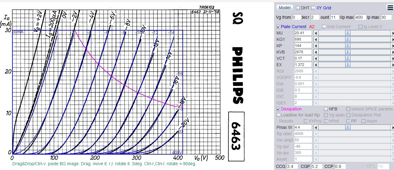

6463 SPICE Models.
Code:
**** 6463 ******************************************
* Created on 09/27/2024 10:23 using paint_kit.jar 3.1
* Plate Curves image file: 6463.jpg
* Data source link:
.SUBCKT TRIODE_6463 1 2 3 ; Plate Grid Cathode
+ PARAMS: CCG=3.4P CGP=5.2P CCP=0.8P RGI=2000
+ MU=20.41 KG1=690 KP=144 KVB=2676 VCT=0.17 EX=1.372
* Vp_MAX=400 Ip_MAX=30 Vg_step=2 Vg_start=0 Vg_count=11
* Rp=4000 Vg_ac=55 P_max=4.4 Vg_qui=-48 Vp_qui=300
* X_MIN=45 Y_MIN=93 X_SIZE=561 Y_SIZE=410 FSZ_X=1323 FSZ_Y=600 XYGrid=false
.ENDS
