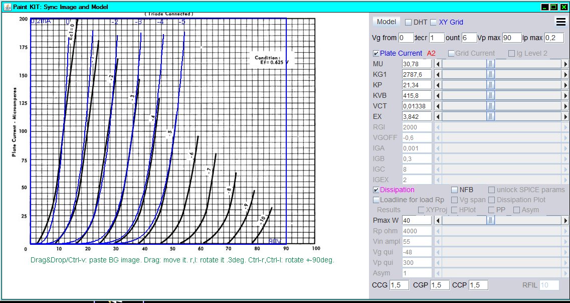

The CK6419 that I am interested in modeling uses a combined heater/cathode configuration.
Does anyone know of any previous efforts to model such a structure that includes this sort of structure?

You picked the maybe most unsuitable - or at least most uncomfortable - candidate for a curve fitting exercise.
It took me quite some time and labor to come up with anything usable.
I get a somewhat decent fit between -1V and -5V Vg1 but beyond that ... no way ...
It seems that the mu is quite variable over the range especially towards higher negative Vg.
It is strange anyhow why they show a triode plot up to 90V when they say that max V is 25V in the first place.
Also, the Raytheon DS does not give electrode capacitances; I took arbitrary numbers from a similar DF96 tube.
Anyway ... here's my best effort, mediocre at best though ... give it a try.

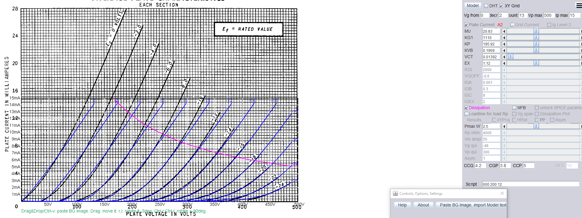

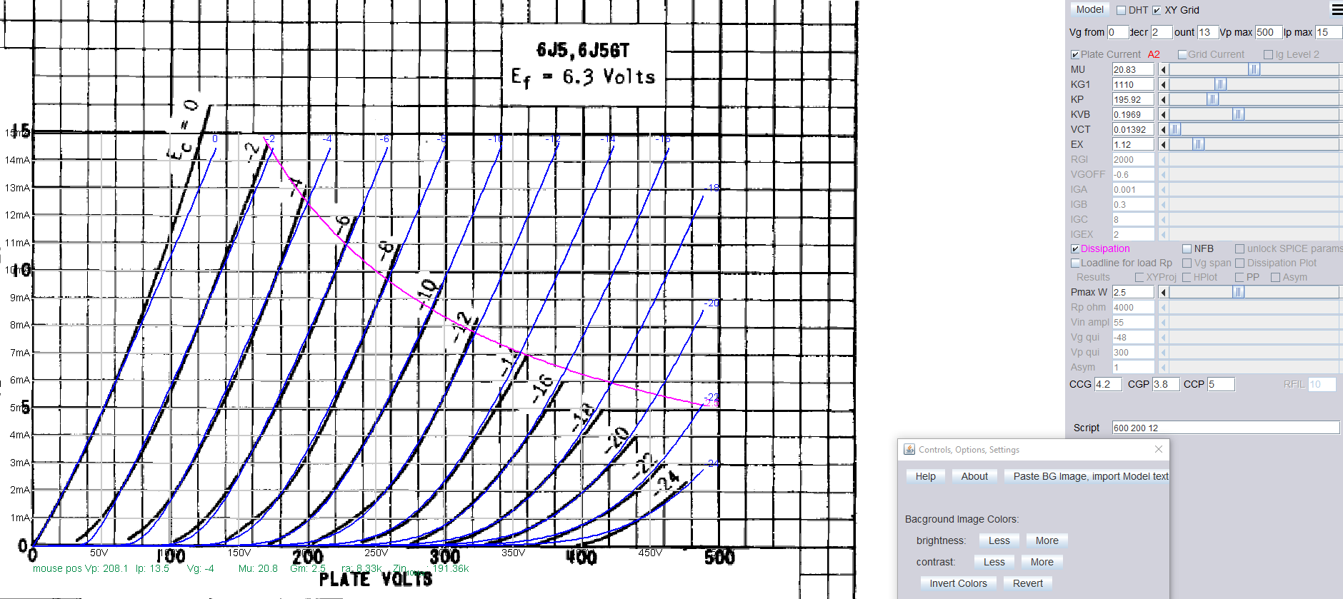

I was able to download and install the curve mapping tool.
Attached is my fit to the 6j5GT curves which I do not believe is too bad; especially, if I stick to currents below 5mA.
For comparative purposes I pushed the curves for a 6SN7GTB under the same fit and the result is also attached.
The scale difference makes the qualitative comparison of the goodness of the fit a bit tricky, but I would surmise that it is still reasonable and that using a 6SN7GT model to simulate a 6J5GT is viable per the link you pointed to.

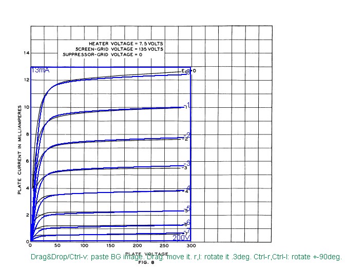

328A SPICE Models.

**** 328A ******************************************
* Created on 10/17/2024 19:30 using paint_kip.jar
* www.dmitrynizh.com/tubeparams_image.htm
* Plate Curves image file: 328A.jpg
* Data source link: <plate curves URL>
.SUBCKT 328A P G2 G K ; LTSpice tetrode.asy pinout
* .SUBCKT 328A P G K G2 ; Koren Pentode Pspice pinout
+ PARAMS: MU=21.7 KG1=2970 KP=133.64 KVB=12 VCT=0.2 EX=1.316 KG2=4200 KNEE=2.76 KVC=2.57
+ KLAM=9.8E-7 KLAMG=5.325E-5 KNEE2=9.2 KNEX=2.7  KNK=-0.044 KNG=0.006
+ CCG=1.3P CGP=6.5P CCP=3.2P RGI=2000.0
* Vp_MAX=200 Ip_MAX=13 Vg_step=1 Vg_start=0 Vg_count=8
* X_MIN=67 Y_MIN=132 X_SIZE=311 Y_SIZE=338 FSZ_X=1183 FSZ_Y=778 XYGrid=false
* Rp=1400 Vg_ac=20 P_max=25 Vg_qui=-3.5 Vp_qui=300
* showLoadLine=n showIp=y isDHP=n isPP=n isAsymPP=n isUL=n showDissipLimit=n
* showIg1=n isInputSnapped=y addLocalNFB=n
* XYProjections=n harmonicPlot=y dissipPlot=n
* UL=0.43 EG2=135 gridLevel2=n addKink=n isTanhKnee=y advSigmoid=n
RE1  7 0  1G    ; DUMMY SO NODE 7 HAS 2 CONNECTIONS
E1   7 0  VALUE=  ; E1 BREAKS UP LONG EQUATION FOR G1.
+{V(G2,K)/KP*LOG(1+EXP((1/MU+(VCT+V(G,K))/SQRT(KVB+V(G2,K)*V(G2,K)))*KP))}
RE2  6 0  1G    ; DUMMY SO NODE 6 HAS 2 CONNECTIONS
E2  6 0  VALUE={(PWR(V(7),EX)+PWRS(V(7),EX))} ; Kg1 times KIT current
G1   P K  VALUE={V(6)/KG1*ATAN((V(P,K)+KNEX)/KNEE)*TANH(V(P,K)/KNEE2)*(1+KLAMG*V(P,K))+KLAM*V(P,K)}
* Alexander Gurskii screen current, see audioXpress 2/2011
RE4K 4K K 1G ; Dummy, per Alex request
E4K 4K  4 VALUE={0} ; Dummy, per Alex request
G4K 4K K VALUE={V(6)/KG2*(KVC-ATAN((V(P,K)+KNEX)/KNEE)*TANH(V(P,K)/KNEE2))/(1+KLAMG*V(P,K))}
RCP  P K  1G     ; FOR CONVERGENCE
C1   K G  {CCG}  ; CATHODE-GRID 1
C2   G P  {CGP}  ; GRID 1-PLATE
C3   K P  {CCP}  ; CATHODE-PLATE
R1   G 5  {RGI}  ; FOR GRID CURRENT
D3   5 K  DX     ; FOR GRID CURRENT }
.MODEL DX D(IS=1N RS=1 CJO=10PF TT=1N)
.ENDS
