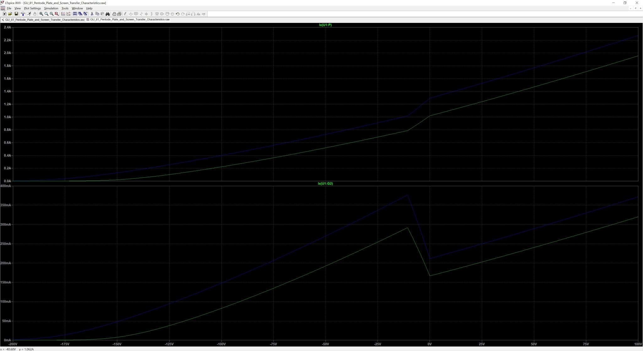

I have attached Model1_G2_600.jpg, which is your model but with S2 = 600 V; for comparison with your S2 = 500 V plot. Comparing it with the published S2 = 600 V data, it looks like model is still valid and accurate. Thanks very much for publishing this model.

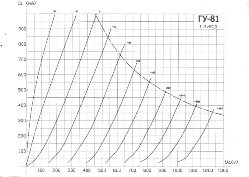

Updated GU-81 Spice model. GU81_LTSpice_051823.zip contains seven pentode-connection simulations corresponding to plots in the attached GU81.pdf. Please find the comments at the top of each schematic (.asc) file. There are also simulations for two sources of triode-connected data.
GU_81_Triode_1.plt:
https://www.diyaudio.com/community/attachments/gu-81-k-musatov-und-o-rasin-jpg.1117595/
GU_81_Triode_2.plt:
http://www.alexkurrasch.com/amp/data/gu81m-triode-connected-data.txt
For each of these nine cases, the LTSpice simulation plots are in reasonable agreement with the datasheets/measured data.
The GU_81_LTSpice.mod is based on the earlier one here: https://www.diyaudio.com/community/threads/vacuum-tube-spice-models.243950/page-163#post-6944473
Two things were changed. First, the plate and screen current plots corresponding to the transfer characteristic curve from page nine of the GU81.pdf had discontinuities corresponding to G1 = -10 and 0 V, please see the plot below (sorry about the poor contrast). That was found to be caused by the "LIMIT" function in the E22 calculation: E22 22 0 VALUE={V(21)LIMIT(KNK-V(G,K)*KNG,0,0.3)(-ATAN((V(P,K)-KNPL)/KNSL)+ATAN((V(P,K)-KNPR)/KNSR))}
I'm not sure what the purpose of the E22 calculation is, but setting it to 0 fixed the problem, and now this and other simulation plots agree well with the data. It is important to note that discontinuities such as this in the models gives Spice major problems with convergence to a solution, both with the DC (.op) solution and with transient (.tran) simulations.
The other change from the original .mod file was to modify parameters related specifically to G1 current with positive input voltages, which simulated about 25% compared with published data in the original .mod file: see pages 12 and 13 in the attached GU81.pdf.
Hopefully one can unzip the attached file, and everything will work out of the box with LTSpice installed. It may be necessary to add the unzipped path to the component symbol library.

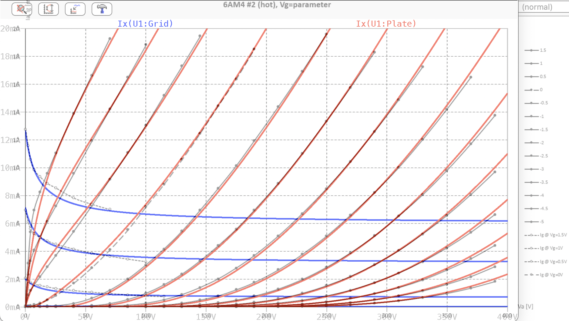

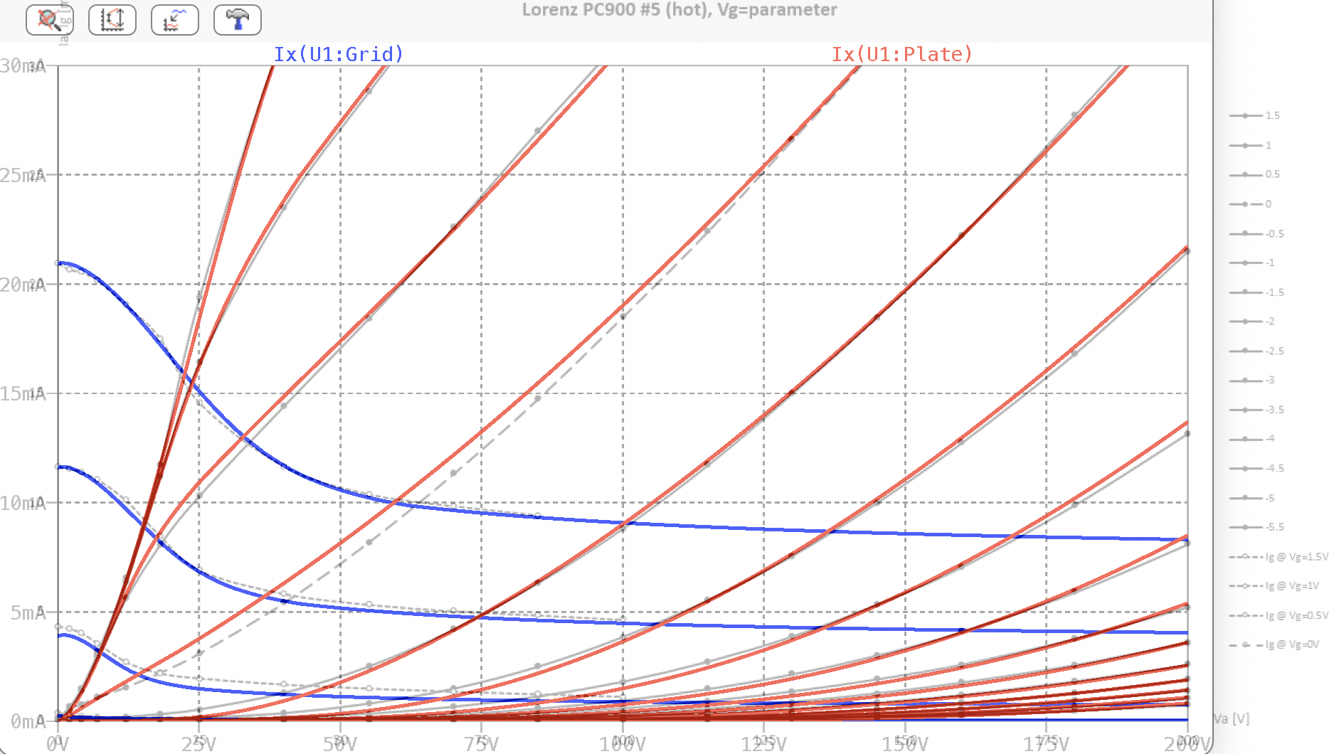

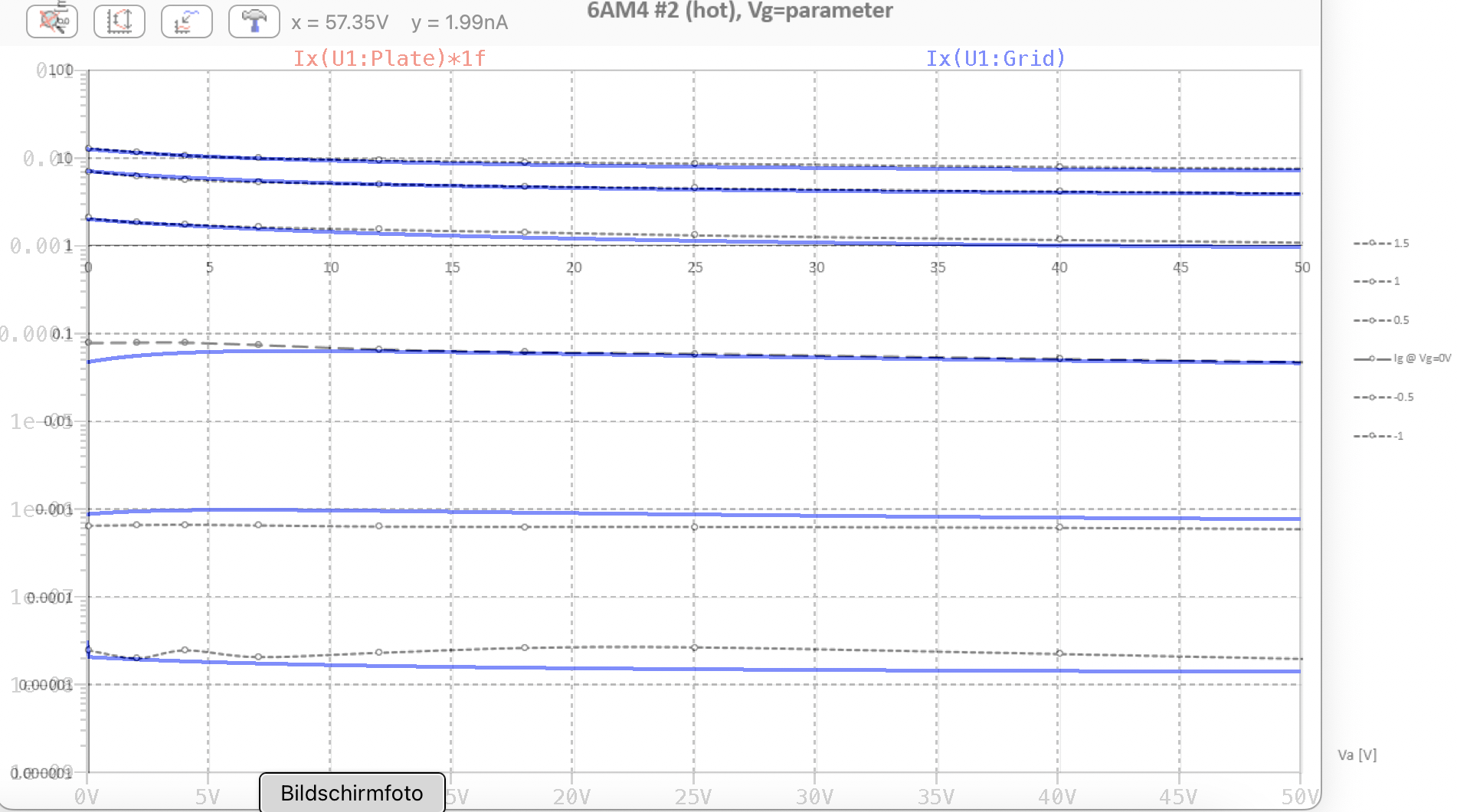

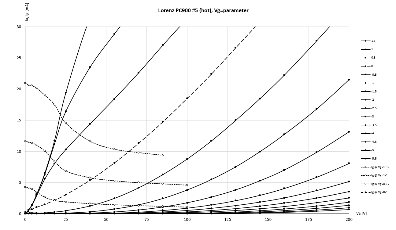

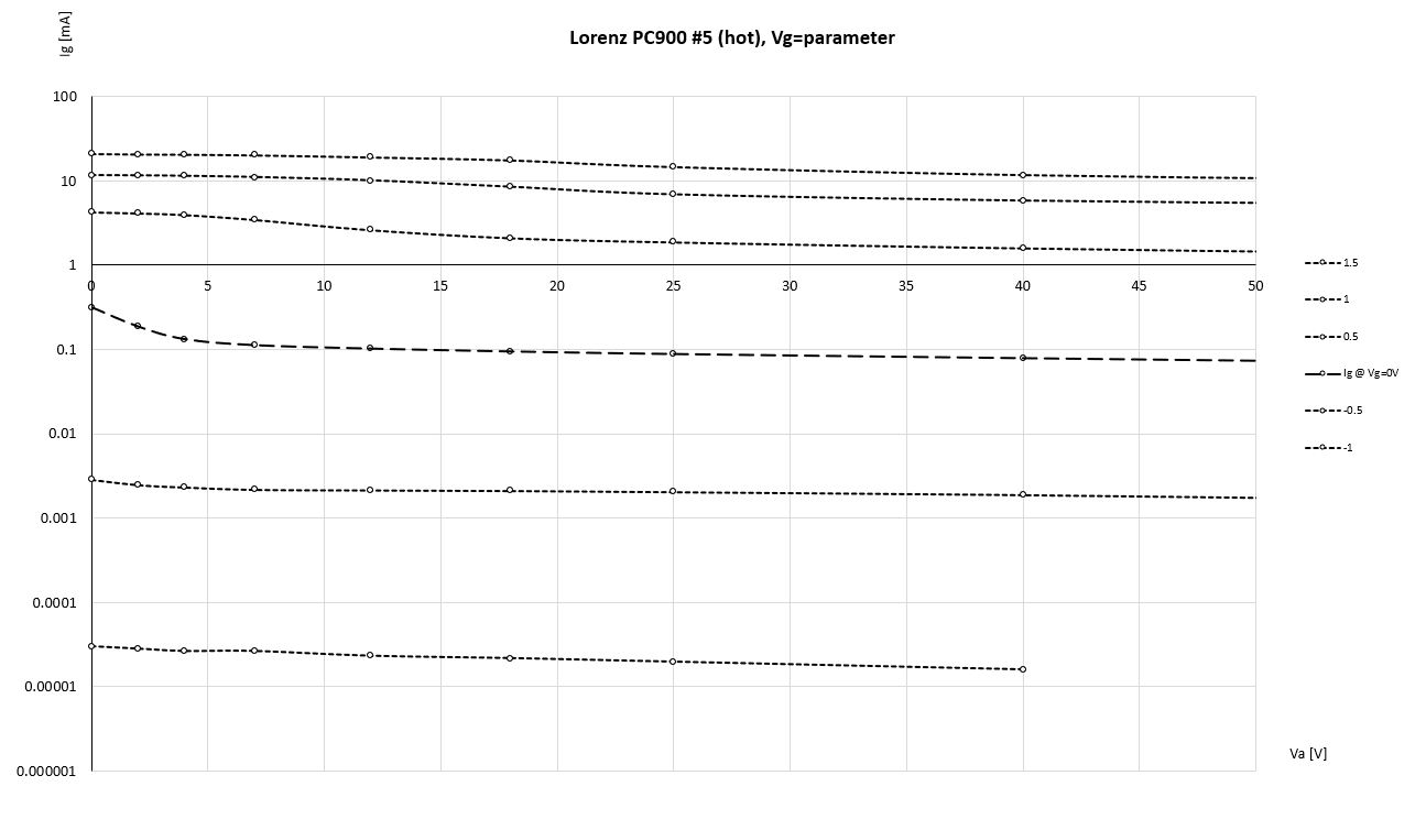

Hi all
I got 5 "Golden Samples" back (which are not mine), for the sake of measure those again, now under hot plate conditions.
Typically, there isn't too much of difference, but sometimes...
The first I measured was the 6AM4, and this tube showed significant curve changes when hot:
So, here the new i6 model.
BR Adrian
- gm got about 25% larger
- mu got about 5% smaller
BR Adrian

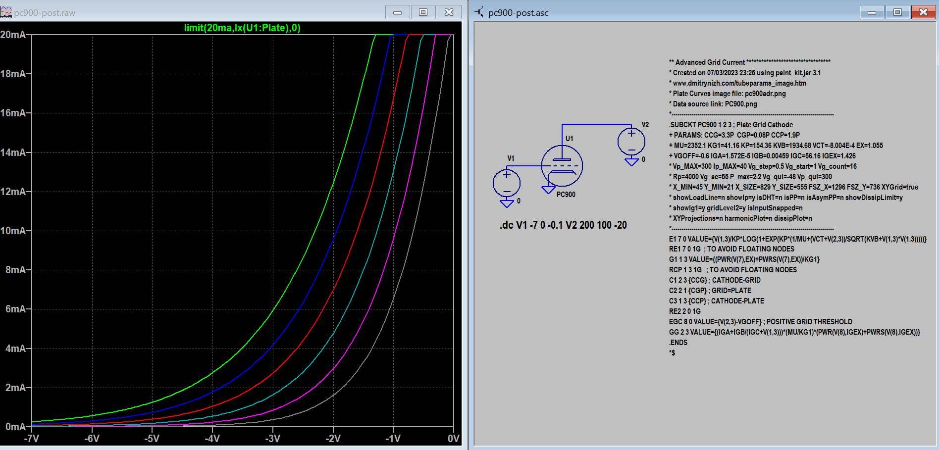

As a convenience to LTspice users I have changed all instances of ^ to **Has anyone tried the 71A spice model form the Ayumi pctube library?

Hi Adrian,...as announced, here my first i5 triode model release!😀
The development took a lot of time, about a dozen beta versions, lot of testing...
Thanks to all involved testers:
rongon
Ray Waters
Achim
The i5 is probably the best tested triode spice model ever. Regarding convergence, I learnt that DC-coupled circuits are much more difficult. So I started to test my beta versions with a tube OpAmp circuit containing 10 triodes!
But the ultimate test circuit was a 1bit-ALU (Arithmetic-Logic-Unit) made with 39 (!!) triodes, challenging my beta versions a lot. 😉
So, if a crazy guy wants to simulate a tube based number cruncher, this is possible now!
But back to the first i5 model:
It's the PC900/6HM5, a (semi) remote cutoff triode. For such triodes, the curves at higher Va voltages are special shaped. The i5 is the first model which is able to mimic such characteristics with a satisfying result.
All PC900/6HM5 electrode constructions seen so far were identical (although from different companies), so I assume that there is only 1 construction existing for that tube, and so I skipped the both manufacturer letters in the suffix - no need to distinguish between companies for this tube.
BR Adrian

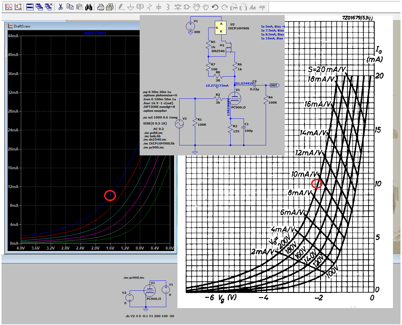

First of all, thank you for all work and efforts you do by sharing the result of your work here for the community!
I'm using your PC900.i5 model to do some simulations (got several PC900, would like to use them for something). I get a mismatch on the grid-plate transfer characteristic (sorry for the busy pic):
At 200V plate and -1.6V grid I get around 10mA on simulation, while the PC900 Philips datasheet shows that the bias at that anode current and voltage should be around -2.2V. I'm probably doing something wrong, but can't find what. Any ideas what would be the issue?
Best regards,
Jose
Hi Jose
My i5 and i6 models are all based on measured samples. While you compare my pc900 model with the data sheet. Main advantage is, that my models provide a grid current model of good quality. Especially for guitar amps with overdriven stages, reliable gris current models are appreciated.
To find the best representative tube, I do the following procedure:
1) burn in a bunch of tubes (typically 10 triodes) at 70% allowed plate losses, for 100 hours
2) Measure all of them
3) Analyze the curves in terms of plate resistance, contact voltage, mu, island effect and grid current. Select one of the triode as the "golden Sample", which is the most average in all those aspects.
4) Measure again the golden sample under hot conditions (done with the i6 only), as some tubes show curve drifts when they get hot.
5) Create a spice model according to those curves.
I recently measured my PC900 golden sample again, under hot conditions. It showed a bit different curves, closer to the data sheet curves. For the bias point you mentioned, this means Vg=-1.8V when hot, and -1.6V when cold. See attached graph.
A drawback of my approach which can't be solved is, that the golden sample is actually representative for the BATCH from where my bunch of tubes belongs to. Tubs from other batches might show a bit different curves.
BR Adrian

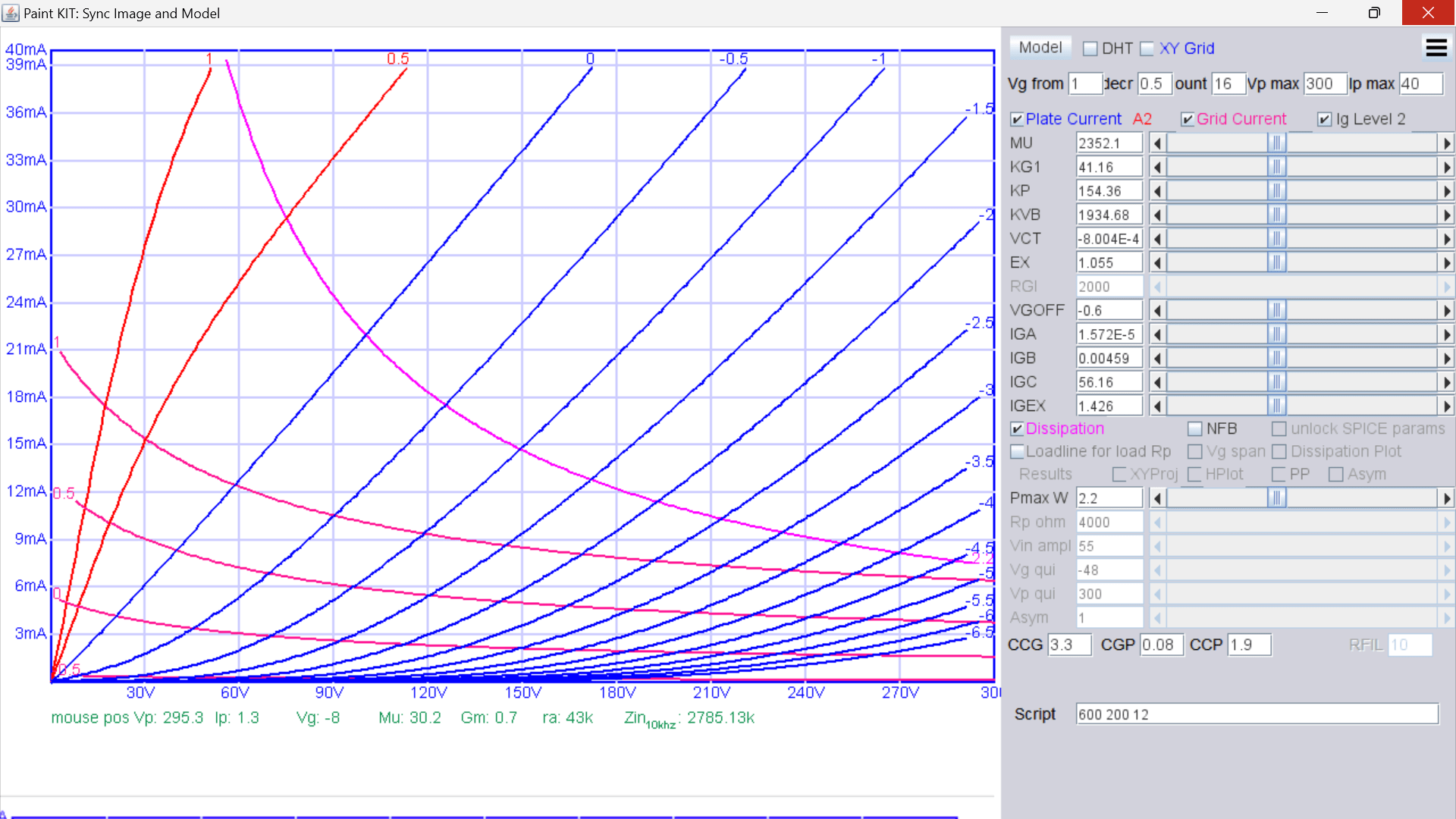

PC900 model based on Philips PC900 for sharing and improvement:
Code:
** Advanced Grid Current **********************************
* Created on 07/03/2023 23:25 using paint_kit.jar 3.1
* www.dmitrynizh.com/tubeparams_image.htm

Thank you Koown! The transfer curves match the datasheet I got.PC900 model based on Philips PC900 for sharing and improvement:
Code:** Advanced Grid Current ********************************** * Created on 07/03/2023 23:25 using paint_kit.jar 3.1 * www.dmitrynizh.com/tubeparams_image.htm * Plate Curves image file: pc900adr.png * Data source link: PC900.png *---------------------------------------------------------------------------------- .SUBCKT PC900 1 2 3 ; Plate Grid Cathode + PARAMS: CCG=3.3P CGP=0.08P CCP=1.9P + MU=2352.1 KG1=41.16 KP=154.36 KVB=1934.68 VCT=-8.004E-4 EX=1.055 + VGOFF=-0.6 IGA=1.572E-5 IGB=0.00459 IGC=56.16 IGEX=1.426 * Vp_MAX=300 Ip_MAX=40 Vg_step=0.5 Vg_start=1 Vg_count=16 * Rp=4000 Vg_ac=55 P_max=2.2 Vg_qui=-48 Vp_qui=300 * X_MIN=45 Y_MIN=21 X_SIZE=829 Y_SIZE=555 FSZ_X=1296 FSZ_Y=736 XYGrid=true * showLoadLine=n showIp=y isDHT=n isPP=n isAsymPP=n showDissipLimit=y * showIg1=y gridLevel2=y isInputSnapped=n * XYProjections=n harmonicPlot=n dissipPlot=n *---------------------------------------------------------------------------------- E1 7 0 VALUE={V(1,3)/KP*LOG(1+EXP(KP*(1/MU+(VCT+V(2,3))/SQRT(KVB+V(1,3)*V(1,3)))))} RE1 7 0 1G ; TO AVOID FLOATING NODES G1 1 3 VALUE={(PWR(V(7),EX)+PWRS(V(7),EX))/KG1} RCP 1 3 1G ; TO AVOID FLOATING NODES C1 2 3 {CCG} ; CATHODE-GRID C2 2 1 {CGP} ; GRID=PLATE C3 1 3 {CCP} ; CATHODE-PLATE RE2 2 0 1G EGC 8 0 VALUE={V(2,3)-VGOFF} ; POSITIVE GRID THRESHOLD GG 2 3 VALUE={(IGA+IGB/(IGC+V(1,3)))*(MU/KG1)*(PWR(V(8),IGEX)+PWRS(V(8),IGEX))} .ENDS *$

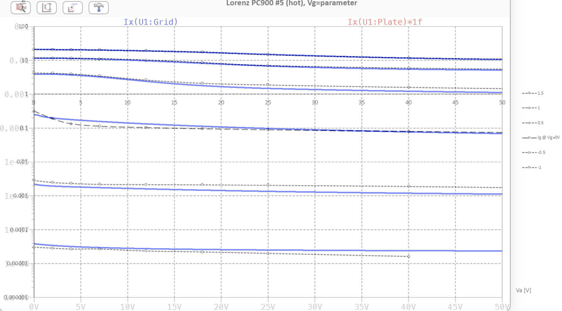

Hi all
As mentioned above, my PC900 golden sample showed different curves when hot. So, I decided to create a new model from the hot curves.
I took quite a bit of time to create it because it is actually made of two triodes in parallel (a high mu & gm one, and a low mu & gm one), which means a highly iterative tuning process.
Thanks to its internal two-triode arrangement, my model mimics the remote cutoff behavior of the PC900. This means one can simulate automatic gain control circuits, for what the PC900 was intended for.
BR Adrian
BR Adrian
