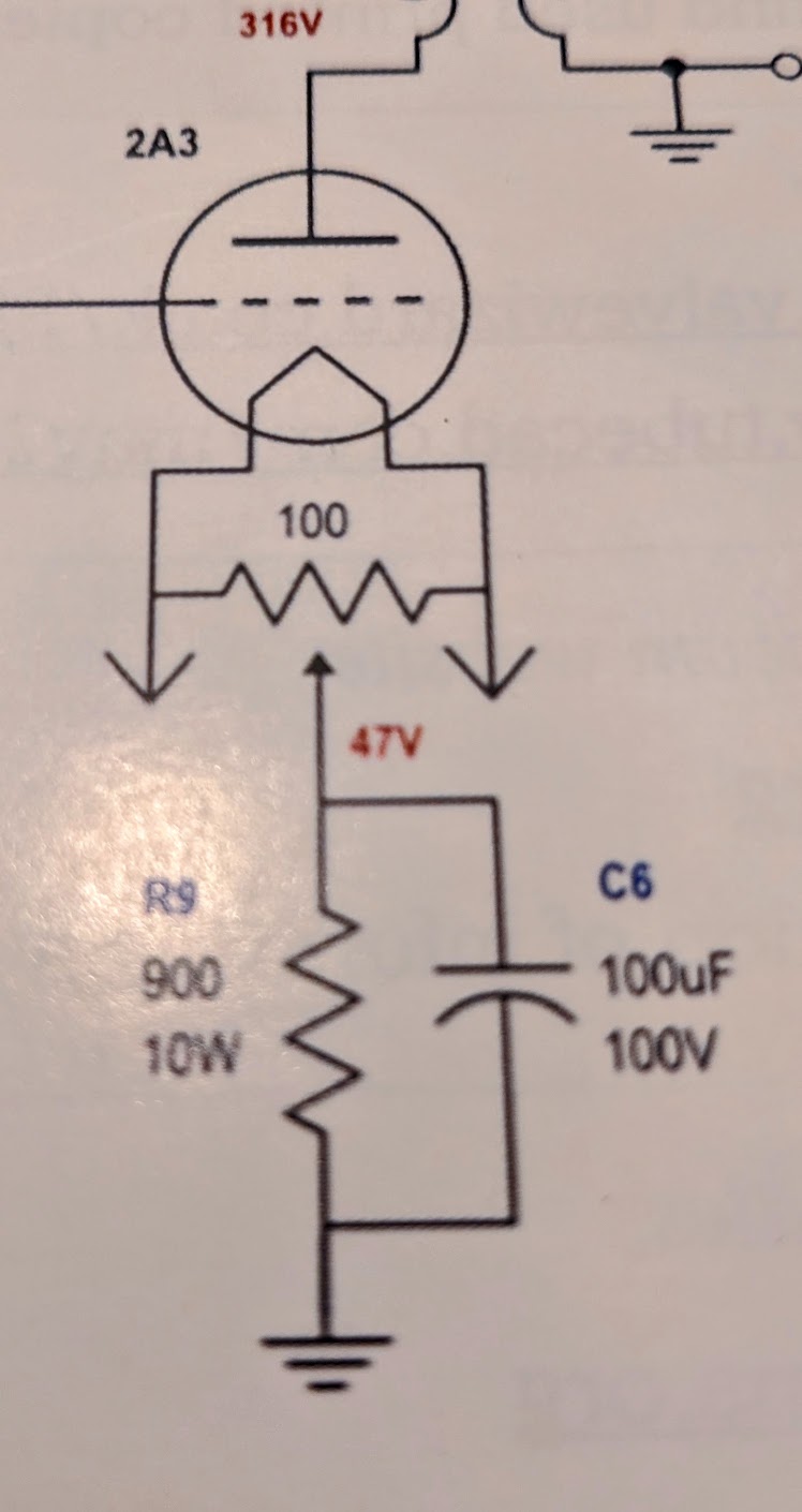

This is the right place, I think you are looking for a model with a filament, I am pretty sure they exist but I am not entirely sure they simulate the AC behaviors of a filamentary cathode correctly.
Perhaps you can simulate this by using a resistive voltage divider with the cathode connected in the center. The resistors should match the warm DCR of the filament. (you can calculate that with ohms on a heated tube, or just calculate it from the listed operating current and voltage.) You can make the resistance values slightly assymettrical to move the virtual cathode around a bit. I have no idea whether this is useful or not, but it is all I can think of.

Not having a good model yet, I hadn't drawn this up. This pic is from the schematic of the amp I want to modify. I built it a couple of years ago and I love it, but in a small listening room with pretty efficient speakers, the hum has gotten to be too much for me.
I think you're suggestion makes sense. I'd basically pull the filament pins "Out of the symbol", attach them to the resistive-divider and take the 2.5V AC out of the center to K in a standard triode symbol. Then the hum pot in the original schematic attaches to the outside of the divider as well as the heater voltage.

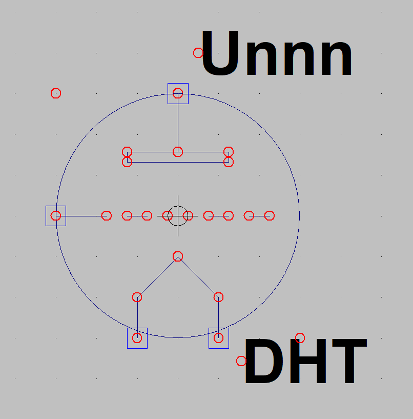

To use Ale's 801a SPICE model you will need a new symbol, since the model has four pins and the LTspice built-in triode symbol has only three. I've thrown together a symbol that is compatible with the 801a SPICE model. It is attached here.
In LTspice, symbol files have the .asy file extension. The forum won't allow uploading .asy files so the attached file is named DHT.asy.txt. Delete the .txt extension before trying to use it.
I hope this is helpful.

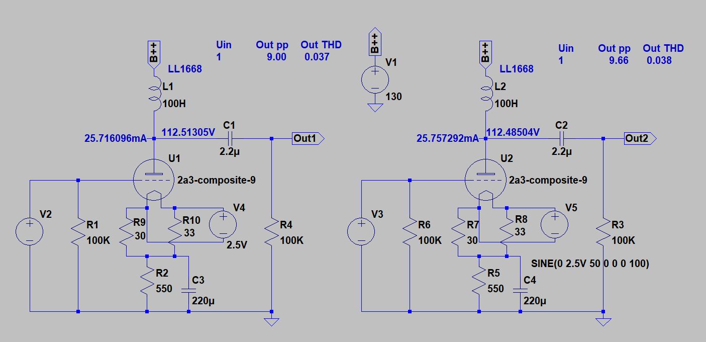

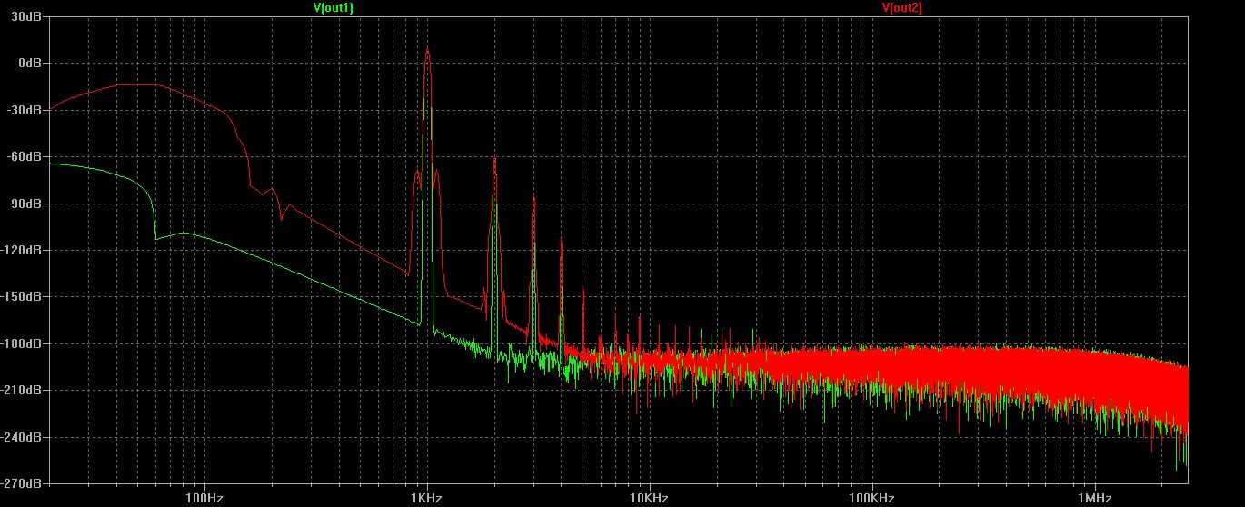

In LTSpice Dmitry "type" four pin DHT models "correctly" shows AC heating modulation.
This is the same (dissimilar -30R/33R- resistors as virtual cathode shows incorrect hum pot settings) preamp simulation with DC and AC filament heating.
The output FFT shows the intermodulation (sidebands around carrier and distortion products) in case of AC filament.
euro21,
Great Job!
It shows the lower and upper sidebands are each offset from each tone, by 2x the power mains frequency . . . Correct.
You may be the first one who posted the screen shot results on diyAudio.
It should be noted that how far the sidebands are down (dBc) from the tone is dependent on two things:
1. The AC filament voltage versus the grid to filament bias voltage
2. The dBc is reduced (made worse) when the peak grid signal voltage and the peak AC filament voltage cause the grid to filament voltage
to get near or at the Contact Potential voltage.
The grid is still slightly more negative than the peak AC voltage at either end of the filament.
I am not talking about when the grid volts is the same as either end of the filament's peak volts. That is the zero volt condidion.
Thanks again, euro21
