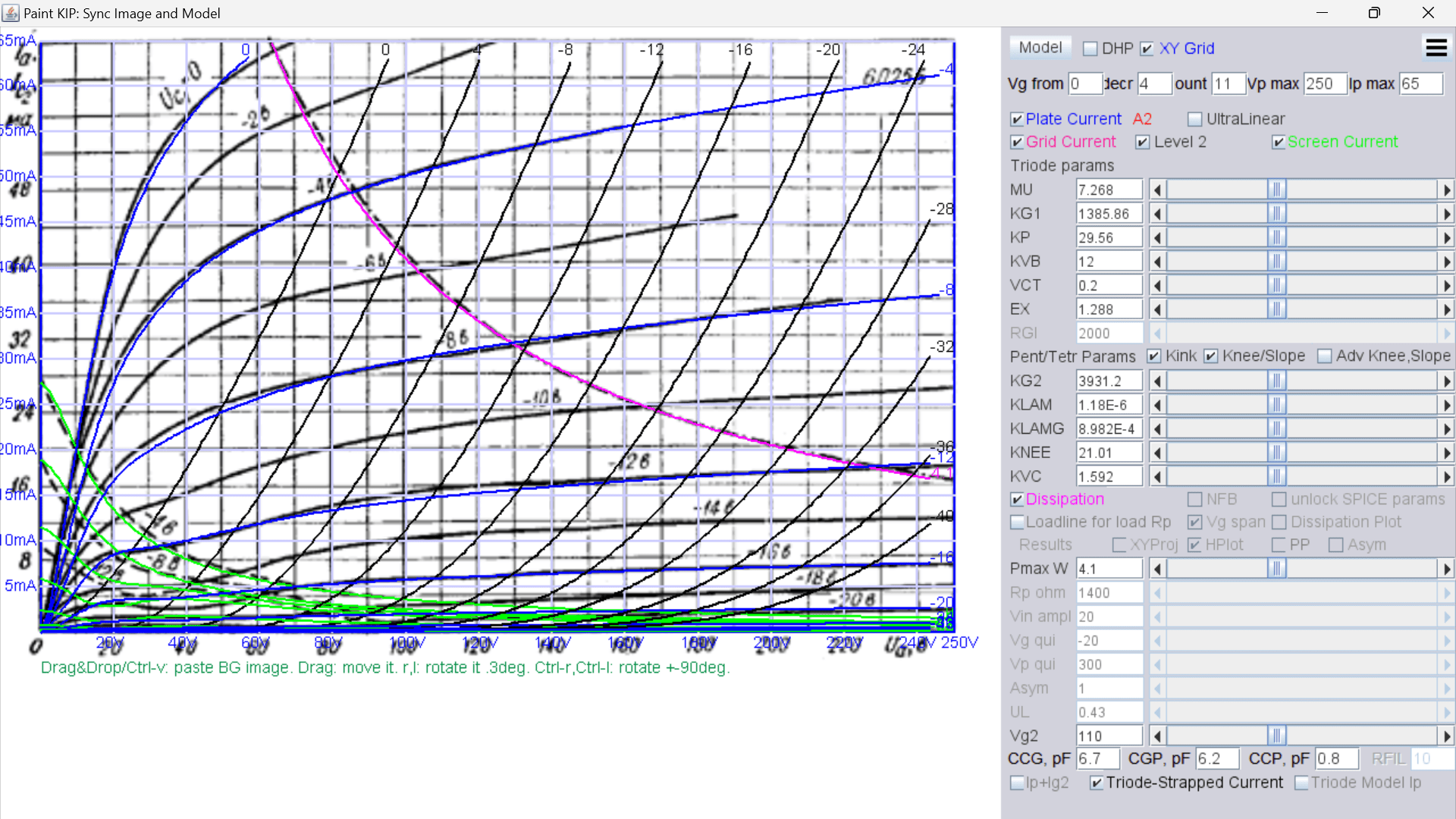

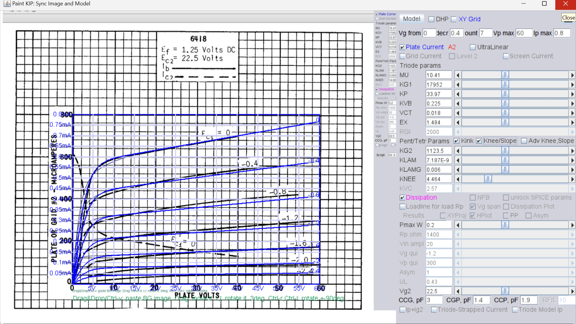

I've made this code for 6418 pentode using Java Paint KIP, but it refuse to work in my ltspice. Could anyone help?
Code:
.SUBCKT 6418_P P G2 G K ; LTSpice tetrode.asy pinout
* .SUBCKT 6418_P P G K G2 ; Koren Pentode Pspice pinout
+ PARAMS: MU=10.41 KG1=17952 KP=33.97 KVB=0.225 VCT=0.018 EX=1.484 KG2=1123.5 KNEE=14.88 KVC=2.57
+ KLAM=7.187E-9 KLAMG=0.006  KD=0.44 KC=0.14 KR1=0.0013 KR2=0.064 KVBG=0.015 KNK=-0.044 KNG=0.006
+ CCG=3P CGP=1.4P CCP=1.9P RGI=2000.0

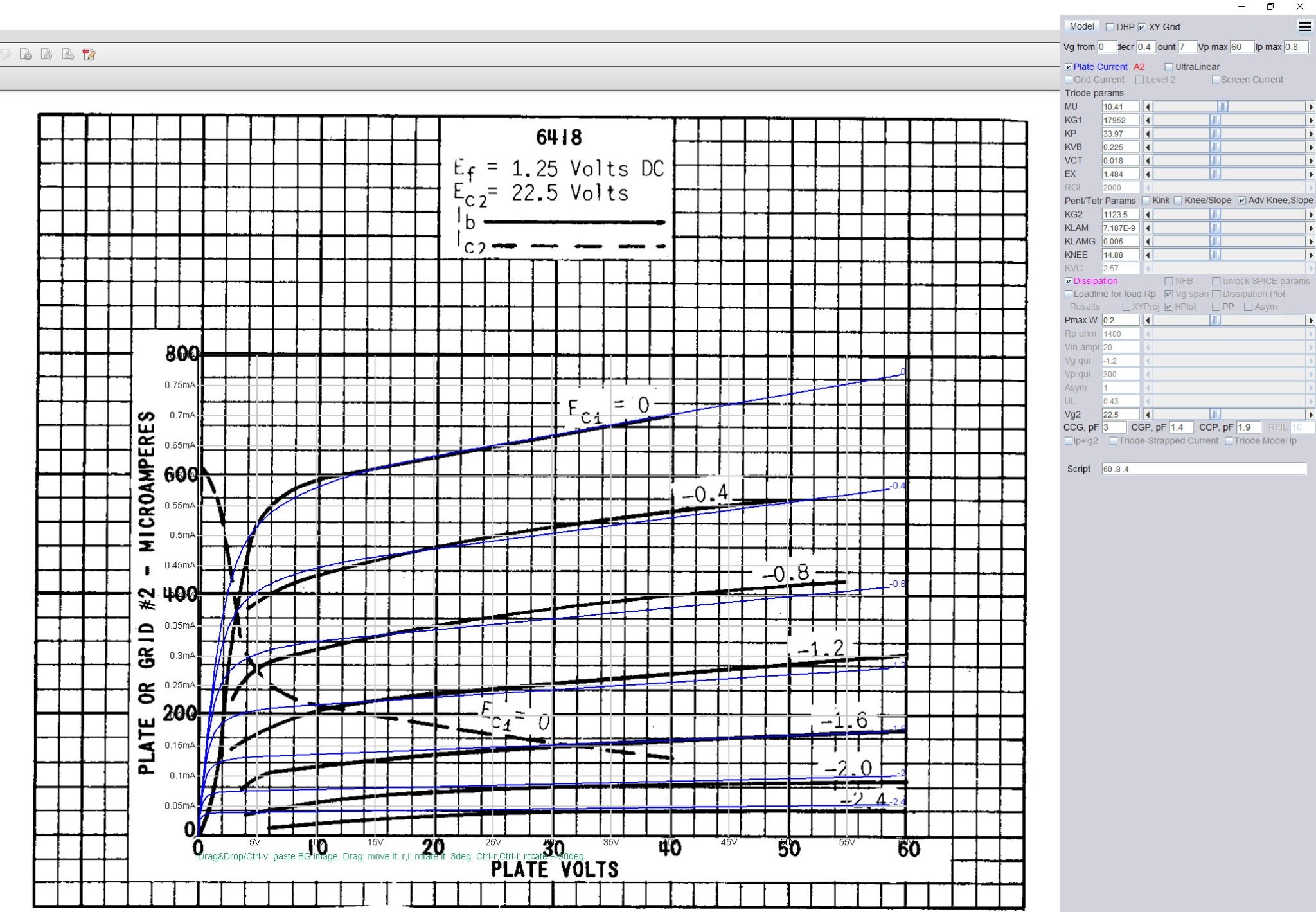

Make sure "Kink" is checked. Aviod using "Advance Knee" if you can. The screen current is too high, need to adjust before it can be used.
Code:
**** 6418P ******************************************
* Created on 05/04/2023 22:50 using paint_kip.jar
* www.dmitrynizh.com/tubeparams_image.htm
* Plate Curves image file: 6418p.jpg
* Data source link: <plate curves URL>
.SUBCKT 6418P P G2 G K ; LTSpice tetrode.asy pinout
* .SUBCKT 6418P P G K G2 ; Koren Pentode Pspice pinout
+ PARAMS: MU=10.41 KG1=17952 KP=33.97 KVB=0.225 VCT=0.018 EX=1.484 KG2=1123.5 KNEE=4.464 KVC=2.57
+ KLAM=7.187E-9 KLAMG=0.006 KNEE2=3.4 KNEX=568.8  KNK=-0.044 KNG=0.006 KNPL=50 KNSL=11 KNPR=120 KNSR=29
* Vp_MAX=60 Ip_MAX=0.8 Vg_step=0.4 Vg_start=0 Vg_count=7
* X_MIN=162 Y_MIN=231 X_SIZE=548 Y_SIZE=377 FSZ_X=1296 FSZ_Y=736 XYGrid=true
* Rp=1400 Vg_ac=20 P_max=0.2 Vg_qui=-1.2 Vp_qui=300
* showLoadLine=n showIp=y isDHP=n isPP=n isAsymPP=n isUL=n showDissipLimit=y
* showIg1=n isInputSnapped=y addLocalNFB=n
* XYProjections=n harmonicPlot=y dissipPlot=n
* UL=0.43 EG2=22.5 gridLevel2=n addKink=y isTanhKnee=y advSigmoid=n
RE1  7 0  1G    ; DUMMY SO NODE 7 HAS 2 CONNECTIONS
E1   7 0  VALUE=  ; E1 BREAKS UP LONG EQUATION FOR G1.
+{V(G2,K)/KP*LOG(1+EXP((1/MU+(VCT+V(G,K))/SQRT(KVB+V(G2,K)*V(G2,K)))*KP))}
RE2  6 0  1G    ; DUMMY SO NODE 6 HAS 2 CONNECTIONS
E2  6 0  VALUE={(PWR(V(7),EX)+PWRS(V(7),EX))} ; Kg1 times KIT current
RE21 21 0 1
E21  21 0 VALUE={V(6)/KG1*ATAN((V(P,K)+KNEX)/KNEE)*TANH(V(P,K)/KNEE2)} ; Ip with knee but no slope and no kink
RE22 22 0 1 ; E22: kink curr deviation for plate
E22  22 0 VALUE={V(21)*LIMIT(KNK-V(G,K)*KNG,0,0.3)*(-ATAN((V(P,K)-KNPL)/KNSL)+ATAN((V(P,K)-KNPR)/KNSR))}
G1   P  K  VALUE={V(21)*(1+KLAMG*V(P,K))+KLAM*V(P,K) + V(22)}
* Alexander Gurskii screen current, see audioXpress 2/2011, with slope and kink added
RE43 43 K 1G ; Dummy
E43  43 G2 VALUE={0} ; Dummy
G2   43 K  VALUE={V(6)/KG2*(KVC-ATAN((V(P,K)+KNEX)/KNEE)*TANH(V(P,K)/KNEE2))/(1+KLAMG*V(P,K))-V(22)}
RCP  P K  1G     ; FOR CONVERGENCE
C1   K G  {CCG}  ; CATHODE-GRID 1
C2   G P  {CGP}  ; GRID 1-PLATE
C3   K P  {CCP}  ; CATHODE-PLATE
R1   G 5  {RGI}  ; FOR GRID CURRENT
D3   5 K  DX     ; FOR GRID CURRENT }
.MODEL DX D(IS=1N RS=1 CJO=10PF TT=1N)
.ENDS

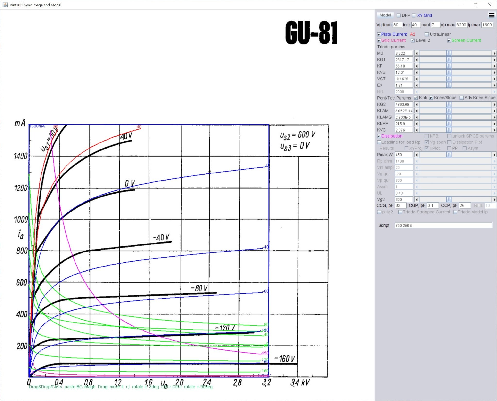

Gu81/ГУ81 pentode model for sharing:

I have attached Model1_G2_600.jpg, which is your model but with S2 = 600 V; for comparison with your S2 = 500 V plot. Comparing it with the published S2 = 600 V data, it looks like model is still valid and accurate. Thanks very much for publishing this model.

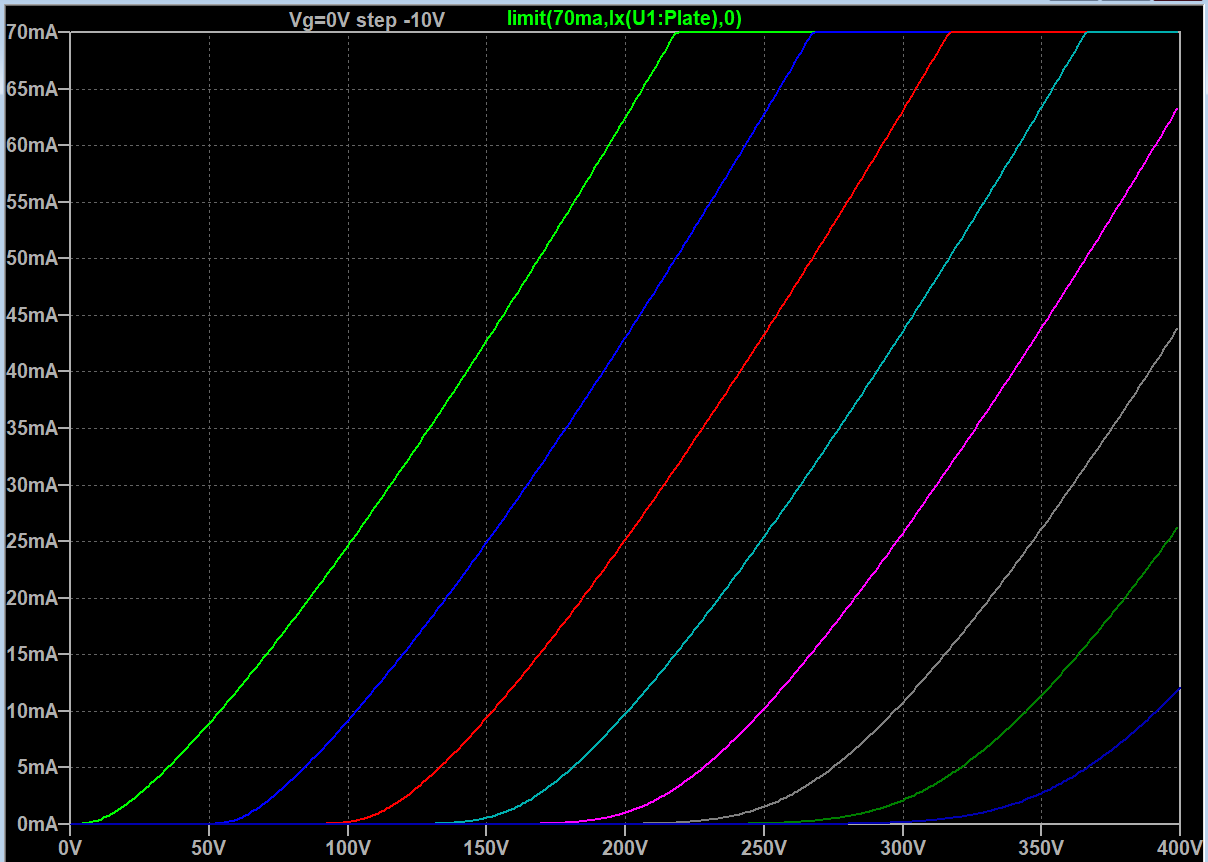

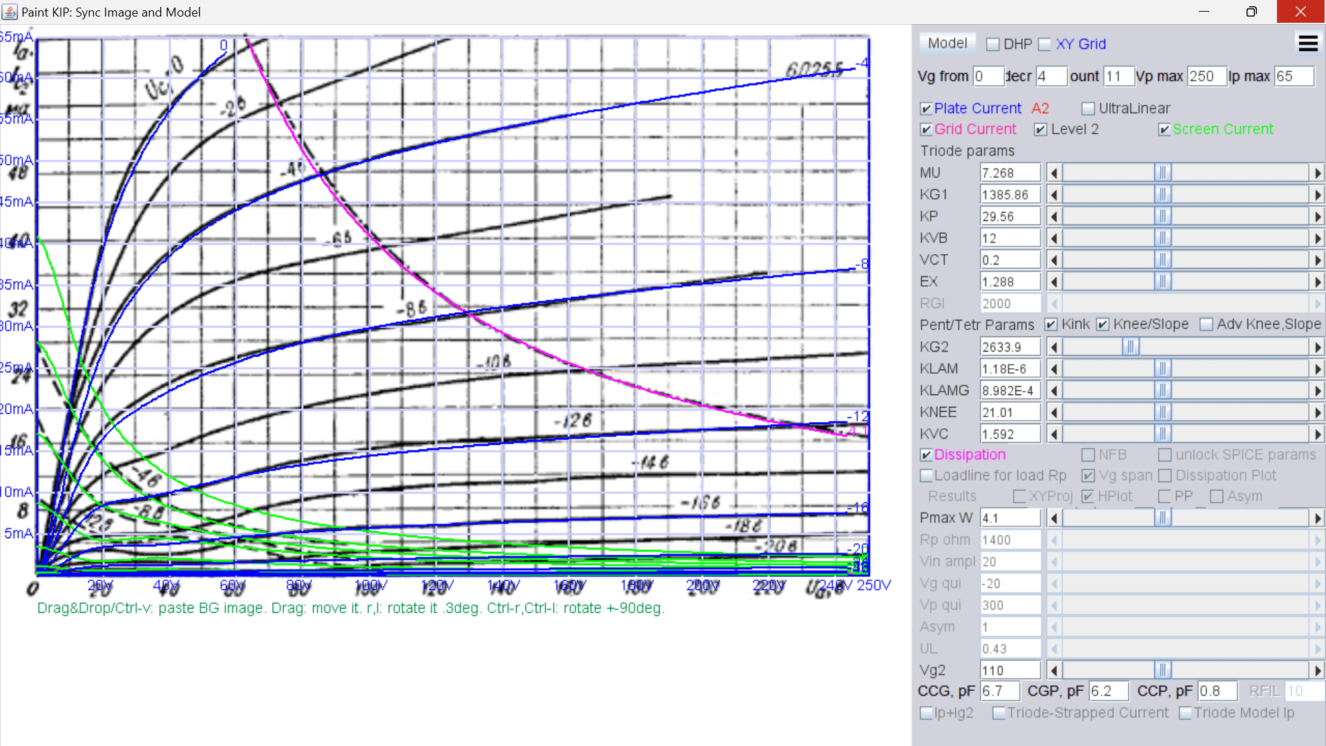

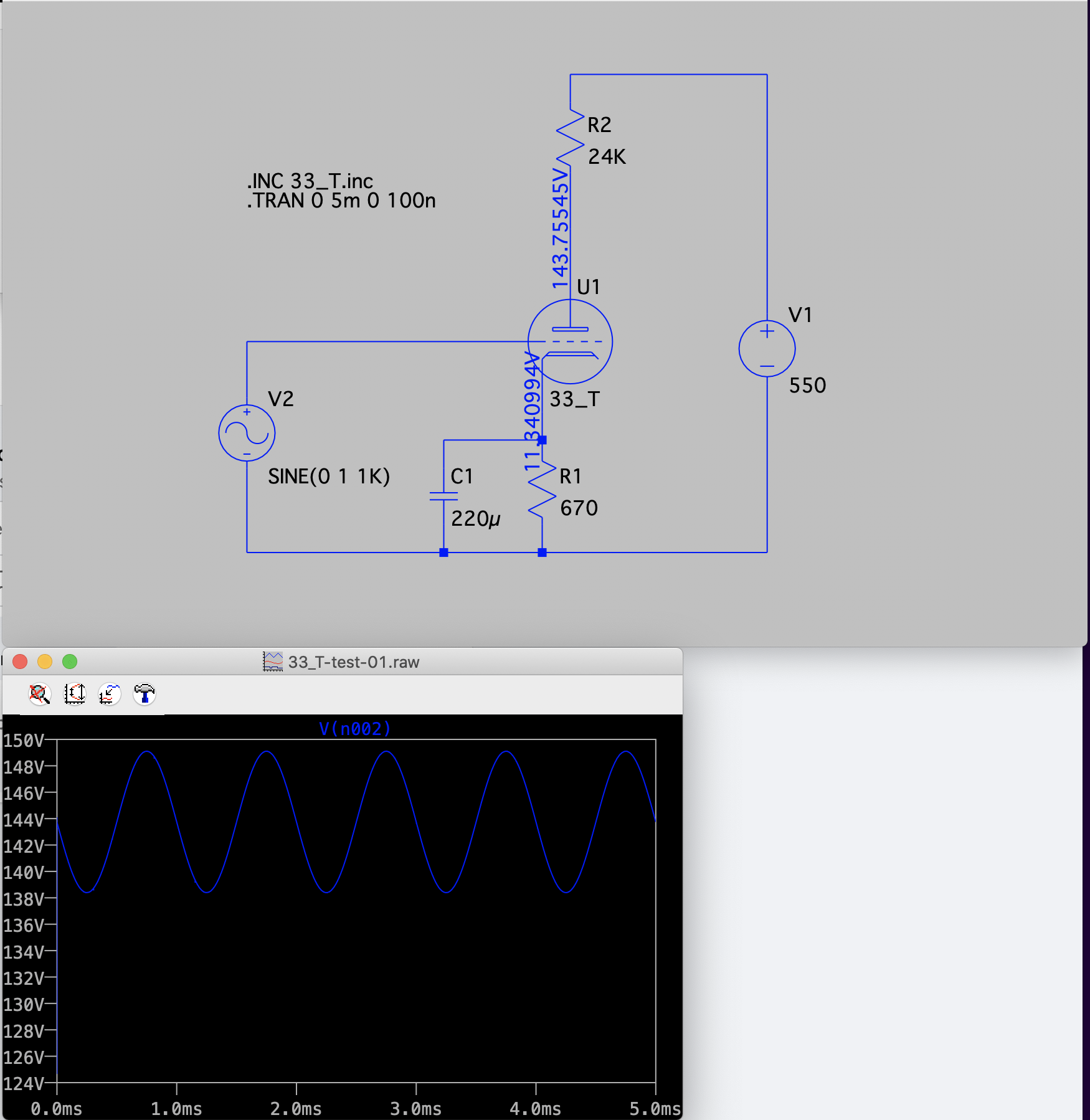

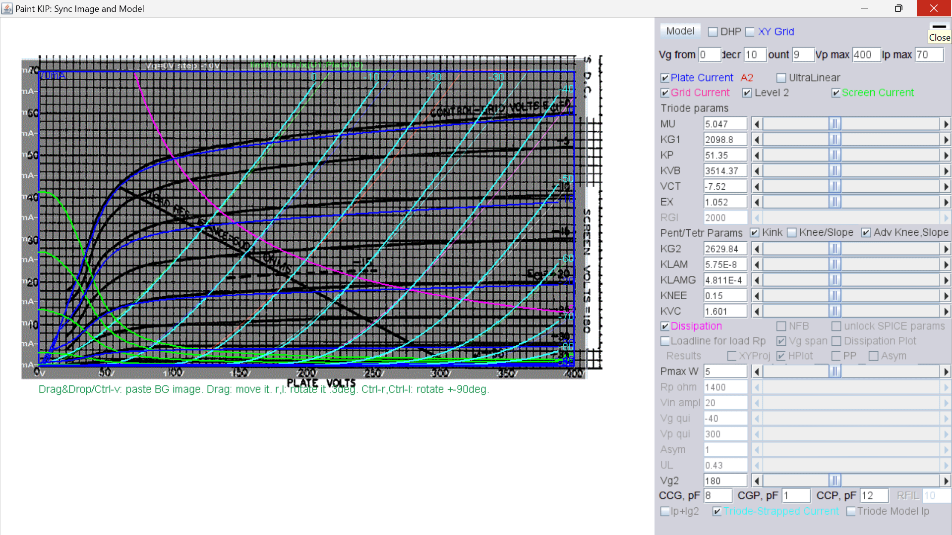

Try this 33 RCA triode and pentode model:
Code:
**** 33_T ** Advanced Grid Current **********************************
* Created on 05/07/2023 22:22 using paint_kit.jar 3.1
* Plate Curves image file: 33-t.png
* Data source link:
.SUBCKT 33_T 1 2 3 ; Plate Grid Cathode
+ PARAMS: CCG=8P  CGP=1P CCP=12P
+ MU=4.929 KG1=2898.64 KP=66.26 KVB=156.53 VCT=-2.27 EX=1.236
+ VGOFF=-0.6 IGA=0.001 IGB=0.3 IGC=8 IGEX=2
* Vp_MAX=280 Ip_MAX=35 Vg_step=5 Vg_start=0 Vg_count=11
* Rp=4000 Vg_ac=55 P_max=2 Vg_qui=-48 Vp_qui=300
* X_MIN=24 Y_MIN=74 X_SIZE=809 Y_SIZE=410 FSZ_X=1296 FSZ_Y=736 XYGrid=false
* showLoadLine=n showIp=y isDHT=n isPP=n isAsymPP=n showDissipLimit=y
* showIg1=y gridLevel2=y isInputSnapped=n
* XYProjections=n harmonicPlot=n dissipPlot=n
E1 7 0 VALUE={V(1,3)/KP*LOG(1+EXP(KP*(1/MU+(VCT+V(2,3))/SQRT(KVB+V(1,3)*V(1,3)))))}
RE1 7 0 1G  ; TO AVOID FLOATING NODES
G1 1 3 VALUE={(PWR(V(7),EX)+PWRS(V(7),EX))/KG1}
RCP 1 3 1G   ; TO AVOID FLOATING NODES
C1 2 3 {CCG} ; CATHODE-GRID
C2 2 1 {CGP} ; GRID=PLATE
C3 1 3 {CCP} ; CATHODE-PLATE
RE2 2 0 1G
EGC 8 0 VALUE={V(2,3)-VGOFF} ; POSITIVE GRID THRESHOLD
GG 2 3 VALUE={(IGA+IGB/(IGC+V(1,3)))*(MU/KG1)*(PWR(V(8),IGEX)+PWRS(V(8),IGEX))}
.ENDS
Code:
**** 33_P ******************************************
* Created on 05/07/2023 23:43 using paint_kip.jar
* Plate Curves image file: 33-p.gif

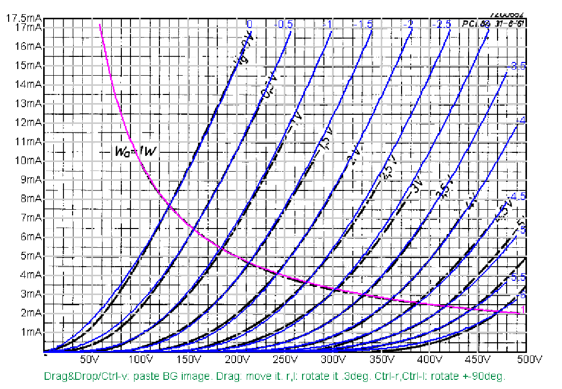

Try this for PCL84 triode section (only the datasheet for PCL84 has the triode curves)
**** TEST ****************************************** * Created on 05/11/2023 20:56 using paint_kit.jar 3.1 * www.dmitrynizh.com/tubeparams_image.htm * Plate Curves image file: * Data source link: *---------------------------------------------------------------------------------- .SUBCKT PCL84T 1 2 3 ; Plate Grid Cathode + PARAMS: CCG=4P CGP=2.7P CCP=2.3P RGI=2200 + MU=89 KG1=400 KP=370 KVB=6000 VCT=-0.15 EX=1.464 * Vp_MAX=500 Ip_MAX=17.5 Vg_step=0.5 Vg_start=0 Vg_count=13 * Rp=4000 Vg_ac=55 P_max=1 Vg_qui=-48 Vp_qui=300 * X_MIN=243 Y_MIN=277 X_SIZE=633 Y_SIZE=438 FSZ_X=1519 FSZ_Y=969 XYGrid=true * showLoadLine=n showIp=y isDHT=n isPP=n isAsymPP=n showDissipLimit=y * showIg1=y gridLevel2=n isInputSnapped=n * XYProjections=n harmonicPlot=n dissipPlot=n *---------------------------------------------------------------------------------- E1 7 0 VALUE={V(1,3)/KP*LOG(1+EXP(KP*(1/MU+(VCT+V(2,3))/SQRT(KVB+V(1,3)*V(1,3)))))} RE1 7 0 1G ; TO AVOID FLOATING NODES G1 1 3 VALUE={(PWR(V(7),EX)+PWRS(V(7),EX))/KG1} RCP 1 3 1G ; TO AVOID FLOATING NODES C1 2 3 {CCG} ; CATHODE-GRID C2 2 1 {CGP} ; GRID=PLATE C3 1 3 {CCP} ; CATHODE-PLATE D3 5 3 DX ; POSITIVE GRID CURRENT R1 2 5 {RGI} ; POSITIVE GRID CURRENT .MODEL DX D(IS=1N RS=1 CJO=10PF TT=1N) .ENDS *$
  • PARAMS: CCG=4P CGP=2.7P CCP=2.3P RGI=2200
  • MU=89 KG1=400 KP=370 KVB=6000 VCT=-0.15 EX=1.464

Try this 6П25Б (6P25B) model:
Code:
**** 6P25B ******************************************
* Created on 05/13/2023 20:57 using paint_kip.jar
* Plate Curves image file: 6P25B.png
.SUBCKT 6P25B P G2 G K ; LTSpice tetrode.asy pinout
* .SUBCKT 6P25B P G K G2 ; Koren Pentode Pspice pinout
+ PARAMS: MU=7.268 KG1=1385.86 KP=29.56 KVB=12 VCT=0.2 EX=1.288 KG2=3931.2 KNEE=21.01 KVC=1.592
+ KLAM=1.18E-6 KLAMG=8.982E-4 KNEE2=9.32 KNEX=2.423  KNK=-0.2328 KNG=0.0383 KNPL=23.23 KNSL=10.45 KNPR=29.34 KNSR=34.62
+ CCG=6.7P CGP=6.2P CCP=0.8P VGOFF=-0.6 IGA=0.001 IGB=0.3 IGC=8 IGEX=2
* Vp_MAX=250 Ip_MAX=65 Vg_step=4 Vg_start=0 Vg_count=11
* X_MIN=36 Y_MIN=13 X_SIZE=803 Y_SIZE=519 FSZ_X=1296 FSZ_Y=736 XYGrid=true
* Rp=1400 Vg_ac=20 P_max=4.1 Vg_qui=-20 Vp_qui=300
* showIg1=y isInputSnapped=y addLocalNFB=n
* UL=0.43 EG2=110 gridLevel2=y addKink=y isTanhKnee=y advSigmoid=n
RE21 21 0 1
RE23 G 0 1G
GG G K VALUE={(IGA+IGB/(IGC+V(P,K)))*(MU/KG1)*
+(PWR(V(G,K)-VGOFF,IGEX)+PWRS(V(G,K)-VGOFF,IGEX))}
.ENDS

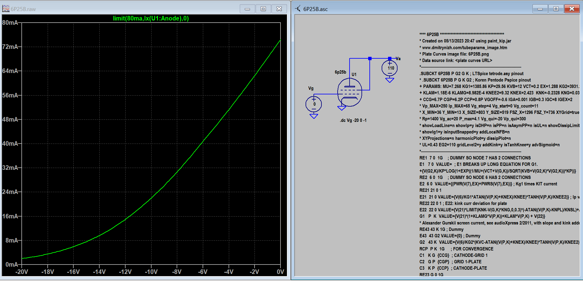

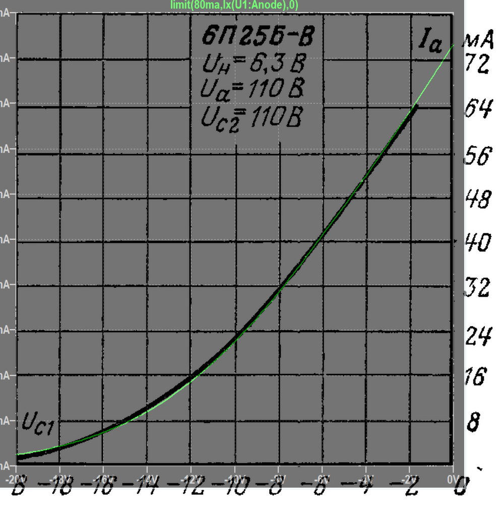

There is a misalignment of screen current curve which started at -4V, not 0V. Here is the correction:
Code:
* Created on 05/14/2023 06:31 using paint_kip.jar
+ PARAMS: MU=7.268 KG1=1385.86 KP=29.56 KVB=12 VCT=0.2 EX=1.288 KG2=2633.9 KNEE=21.01 KVC=1.592
RE21 21 0 1
RE23 G 0 1G
.ENDS

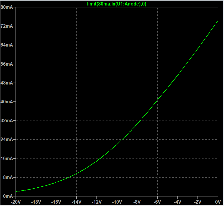

Thank you! I'll have to try that Paint-KIP program. Here's the screenshot of a basic test circuit of the 33 in triode mode, running the tube at about 132.4V/16.9mA. Gain is 10.
To calculate the plate resistance, would we divide Vak by Ia?
132.4/.0169 = 7,834R
I've read that a rule of thumb for determining the value of the plate load resistor is that it should be roughly 3X the plate resistance. So I ran the model with a 24K load resistor and it needed a 550V supply for this op point.
