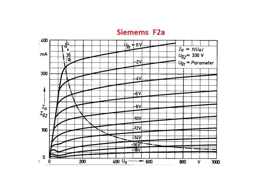

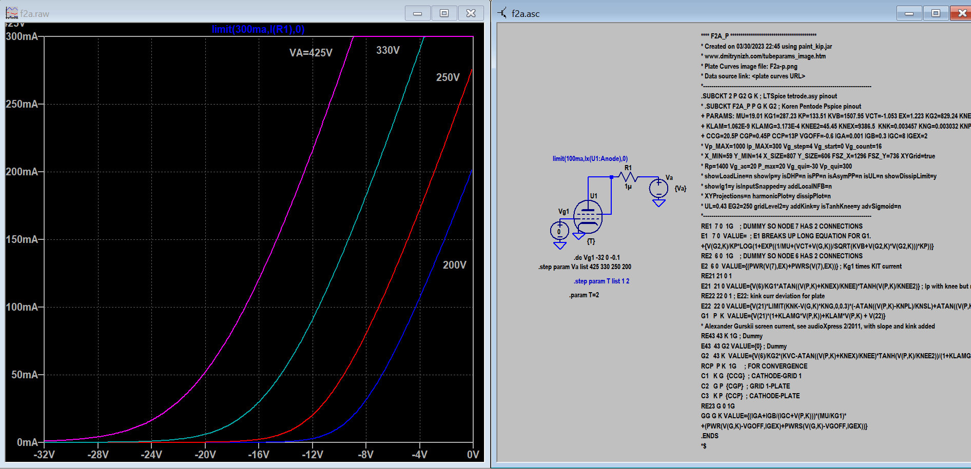

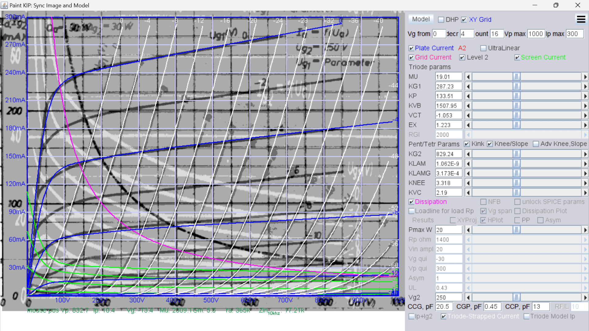

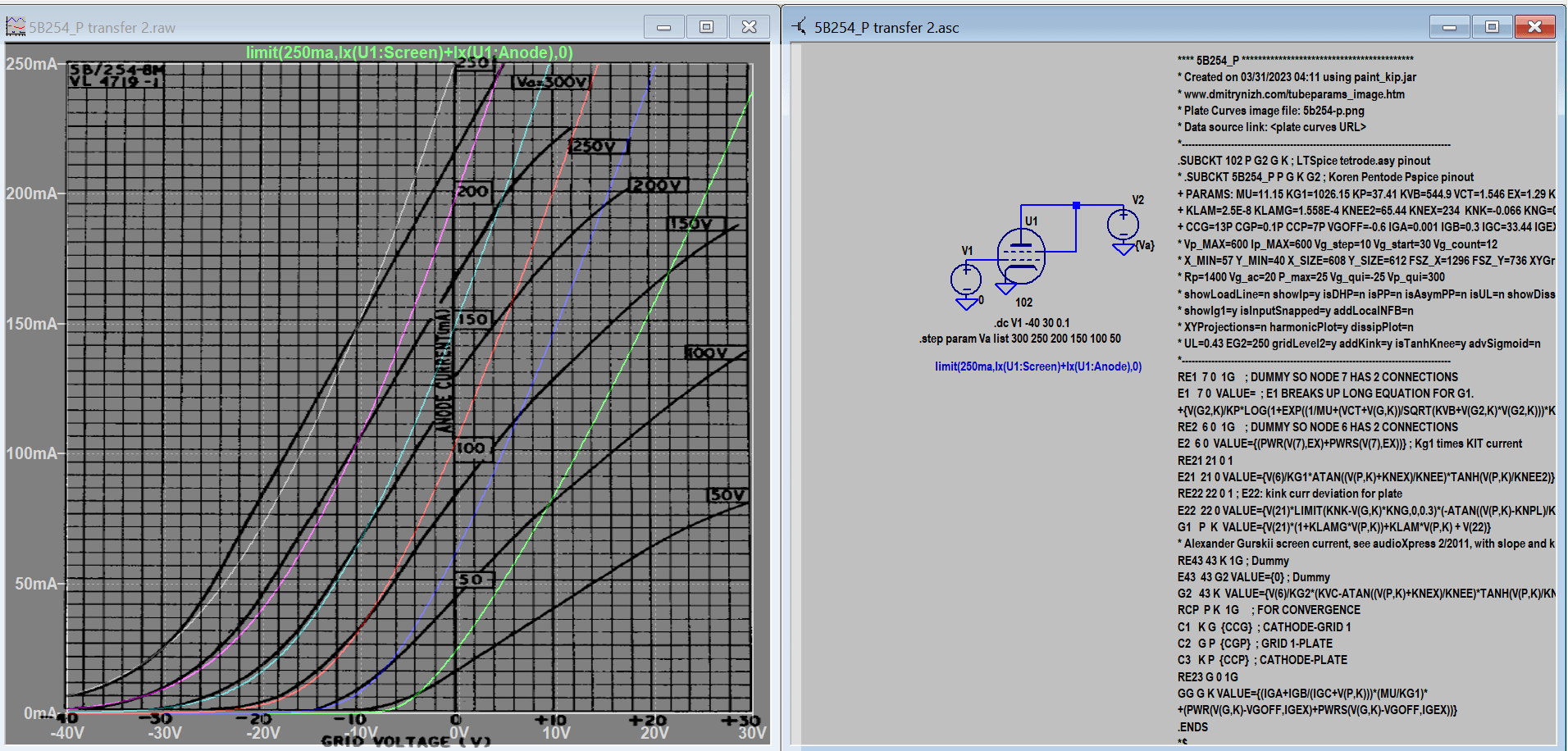

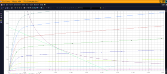

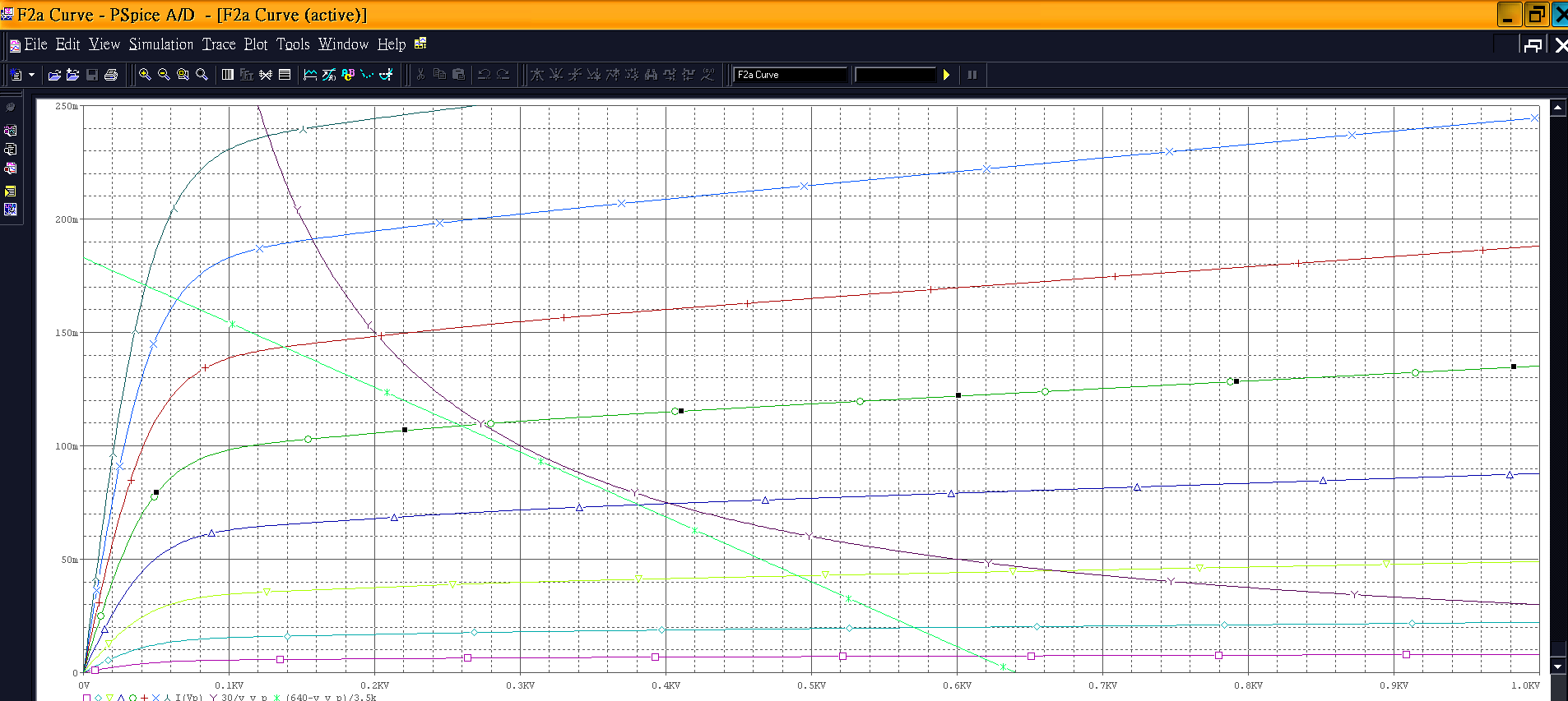

Here is F2A tetrode model:
Code:
**** F2A_P ******************************************
* Created on 03/30/2023 22:45 using paint_kip.jar
* www.dmitrynizh.com/tubeparams_image.htm
* Plate Curves image file: F2a-p.png
* Data source link: <plate curves URL>
.SUBCKT 2 P G2 G K ; LTSpice tetrode.asy pinout
* .SUBCKT F2A_P P G K G2 ; Koren Pentode Pspice pinout
+ PARAMS: MU=19.01 KG1=287.23 KP=133.51 KVB=1507.95 VCT=-1.053 EX=1.223 KG2=829.24 KNEE=3.318 KVC=2.19
+ KLAM=1.062E-9 KLAMG=3.173E-4 KNEE2=45.45 KNEX=9386.5  KNK=0.003457 KNG=0.003032 KNPL=7.6 KNSL=0.528 KNPR=212.54 KNSR=92.78
+ CCG=20.5P CGP=0.45P CCP=13P VGOFF=-0.6 IGA=0.001 IGB=0.3 IGC=8 IGEX=2
* Vp_MAX=1000 Ip_MAX=300 Vg_step=4 Vg_start=0 Vg_count=16
* X_MIN=59 Y_MIN=14 X_SIZE=807 Y_SIZE=606 FSZ_X=1296 FSZ_Y=736 XYGrid=true
* Rp=1400 Vg_ac=20 P_max=20 Vg_qui=-30 Vp_qui=300
* showLoadLine=n showIp=y isDHP=n isPP=n isAsymPP=n isUL=n showDissipLimit=y
* showIg1=y isInputSnapped=y addLocalNFB=n
* XYProjections=n harmonicPlot=y dissipPlot=n
* UL=0.43 EG2=250 gridLevel2=y addKink=y isTanhKnee=y advSigmoid=n
RE1  7 0  1G    ; DUMMY SO NODE 7 HAS 2 CONNECTIONS
E1   7 0  VALUE=  ; E1 BREAKS UP LONG EQUATION FOR G1.
+{V(G2,K)/KP*LOG(1+EXP((1/MU+(VCT+V(G,K))/SQRT(KVB+V(G2,K)*V(G2,K)))*KP))}
RE2  6 0  1G    ; DUMMY SO NODE 6 HAS 2 CONNECTIONS
E2  6 0  VALUE={(PWR(V(7),EX)+PWRS(V(7),EX))} ; Kg1 times KIT current
RE21 21 0 1
E21  21 0 VALUE={V(6)/KG1*ATAN((V(P,K)+KNEX)/KNEE)*TANH(V(P,K)/KNEE2)} ; Ip with knee but no slope and no kink
RE22 22 0 1 ; E22: kink curr deviation for plate
E22  22 0 VALUE={V(21)*LIMIT(KNK-V(G,K)*KNG,0,0.3)*(-ATAN((V(P,K)-KNPL)/KNSL)+ATAN((V(P,K)-KNPR)/KNSR))}
G1   P  K  VALUE={V(21)*(1+KLAMG*V(P,K))+KLAM*V(P,K) + V(22)}
* Alexander Gurskii screen current, see audioXpress 2/2011, with slope and kink added
RE43 43 K 1G ; Dummy
E43  43 G2 VALUE={0} ; Dummy
G2   43 K  VALUE={V(6)/KG2*(KVC-ATAN((V(P,K)+KNEX)/KNEE)*TANH(V(P,K)/KNEE2))/(1+KLAMG*V(P,K))-V(22)}
RCP  P K  1G     ; FOR CONVERGENCE
C1   K G  {CCG}  ; CATHODE-GRID 1
C2   G P  {CGP}  ; GRID 1-PLATE
C3   K P  {CCP}  ; CATHODE-PLATE
RE23 G 0 1G
GG G K VALUE={(IGA+IGB/(IGC+V(P,K)))*(MU/KG1)*
+(PWR(V(G,K)-VGOFF,IGEX)+PWRS(V(G,K)-VGOFF,IGEX))}
.ENDS
Reactions: EL8

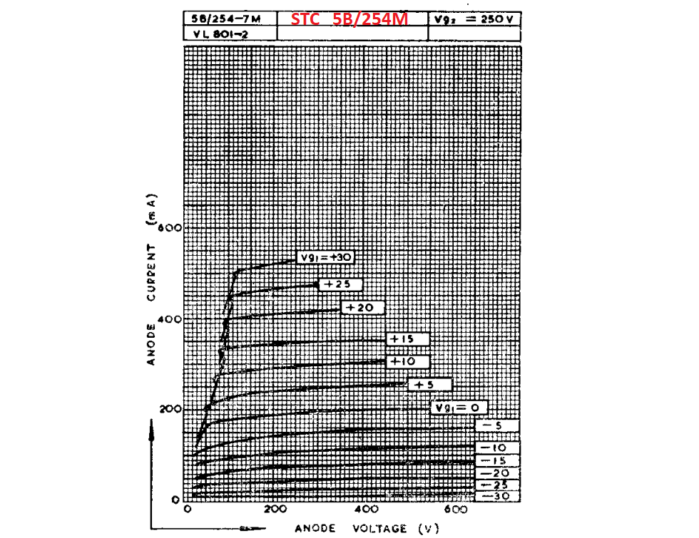

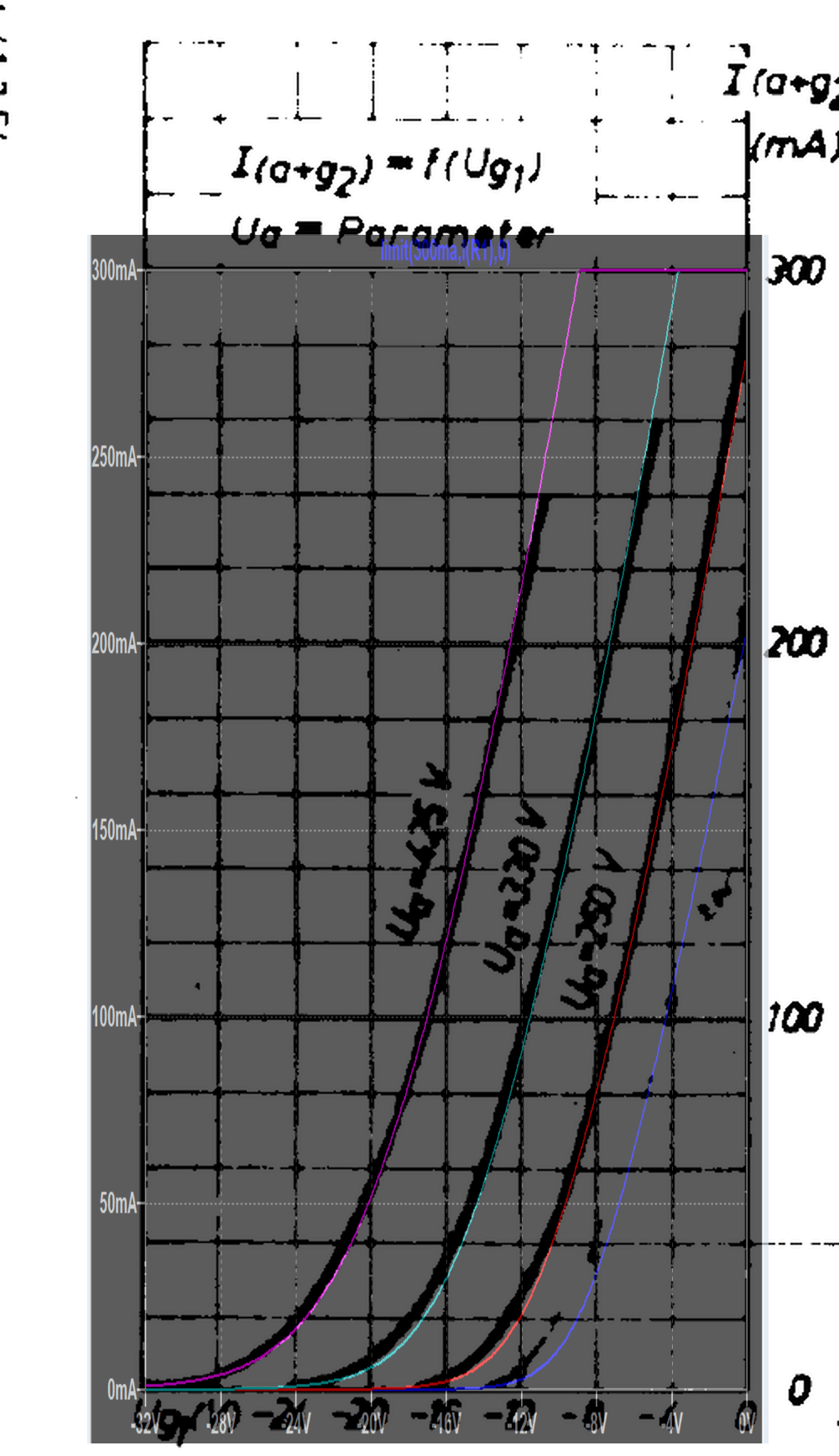

Have some issures with transfer curve for 5b/254 tetrode model, see attached, will see how later.

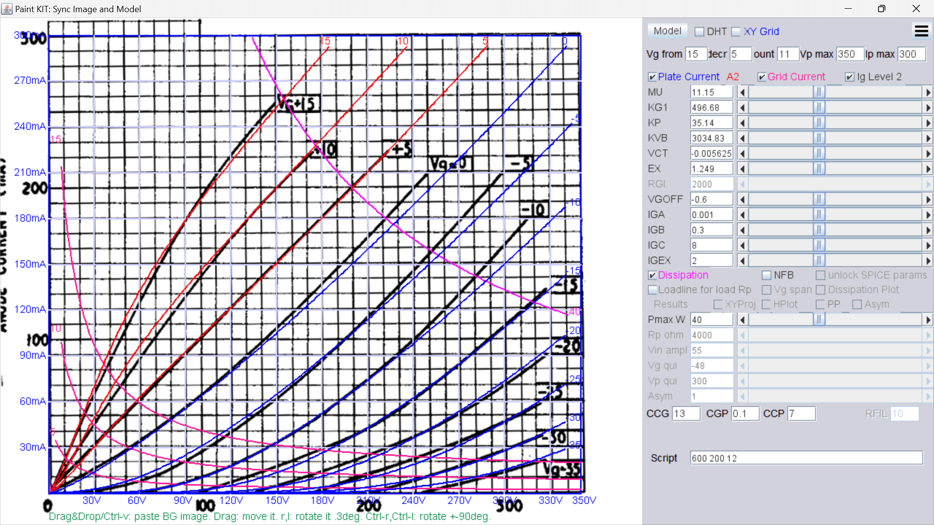

Here is 5B/254 triode model:
Code:
**** 5B254_T ** Advanced Grid Current **********************************

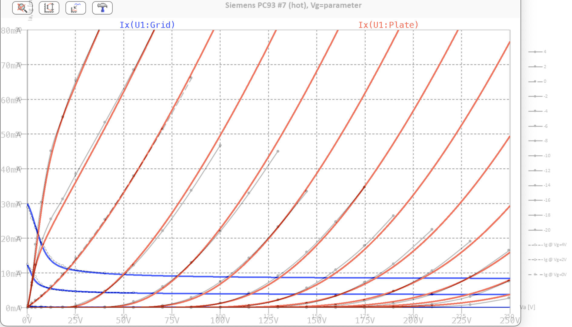

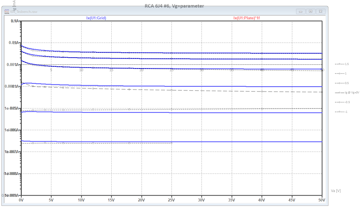

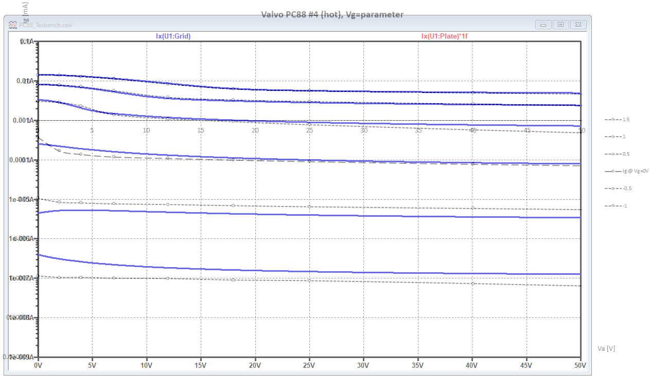

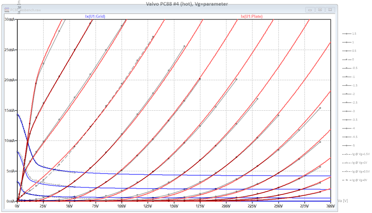

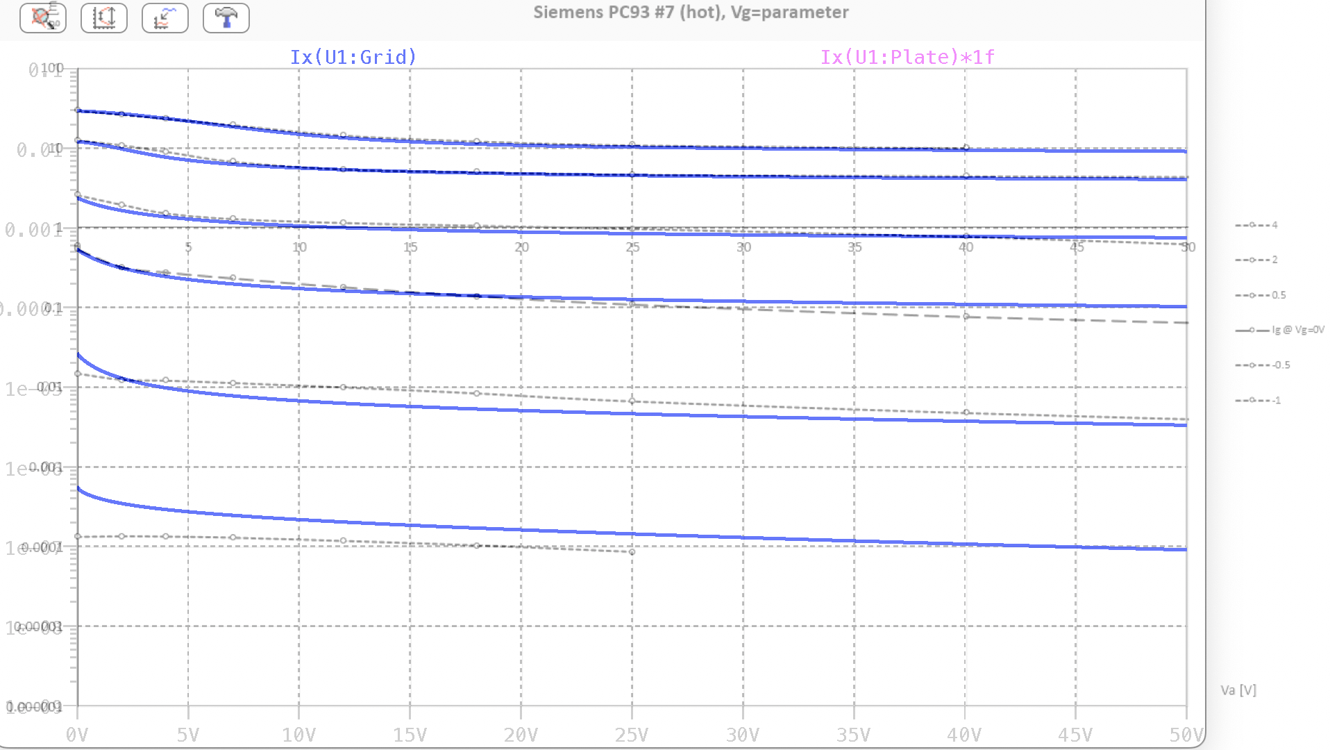

Hi all
It's been several months since I have posted anything here.

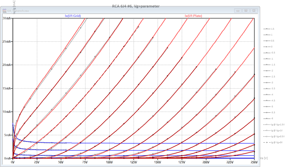

In the meantime, I created two new models, 6J4 and PC88. (PC93 and PC86 on half way)
Note that the 6J4 has quite a bit a hungry heater, while the PC88 suffers under significant sample tolerances ( the Philips a bit less than the Valvo types).
Code:
*6J4 LTspice model based on the generic triode model from Adrian Immler, version i6
*A version log is at the end of this file
*100h BurnIn of 10 RCA tubes, sample selection and measurements done in January 2023
*Params fitted to the measured values by Adrian Immler, January 2023
*This model is accurate for Vg up to 1.5V.
*The high fit quality is presented at adrianimmler.simplesite.com
*History's best of tube describing art (plus some new ideas) is merged to this new approach.
*@ neg. Vg, Ia accuracy is similar to Koren models, and unrivaled for remote cutoff triodes
*@ small neg. Vg, the "Anlauf" current is considered.
*@ pos. Vg, Ig and Ia accuracy is on an unrivaled level (including neg. Va range!)
*This offers new simulation possibilities like grid resistor bias, backward plate modulated stages,
*Audion radio circuits, low voltage amps, guitar distortion stages or pulsed stages.

Hi all
A further model of mine...
This time the PC93. Note that this tube, while keeping its heater power moderate, provides an exceptional low plate resistance of less than 2kOhm!
BR Adrian
Code:
*PC93 LTspice model based on the generic triode model from Adrian Immler, version i6
*100h BurnIn of 10 Siemens tubes, sample selection and measurements done in April 2023
*Params fitted to the measured values by Adrian Immler, April 2023
*This model is accurate for Vg up to 4V.

... and here the PC88 model.
BR Adrian
Hi all
This hour, I recognized convergence issues of my PC88 model I provided some days ago, when the model is used in dc-coupled stages.
This is because I forgot to tune a parameter - this is now done!
So, here the new, more stable PC88 model:
Code:
*PC88 LTspice model based on the generic triode model from Adrian Immler, version i6
*100h BurnIn of 6 Philips and 8 Valvo tubes, sample selection and measurements done in January 2023

PS: I have also to check the 6J4 model. I will do this tomorrow.
