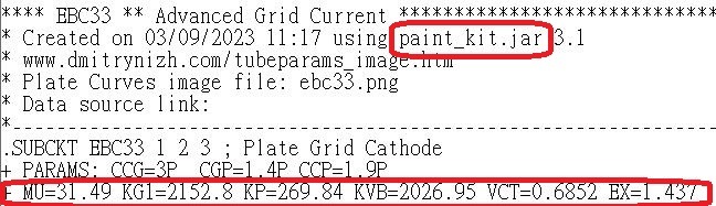

@Ray Waters
Hi Ray, Thanks for your advice.
I tried you way but it didn't work, I think it's about the format, it's ok if you use paint_kip.jar to make it, just like the sticker below.

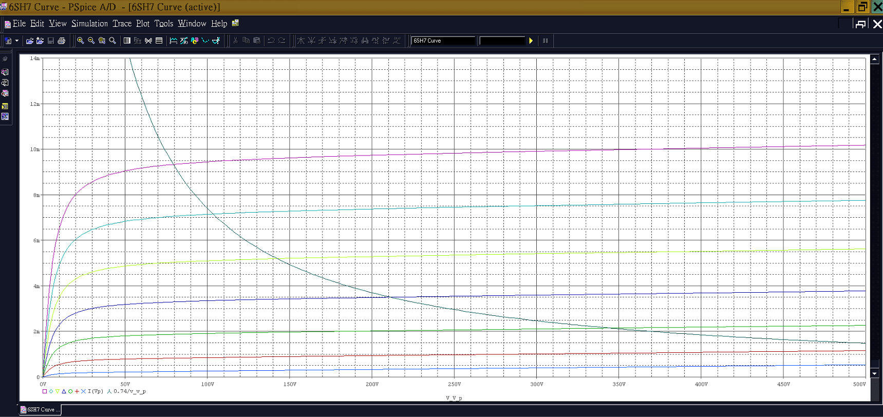

I'm learning to use paint_kip.jar, this is a very rough model, just for reference.
** 6SH7 ****************************************
* .SUBCKT 6SH7 P G2 G K ; LTSpice tetrode.asy pinout
.SUBCKT 6SH7 P G K G2 ; Koren Pentode Pspice pinout
RE1 7 0 1G ; DUMMY SO NODE 7 HAS 2 CONNECTIONS
E1 7 0 VALUE= ; E1 BREAKS UP LONG EQUATION FOR G1.
+{V(G2,K)/KP*LOG(1+EXP((1/MU+(VCT+V(G,K))/SQRT(KVB+V(G2,K)*V(G2,K)))*KP))}
RE2 6 0 1G ; DUMMY SO NODE 6 HAS 2 CONNECTIONS
E2 6 0 VALUE={(PWR(V(7),EX)+PWRS(V(7),EX))} ; Kg1 times KIT current
G1 P K VALUE={V(6)/KG1*ATAN((V(P,K)+KNEX)/KNEE)TANH(V(P,K)/KNEE2)(1+KLAMG*V(P,K))+KLAM*V(P,K)}
* Alexander Gurskii screen current, see audioXpress 2/2011
RE4K 4K K 1G ; Dummy, per Alex request
E4K 4K 4 VALUE={0} ; Dummy, per Alex request
G4K 4K K VALUE={V(6)/KG2*(KVC-ATAN((V(P,K)+KNEX)/KNEE)*TANH(V(P,K)/KNEE2))/(1+KLAMG*V(P,K))}
RCP P K 1G ; FOR CONVERGENCE
C1 K G {CCG} ; CATHODE-GRID 1
C2 G P {CGP} ; GRID 1-PLATE
C3 K P {CCP} ; CATHODE-PLATE
R1 G 5 {RGI} ; FOR GRID CURRENT
D3 5 K DX ; FOR GRID CURRENT }
.MODEL DX D(IS=1N RS=1 CJO=10PF TT=1N)
.ENDS
** 6SH7_T ****************************************
.SUBCKT TRIODE_6SH7_T 1 2 3 ; Plate Grid Cathode
E1 7 0 VALUE={V(1,3)/KP*LOG(1+EXP(KP*(1/MU+(VCT+V(2,3))/SQRT(KVB+V(1,3)*V(1,3)))))}
RE1 7 0 1G ; TO AVOID FLOATING NODES
G1 1 3 VALUE={(PWR(V(7),EX)+PWRS(V(7),EX))/KG1}
RCP 1 3 1G ; TO AVOID FLOATING NODES
C1 2 3 {CCG} ; CATHODE-GRID
C2 2 1 {CGP} ; GRID=PLATE
C3 1 3 {CCP} ; CATHODE-PLATE
D3 5 3 DX ; POSITIVE GRID CURRENT
R1 2 5 {RGI} ; POSITIVE GRID CURRENT
.ENDS
- Created on 09/08/2023 23:21 using paint_kip.jar
- www.dmitrynizh.com/tubeparams_image.htm
- Plate Curves image file: 6SH7_P.jpg
- Data source link: <plate curves URL>
- PARAMS: MU=32.47 KG1=2200 KP=354.38 KVB=14.16 VCT=0.136 EX=1.635 KG2=4284 KNEE=5.245 KVC=2.57
- KLAM=7.392E-7 KLAMG=1.039E-5 KNEE2=16.2 KNEX=37.2 KNK=-0.044 KNG=0.006
- CCG=8.5P CGP=0.003P CCP=7P RGI=2000.0
- Vp_MAX=500 Ip_MAX=14 Vg_step=0.5 Vg_start=0 Vg_count=7
- X_MIN=72 Y_MIN=73 X_SIZE=796 Y_SIZE=558 FSZ_X=1591 FSZ_Y=823 XYGrid=false
- Rp=39000 Vg_ac=-1.5 P_max=2 Vg_qui=-1.5 Vp_qui=334.26
- showLoadLine=y showIp=y isDHP=n isPP=n isAsymPP=n isUL=n showDissipLimit=y
- showIg1=n isInputSnapped=n addLocalNFB=n
- XYProjections=n harmonicPlot=y dissipPlot=n
- UL=0.43 EG2=100 gridLevel2=n addKink=n isTanhKnee=y advSigmoid=n
.ENDS

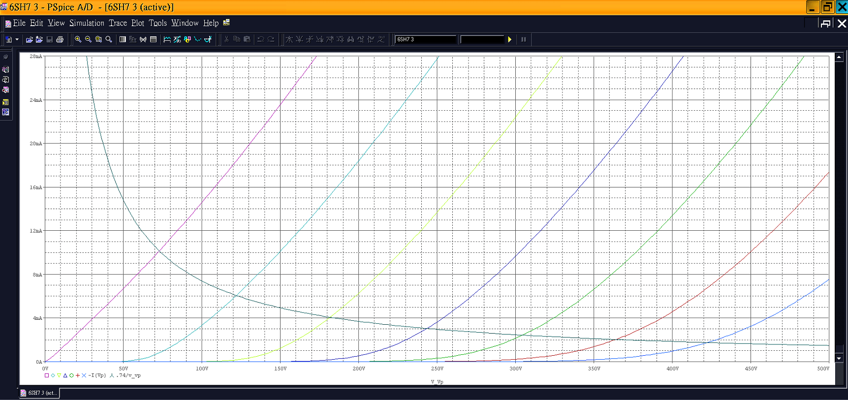

- Created on 09/08/2023 20:34 using paint_kit.jar 3.1
- Plate Curves image file: 6SH7_T.jpg
- Data source link:
- PARAMS: CCG=8.5P CGP=0.003P CCP=7.0P RGI=2000
- MU=39.31 KG1=540 KP=310 KVB=387 VCT=0.326 EX=1.302
- Vp_MAX=500 Ip_MAX=28 Vg_step=2 Vg_start=0 Vg_count=7
- Rp=18000 Vg_ac=6 P_max=3 Vg_qui=-6 Vp_qui=290
- X_MIN=90 Y_MIN=79 X_SIZE=797 Y_SIZE=561 FSZ_X=1507 FSZ_Y=763 XYGrid=false
- showLoadLine=y showIp=y isDHT=n isPP=n isAsymPP=n showDissipLimit=y
- showIg1=n gridLevel2=n isInputSnapped=n
- XYProjections=n harmonicPlot=n dissipPlot=n
.ENDS

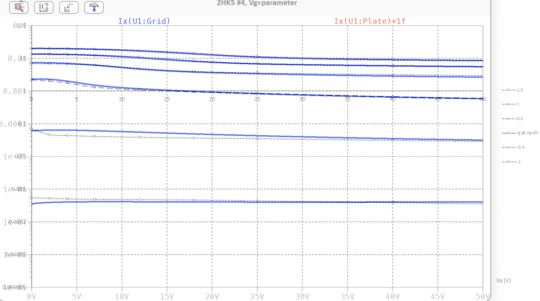

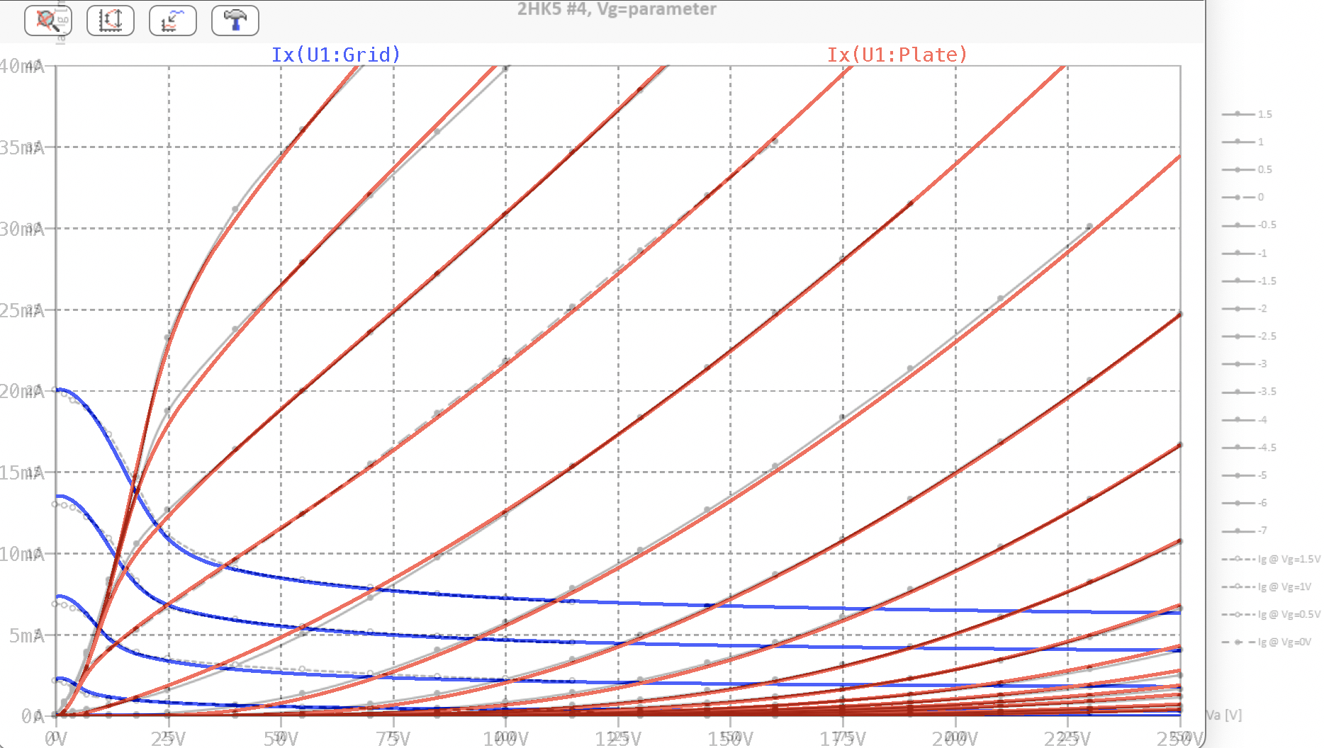

Hi all
Just a further model of mine... This time the 2HK5, which offers a "lot of tube" for not too much of money:
mu=75
gm = 15mA
remote cutoff feature, for automatic gain control circuits
miller cap is as low as 0.29pF (!!!)
A perfect RF tube, I would say 😉
BR Adrian
mu=75
gm = 15mA
BR Adrian
Code:
*2HK5 LTspice model based on the generic triode model from Adrian Immler, version i6
*A version log is at the end of this file
*100h BurnIn of 10 Sylvania, GE & Philco tubes, sample selection and measurements done in July 2023
*Params fitted to the measured values by Adrian Immler, Sept 2023
*The high fit quality is presented at adrianimmler.simplesite.com
*History's best of tube decribing art (plus some new ideas) is merged to this new approach.
*@ neg. Vg, Ia accuracy is similar to Koren models, and unrivaled for remote cutoff triodes
*@ small neg. Vg, the "Anlauf" current is considered.
*@ pos. Vg, Ig and Ia accuracy is on a unrivaled level (including neg. Va range!)
*This offers new simulation possibilities like grid resistor bias, backward plate modulated stages,
*Audion radio circuits, low voltage amps, guitar distortion stages or pulsed stages.
*All 2HK5 electrode designs found so far were identical => manufacturer not mentioned in the suffix
