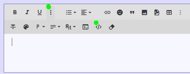

Could you please share them as code? That will allow us just cut and paste. You can wrap your models with
Sorry for me being lazy
Code:
your model text here

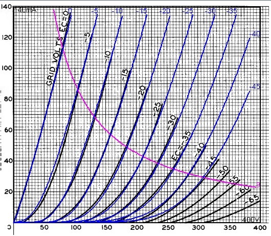

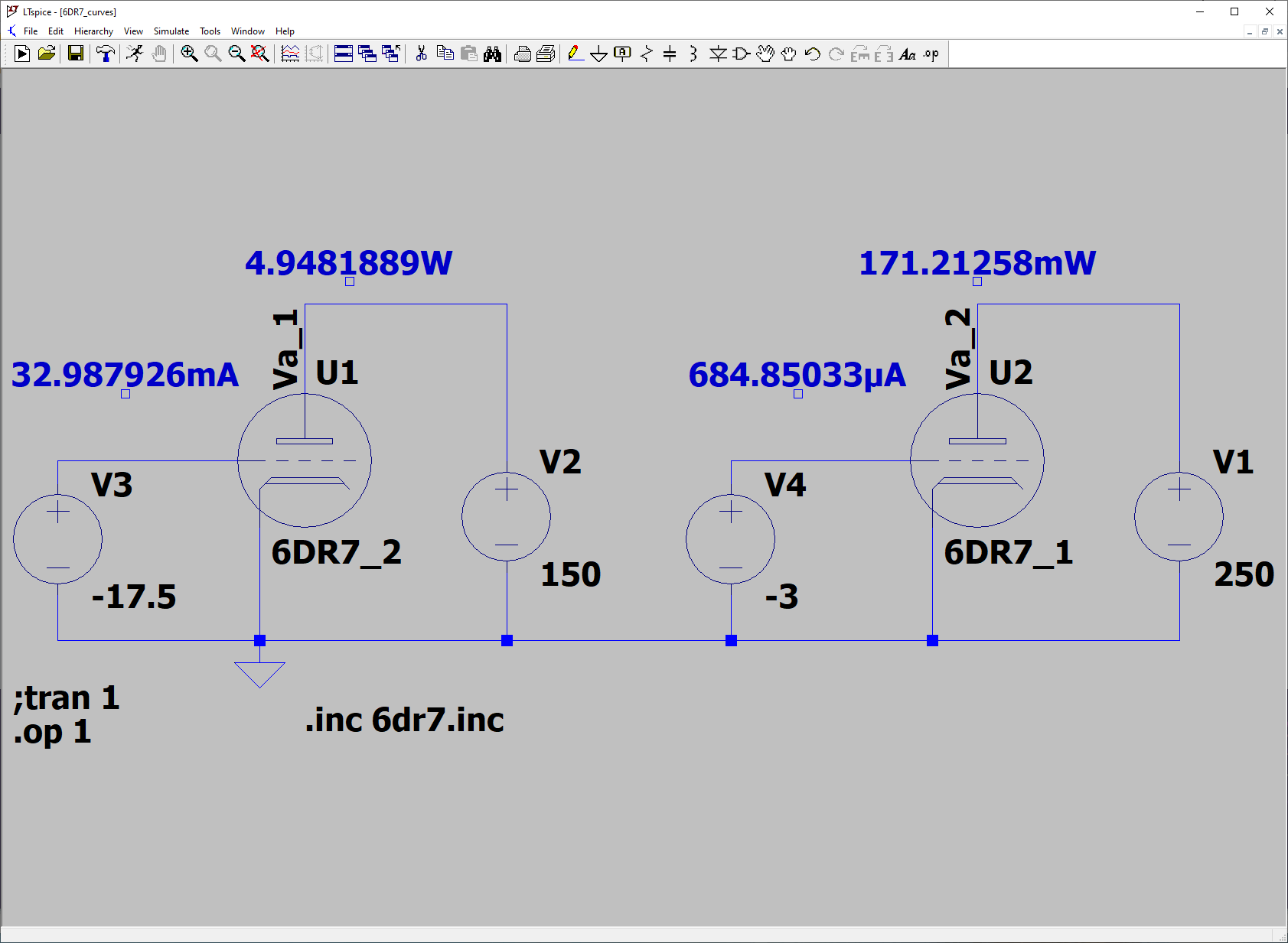

@qiuchun63 Using the Class A sample in the datasheet I get a decent match for the high powered section, but not good for the low powered one. The anode current is expected to be around 1.4mA, but simulation shows 0.68mA.

There are no '^'s in the model. It executes properly, I do not see any errors in the log. It is just the operating point for the low power triode way off when I use LTSpice.
