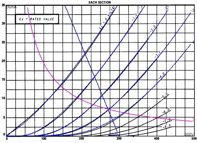

Pretty good match on this one, thank you! The operating point example in the datasheet matches pretty well 👍.6A10A model
Code:[B]** 6AC10A ****************************************[/B] [LIST] [*]Created on 12/07/2023 15:17 using paint_kit.jar 3.1 [*]www.dmitrynizh.com/tubeparams_image.htm [*]Plate Curves image file: [*]Data source link: [/LIST] *---------------------------------------------------------------------------------- .SUBCKT 6AC10A 1 2 3 ; Plate Grid Cathode [LIST] [*]PARAMS: CCG=2.4P CGP=1.3P CCP=0.22P RGI=2000 [*]MU=102.82 KG1=285 KP=164 KVB=1.875 VCT=0.112 EX=1.372 [/LIST] [LIST] [*]Vp_MAX=500 Ip_MAX=36 Vg_step=1 Vg_start=0 Vg_count=5 [*]Rp=4000 Vg_ac=55 P_max=40 Vg_qui=-48 Vp_qui=300 [*]X_MIN=24 Y_MIN=19 X_SIZE=656 Y_SIZE=456 FSZ_X=1260 FSZ_Y=630 XYGrid=false [*]showLoadLine=y showIp=y isDHT=n isPP=n isAsymPP=n showDissipLimit=y [*]showIg1=n gridLevel2=n isInputSnapped=n [*]XYProjections=n harmonicPlot=n dissipPlot=n [/LIST] *---------------------------------------------------------------------------------- ... [/QUOTE]
I don't know if this C3g simulation model is correct.

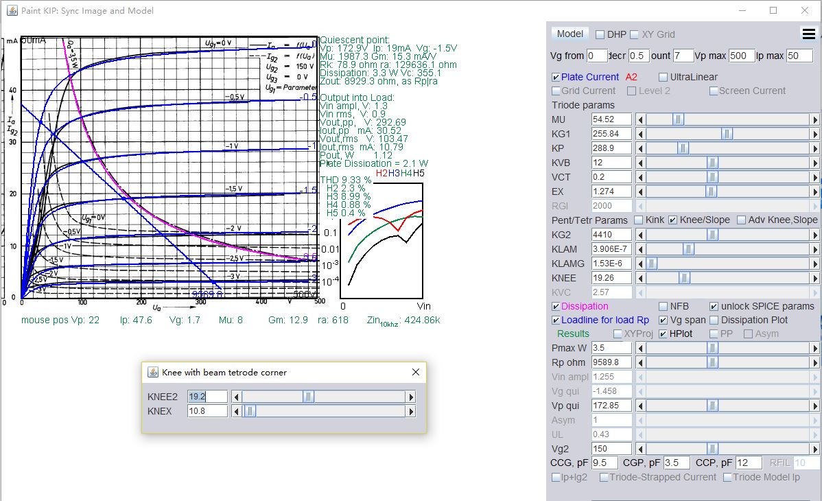

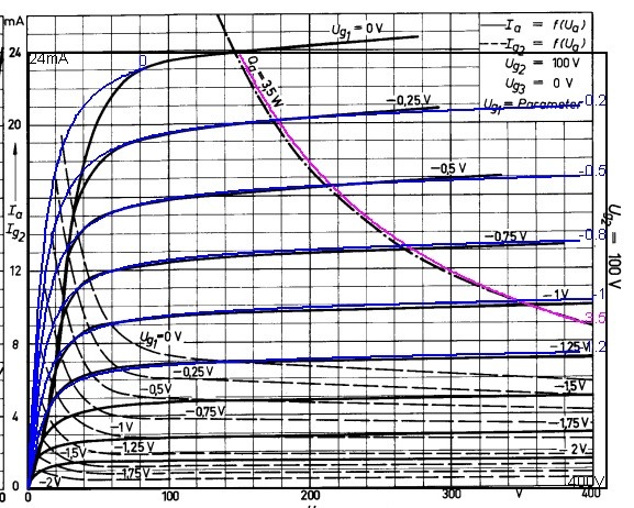

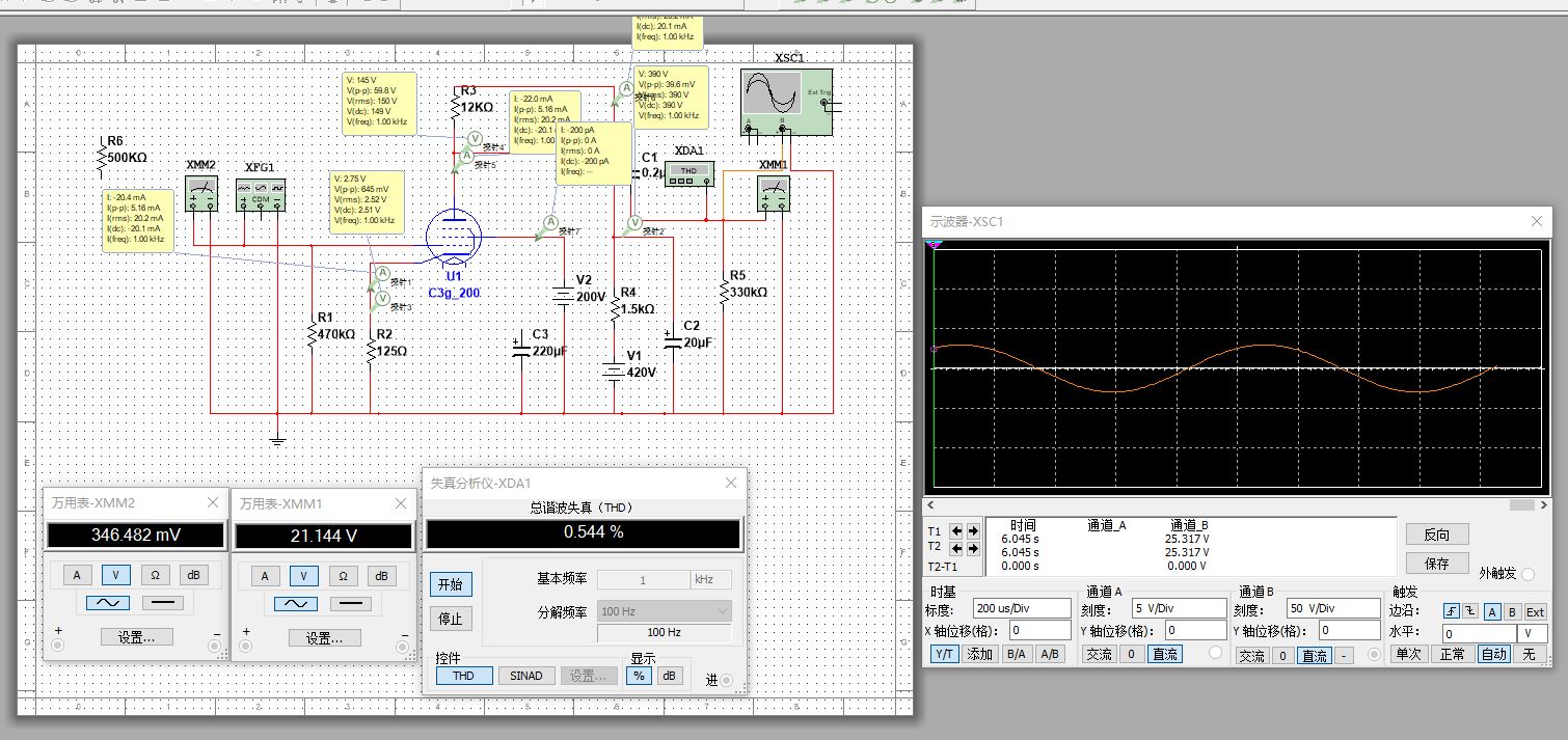

I use paint_ Kip tried multiple times but couldn't generate the correct simulation model for the five level transistor. Can anyone tell me the correct method? Thank you!

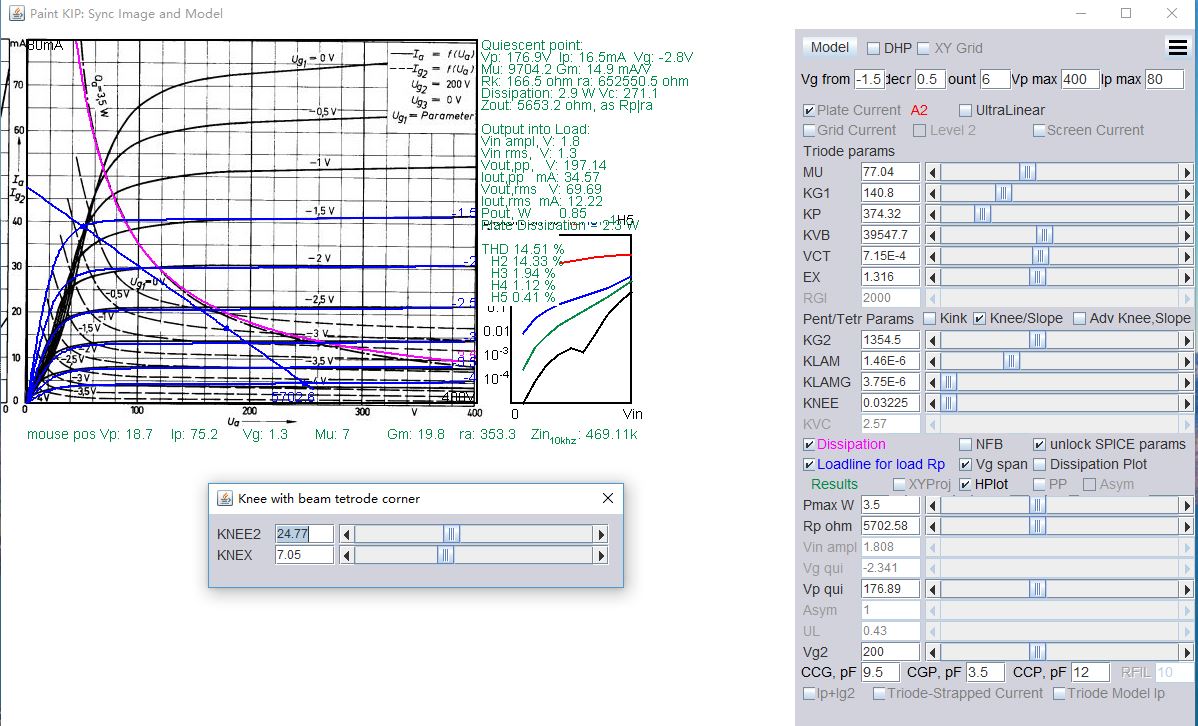

After continuous exploration, I should have a preliminary understanding of the simulation model generation method for the five level tube.
C3g Model:
C3g Model:
Code:

.SUBCKT C3g P G2 G K ; LTSpice tetrode.asy pinout
* .SUBCKT TEST P G K G2 ; Koren Pentode Pspice pinout
+ PARAMS: MU=77.04 KG1=140.8 KP=374.32 KVB=39547.7 VCT=7.15E-4 EX=1.316 KG2=1354.5 KNEE=0.03225 KVC=2.57
+ KLAM=1.46E-6 KLAMG=3.75E-6 KNEE2=24.77 KNEX=7.05 KNK=-0.0944 KNG=3E-5

C3g G2=150V Model:
Code:

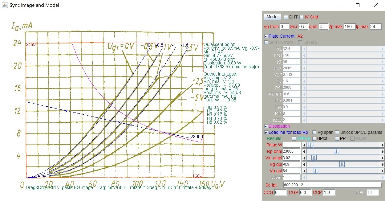

Hello !Hello ,
I'm looking for 6K4P-ev LtSpice model in Triode mode
Thanks for any help
Nobody to help ?
Hi Ciu
I tried ti achieve an acceptable fit with my model, but failed. It is most probably the same with the Paint Tool. This tube seems to be veeeery non-linear, unfortunately.
BR Adrian
BR Adrian
** 6K4P ****************************************Hello ,
Thanks for any help

Thank you, EL8, for your model.
If you would have plotted also curves for Vg=-2.5V and Vg=-5V, one would see the fitting issues I mentioned…
BR Adrian
BR Adrian
I guess the -5V is a marking error, it is only -3.5V or -4V, then the model will easy to create

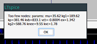

The 6E6P model returns the error message below. Is anyone aware of an alternate pentode mode version? Thanks.Here is correction of scale of 6e6p-e pentode mode:
