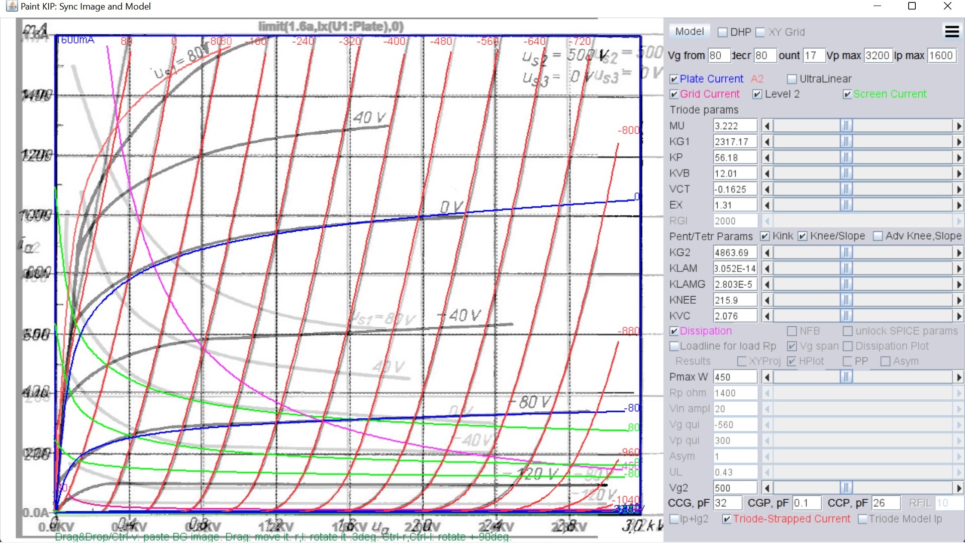

Gu81/ГУ81 pentode model for sharing:
Code:
**** GU81 ******************************************
* Created on 02/17/2022 20:50 using paint_kip.jar
* www.dmitrynizh.com/tubeparams_image.htm
* Plate Curves image file: GU81.jpg
* Data source link: <plate curves URL>
.SUBCKT GU81 P G2 G K ; LTSpice tetrode.asy pinout
* .SUBCKT GU81 P G K G2 ; Koren Pentode Pspice pinout
+ PARAMS: MU=3.222 KG1=2317.17 KP=56.18 KVB=12.01 VCT=-0.1625 EX=1.31 KG2=4863.69 KNEE=215.9 KVC=2.076
+ KLAM=3.052E-14 KLAMG=2.803E-5 KNEE2=65.37 KNEX=166.47  KNK=3.763E-8 KNG=0.02817 KNPL=4.092E-9 KNSL=31537.46 KNPR=10600.24 KNSR=16388.67
+ CCG=32P CGP=0.1P CCP=26P VGOFF=-0.6 IGA=0.001 IGB=0.465 IGC=1.68 IGEX=1.84
* Vp_MAX=3200 Ip_MAX=1600 Vg_step=80 Vg_start=80 Vg_count=17
* X_MIN=73 Y_MIN=24 X_SIZE=776 Y_SIZE=633 FSZ_X=1296 FSZ_Y=736 XYGrid=false
* Rp=1400 Vg_ac=20 P_max=450 Vg_qui=-560 Vp_qui=300
* showLoadLine=n showIp=y isDHP=n isPP=n isAsymPP=n isUL=n showDissipLimit=y
* showIg1=y isInputSnapped=y addLocalNFB=n
* XYProjections=n harmonicPlot=y dissipPlot=n
* UL=0.43 EG2=500 gridLevel2=y addKink=y isTanhKnee=y advSigmoid=n
RE1  7 0  1G    ; DUMMY SO NODE 7 HAS 2 CONNECTIONS
E1   7 0  VALUE=  ; E1 BREAKS UP LONG EQUATION FOR G1.
+{V(G2,K)/KP*LOG(1+EXP((1/MU+(VCT+V(G,K))/SQRT(KVB+V(G2,K)*V(G2,K)))*KP))}
RE2  6 0  1G    ; DUMMY SO NODE 6 HAS 2 CONNECTIONS
E2  6 0  VALUE={(PWR(V(7),EX)+PWRS(V(7),EX))} ; Kg1 times KIT current
RE21 21 0 1
E21  21 0 VALUE={V(6)/KG1*ATAN((V(P,K)+KNEX)/KNEE)*TANH(V(P,K)/KNEE2)} ; Ip with knee but no slope and no kink
RE22 22 0 1 ; E22: kink curr deviation for plate
E22  22 0 VALUE={V(21)*LIMIT(KNK-V(G,K)*KNG,0,0.3)*(-ATAN((V(P,K)-KNPL)/KNSL)+ATAN((V(P,K)-KNPR)/KNSR))}
G1   P  K  VALUE={V(21)*(1+KLAMG*V(P,K))+KLAM*V(P,K) + V(22)}
* Alexander Gurskii screen current, see audioXpress 2/2011, with slope and kink added
RE43 43 K 1G ; Dummy
E43  43 G2 VALUE={0} ; Dummy
G2   43 K  VALUE={V(6)/KG2*(KVC-ATAN((V(P,K)+KNEX)/KNEE)*TANH(V(P,K)/KNEE2))/(1+KLAMG*V(P,K))-V(22)}
RCP  P K  1G     ; FOR CONVERGENCE
C1   K G  {CCG}  ; CATHODE-GRID 1
C2   G P  {CGP}  ; GRID 1-PLATE
C3   K P  {CCP}  ; CATHODE-PLATE
RE23 G 0 1G
GG G K VALUE={(IGA+IGB/(IGC+V(P,K)))*(MU/KG1)*
+(PWR(V(G,K)-VGOFF,IGEX)+PWRS(V(G,K)-VGOFF,IGEX))}
.ENDS

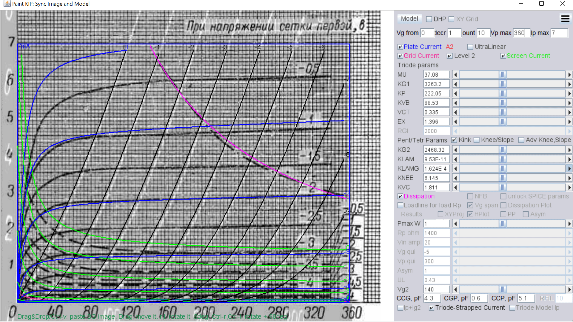

6J32P 6Ж32П model
Code:
**** 6J32P1 ******************************************
* Created on 02/26/2022 21:08 using paint_kip.jar
* Plate Curves image file: 6j32p1.png
.SUBCKT 6J32P P G2 G K ; LTSpice tetrode.asy pinout
* .SUBCKT 6J32P1 P G K G2 ; Koren Pentode Pspice pinout
+ PARAMS: MU=37.08 KG1=3263.2 KP=222.05 KVB=88.53 VCT=0.335 EX=1.396 KG2=2468.32 KNEE=6.145 KVC=1.811
+ KLAM=9.53E-11 KLAMG=1.624E-4   KNK=-1.77E-4 KNG=7.813E-4 KNPL=16.96 KNSL=4616.62 KNPR=3540 KNSR=2674
+ CCG=4.3P CGP=0.6P CCP=5.1P VGOFF=-0.6 IGA=0.001 IGB=0.3 IGC=8 IGEX=2
* Vp_MAX=360 Ip_MAX=7 Vg_step=1 Vg_start=-0.5 Vg_count=10
* X_MIN=39 Y_MIN=75 X_SIZE=742 Y_SIZE=578 FSZ_X=1296 FSZ_Y=736 XYGrid=false
* Rp=1400 Vg_ac=20 P_max=1 Vg_qui=-5 Vp_qui=300
* UL=0.43 EG2=140 gridLevel2=y addKink=y isTanhKnee=n advSigmoid=n
RE21 21 0 1
E21  21 0 VALUE={V(6)/KG1*ATAN(V(P,K)/KNEE)} ; Ip with knee but no slope and no kink
G2   43 K  VALUE={V(6)/KG2*(KVC-ATAN(V(P,K)/KNEE))/(1+KLAMG*V(P,K))-V(22)}
RE23 G 0 1G
.ENDS

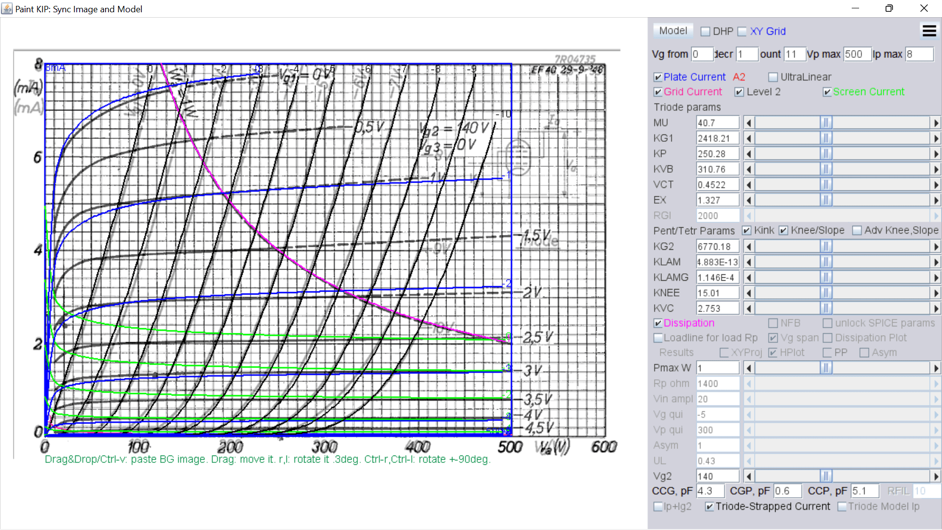

EF86 (Philips) model:
Code:
**** EF86_PL ******************************************
* Created on 02/26/2022 21:26 using paint_kip.jar
* Plate Curves image file: ef86_pl.png
.SUBCKT EF86_PL  P G2 G K ; LTSpice tetrode.asy pinout
* .SUBCKT EF86_PL P G K G2 ; Koren Pentode Pspice pinout
+ PARAMS: MU=40.7 KG1=2418.21 KP=250.28 KVB=310.76 VCT=0.4522 EX=1.327 KG2=6770.18 KNEE=15.01 KVC=2.753
+ KLAM=4.883E-13 KLAMG=1.146E-4 KNEE2=6.715 KNEX=24.2  KNK=3.906E-4 KNG=1.163E-4 KNPL=0.1016 KNSL=25.3 KNPR=9.15 KNSR=1593.19
* Vp_MAX=500 Ip_MAX=8 Vg_step=1 Vg_start=0 Vg_count=11
* X_MIN=61 Y_MIN=63 X_SIZE=634 Y_SIZE=506 FSZ_X=1296 FSZ_Y=736 XYGrid=false
* UL=0.43 EG2=140 gridLevel2=y addKink=y isTanhKnee=y advSigmoid=n
RE21 21 0 1
RE23 G 0 1G
.ENDS

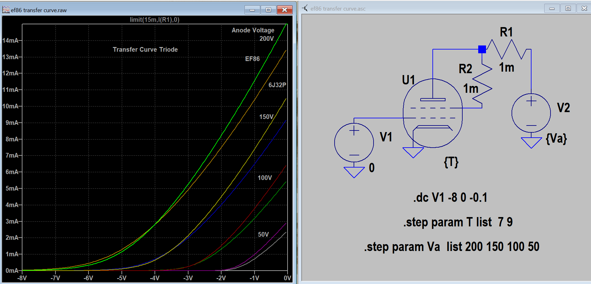

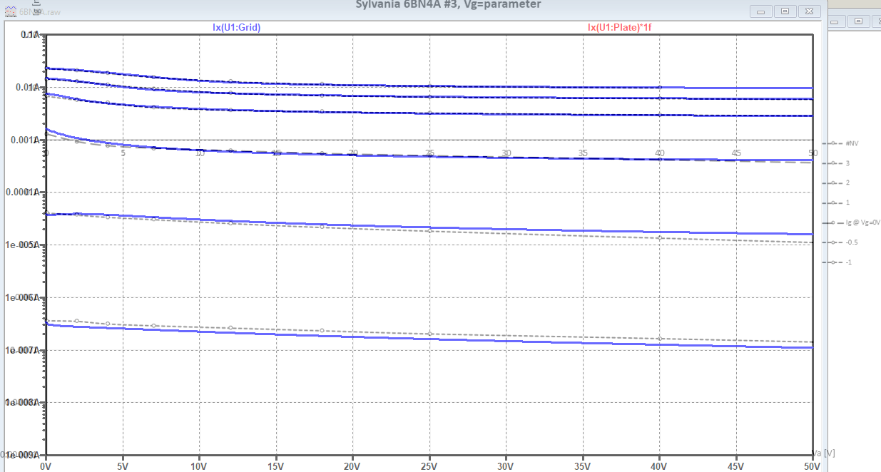

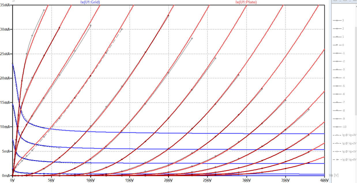

Hi all
Please note my latest model, which is a Sylvania 6BN4A. As usual, it is based on the most representative sample out of 10 burnt-in tubes.
One thing to mention: Typically, the higher the Mu, the less good a triode performs at very low anode voltages. But the 6BN4A with a Mu > 40 seems to be an exception, running well with a Supply of 60V only. So, this tube is a good choice for LoV projects.
all the best, Adrian
Code:
*6BN4A LTspice model based on the generic triode model from Adrian Immler, version i5
*Note that the 6BN4 has in average a 15% smaller gm.
*A version log is at the end of this file
*100h BurnIn of 10 Sylvania tubes, sample selection and measurements done in Febr 2022
*Params fitted to the measured values by Adrian Immler, Febr 2022
*The high fit quality is presented at adrianimmler.simplesite.com
*History's best of tube describing art (plus some new ideas) is merged to this new approach.
*@ neg. Vg, Ia accuracy is similar to Koren models, and unrivaled for remote cutoff triodes
*@ small neg. Vg, the "Anlauf" current is considered.
*@ pos. Vg, Ig and Ia accuracy is on a unrivaled level (including neg. Va range!)
*This offers new simulation possibilities like grid resistor bias, backward plate modulated stages,
*Audion radio circuits, low voltage amps, guitar distortion stages or pulsed stages.
Adrian, thanks again for another great looking model. I have a question about 6BN4A....
6BN4A looks a lot like the triode in the twin-triodes 6BQ7 and 6BZ7. No?
6BQ7A data sheet: https://frank.pocnet.net/sheets/093/6/6BQ7A.pdf
6BZ7 data sheet: https://frank.pocnet.net/sheets/093/6/6BZ7.pdf
6BN4 data sheet: https://frank.pocnet.net/sheets/093/6/6BN4.pdf
All three have mu about 40, gm about 7mA/V, rp about 5k ohms.
6BQ7A and 6BN4 have the same plate-grid capacitance, 1.2pF.
6BZ7 has Cp-g of 1.8pF.

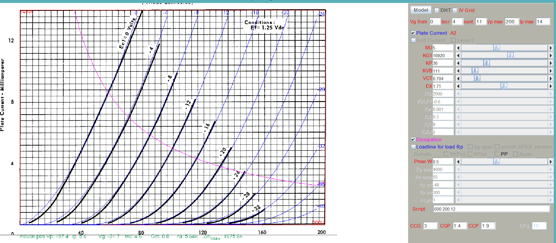

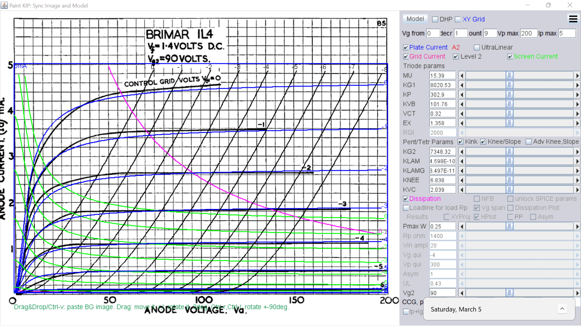

Try this 1L4 Brimar model (similar to DF92 u=11):
Code:
**** 1L4_BM ******************************************
* Created on 03/05/2022 11:08 using paint_kip.jar
* Plate Curves image file: 1L4_BM.png
.SUBCKT 1L4_BM P G2 G K ; LTSpice tetrode.asy pinout
* .SUBCKT 1L4_BM P G K G2 ; Koren Pentode Pspice pinout
+ PARAMS: MU=15.39 KG1=8020.53 KP=302.9 KVB=101.76 VCT=0.32 EX=1.358 KG2=7348.32 KNEE=6.838 KVC=2.039
+ KLAM=4.598E-10 KLAMG=8.497E-11 KNEE2=5.48 KNEX=0.00116  KNK=-0.07986 KNG=0.006 KNPL=51 KNSL=11 KNPR=121.2 KNSR=27.84
+ CCG=3.6P CGP=0.008P CCP=7.5P VGOFF=-0.6 IGA=0.001 IGB=0.3 IGC=8 IGEX=2
* Vp_MAX=200 Ip_MAX=5 Vg_step=1 Vg_start=0 Vg_count=9
* X_MIN=31 Y_MIN=117 X_SIZE=823 Y_SIZE=506 FSZ_X=1296 FSZ_Y=736 XYGrid=false
* Rp=1400 Vg_ac=20 P_max=0.25 Vg_qui=-4 Vp_qui=300
* UL=0.43 EG2=90 gridLevel2=y addKink=y isTanhKnee=y advSigmoid=n
RE21 21 0 1
RE23 G 0 1G
.ENDS

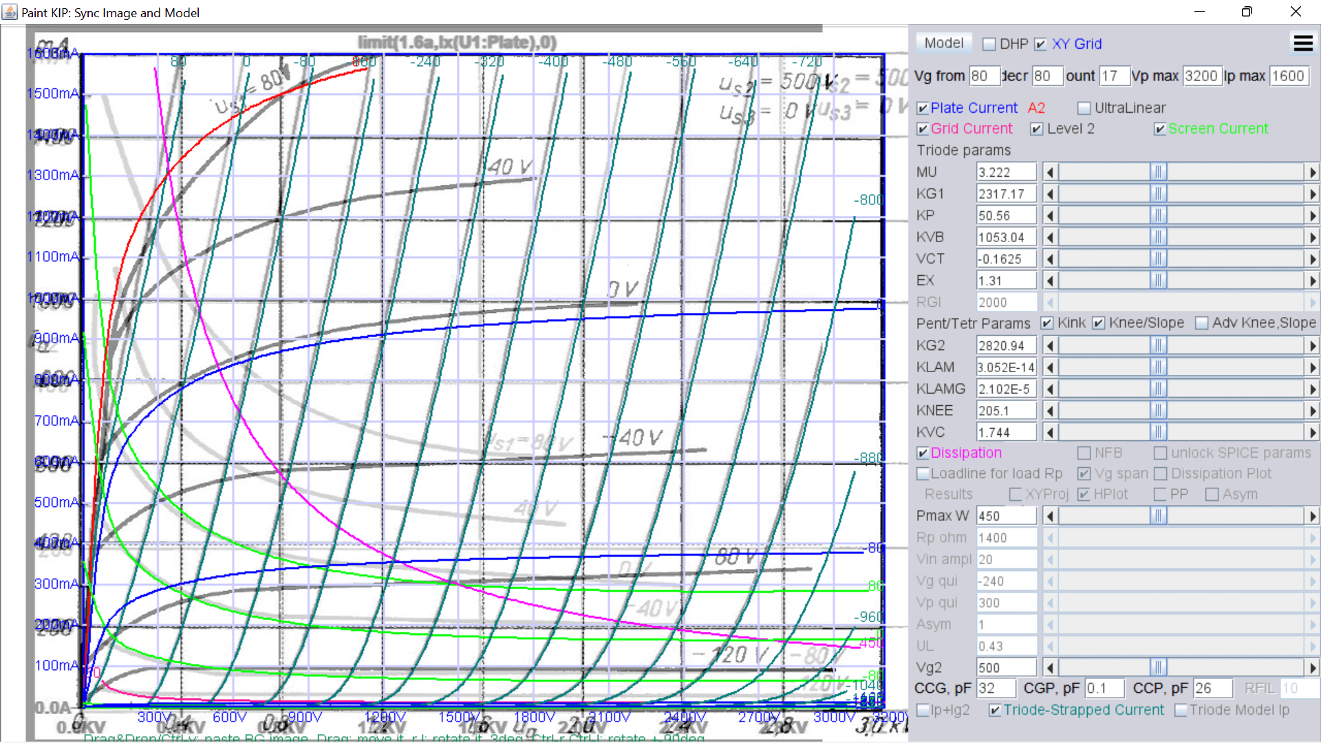

This GU81 model fixed Ig2 distortion in triode mode:
Code:
**** GU81 *****************************Fixed Ig2 distortion in triode mode*************
* Created on 03/07/2022 20:41 using paint_kip.jar
+ PARAMS: MU=3.222 KG1=2317.17 KP=50.56 KVB=1053.04 VCT=-0.1625 EX=1.31 KG2=2820.94 KNEE=205.1 KVC=1.744
+ KLAM=3.052E-14 KLAMG=2.102E-5 KNEE2=65.37 KNEX=166.47  KNK=1.92 KNG=0.007113 KNPL=4.665E-9 KNSL=18291.73 KNPR=11978.27 KNSR=4.615E6
* Vp_MAX=3200 Ip_MAX=1600 Vg_step=40 Vg_start=80 Vg_count=17
* X_MIN=81 Y_MIN=29 X_SIZE=776 Y_SIZE=633 FSZ_X=1296 FSZ_Y=736 XYGrid=true
* Rp=1400 Vg_ac=20 P_max=450 Vg_qui=-240 Vp_qui=300
RE21 21 0 1
RE23 G 0 1G
.ENDS

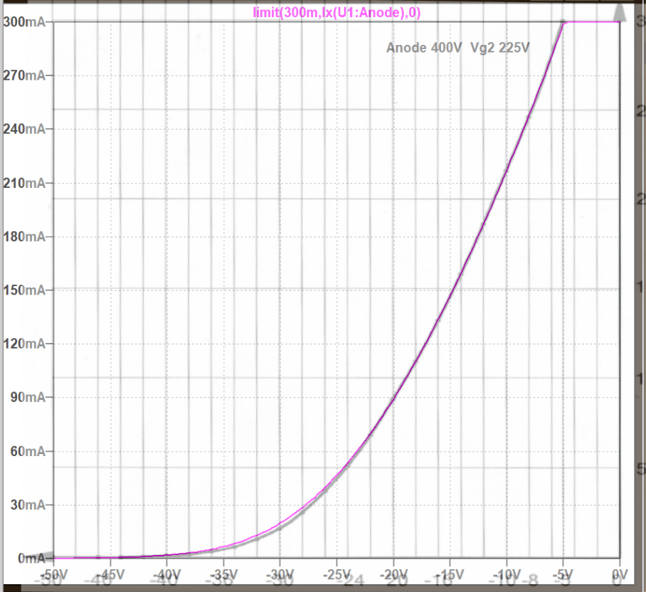

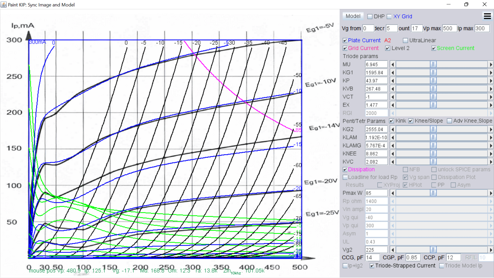

KT170 Tung-Sol model:
Code:
**** KT170 ******************************************
* Created on 03/09/2022 08:16 using paint_kip.jar
* Plate Curves image file: kt170.png
.SUBCKT KT170 P G2 G K ; LTSpice tetrode.asy pinout
* .SUBCKT KT170 P G K G2 ; Koren Pentode Pspice pinout
+ PARAMS: MU=6.945 KG1=1595.84 KP=43.97 KVB=267.48 VCT=-1 EX=1.477 KG2=2555.04 KNEE=8.862 KVC=2.082
+ KLAM=1.192E-10 KLAMG=5.767E-4 KNEE2=8.118 KNEX=2.103  KNK=-0.01984 KNG=0.01526 KNPL=24.4 KNSL=20.41 KNPR=110.34 KNSR=70.72
+ CCG=14P CGP=0.85P CCP=12P VGOFF=-1.5 IGA=0.002788 IGB=0.156 IGC=6.16 IGEX=1.86
* Vp_MAX=500 Ip_MAX=300 Vg_step=5 Vg_start=0 Vg_count=17
* X_MIN=75 Y_MIN=80 X_SIZE=707 Y_SIZE=566 FSZ_X=1296 FSZ_Y=736 XYGrid=false
* Rp=1400 Vg_ac=20 P_max=85 Vg_qui=-40 Vp_qui=300
* UL=0.43 EG2=225 gridLevel2=y addKink=y isTanhKnee=y advSigmoid=n
RE21 21 0 1
RE23 G 0 1G
.ENDS

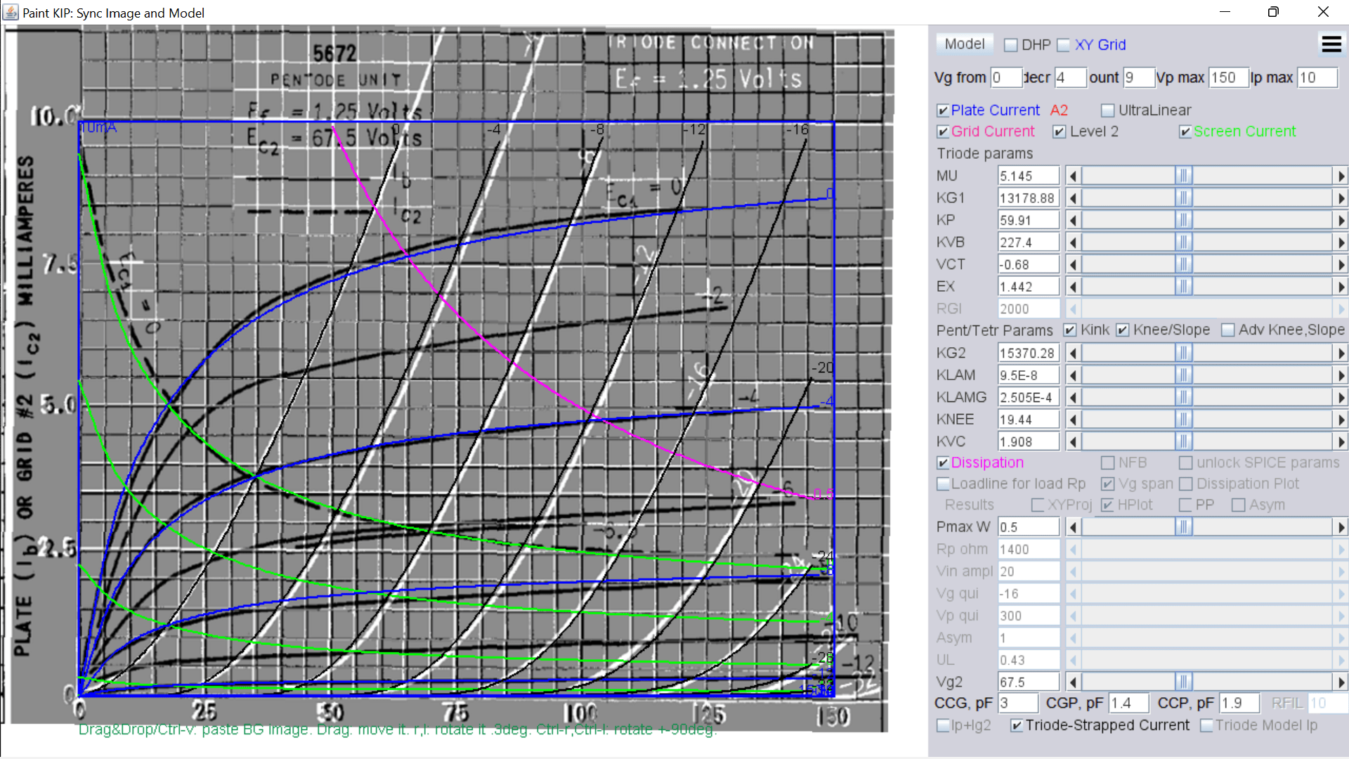

does anybody has a Model for the 5672 subminiature tube?
I tried using Paint_kit and had some success with the triode mode curves, but could not match the pentode curves.
Do the parameters need to be the same when using paint_kit and paint_kip? The triode strapped mode of paint_kip also did not produce similar results.
Try to merge the pentode and triode curve, Mu used is same as triode (Pentode has it's own Mu=Gm*Rl). I can't find the interelectrode capacitance, if you find it, replaced them. 5672P Tung-Sol model:
Code:
**** 5672P ******************************************
* Created on 03/30/2022 15:39 using paint_kip.jar
* Plate Curves image file: 5672p.png
.SUBCKT 5672P P G2 G K ; LTSpice tetrode.asy pinout
* .SUBCKT 5672P P G K G2 ; Koren Pentode Pspice pinout
+ PARAMS: MU=5.145 KG1=13178.88 KP=59.91 KVB=227.4 VCT=-0.68 EX=1.442 KG2=15370.28 KNEE=19.44 KVC=1.908
+ KLAM=9.5E-8 KLAMG=2.505E-4 KNEE2=4.559 KNEX=5.7  KNK=-0.044 KNG=0.006 KNPL=50 KNSL=11 KNPR=120 KNSR=29
+ CCG=3P CGP=1.4P CCP=1.9P VGOFF=-0.6 IGA=0.001 IGB=0.3 IGC=8 IGEX=2
* Vp_MAX=150 Ip_MAX=10 Vg_step=4 Vg_start=0 Vg_count=9
* X_MIN=74 Y_MIN=92 X_SIZE=717 Y_SIZE=545 FSZ_X=1298 FSZ_Y=738 XYGrid=false
* Rp=1400 Vg_ac=20 P_max=0.5 Vg_qui=-16 Vp_qui=300
* UL=0.43 EG2=67.5 gridLevel2=y addKink=y isTanhKnee=y advSigmoid=n
RE21 21 0 1
RE23 G 0 1G
.ENDS
