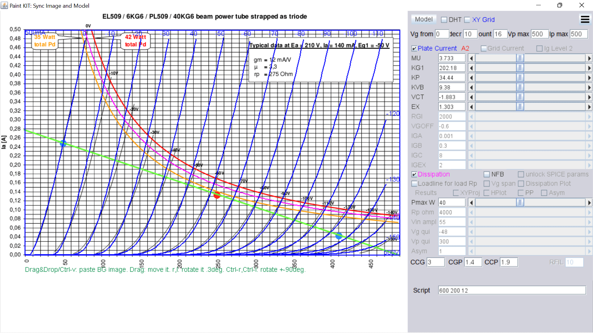

Try this model. A 6AQ5 is basically a 6V6 in a 7 pin miniature bottle.Do any of you have the Spice model of the 6AQ5 Triode?

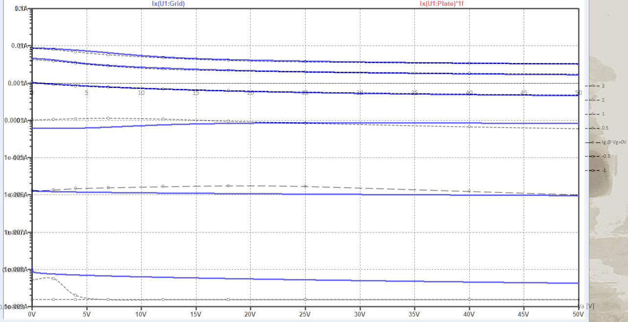

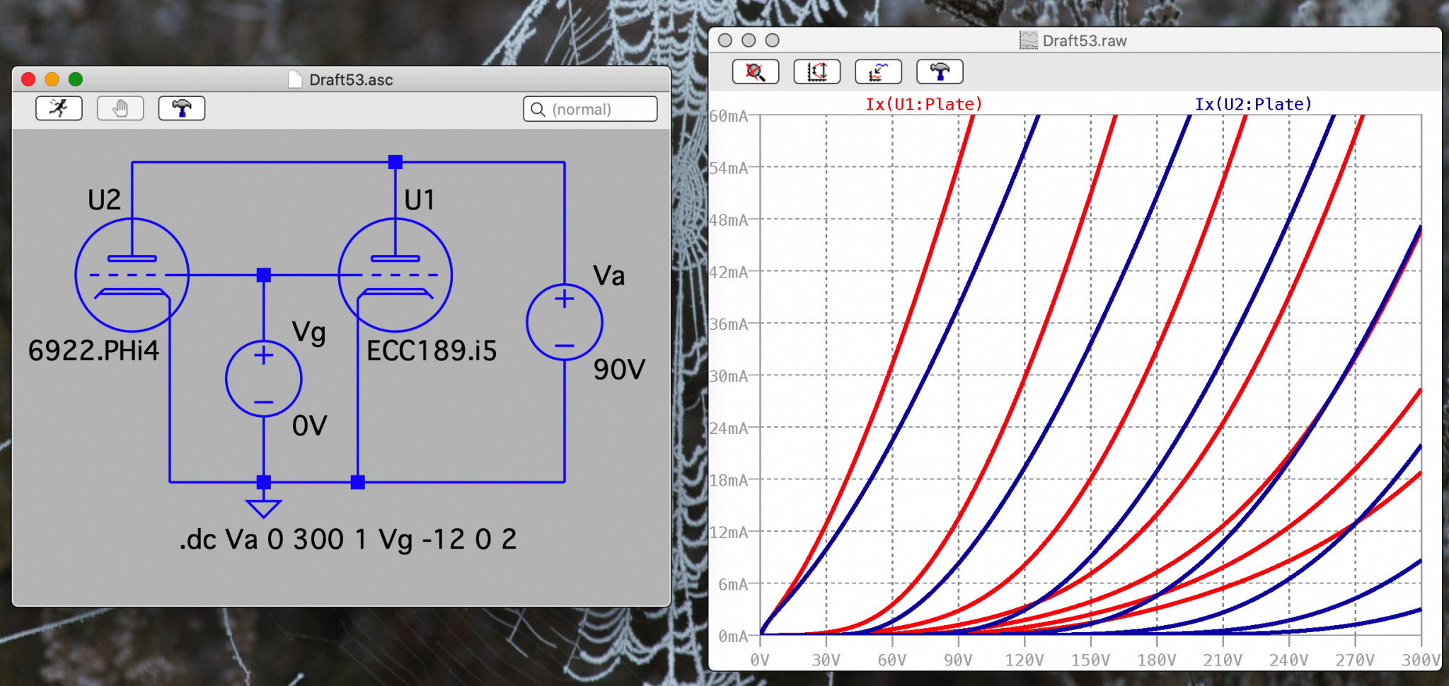

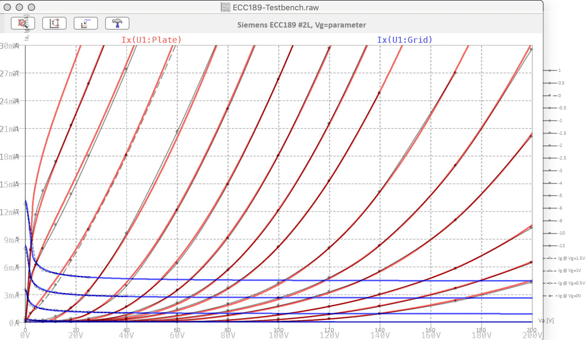

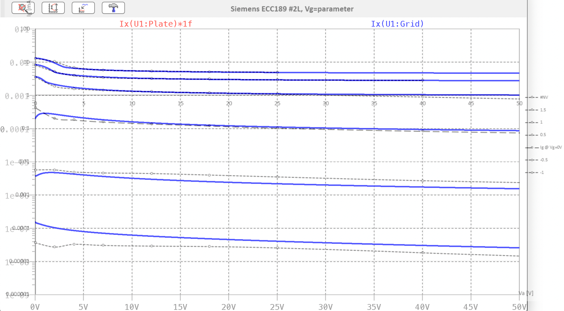

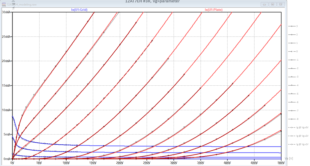

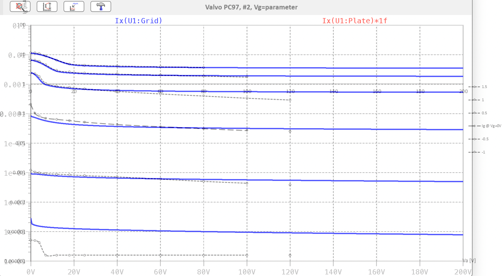

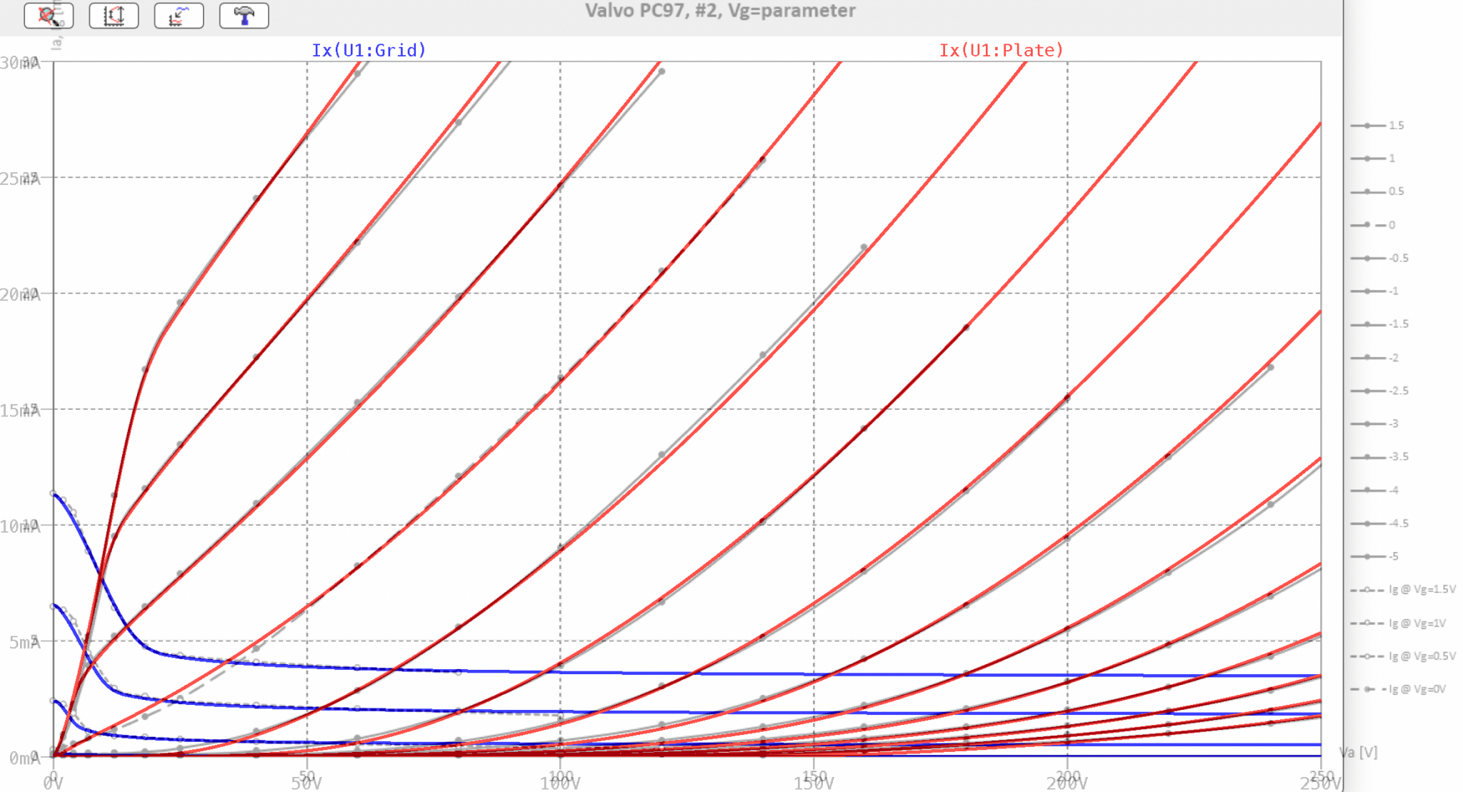

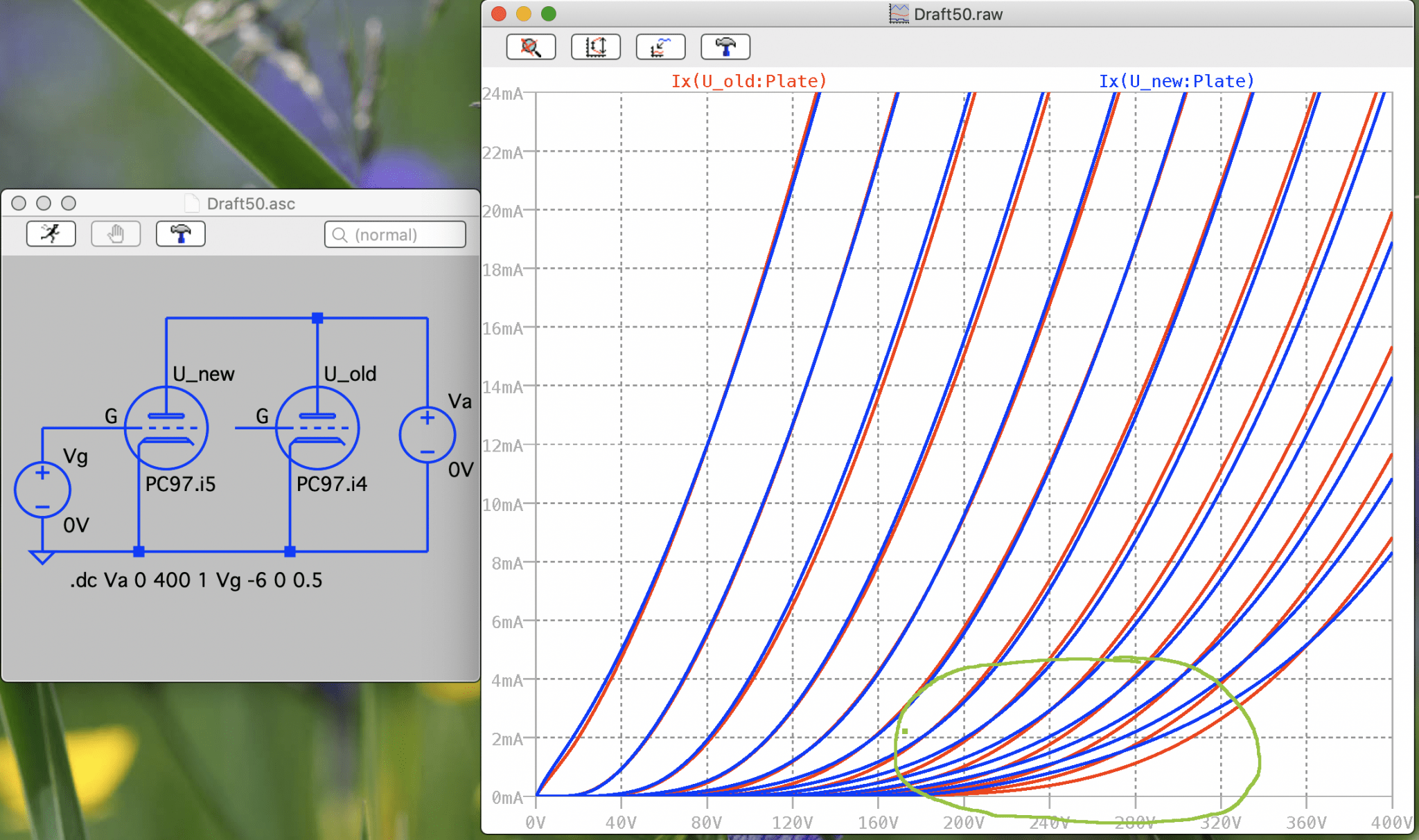

Hi all
Some new models of mine:
12AT7EH.i5 - in difference to the older i4 model of this tube, the curves are now measured not manually, but with my iTracer. Note that this tube turned out as one with quite close tolerances.
PC97.i5 - in difference to the older i4 model of this tube, the i5 mimics much better the remote cutoff behavior. See green marked zone in the attached graph. This tube might be interesting for AGC circuits (signal compressors).
BR Adrian
BR Adrian

Hi all
As announced, here the ECC189.i5 model.
Cheers!

Thanks for that important hint, Rongon. I attached a comparison graph, so everybody can see the BIG difference.

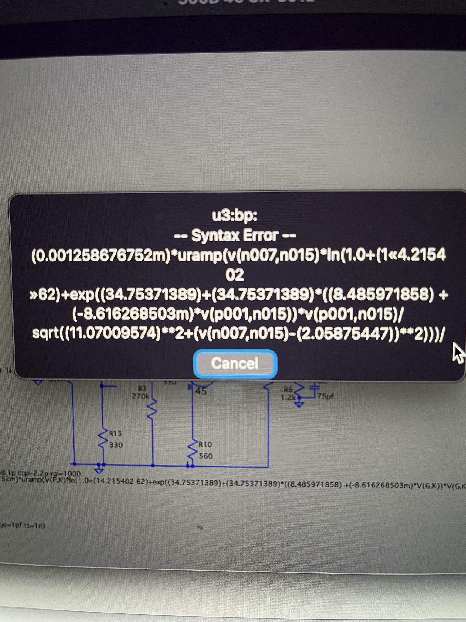

Code:
* cx-301a LTSpice model
.subckt cx-301a P G K
+ params: ccg=3.1p cgp=8.1p ccp=2.2p rgi=1000
Bp P K I=(0.001258676752m)*uramp(V(P,K)*ln(1.0+(14.21540262)+exp((34.75371389)+(34.75371389)*((8.485971858)+(-8.616268503m)*V(G,K))*V(G,K)/sqrt((11.07009574)**2+(V(P,K)-(2.05875447))**2)))/(34.75371389))**(1.88212582)
rcp 1 3 1g
c1 2 3 {ccg}
c2 1 2 {cgp}
c3 1 3 {ccp}
r1 2 5 {rgi}
d3 6 3 dx
.model dx d(is=1n rs=1 cjo=1pf tt=1n)
.ends cx-301a

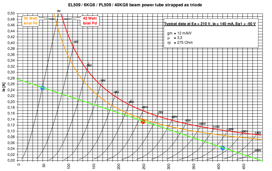

Hello everyone!
Is there a model for the EL509/6KG6 in triode mode? I could only find the pentode model here.
Thank you!
Thank you!
Normal I don't build a separate model for triode, as you'll get triode mode when you connect grid 2 to plate. Here is specific triode model based on the curve found here: http://www.dissident-audio.com/Yves/EL509-Triode.gif

- www.dmitrynizh.com/tubeparams_image.htm
- Plate Curves image file: EL509_TF-T.png
- Data source link:
.SUBCKT EL509_T 1 2 3 ; Plate Grid Cathode
- PARAMS: CCG=3P CGP=1.4P CCP=1.9P RGI=2000
- MU=3.733 KG1=202.18 KP=34.44 KVB=9.38 VCT=-1.883 EX=1.303
- Vp_MAX=500 Ip_MAX=500 Vg_step=10 Vg_start=0 Vg_count=16
- Rp=4000 Vg_ac=55 P_max=40 Vg_qui=-48 Vp_qui=300
- X_MIN=68 Y_MIN=43 X_SIZE=809 Y_SIZE=486 FSZ_X=1296 FSZ_Y=736 XYGrid=false
- showLoadLine=n showIp=y isDHT=n isPP=n isAsymPP=n showDissipLimit=y
- showIg1=n gridLevel2=n isInputSnapped=n
- XYProjections=n harmonicPlot=n dissipPlot=n

I'm getting syntax errors, probably due to the bullets in the model. Can you re-post the model using the forum's "Code" feature? Thanks.Normal I don't build a separate model for triode, as you'll get triode mode when you connect grid 2 to plate. Here is specific triode model based on the curve found here: http://www.dissident-audio.com/Yves/EL509-Triode.gif
