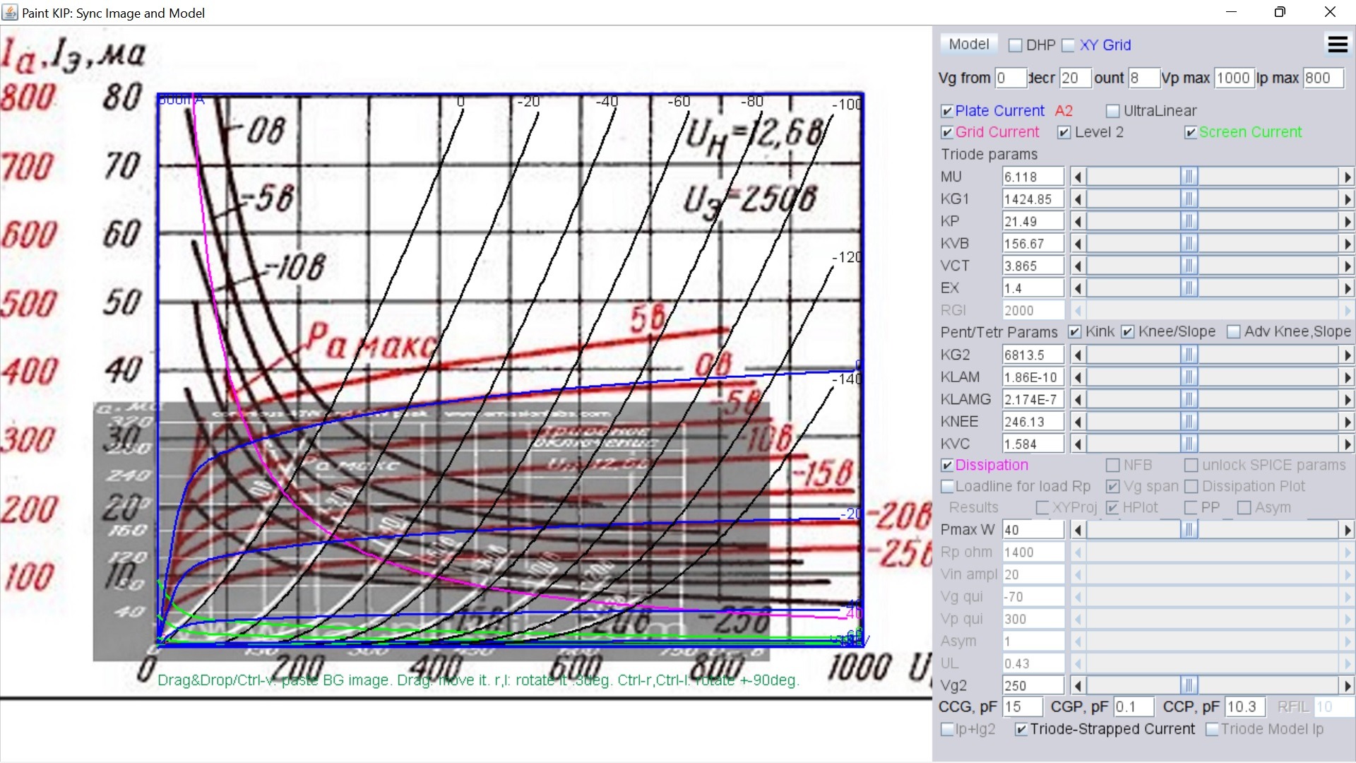

https://www.dmitrynizh.com/tubeparams_image.htm
Alternatively you can use the plotted trace curve model directly with Paint Tools or post curves here to request for the model.

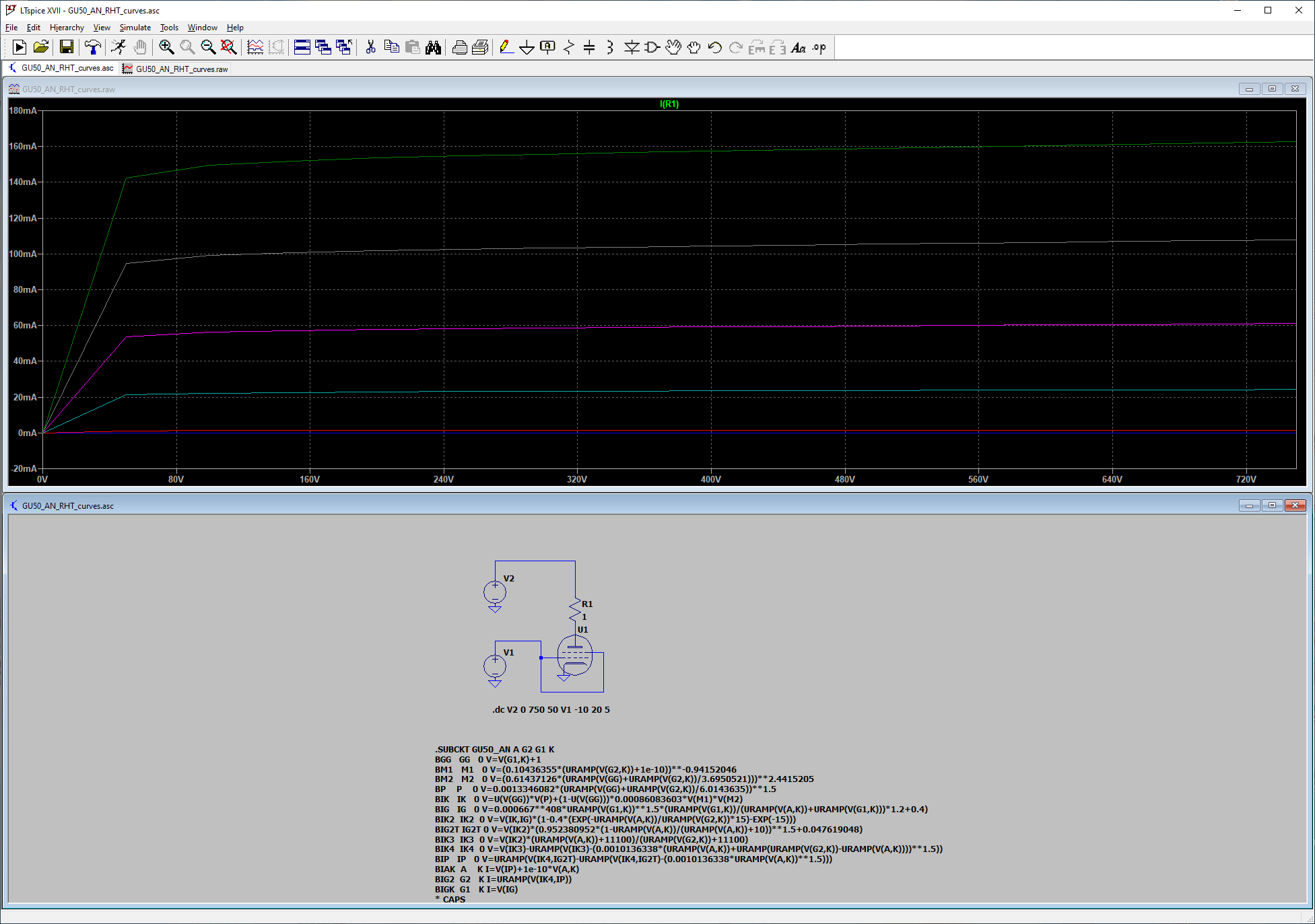

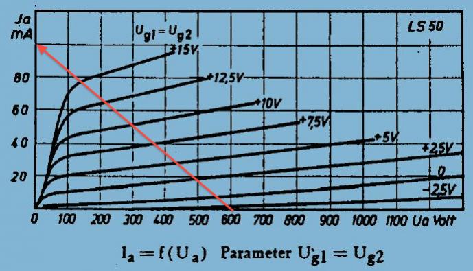

I'm trying to find a working LTSpice model for the GU-50 (LS-50) in right handed triode mode (G1+G2 together). I have done a lot of googling, but to no avail. I have seen curves, but could not find any model.
I tried to use the pentode model, connecting G1 and G2 together, but I end up having to use +300V bias to get some meaningful anode current, which obviously does not match the curves.
Any help would be appreciated.

There is GU-50 in “right-handed mode” here:
https://www.bartola.co.uk/valves/tag/gu50-right-handed-mode/I suppose you can plot it with DC sweep if you have GU50 model by connecting g2 and g1 as a variable input.

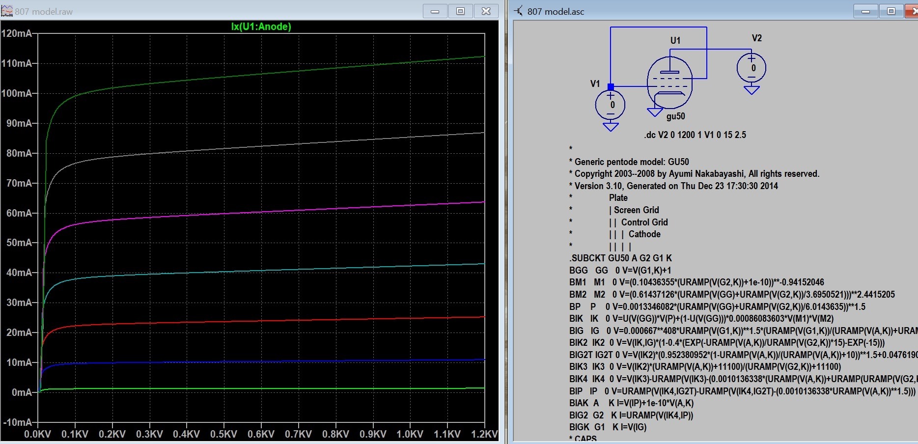

I was following those curves, yes. I realised I was using the wrong symbol for the GU50 model I used. Now I get something closer to what I expected, but the anode current is way higher than on Bartola's curvesThere is GU-50 in “right-handed mode” here:
GU50 model is found here: https://www.diyaudio.com/community/threads/g2-using-mosfet-ultralinear-feed.356896/page-2
That model gives the right results, many thanks for that!GU50 model is found here: https://www.diyaudio.com/community/threads/g2-using-mosfet-ultralinear-feed.356896/page-2

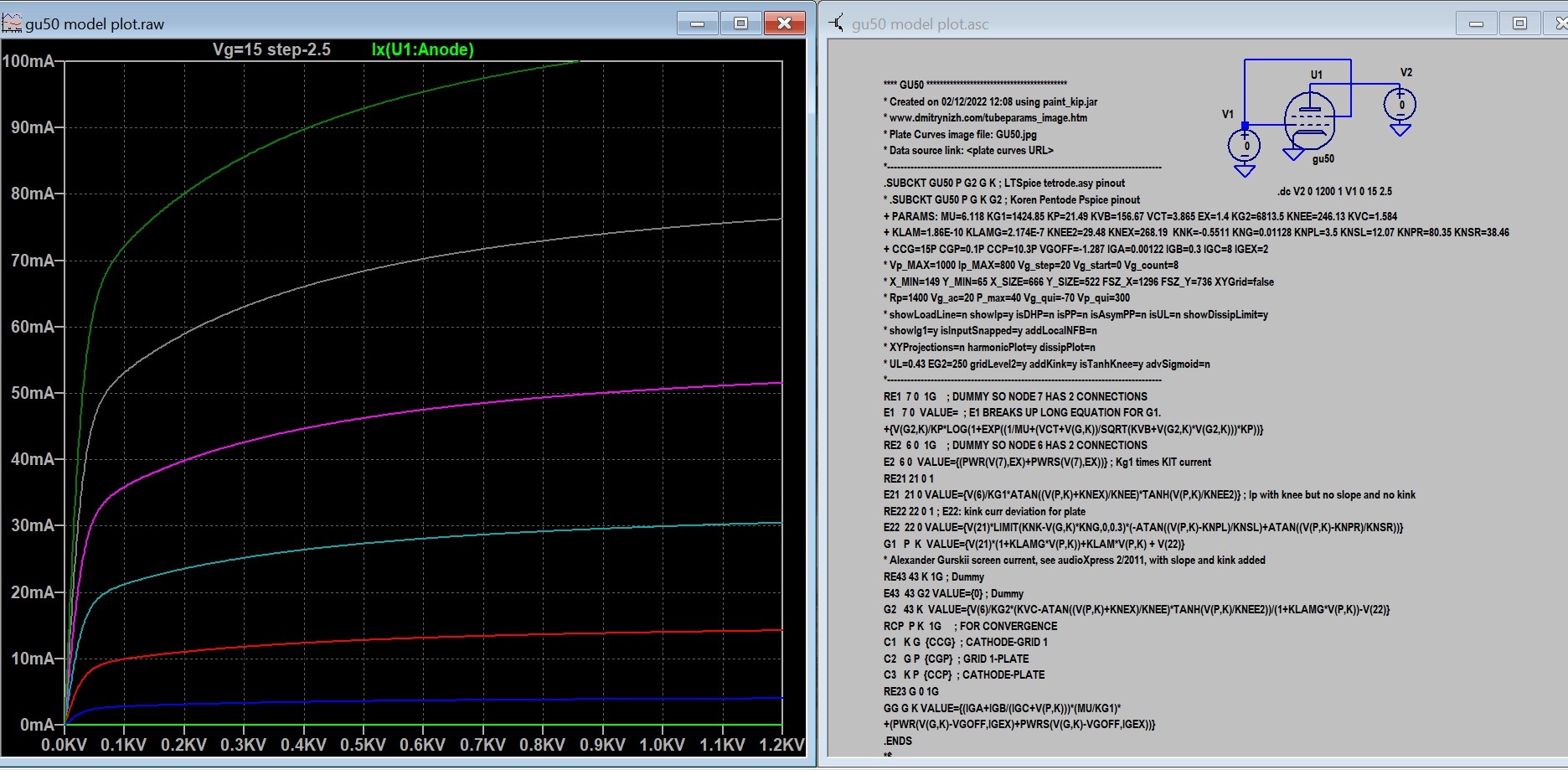

GU50 Paint Tools model:
Code:
**** GU50 ******************************************
* Created on 02/12/2022 12:08 using paint_kip.jar
* www.dmitrynizh.com/tubeparams_image.htm
* Plate Curves image file: GU50.jpg
* Data source link: <plate curves URL>
.SUBCKT GU50 P G2 G K ; LTSpice tetrode.asy pinout
* .SUBCKT GU50 P G K G2 ; Koren Pentode Pspice pinout
+ PARAMS: MU=6.118 KG1=1424.85 KP=21.49 KVB=156.67 VCT=3.865 EX=1.4 KG2=6813.5 KNEE=246.13 KVC=1.584
+ KLAM=1.86E-10 KLAMG=2.174E-7 KNEE2=29.48 KNEX=268.19 KNK=-0.5511 KNG=0.01128 KNPL=3.5 KNSL=12.07 KNPR=80.35 KNSR=38.46
+ CCG=15P CGP=0.1P CCP=10.3P VGOFF=-1.287 IGA=0.00122 IGB=0.3 IGC=8 IGEX=2
* Vp_MAX=1000 Ip_MAX=800 Vg_step=20 Vg_start=0 Vg_count=8
* X_MIN=149 Y_MIN=65 X_SIZE=666 Y_SIZE=522 FSZ_X=1296 FSZ_Y=736 XYGrid=false
* Rp=1400 Vg_ac=20 P_max=40 Vg_qui=-70 Vp_qui=300
* showLoadLine=n showIp=y isDHP=n isPP=n isAsymPP=n isUL=n showDissipLimit=y
* showIg1=y isInputSnapped=y addLocalNFB=n
* XYProjections=n harmonicPlot=y dissipPlot=n
* UL=0.43 EG2=250 gridLevel2=y addKink=y isTanhKnee=y advSigmoid=n

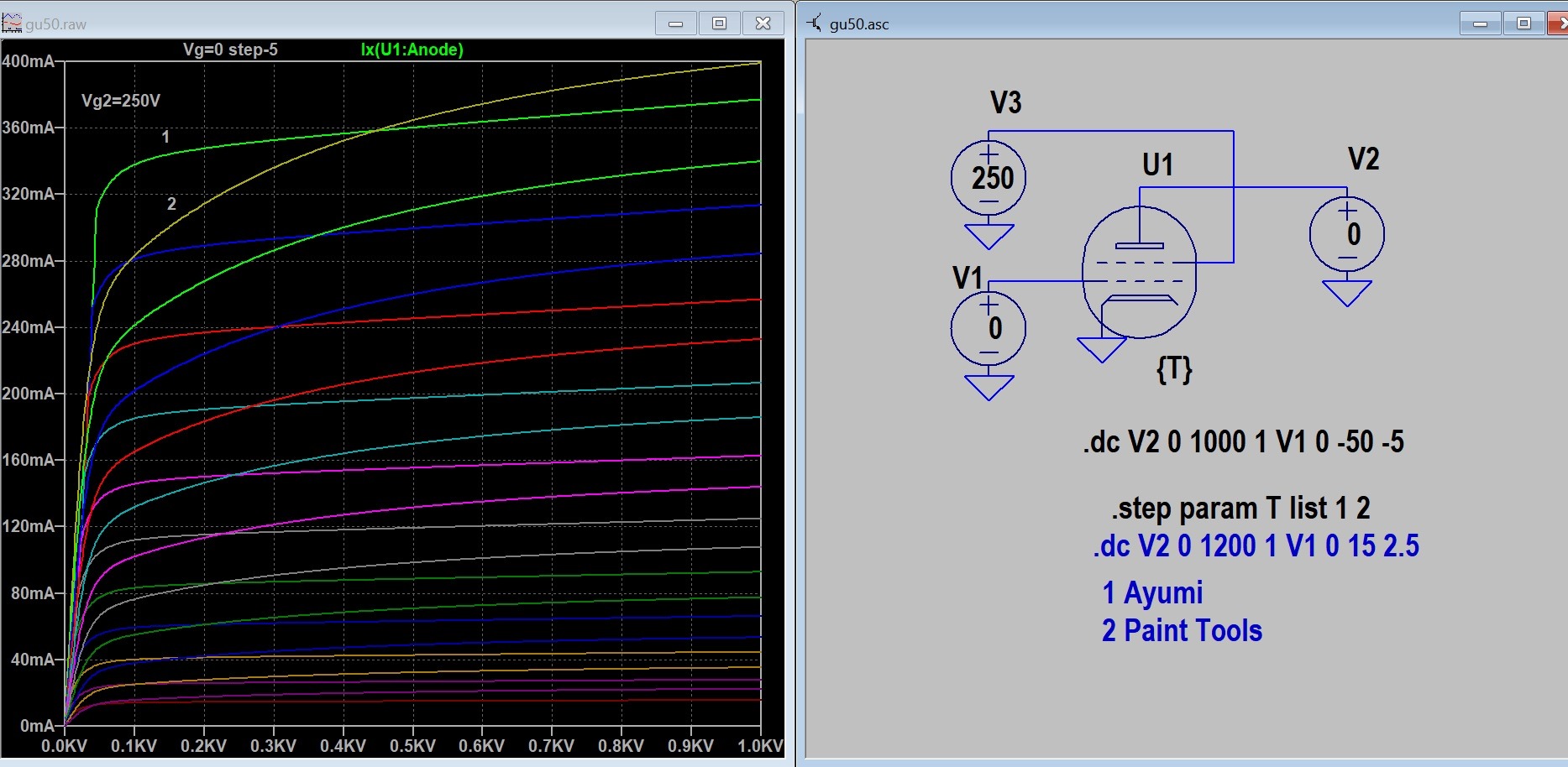

What's the difference with the previous one from your link? Just the layout?GU50 Paint Tools model:
Code:**** GU50 ****************************************** * Created on 02/12/2022 12:08 using paint_kip.jar * www.dmitrynizh.com/tubeparams_image.htm * Plate Curves image file: GU50.jpg * Data source link: <plate curves URL> *---------------------------------------------------------------------------------- .SUBCKT GU50 P G2 G K ; LTSpice tetrode.asy pinout * .SUBCKT GU50 P G K G2 ; Koren Pentode Pspice pinout + PARAMS: MU=6.118 KG1=1424.85 KP=21.49 KVB=156.67 VCT=3.865 EX=1.4 KG2=6813.5 KNEE=246.13 KVC=1.584 + KLAM=1.86E-10 KLAMG=2.174E-7 KNEE2=29.48 KNEX=268.19 KNK=-0.5511 KNG=0.01128 KNPL=3.5 KNSL=12.07 KNPR=80.35 KNSR=38.46 + CCG=15P CGP=0.1P CCP=10.3P VGOFF=-1.287 IGA=0.00122 IGB=0.3 IGC=8 IGEX=2 * Vp_MAX=1000 Ip_MAX=800 Vg_step=20 Vg_start=0 Vg_count=8 * X_MIN=149 Y_MIN=65 X_SIZE=666 Y_SIZE=522 FSZ_X=1296 FSZ_Y=736 XYGrid=false * Rp=1400 Vg_ac=20 P_max=40 Vg_qui=-70 Vp_qui=300 * showLoadLine=n showIp=y isDHP=n isPP=n isAsymPP=n isUL=n showDissipLimit=y * showIg1=y isInputSnapped=y addLocalNFB=n * XYProjections=n harmonicPlot=y dissipPlot=n * UL=0.43 EG2=250 gridLevel2=y addKink=y isTanhKnee=y advSigmoid=n *---------------------------------------------------------------------------------- RE1 7 0 1G ; DUMMY SO NODE 7 HAS 2 CONNECTIONS E1 7 0 VALUE= ; E1 BREAKS UP LONG EQUATION FOR G1. +{V(G2,K)/KP*LOG(1+EXP((1/MU+(VCT+V(G,K))/SQRT(KVB+V(G2,K)*V(G2,K)))*KP))} RE2 6 0 1G ; DUMMY SO NODE 6 HAS 2 CONNECTIONS E2 6 0 VALUE={(PWR(V(7),EX)+PWRS(V(7),EX))} ; Kg1 times KIT current RE21 21 0 1 E21 21 0 VALUE={V(6)/KG1*ATAN((V(P,K)+KNEX)/KNEE)*TANH(V(P,K)/KNEE2)} ; Ip with knee but no slope and no kink RE22 22 0 1 ; E22: kink curr deviation for plate E22 22 0 VALUE={V(21)*LIMIT(KNK-V(G,K)*KNG,0,0.3)*(-ATAN((V(P,K)-KNPL)/KNSL)+ATAN((V(P,K)-KNPR)/KNSR))} G1 P K VALUE={V(21)*(1+KLAMG*V(P,K))+KLAM*V(P,K) + V(22)} * Alexander Gurskii screen current, see audioXpress 2/2011, with slope and kink added RE43 43 K 1G ; Dummy E43 43 G2 VALUE={0} ; Dummy G2 43 K VALUE={V(6)/KG2*(KVC-ATAN((V(P,K)+KNEX)/KNEE)*TANH(V(P,K)/KNEE2))/(1+KLAMG*V(P,K))-V(22)} RCP P K 1G ; FOR CONVERGENCE C1 K G {CCG} ; CATHODE-GRID 1 C2 G P {CGP} ; GRID 1-PLATE C3 K P {CCP} ; CATHODE-PLATE RE23 G 0 1G GG G K VALUE={(IGA+IGB/(IGC+V(P,K)))*(MU/KG1)* +(PWR(V(G,K)-VGOFF,IGEX)+PWRS(V(G,K)-VGOFF,IGEX))} .ENDS *$
I found lillte information of which curve it's based on. As you can see (typical of Ayumi pentode model) it does not follow the original curve very well at left knee section I think that is enough to cause some differences (Thd distortion, power output etc..).

Thanks. Yes, models are not perfect. There are some that match reality quite well. Is a hit and miss.I found lillte information of which curve it's based on. As you can see (typical of Ayumi pentode model) it does not follow the original curve very well at left knee section I think that is enough to cause some differences (Thd distortion, power output etc..).
