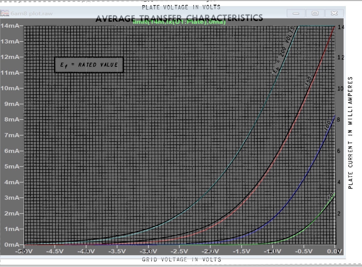

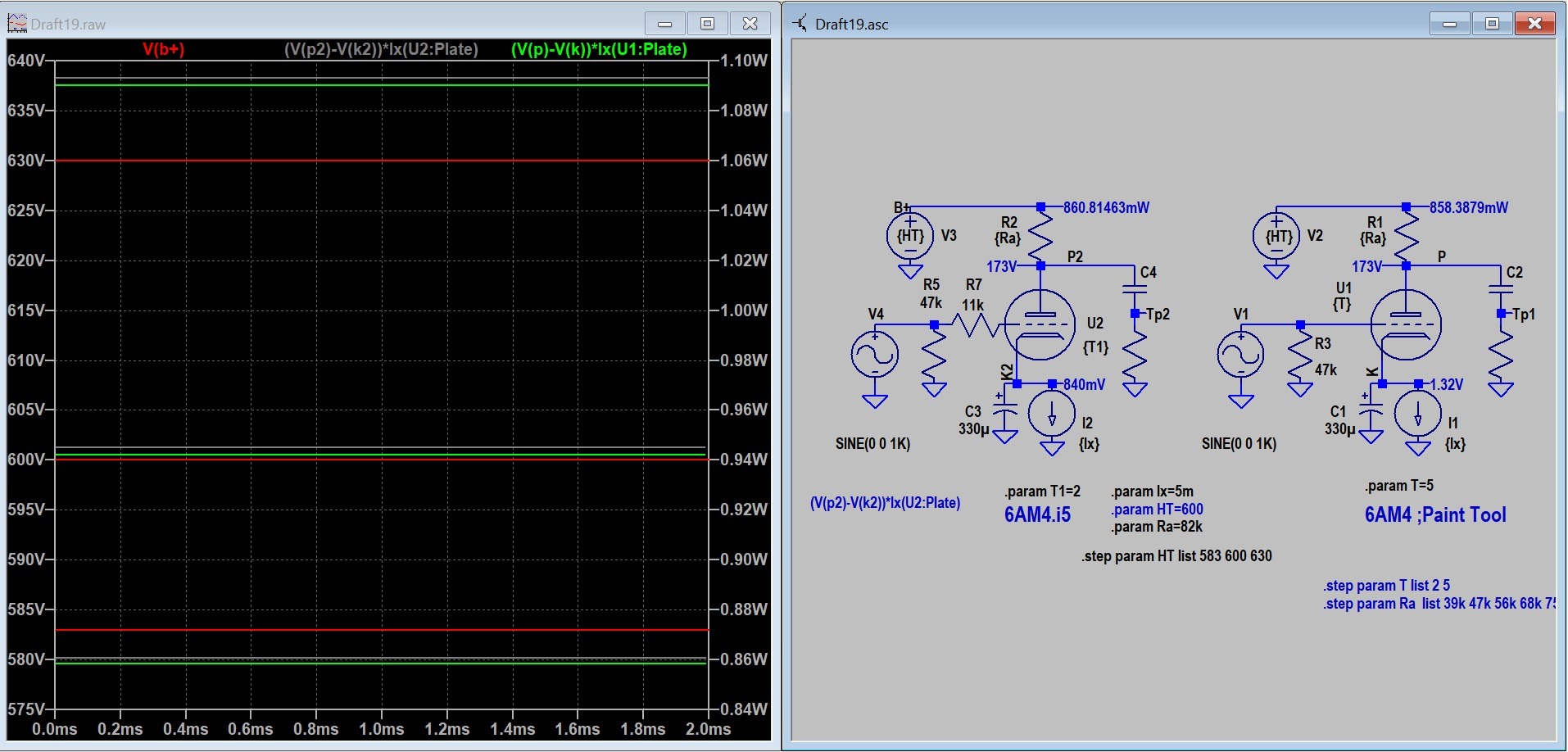

Are you compared measured Ua with simulated one?
My concern was that each simulated anode voltage tendentiously was greater than in datasheet, so estimated dissipation may exceed the limit.
Hi euro21
You can easily calulate the plate voltages for all 10 tubes: Ua = 582V - 39k1*Ia
Yes, I agree, the anode power loss is a problem in your stage as currently proposed. Well, for the short moment of my measurement it is not a problem, but one should not run a tube longer time out of spec. Good amp designs (where the tubes runs for years without problems) consider a margin to the max allowed power of at least 25%. Such a margin adresses the sample tolerances as well as the aging of a tube, which reduces slowly the plate current over time (with the side effect of increased plate losses in your stage)

BTW when you use my model instead of a datasheet based one, your design gets more margin!

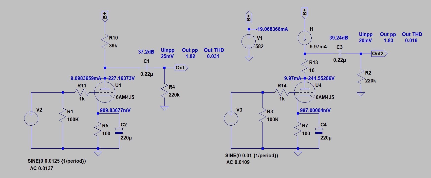

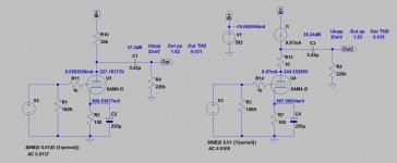

In #3200 post the picture in the right shows the no. 10 tube at 9.97mA current.
39k*9.97mA= 388.83V
So the anode voltage is 582-388.83= 193.17V which is perfect.
The simulation at this constant current shows 244.5V, the 39k loaded simulated tube voltage is 227.16V.
Are you sure that these voltages are fine, or something in the simulation is wrong?
39k*9.97mA= 388.83V
With a 39k resistive load, the tube in the circuit on the left draws about 9.1 mA, not 9.97 mA, so the plate voltage of about 227 volts is correct per Ohm's Law. The simulation looks fine to me.
I know, but I didn't choose this operating point. 😉 I'm guessing that Adrian ran his tests using the values in the schematic in your post # 3192 for the sake of comparison. But this circuit operates the tube at the limits of its maximum ratings. As Adrian pointed out, you can run the tube this way for short periods of testing but it is not safe for continuous operation.

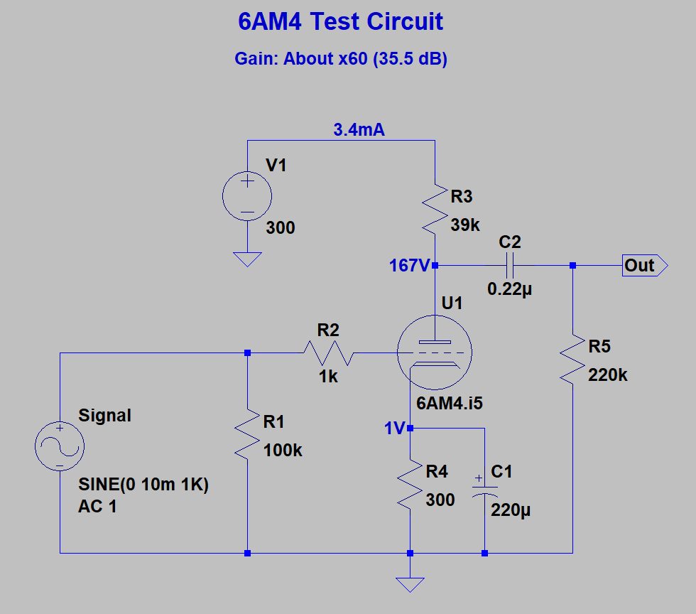

Going back to your schematic in post # 3187, if you want to use a B+ of 300 volts instead of 582 you should be able to find an operating point that is more reasonable. Using a 300 volt B+ supply, a plate resistor of 39k and a cathode resistor of 300 ohms gives a workable operating point for this tube. The plate current is around 3.4 mA or so at a plate voltage of about 167 volts and a grid voltage of about -1 volt. See attached. All of the operating parameters are well within the tube's maximum ratings. If you want to use an active (constant current source) load instead of the fixed resistor, set it at about 3.4 mA and you should be fine.
Of course, this isn't the only possible operating point. It's just an example of one that should work.

I myself would not run the 6AM4 at this operating point (200 Vp-k at 10 mA), regardless of whether the grid voltage is -1 volt or -1.5 volts. That is a plate dissipation of 2 watts, which is the maximum rating for that tube. The link you provided also acknowledged that. You can expect short tube life and even some outright tube failures pushing a tube that hard.
As for the SPICE model curves vs. the datasheet curves, I think Adrian has explained this as well as he can. But if the tube you end up using behaves more like Adrian's model than the datasheet, then you will push the tube well beyond its rating. Maybe someone here who has experience with the 6AM4 can offer an opinion about running the 6AM4 that hard. But I admit to being conservative when it comes to component ratings so I personally wouldn't be comfortable doing this.
At this point, I think you just have to decide whether you trust the schematic enough to build it as shown or not. Simulation can only take you so far.
Good luck.
Good luck.

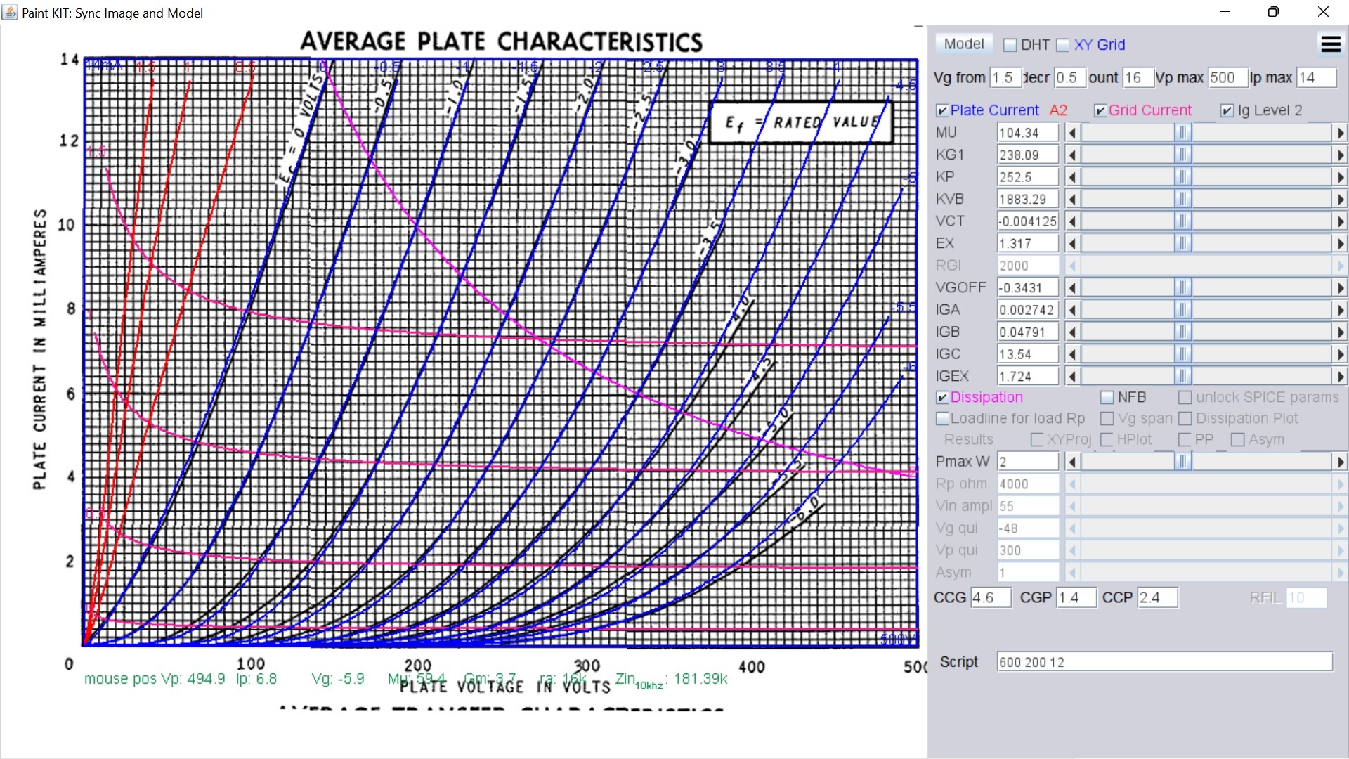

I build this 6AM4 model based on GE curve which is most popular and more linear, (grid current data borrowed from Adrians, it is high):

Mu or Gm*Rl of the samples is higher than that of original data.10mA, -1V is stable working point of this tube, with 200V Ua.
Simulated Ua exceed this voltage by the huge margin. Why?

Once more: My Model reflects the TYPICAL behaviour of the 10 tubes I measured. You took No.10 for comarison, which is one of the most extreme tube out of my lot. With the same kind of logic, one can do a comarison with the tube No.9, and then (because of the big difference between Sim and No.9) set a questionmark behind a datasheet based model whether it really reflects reality...
However...
Thank you Koonw for your model, as this will hopefully set an end to this pointless discussion.

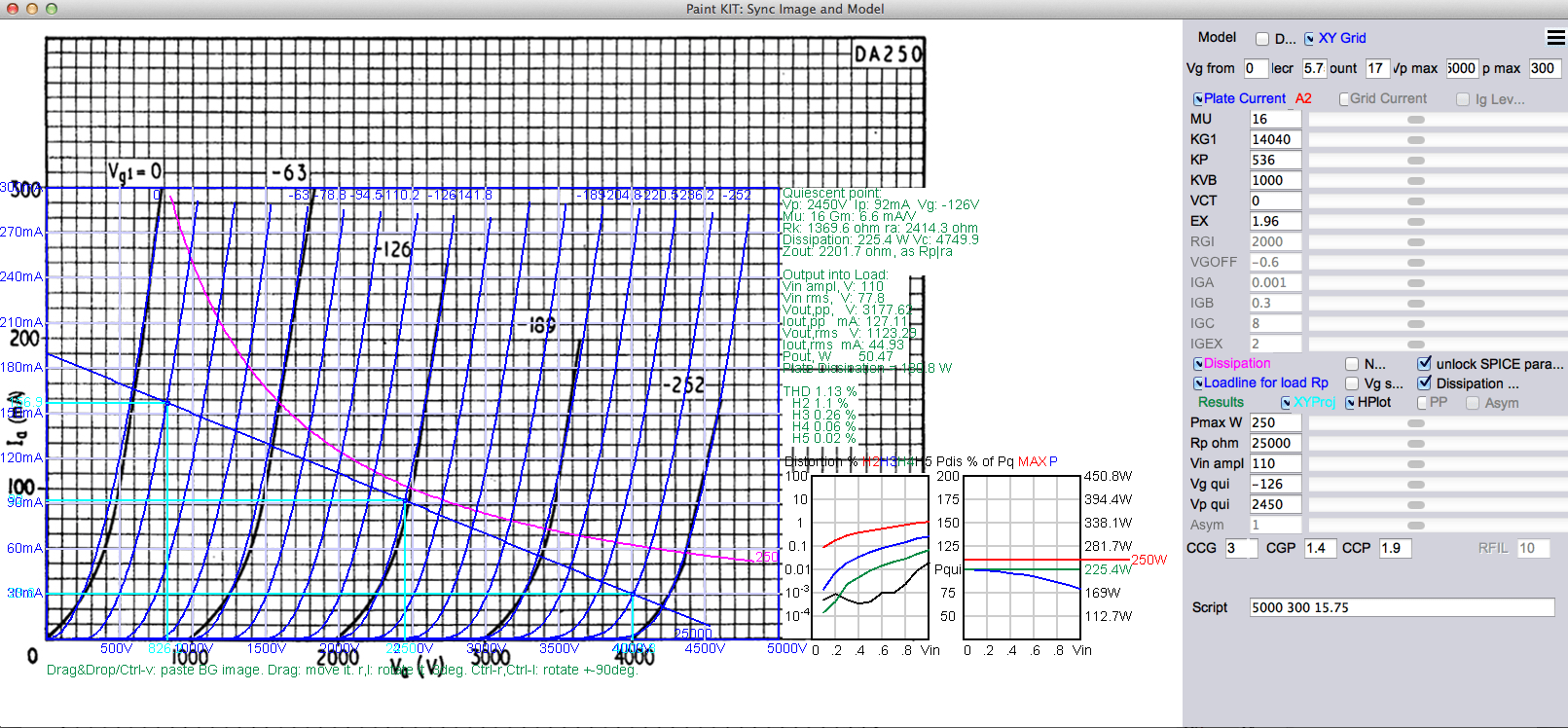

Hi I made 2 PSpice models for DA250 DHT power triode. Maybe it was inside the topic i didnt check 🙁 ?
Anyway it is not big help, because these tubes are almost imposibile to find 🙁
one model is plain triode model, another is with DHT connection pins.
cheers 🙂

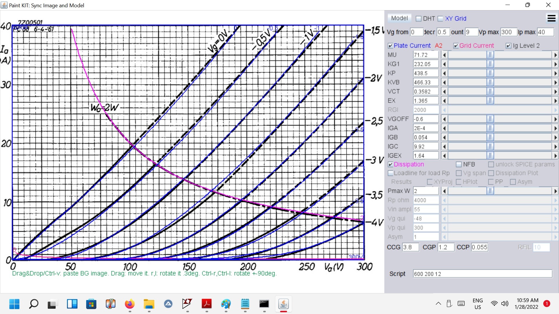

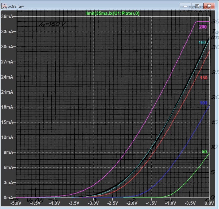

Try this PC88 model:

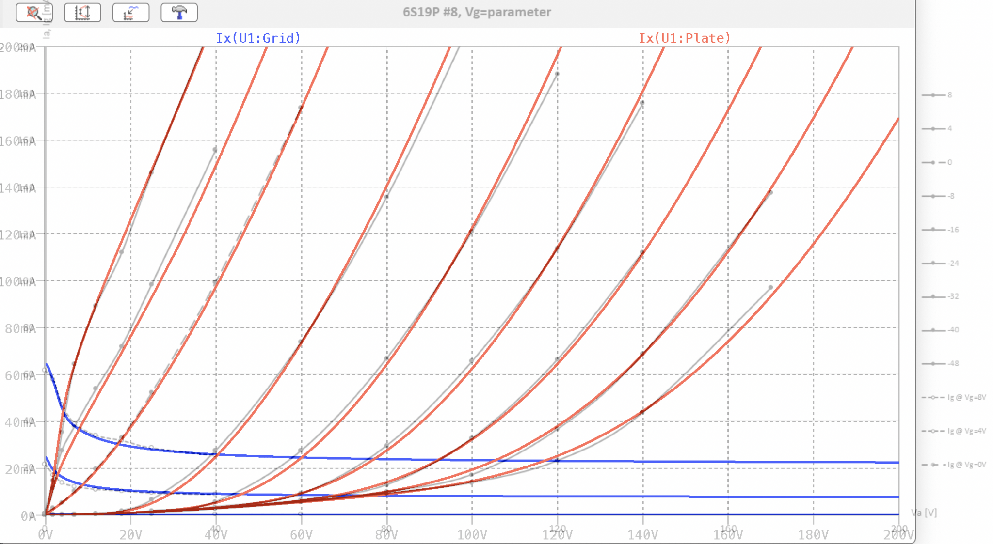

Here is a spice model of mine for the Russian 6S19P. It is intended for regulated power supplies, but may be something for a small OTL amp. Or one can even design a crazy "backward plate modulated" stage, for those looking for something different 😉.
However, please note that my small lot of 8 tubes showed a widely variating island-effect. So, for larger Va voltages (say > 100V) the sim might be quite different compared to the running tube.
In addition, all tubes showed a cathode area which is not covered by the grid (near the getter), which means that there is a small vacuum diode from plate to cathode, in parallel to the triode. Thus, there is a small plate current of some mA, which you can't suppress with the grid !!
BR Adrian
BR Adrian
