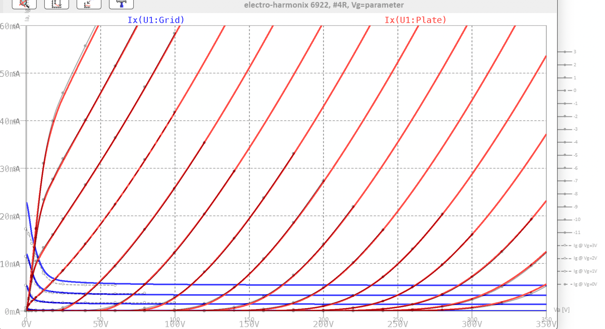

As I gift, here is my 6922EH.i5 model...
Beside of that, I still struggle to translate my i5 model into Spice compatible code. Several issues, for example how to define parameters which are calculated from other parameters etc. If in this community is a native Spice speaker, I would be glad for help!!

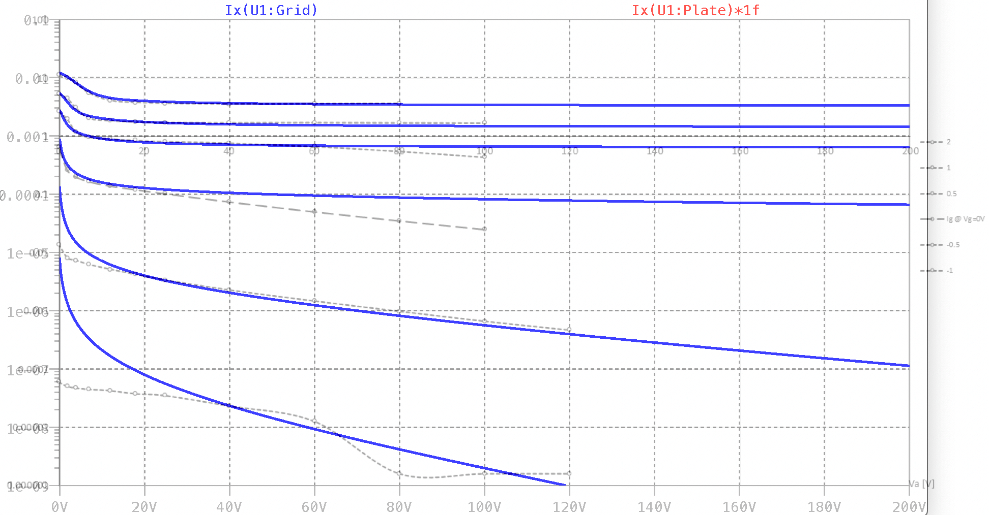

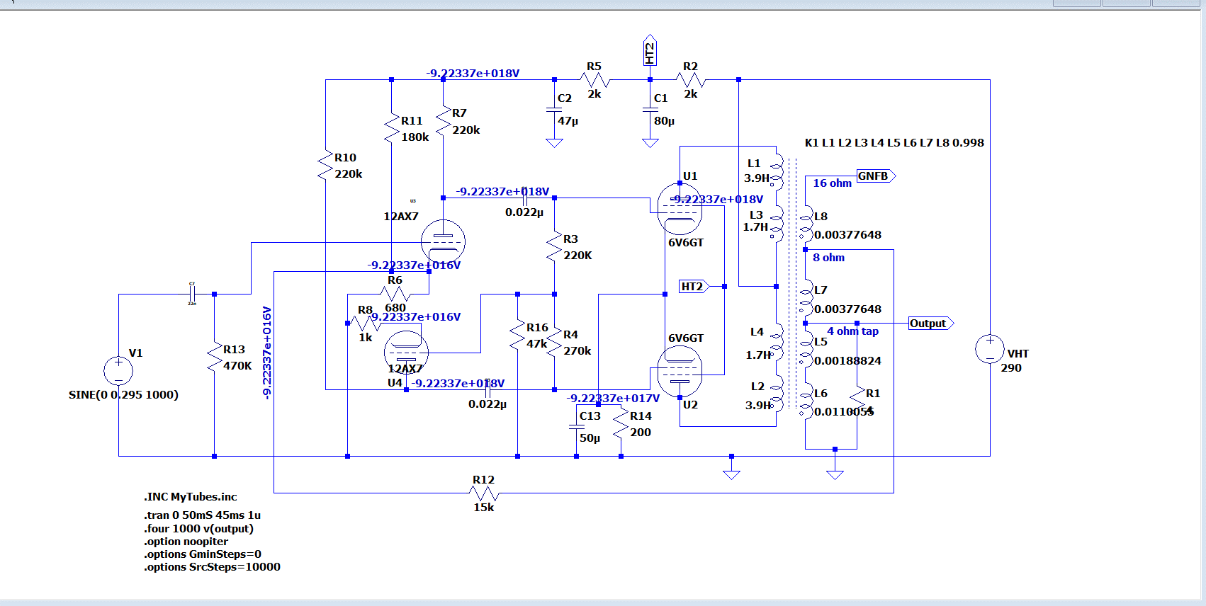

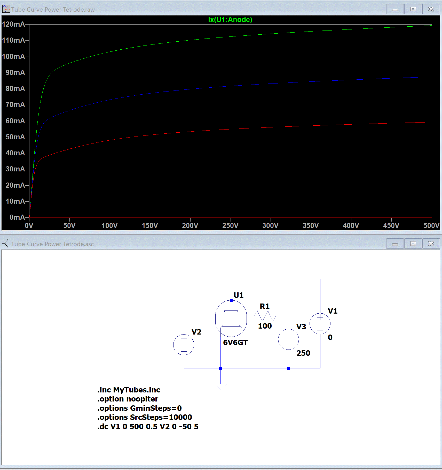

Hi Koonw, I tried this model and it did not work. Can you check and find what is wrong?Here 6V6GT GE model, original curve has triode, grid#1 and grid#2 current curve:
Code:**** 6V6GT ****************************************** * Created on 08/20/2021 15:48 using paint_kip.jar * [url=http://www.dmitrynizh.com/tubeparams_image.htm]Model Paint Tools: Trace Tube Parameters over Plate Curves, Interactively[/url] * Plate Curves image file: 6v6gt.png * Data source link: <plate curves URL> *---------------------------------------------------------------------------------- .SUBCKT 6V6GT P G2 G K ; LTSpice tetrode.asy pinout * .SUBCKT 6V6GT P G K G2 ; Koren Pentode Pspice pinout + PARAMS: MU=10.7 KG1=1676.38 KP=46.44 KVB=1412.81 VCT=-0.0399 EX=1.306 KG2=2635.52 KNEE=9.75 KVC=1.67 + KLAM=1.5E-9 KLAMG=1.35E-4 KD=0.02767 KC=0.2692 KR1=1.112E-5 KR2=0.06456 KVBG=0.01817 KB1=1.299 KB2=3.194 KB3=1.125E-5 KB4=0.98 KVBGI=3.975E-6 KNK=0.1559 KNG=0.00951 KNPL=1.145E-6 KNSL=3.87E-4 KNPR=0.4664 KNSR=84.99 + CCG=0.7P CGP=9P CCP=7.5P VGOFF=-3.6 IGA=8.688E-5 IGB=0.007008 IGC=15 IGEX=3.236 * Vp_MAX=500 Ip_MAX=140 Vg_step=5 Vg_start=0 Vg_count=14 * X_MIN=37 Y_MIN=25 X_SIZE=731 Y_SIZE=516 FSZ_X=1288 FSZ_Y=723 XYGrid=false * Rp=1400 Vg_ac=20 P_max=12 Vg_qui=-32.5 Vp_qui=300 * showLoadLine=n showIp=y isDHP=n isPP=n isAsymPP=n isUL=n showDissipLimit=y * showIg1=y isInputSnapped=y addLocalNFB=n * XYProjections=n harmonicPlot=y dissipPlot=n * UL=0.43 EG2=250 gridLevel2=y addKink=y isTanhKnee=n advSigmoid=y *---------------------------------------------------------------------------------- RE1 7 0 1G ; DUMMY SO NODE 7 HAS 2 CONNECTIONS E1 7 0 VALUE= ; E1 BREAKS UP LONG EQUATION FOR G1. +{V(G2,K)/KP*LOG(1+EXP((1/MU+(VCT+V(G,K))/SQRT(KVB+V(G2,K)*V(G2,K)))*KP))} RE2 6 0 1G ; DUMMY SO NODE 6 HAS 2 CONNECTIONS E2 6 0 VALUE={(PWR(V(7),EX)+PWRS(V(7),EX))} ; Kg1 times KIT current E4 8 0 VALUE={V(P,K)/KNEE/(KVBGI+V(6)*KVBG)} E5 81 0 VALUE={PWR(V(8),KB1)} E6 82 0 VALUE={PWR(V(8),KB2)} E7 83 0 VALUE={PWR(V(8),KB3)} E8 9 0 VALUE={PWR(1-EXP(-V(81)*(KC+KR1*V(82))/(KD+KR2*V(83))),KB4)*1.5708} RE4 8 0 1 RE5 81 0 1 RE6 82 0 1 RE7 83 0 1 RE8 9 0 1 RE21 21 0 1 E21 21 0 VALUE={V(6)/KG1*V(9)} ; Ip with knee but no slope and no kink RE22 22 0 1 ; E22: kink curr deviation for plate E22 22 0 VALUE={V(21)*LIMIT(KNK-V(G,K)*KNG,0,0.3)*(-ATAN((V(P,K)-KNPL)/KNSL)+ATAN((V(P,K)-KNPR)/KNSR))} G1 P K VALUE={V(21)*(1+KLAMG*V(P,K))+KLAM*V(P,K) + V(22)} G2 G2 K VALUE={V(6)/KG2*(KVC-V(9))/(1+KLAMG*V(P,K)) - V(22)} RCP P K 1G ; FOR CONVERGENCE C1 K G {CCG} ; CATHODE-GRID 1 C2 G P {CGP} ; GRID 1-PLATE C3 K P {CCP} ; CATHODE-PLATE RE23 G 0 1G GG G K VALUE={(IGA+IGB/(IGC+V(P,K)))*(MU/KG1)* +(PWR(V(G,K)-VGOFF,IGEX)+PWRS(V(G,K)-VGOFF,IGEX))} .ENDS *$
Hi Koonw,Try to add these options:
.option noopiter
.options GminSteps=0
.options SrcSteps=10000
Please take a look at the plate curve below. For some reason, it only plots the first three curves.
I also attached a VM1448 simulation result using Ayumi 6V6 model. It has no problem. When I switched over to your 6V6GT model, I got strange numbers.

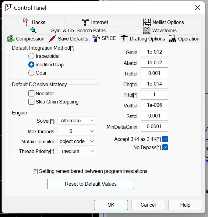

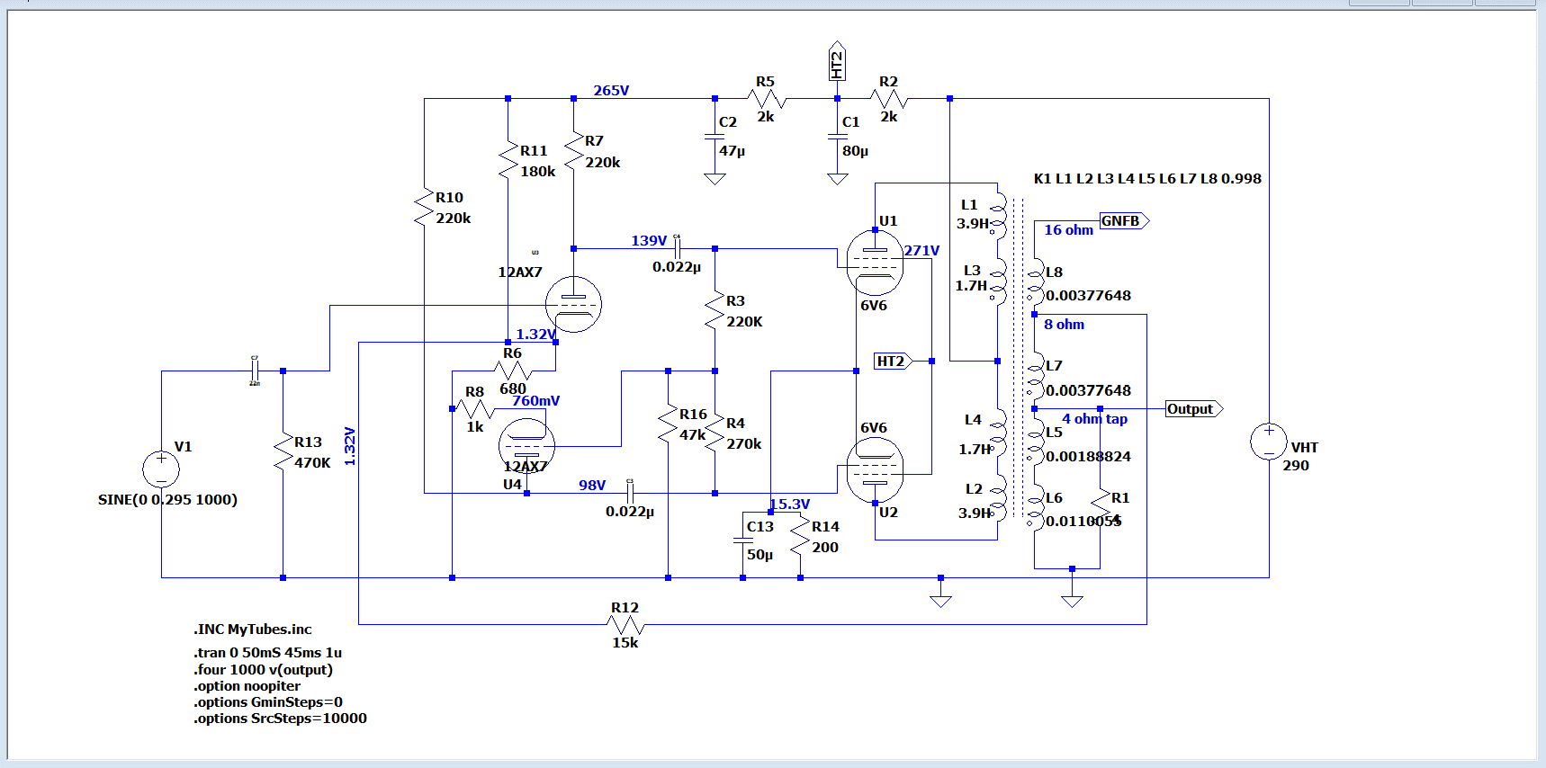

Hi Koonw,In LTSpice, click on Tools->Control Panel->SPICE, change Solver[*] from Normal to Alternate. I have posted this before.
By accident, I found out that the model works with only adding ".option noopiter".
Adding other options listed above will give error results.
Alternate solver is much slower.
Thanks for the support.

.options NoOpIter
.options SrcSteps=0
Circuit: * F:\SIM 2018\last\6v6gt model test.asc
.step vg=0
.step vg=-5
.step vg=-10
Direct Newton iteration for .op point skipped.
Gmin stepping method for .op point skipped.
Source stepping method for .op point skipped.
Pseudo Transient succeeded in finding the operating point at 327.69 ms.
.step vg=-15
.step vg=-20
.step vg=-25
.step vg=-30
.step vg=-35
.step vg=-40
.step vg=-45
.step vg=-50
Date: Wed Dec 29 10:38:21 2021

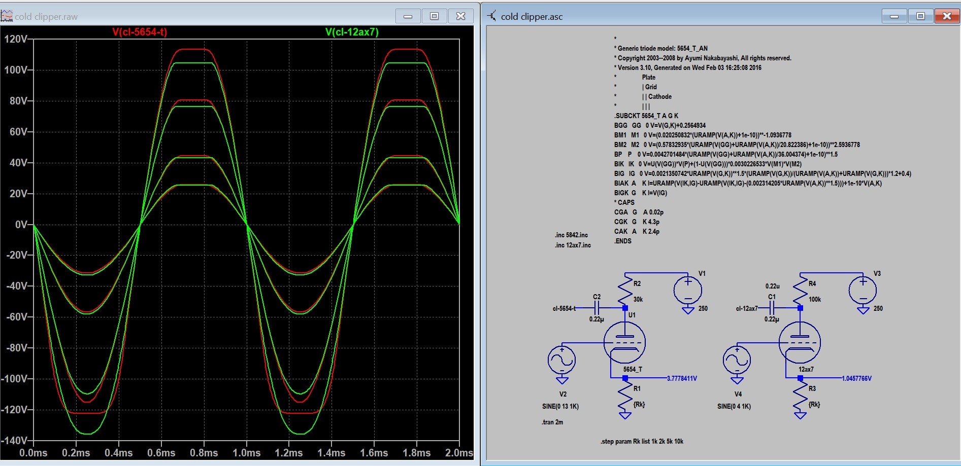

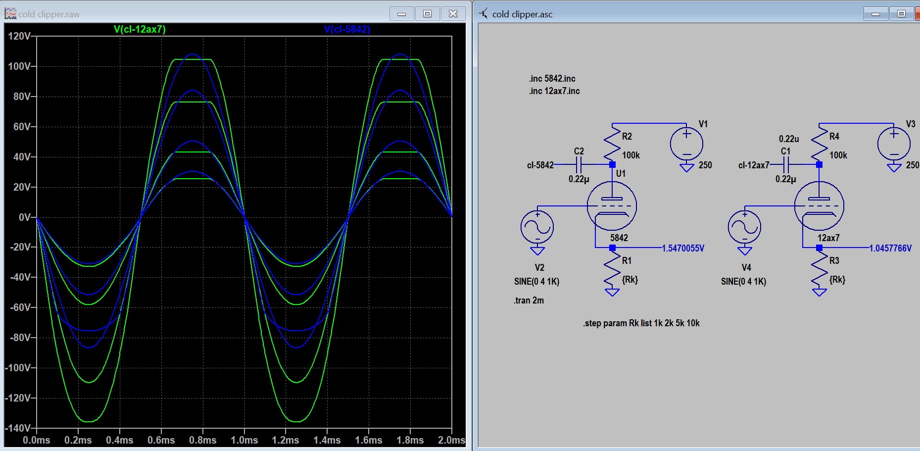

Can anyone tell me how to use these subcircuits in LTSpice? I've successfully used some other ones, but when I try to use the 5654 pentode, it generates an error because the model only has four pins. Should I start with a tetrode instead of a pentode?5654/6AK5/6J1 SPICE Models
Triode-Connected
Code:* * Generic triode model: 5654_T_AN * Copyright 2003--2008 by Ayumi Nakabayashi, All rights reserved. * Version 3.10, Generated on Wed Feb 03 16:25:08 2016 * Plate * | Grid * | | Cathode * | | | .SUBCKT 5654_T_AN A G K BGG GG 0 V=V(G,K)+0.2564934 BM1 M1 0 V=(0.020250832*(URAMP(V(A,K))+1e-10))**-1.0936778 BM2 M2 0 V=(0.57832935*(URAMP(V(GG)+URAMP(V(A,K))/20.822386)+1e-10))**2.5936778 BP P 0 V=0.0042701484*(URAMP(V(GG)+URAMP(V(A,K))/36.004374)+1e-10)**1.5 BIK IK 0 V=U(V(GG))*V(P)+(1-U(V(GG)))*0.0030226533*V(M1)*V(M2) BIG IG 0 V=0.0021350742*URAMP(V(G,K))**1.5*(URAMP(V(G,K))/(URAMP(V(A,K))+URAMP(V(G,K)))*1.2+0.4) BIAK A K I=URAMP(V(IK,IG)-URAMP(V(IK,IG)-(0.002314205*URAMP(V(A,K))**1.5)))+1e-10*V(A,K) BIGK G K I=V(IG) * CAPS CGA G A 0.02p CGK G K 4.3p CAK A K 2.4p .ENDS
Pentode
Code:* * Generic pentode model: 5654_AN * Copyright 2003--2008 by Ayumi Nakabayashi, All rights reserved. * Version 3.10, Generated on Wed Feb 03 16:24:50 2016 * Plate * | Screen Grid * | | Control Grid * | | | Cathode * | | | | .SUBCKT 5654_AN A G2 G1 K BGG GG 0 V=V(G1,K)+0.2564934 BM1 M1 0 V=(0.020250832*(URAMP(V(G2,K))+1e-10))**-1.0936778 BM2 M2 0 V=(0.57832935*(URAMP(V(GG)+URAMP(V(G2,K))/20.822386)))**2.5936778 BP P 0 V=0.0042701484*(URAMP(V(GG)+URAMP(V(G2,K))/36.004374))**1.5 BIK IK 0 V=U(V(GG))*V(P)+(1-U(V(GG)))*0.0030226533*V(M1)*V(M2) BIG IG 0 V=0.0021350742*URAMP(V(G1,K))**1.5*(URAMP(V(G1,K))/(URAMP(V(A,K))+URAMP(V(G1,K)))*1.2+0.4) BIK2 IK2 0 V=V(IK,IG)*(1-0.4*(EXP(-URAMP(V(A,K))/URAMP(V(G2,K))*15)-EXP(-15))) BIG2T IG2T 0 V=V(IK2)*(0.76634978*(1-URAMP(V(A,K))/(URAMP(V(A,K))+10))**1.5+0.23365022) BIK3 IK3 0 V=V(IK2)*(URAMP(V(A,K))+3705)/(URAMP(V(G2,K))+3705) BIK4 IK4 0 V=V(IK3)-URAMP(V(IK3)-(0.002314205*(URAMP(V(A,K))+URAMP(URAMP(V(G2,K))-URAMP(V(A,K))))**1.5)) BIP IP 0 V=URAMP(V(IK4,IG2T)-URAMP(V(IK4,IG2T)-(0.002314205*URAMP(V(A,K))**1.5))) BIAK A K I=V(IP)+1e-10*V(A,K) BIG2 G2 K I=URAMP(V(IK4,IP)) BIGK G1 K I=V(IG) * CAPS CGA G1 A 0.02p CGK G1 K 2.6p C12 G1 G2 1.7p CAK A K 2.4p .ENDS
Yes. Most "pentode" models are actually tetrode models. Very few pentode SPICE subcircuits model the suppressor grid. In practice, the suppressor grid is usually connected to the cathode (either internally or externally) and is not normally used as a modulating element.
Thanks. I am trying to make a distortion pedal using 5654 but for some reason I can't get the "cold clipper" stage to work. With a 12AX7 model, if I raise the value of the cathode resistor, I get asymmetrical clipping. But no matter how high I change the value with the 5654, it doesn't clip. Very strange.Yes. Most "pentode" models are actually tetrode models. Very few pentode SPICE subcircuits model the suppressor grid. In practice, the suppressor grid is usually connected to the cathode (either internally or externally) and is not normally used as a modulating element.
