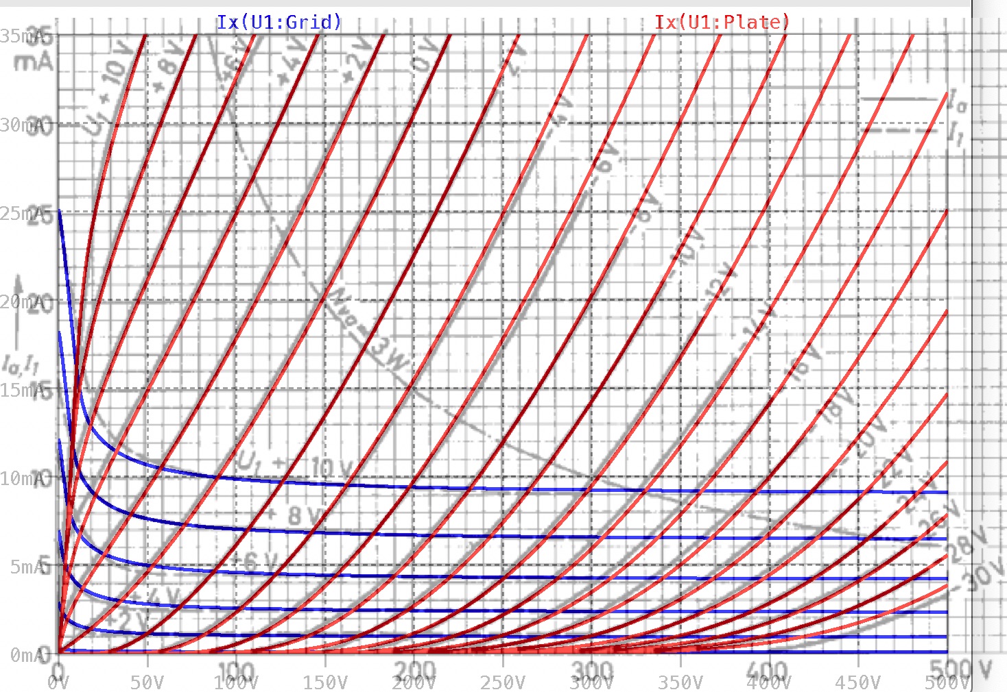

here the E82CC according the Philips data sheet, freshly cooked with my i5 model.
The i5 offers an improved convergence performance.

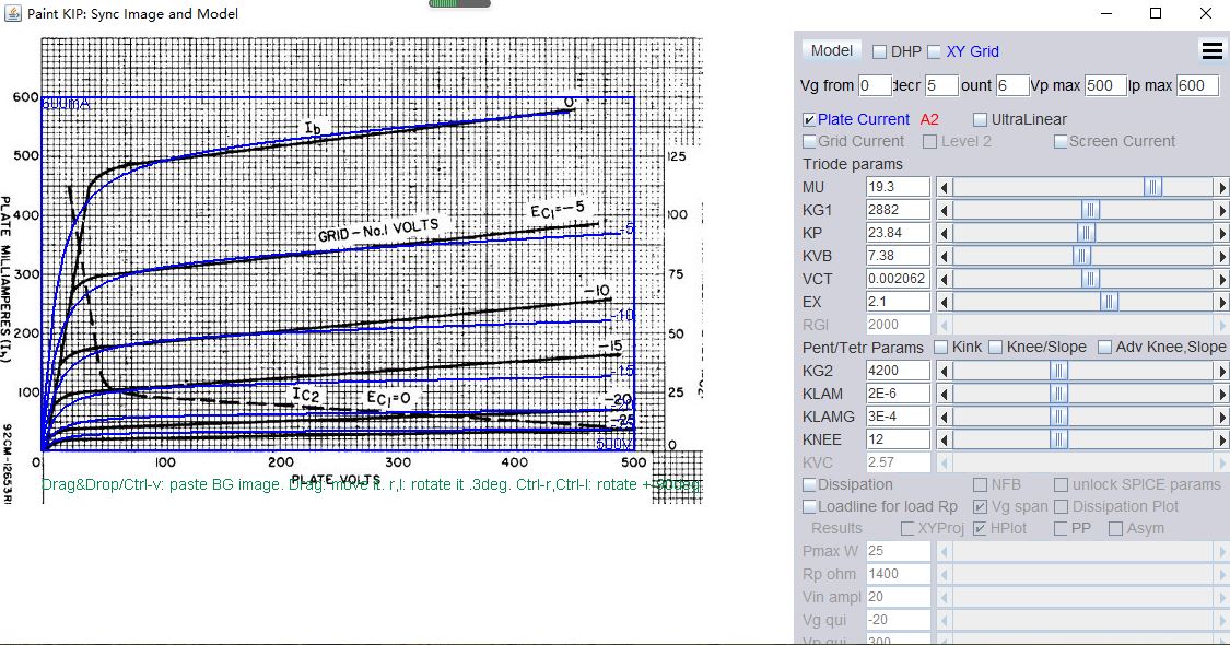

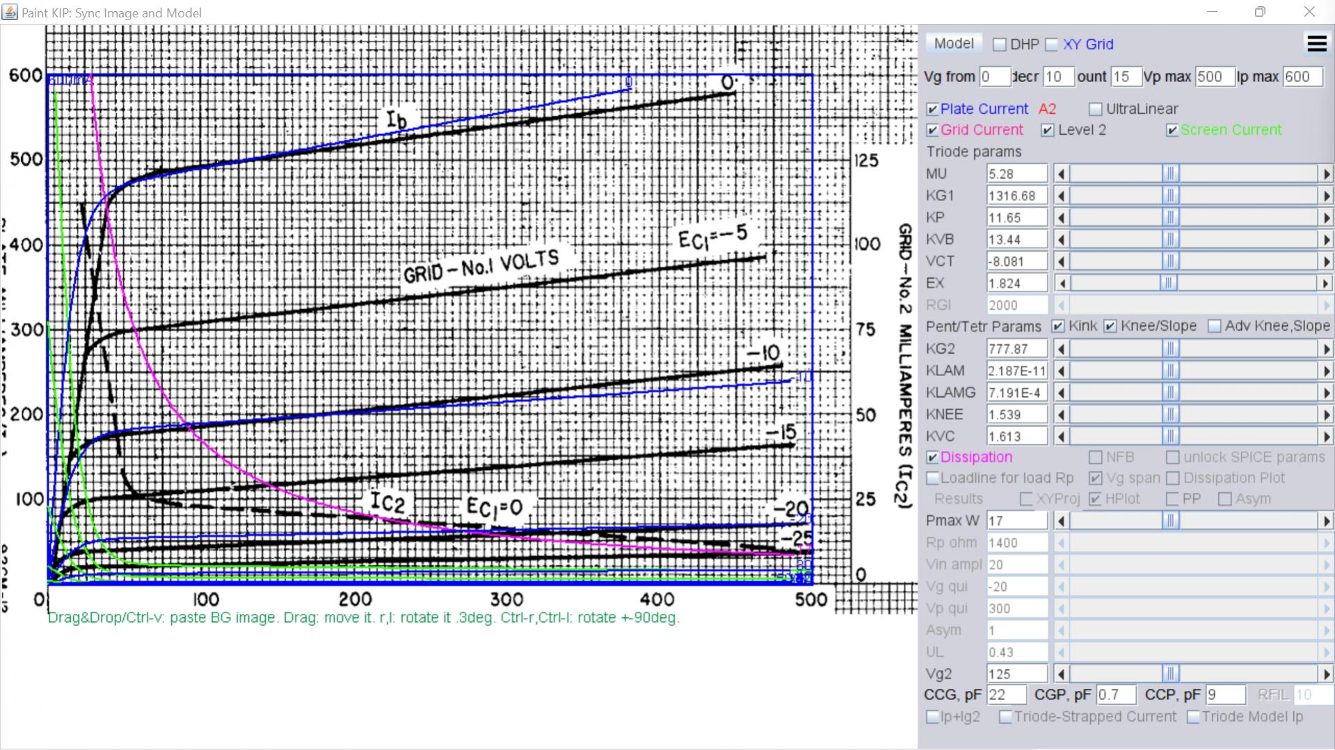

*** 6JR6 ******************************************
* Created on 12/02/2021 19:27 using paint_kip.jar
* [url=http://www.dmitrynizh.com/tubeparams_image.htm]Model Paint Tools: Trace Tube Parameters over Plate Curves, Interactively[/url]
* Plate Curves image file: 6jr6.png
* Data source link: <plate curves URL>
.SUBCKT 6JR6 P G2 G K ; LTSpice tetrode.asy pinout
* .SUBCKT 6JR6 P G K G2 ; Koren Pentode Pspice pinout
+ PARAMS: MU=5.28 KG1=1316.68 KP=11.65 KVB=13.44 VCT=-8.081 EX=1.824 KG2=777.87 KNEE=1.539 KVC=1.613
+ KLAM=2.187E-11 KLAMG=7.191E-4 KNEE2=17.46 KNEX=230.21 KNK=2.25E-4 KNG=-110.54 KNPL=1.286E-5 KNSL=0.000945 KNPR=0.007125 KNSR=907.92
+ CCG=22P CGP=0.7P CCP=9P VGOFF=-0.6 IGA=0.001 IGB=0.3 IGC=8 IGEX=2
* Vp_MAX=500 Ip_MAX=600 Vg_step=10 Vg_start=0 Vg_count=15
* X_MIN=46 Y_MIN=48 X_SIZE=733 Y_SIZE=490 FSZ_X=1296 FSZ_Y=736 XYGrid=false
* Rp=1400 Vg_ac=20 P_max=17 Vg_qui=-70 Vp_qui=300
* showLoadLine=n showIp=y isDHP=n isPP=n isAsymPP=n isUL=n showDissipLimit=y
* showIg1=y isInputSnapped=y addLocalNFB=n
* XYProjections=n harmonicPlot=y dissipPlot=n
* UL=0.43 EG2=125 gridLevel2=y addKink=y isTanhKnee=y advSigmoid=n

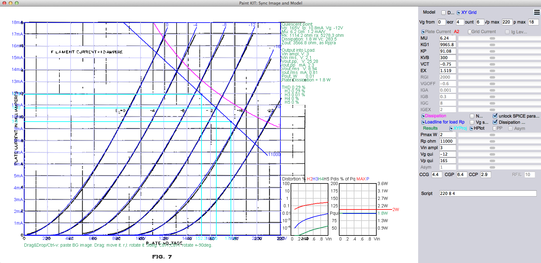

Hi probably it is posibile to convert model to PSpice. But it will take to replace some charakters in the script? For instance this is PSpice model of 101D triode.
.SUBCKT 101D 1 2 3 ; Plate Grid Cathode
+ PARAMS: CCG=4.4P CGP=6.4P CCP=2.9P RGI=2000
+ MU=6.24 KG1=9965.8 KP=91.08 KVB=300 VCT=-0.75 EX=1.519
E1 7 0 VALUE={V(1,3)/KP*LOG(1+EXP(KP*(1/MU+(VCT+V(2,3))/SQRT(KVB+V(1,3)*V(1,3)))))}
RE1 7 0 1G ; TO AVOID FLOATING NODES
G1 1 3 VALUE={(PWR(V(7),EX)+PWRS(V(7),EX))/KG1}
RCP 1 3 1G ; TO AVOID FLOATING NODES
C1 2 3 {CCG} ; CATHODE-GRID
C2 2 1 {CGP} ; GRID=PLATE
C3 1 3 {CCP} ; CATHODE-PLATE
D3 5 3 DX ; POSITIVE GRID CURRENT
R1 2 5 {RGI} ; POSITIVE GRID CURRENT
.MODEL DX D(IS=1N RS=1 CJO=10PF TT=1N)
.ENDS 101D
It starts with 1 2 3 corresponding to P G C. But in Your model numbers are used in script as node-point? I think that first is to exchange A G K with 1 2 3. Then to replace in the script all "doubled" numbers with other nubers?
I will try and report.

This is LTSpice model for 6F12P modeled by PaintKit, I believe it's in Pspice syntax already adopted from Koren model developed in PSpice and can be used in Micro-cap (which is PSpice compatiable), by following the import procedures without any change of model codes or syntax.
Code:
**** 6F12P_NEW **************************5****************
* Created on 10/19/2021 13:43 using paint_kip.jar
* Plate Curves image file: 6f12p-new.png
.SUBCKT 6F12P P G2 G K ; LTSpice tetrode.asy pinout
* .SUBCKT 6F12P P G K G2 ; Koren Pentode Pspice pinout
+ PARAMS: MU=87.23 KG1=239.95 KP=481.14 KVB=432.8 VCT=0.2871 EX=1.297 KG2=145.63 KNEE=168.15 KVC=1.726
+ KLAM=1.863E-10 KLAMG=5.733E-6 KD=31.03 KC=0.1211 KR1=5.46E-4 KR2=0.02944 KVBG=0.0012 KB1=2.32 KB2=0.11 KB3=2.02 KB4=0.82 KVBGI=0.00416 KNK=0 KNG=0 KNPL=50 KNSL=11 KNPR=120 KNSR=29
+ CCG=6.6P CGP=1.4P CCP=1.9P VGOFF=-0.6 IGA=8.7E-4 IGB=0.129 IGC=6.72 IGEX=2.8
* Vp_MAX=320 Ip_MAX=35 Vg_step=0.5 Vg_start=1 Vg_count=11
* X_MIN=49 Y_MIN=100 X_SIZE=632 Y_SIZE=541 FSZ_X=1296 FSZ_Y=736 XYGrid=false
* Rp=1400 Vg_ac=20 P_max=5 Vg_qui=-1.5 Vp_qui=300
* UL=0.43 EG2=150 gridLevel2=y addKink=y isTanhKnee=n advSigmoid=y
RE1 7 0 1G ; DUMMY SO NODE 7 HAS 2 CONNECTIONS
E1 7 0 VALUE= ; E1 BREAKS UP LONG EQUATION FOR G1.
+{V(G2,K)/KP*LOG(1+EXP((1/MU+(VCT+V(G,K))/SQRT(KVB+V(G2,K)*V(G2,K)))*KP))}
RE2 6 0 1G ; DUMMY SO NODE 6 HAS 2 CONNECTIONS
E2 6 0 VALUE={(PWR(V(7),EX)+PWRS(V(7),EX))} ; Kg1 times KIT current
E4 8 0 VALUE={V(P,K)/KNEE/(KVBGI+V(6)*KVBG)}
E5 81 0 VALUE={PWR(V(8),KB1)}
E6 82 0 VALUE={PWR(V(8),KB2)}
E7 83 0 VALUE={PWR(V(8),KB3)}
E8 9 0 VALUE={PWR(1-EXP(-V(81)*(KC+KR1*V(82))/(KD+KR2*V(83))),KB4)*1.5708}
RE4 8 0 1
RE5 81 0 1
RE6 82 0 1
RE7 83 0 1
RE8 9 0 1
RE21 21 0 1
E21 21 0 VALUE={V(6)/KG1*V(9)} ; Ip with knee but no slope and no kink
RE22 22 0 1 ; E22: kink curr deviation for plate
E22 22 0 VALUE={V(21)*LIMIT(KNK-V(G,K)*KNG,0,0.3)*(-ATAN((V(P,K)-KNPL)/KNSL)+ATAN((V(P,K)-KNPR)/KNSR))}
G1 P K VALUE={V(21)*(1+KLAMG*V(P,K))+KLAM*V(P,K) + V(22)}
G2 G2 K VALUE={V(6)/KG2*(KVC-V(9))/(1+KLAMG*V(P,K)) - V(22)}
RCP P K 1G ; FOR CONVERGENCE
C1 K G {CCG} ; CATHODE-GRID 1
C2 G P {CGP} ; GRID 1-PLATE
C3 K P {CCP} ; CATHODE-PLATE
RE23 G 0 1G
GG G K VALUE={(IGA+IGB/(IGC+V(P,K)))*(MU/KG1)*
+(PWR(V(G,K)-VGOFF,IGEX)+PWRS(V(G,K)-VGOFF,IGEX))}
.ENDS

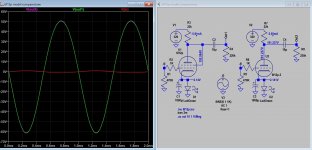

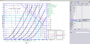

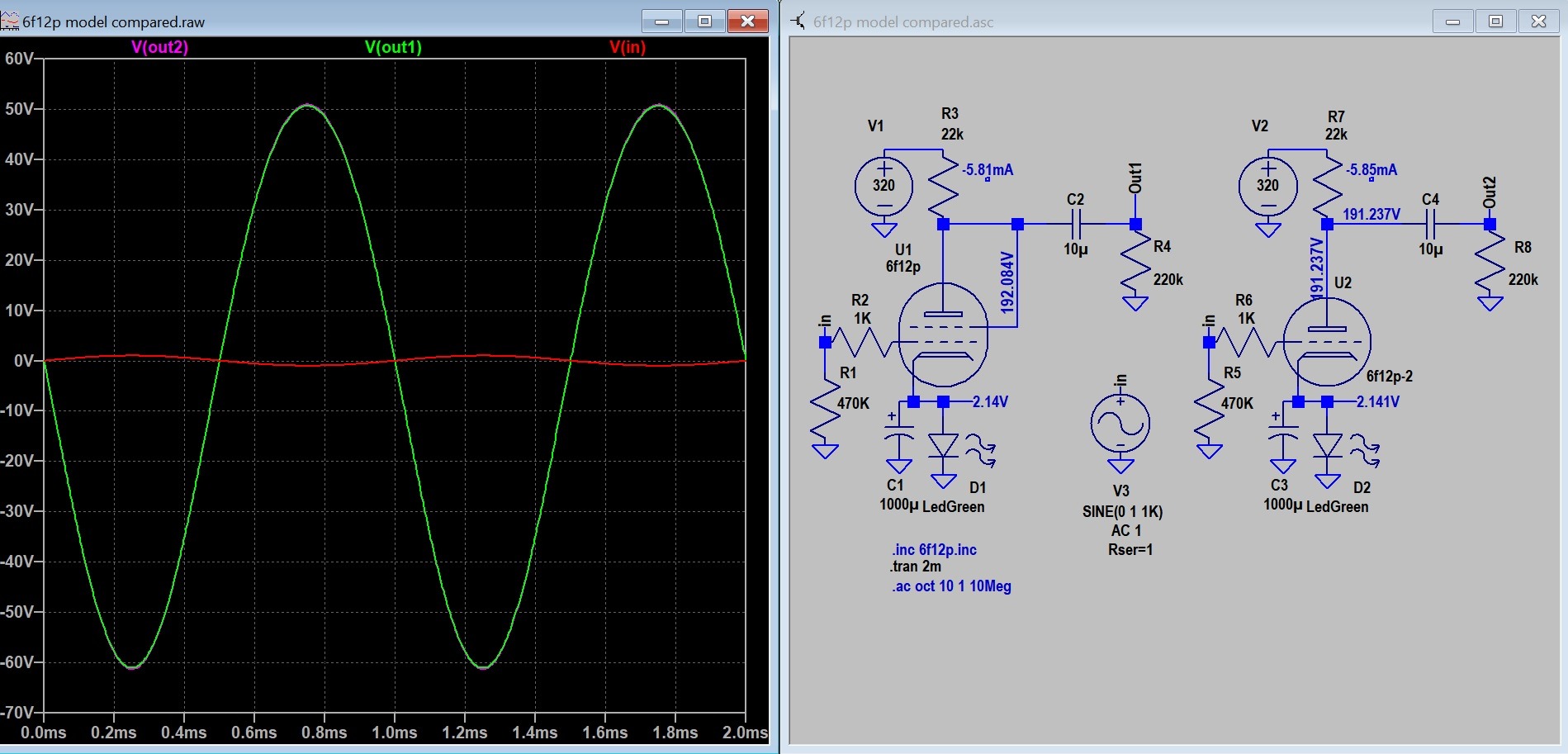

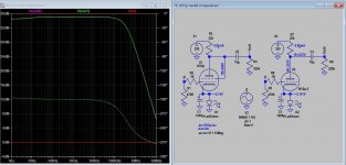

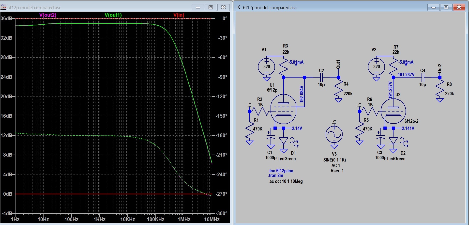

I was working on a 6F12P based preamp for a friend. What are the current 'best' models for the 6F12P pentode and triode sections? I have a few but they produce such widely different results, I don't know if I can trust them. Any suggestions?
If you're using 6f12p pentode section triode strapped you can use this model: https://www.bartola.co.uk/valves/2019/04/20/6f12p-a-great-russian-valve/
It also includes the newly measured Miller effect capacitance (maybe other model should use the same capacitance):
If you want to use 6f12p pentode model, try to use my most recent model, in which the strapped triode (tie screen to plate) in sim the result will be same as the above triode model. In other word the above triode model is used to model the my 6f12p pentode model. You should be able to verify both models in sim, but Bartola has not published a pentode model, so you can only compare the triode mode. In real circuit you can only have triode connected pentode, not real triode, if pentode curves varied so does the triode strapped tube.
- 1. total input capacitance measured is 605pF @gain of 39dB (x89.1)
- 2. From data sheet Cgk=6.6pF. Given Cin=Cgk+(mu+1)*Cag -> Cag = (Cin-Cgk)/(mu+1) =6.64pF
Here is one verification you can do: edit Cag=6.64p, so capacitance for both model are same and plot the transcient and freq. response.
