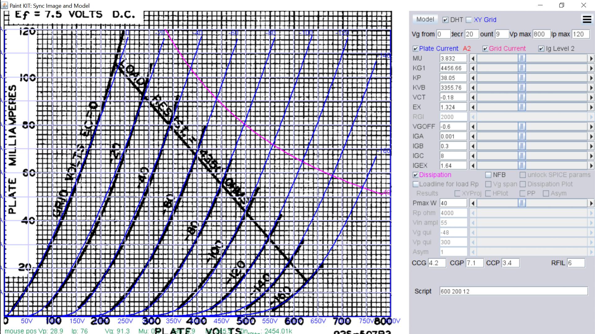

Type 50 RCA model:
DHT model:
Code:
**** 50 ** Advanced Grid Current **********************************
* Created on 09/20/2021 10:04 using paint_kit.jar 3.1
* [url=http://www.dmitrynizh.com/tubeparams_image.htm]Model Paint Tools: Trace Tube Parameters over Plate Curves, Interactively[/url]
* Plate Curves image file: 50.png
* Data source link:
.SUBCKT 50 1 2 3 ; Plate Grid Cathode
+ PARAMS: CCG=4.2P CGP=7.1P CCP=3.4P
+ MU=3.832 KG1=4456.66 KP=38.05 KVB=3355.76 VCT=-0.18 EX=1.324
+ VGOFF=-0.6 IGA=0.001 IGB=0.3 IGC=8 IGEX=1.64
* Vp_MAX=800 Ip_MAX=120 Vg_step=20 Vg_start=0 Vg_count=9
* Rp=4000 Vg_ac=55 P_max=40 Vg_qui=-48 Vp_qui=300
* X_MIN=10 Y_MIN=40 X_SIZE=830 Y_SIZE=619 FSZ_X=1296 FSZ_Y=736 XYGrid=true
* showLoadLine=n showIp=y isDHT=n isPP=n isAsymPP=n showDissipLimit=y
* showIg1=y gridLevel2=y isInputSnapped=n
* XYProjections=n harmonicPlot=n dissipPlot=n
E1 7 0 VALUE={V(1,3)/KP*LOG(1+EXP(KP*(1/MU+(VCT+V(2,3))/SQRT(KVB+V(1,3)*V(1,3)))))}
RE1 7 0 1G ; TO AVOID FLOATING NODES
G1 1 3 VALUE={(PWR(V(7),EX)+PWRS(V(7),EX))/KG1}
RCP 1 3 1G ; TO AVOID FLOATING NODES
C1 2 3 {CCG} ; CATHODE-GRID
C2 2 1 {CGP} ; GRID=PLATE
C3 1 3 {CCP} ; CATHODE-PLATE
RE2 2 0 1G
EGC 8 0 VALUE={V(2,3)-VGOFF} ; POSITIVE GRID THRESHOLD
GG 2 3 VALUE={(IGA+IGB/(IGC+V(1,3)))*(MU/KG1)*(PWR(V(8),IGEX)+PWRS(V(8),IGEX))}
.ENDS
DHT model:
Code:
**** 50 ** Composite DHT with Advanced Grid Current **************
* Created on 09/20/2021 10:06 using paint_kit.jar 3.1
* Data source link:
.SUBCKT DHT_50_A2 1 2 3 4 ; P G K1 K2
+ PARAMS: CCG=4.2P CGP=7.1P CCP=3.4P RFIL=6
* showLoadLine=n showIp=y isDHT=y isPP=n isAsymPP=n showDissipLimit=y
RFIL_LEFT 3 31 {RFIL/4}
RFIL_RIGHT 4 41 {RFIL/4}
RFIL_MIDDLE1 31 34 {RFIL/4}
RFIL_MIDDLE2 34 41 {RFIL/4}
E11 32 0 VALUE={V(1,31)/KP*LOG(1+EXP(KP*(1/MU+V(2,31)/SQRT(KVB+V(1,31)*V(1,31)))))}
E12 42 0 VALUE={V(1,41)/KP*LOG(1+EXP(KP*(1/MU+V(2,41)/SQRT(KVB+V(1,41)*V(1,41)))))}
RE11 34 0 1G
G11 1 31 VALUE={(PWR(V(32),EX)+PWRS(V(32),EX))/(2*KG1)}
G12 1 41 VALUE={(PWR(V(42),EX)+PWRS(V(42),EX))/(2*KG1)}
RCP1 1 34 1G
C1 2 34 {CCG} ; CATHODE-GRID
C3 1 34 {CCP} ; CATHODE-PLATE
RE2 2 0 1G
EGC1 81 0 VALUE={V(2,31)-VGOFF} ; POSITIVE GRID THRESHOLD
GG1 2 31 VALUE={0.5*(IGA+IGB/(IGC+V(1,31)))*(MU/KG1)*(PWR(V(81),IGEX)+PWRS(V(81),IGEX))}
EGC2 82 0 VALUE={V(2,41)-VGOFF} ; POSITIVE GRID THRESHOLD
GG2 2 41 VALUE={0.5*(IGA+IGB/(IGC+V(1,41)))*(MU/KG1)*(PWR(V(82),IGEX)+PWRS(V(82),IGEX))}
.ENDS

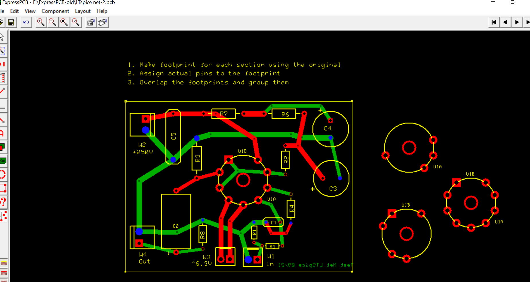

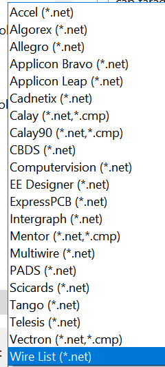

Export and Import Netlist
LTSpice exports netlist to about 20 external layout softwares. Here I share with you the ways. The netlist pin order exported from LTspice is based on the model pins (1, 2, 3,..) order, the pins number must be reassigned in the actual layout footprint as shown. You can add more pins like heaters to the tube model and asy symbol, and they will still be running so long both the model pin and asy pin order are same. You split the original into two half sections, be it twin triode or pentode triode, and make separate footprint for each section and regroup to form group footprint so they're not shift in anyway. Do not change the net order of pin or model. Use text to label the asy model/actual pins so make it easy to reassign later.
Cool stuff, Koonw!
That may safe a lot of drawing time when one intend to build a PCB for a tube amp. 👍

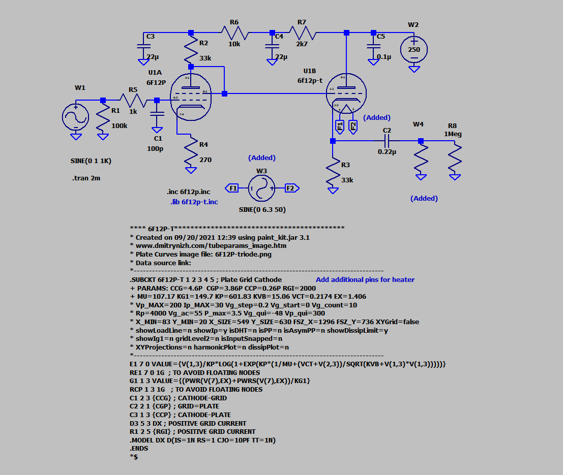

LTSpice phase splitter not working
I'm quite new to LTSpice and have only made a few simulations so far. I have drawn a diagram of my (working) driver stage. For some reason the phase inverter doesn't invert in LTSpice. In reality it does...
How do I get a proper simulation of the phase splitter?
Note: the 10M90S in this diagram will be used later on, this code is not needed right now.
Regards, Gerrit
Regards, Gerrit

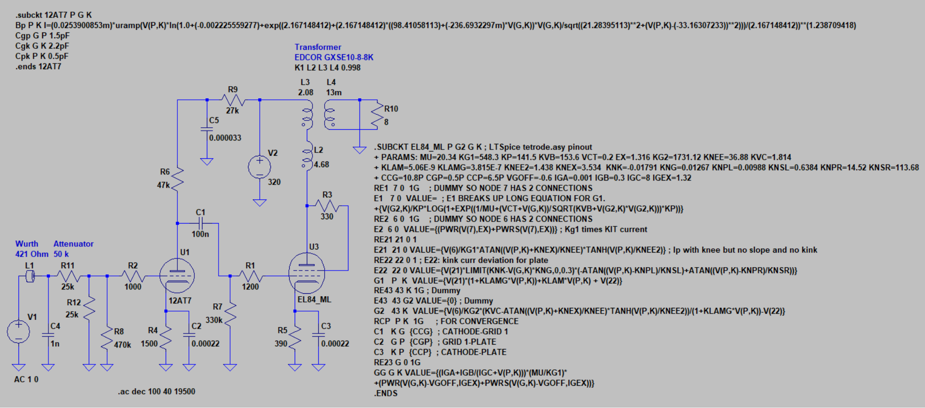

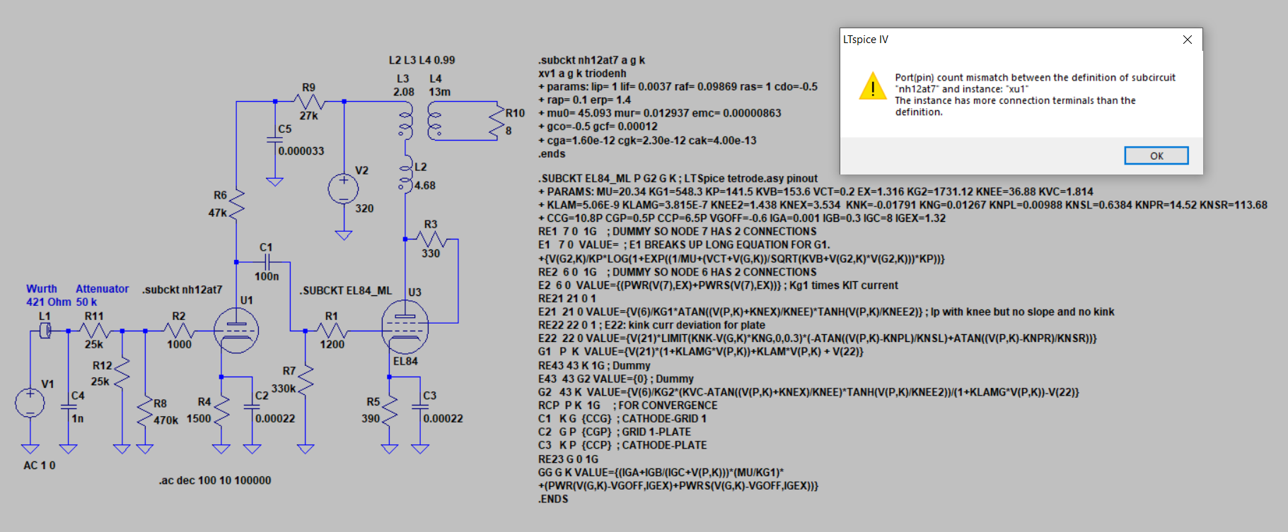

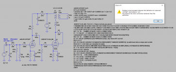

Simulating a triode with LTSpice
I have a problem with my simulations. OBVIOUSLY I have done some mistake but I just don't know what. See the screen capture.
It seems that I did not quite catch something, but what is it?
By the way, I copied the ECC81 simulation model from this site:
Spice Model Package 7/7 Triodes | paengdesign
Port(pin) count mismatch between the definition of subcircuit "nh12at7" and instance: "xu1"
The instance has more connection terminals than the definition.
You look as though you have defined the subcircuits twice over - once with the pin parameters (on the right) and once without (next to the x1 and x2 symbols). The symbol has to have the same number of matching net connections as the definition, so the two one liners look to be in conflict with that, at least that is what the error message appears to be saying.

That's one of Duncan Monroe's models. The line "XV1 A G K TRIODENH" is calling that subckt, which wasn't included in your spice directive on your schematic. I have provided the complete model below.I have a problem with my simulations. OBVIOUSLY I have done some mistake but I just don't know what.

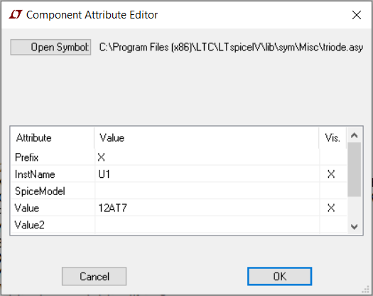

That problem was solved
Thanks!
I had put the name of the model on the wrong line of the Component Attribute Editor. There were other smaller problems afterwards but they were easily solved. I also used another simulation model for ECC81.
I used the transformer coupling coefficient K = 0.998 but I think it could be 0.999. I haven't measured it so I am not sure.

Thanks!
