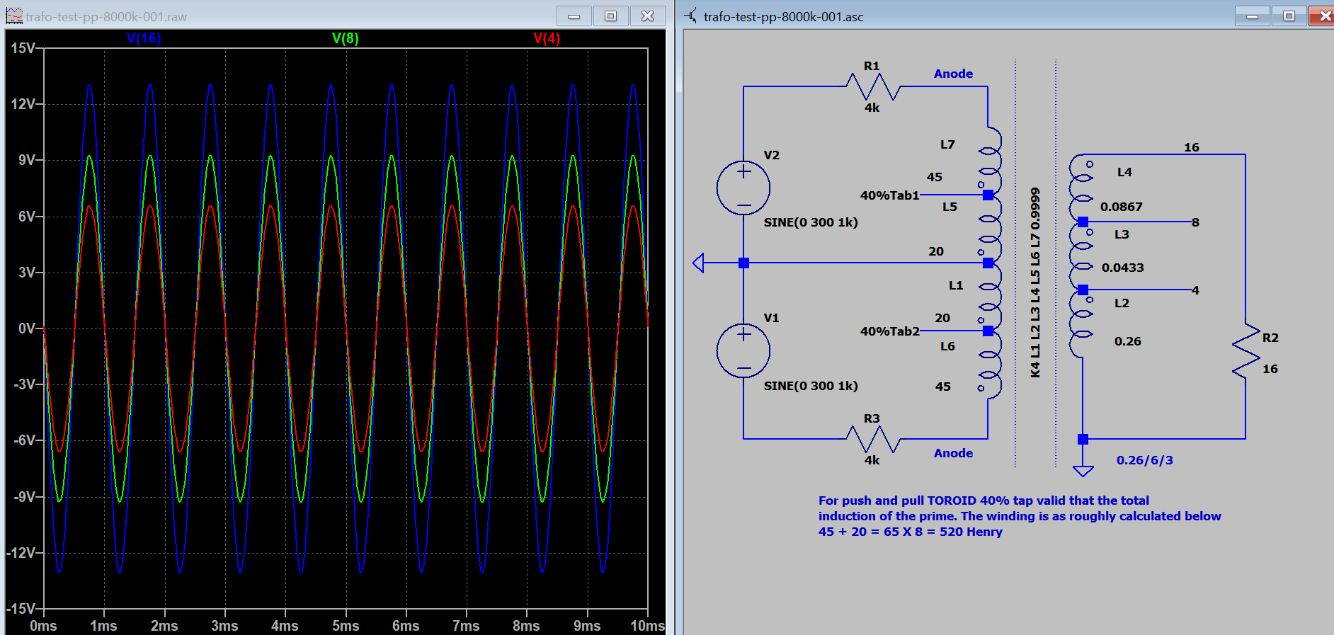

I have been trying to get to grips with modelling the Tubelab SPP in LtSpice so that I can investigate how the simulation differs for an EL86 version. I am trying to add negative feedback, and I'd like to see how the operating points are affected by different values of the feedback resistor from the OPT secondary.
In order to do that, I have had to better understand how transformer models work, and I have also tried to derive a model for the Toroidy TTG-EL84PP, which looks to be quite different to the theoretical model I have in my simulation today.
Here is my test file for the Toroidy OPT, added to another simulation I sourced somewhere, and can't remember. I have had to get a better understanding of how the different windings are coupled, and calculate the inductances of each section.
In my näive view, the Toroidy should have the same power output as the theoretical one. With 300V p-p on the primary, the theoretical gives 25v p-p, so power output on the 16ohm tap should be ((25/1.4)^2)/16 = approx 20W, which is OK.
The Toroidy model only has 10V p-p. It has a primary inductance of 500H instead of 72H of the theoretical OPT.
Is this to be expected?

Total pri inductance is 520H based on your data.
4 ohm inductance ratio=8000/4=2000
sec 4 ohms inductance=520/2000=0.26
sec 8 ohms inductance=0.26/6=0.0433
sec 16 ohms inductance=0.26/3=0.0867
40% UL tap=150*0.4=60Vp
see attach for sec output voltage

Hi Koonw,
Many thanks for setting me straight! Another small step for me in the right direction.
I was wondering what the purpose was of the two 4K resistors? I presume I omit them when I connect the taps to anodes in the circuit.
Cheers, Richard
Yes, you're correct to omit them in actual circuit. The purpose of two 4k resistors is chosen so they represent the total effective OT pri Z raa (r anode to anode) is 2*4k=8k, for OT Z=4k, two 2k resistors are used and so on. You can test by measuring the voltage after the resistors with respect to ground, should be half of generator voltage.
In actual circuit resistor is represented by the tube resistance, that is if raa=8k, and OT Z=8k when sec is connected, you'll measure 1/2 voltage at plate top with respect to ground or full voltage swing across the 2 plate tops

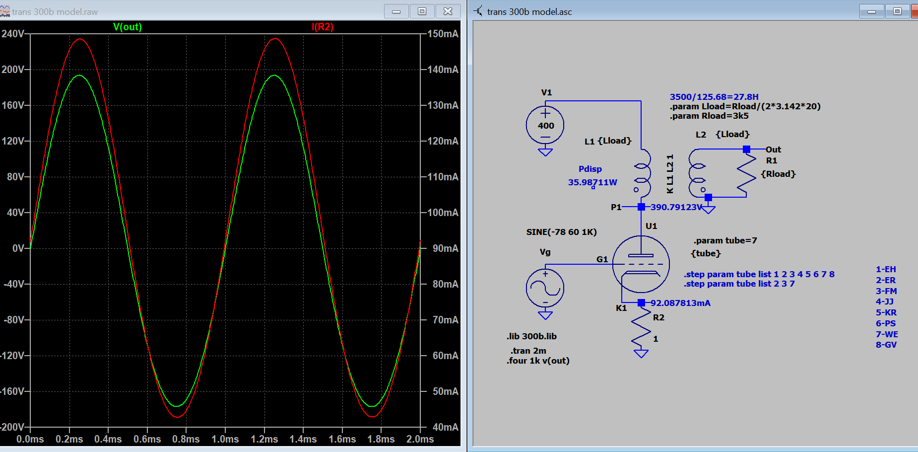

I have put together all the 300b models in one lib and each model is labeled using number rather than char. so can use ".step param tube list 1 2 4.." or just "param tube =7" will pick up 300b_we model.
The will make it possible for instant comparing various params like power dissipation, current, ouput and distortion etc.
Model naming as follow:-
1-EH
2-ER
3-FM
4-JJ
5-KR
6-PS
7-WE
8-GV

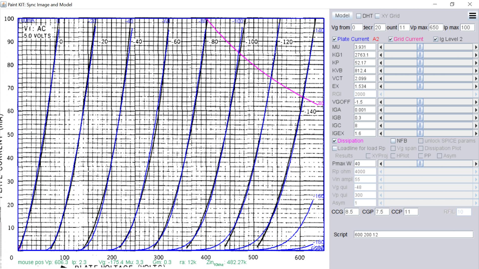

STC 4300B model
Code:
**** 4300B ** Advanced Grid Current **********************************
* Created on 09/12/2021 00:06 using paint_kit.jar 3.1
* [url=http://www.dmitrynizh.com/tubeparams_image.htm]Model Paint Tools: Trace Tube Parameters over Plate Curves, Interactively[/url]
* Plate Curves image file: 4300B.GIF
* Data source link: [url]http://tdsl.duncanamps.com/dcigna/tubes/sheets/misc/4300b-3h.gif[/url]
.SUBCKT 300B-GD 1 2 3 ; Plate Grid Cathode
+ PARAMS: CCG=8.5P CGP=7.5P CCP=11P
+ MU=3.931 KG1=2763.1 KP=52.17 KVB=812.4 VCT=2.099 EX=1.534
+ VGOFF=2 IGA=0.001 IGB=0.3 IGC=8 IGEX=1.6
* Vp_MAX=650 Ip_MAX=100 Vg_step=20 Vg_start=0 Vg_count=11
* Rp=4000 Vg_ac=55 P_max=40 Vg_qui=-48 Vp_qui=300
* X_MIN=48 Y_MIN=26 X_SIZE=818 Y_SIZE=621 FSZ_X=1296 FSZ_Y=736 XYGrid=false
* showLoadLine=n showIp=y isDHT=n isPP=n isAsymPP=n showDissipLimit=y
* showIg1=y gridLevel2=y isInputSnapped=n
* XYProjections=n harmonicPlot=n dissipPlot=n
E1 7 0 VALUE={V(1,3)/KP*LOG(1+EXP(KP*(1/MU+(VCT+V(2,3))/SQRT(KVB+V(1,3)*V(1,3)))))}
RE1 7 0 1G ; TO AVOID FLOATING NODES
G1 1 3 VALUE={(PWR(V(7),EX)+PWRS(V(7),EX))/KG1}
RCP 1 3 1G ; TO AVOID FLOATING NODES
C1 2 3 {CCG} ; CATHODE-GRID
C2 2 1 {CGP} ; GRID=PLATE
C3 1 3 {CCP} ; CATHODE-PLATE
RE2 2 0 1G
EGC 8 0 VALUE={V(2,3)-VGOFF} ; POSITIVE GRID THRESHOLD
GG 2 3 VALUE={(IGA+IGB/(IGC+V(1,3)))*(MU/KG1)*(PWR(V(8),IGEX)+PWRS(V(8),IGEX))}
.ENDS

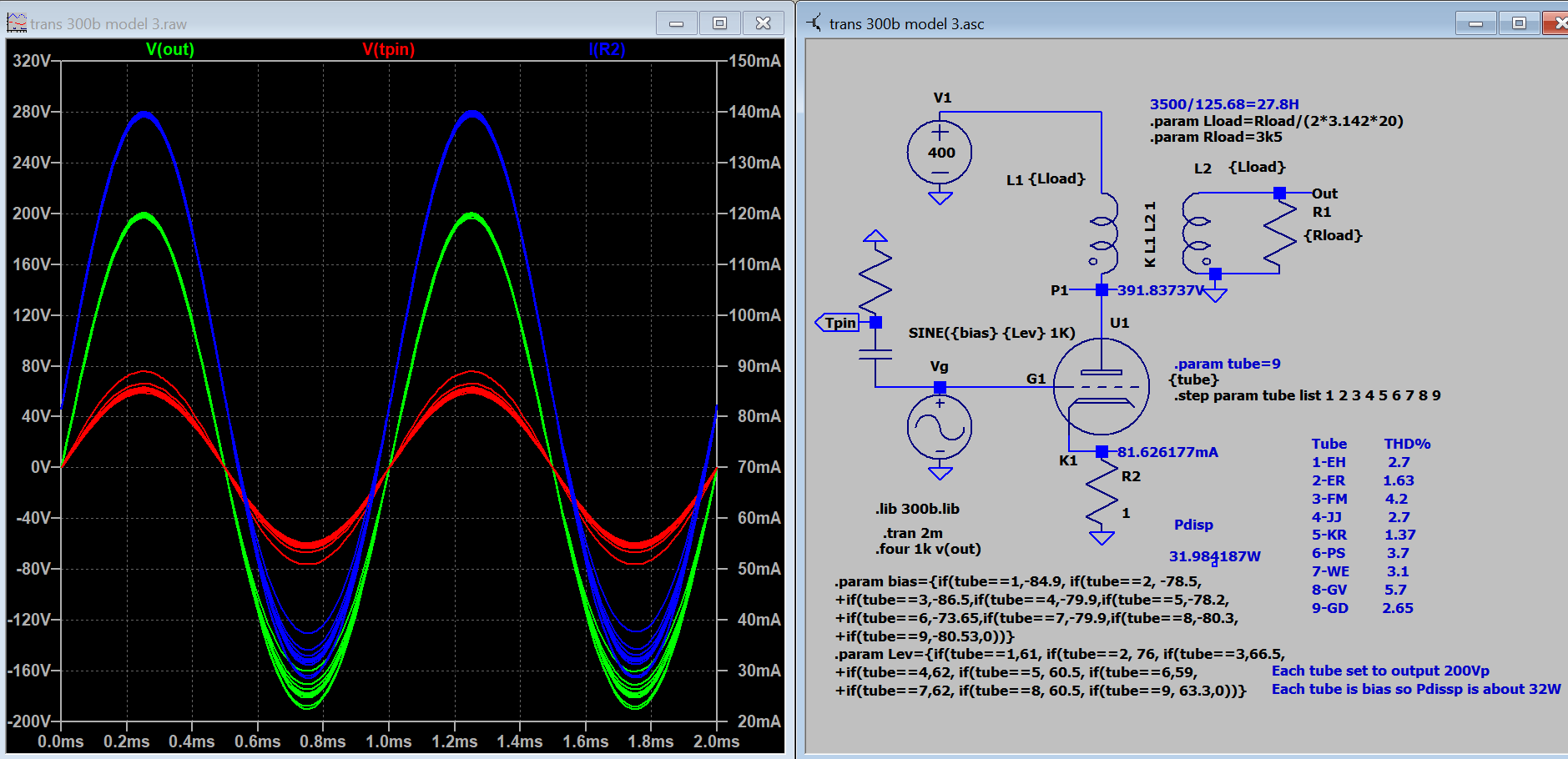

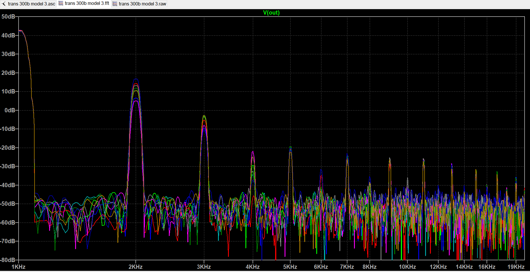

This sim is taken a step further:
Each tube set to output 200Vp
Each tube is bias so Pdissp is about 32W
STC 4300B is added to the list.

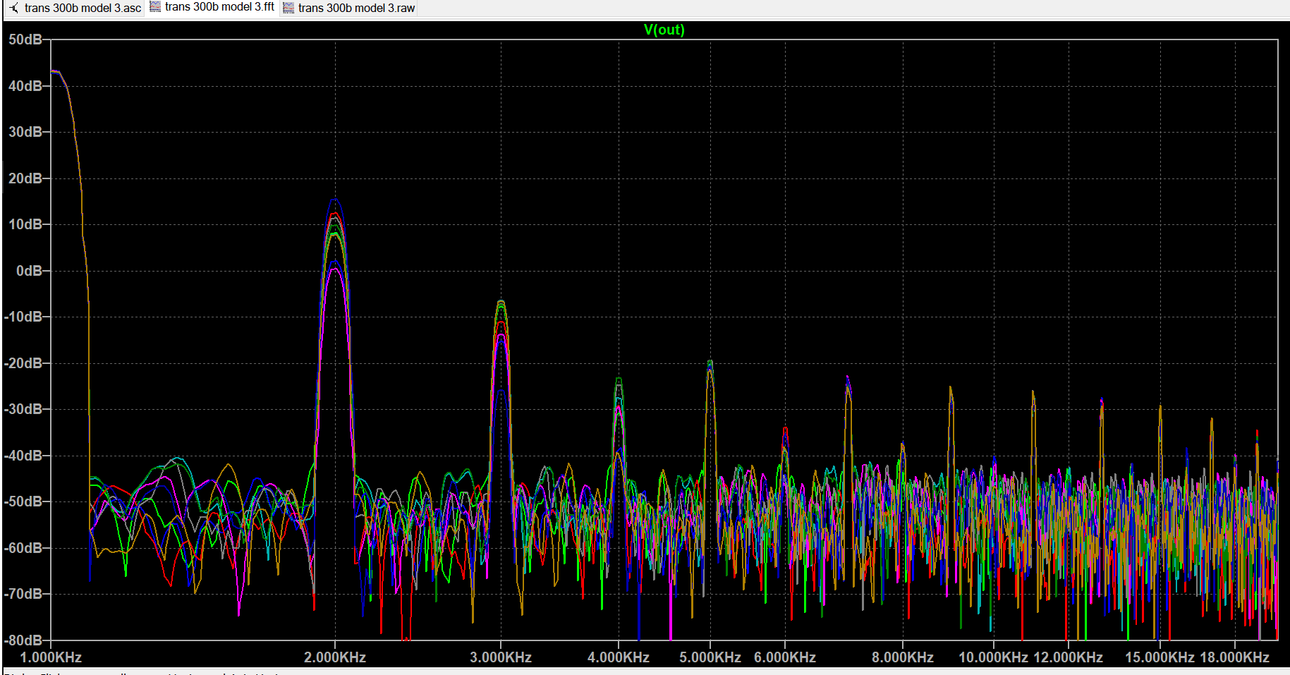

Total harmonic distortion (Thd) comparison of 300b's model with 3k5 and 5k OT.
Never ending saga ...

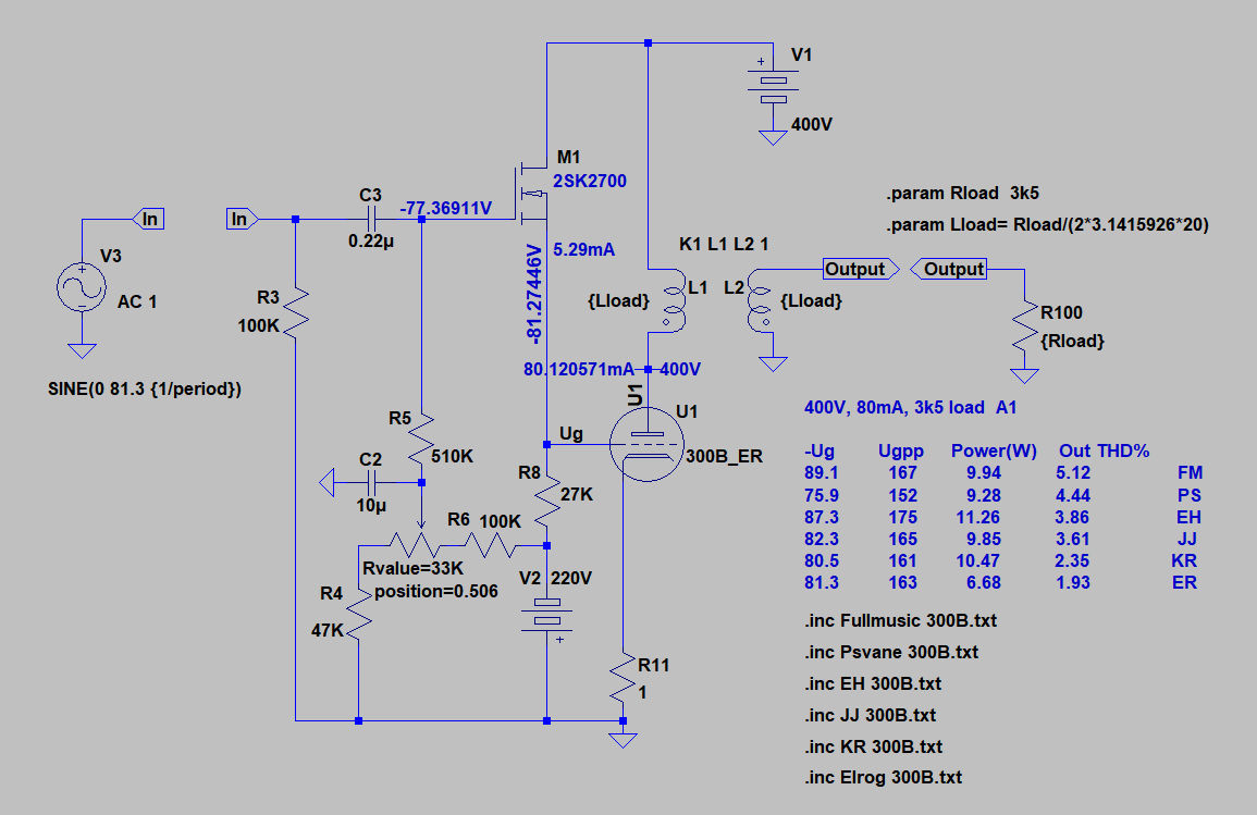

All of this advanced LTSpice usage leaves me a bit ashamed to bring up another issue with my simulation.
It was working perfectly, then I saw that I had got the OPT inductance wrong, it was 400H not 500H, so I reworked the windings and updated the model. Then it just stopped working. It all goes to pot after the phase splitter.
Unfortunately I lack the experience with this tool to iterate around standard issues, and divide and conquer.
Also, what is a reasonable line input level to work with? My resistance divider (40k + 60k) is meant to represent a potentiometer. I have reduced the amplitude of the input sine wave to 0.5V. I will lose some gain when I manage to get the NFB correct.

Thanks, I'd have never spotted that.
I thought they were just labels, and I just changed the text from '40% tab' to '43%', so I don't really understand what I did? How did you see it?
One 40%Tab1 and the other 40%Tab2 is ok as long as they're not shorting out. I changed the circuit to Pentode mode and it worked, I must have moved the 2 tabs away so the circuit become operational. I check a few area wonder why UL mode not working, knowing the circuit is fine, same as you, then I spot it. It will happen if it copied as Ltspice will not change the 2 same labels, like "Tp1" or "40%", include this in troubleshoot checklist.

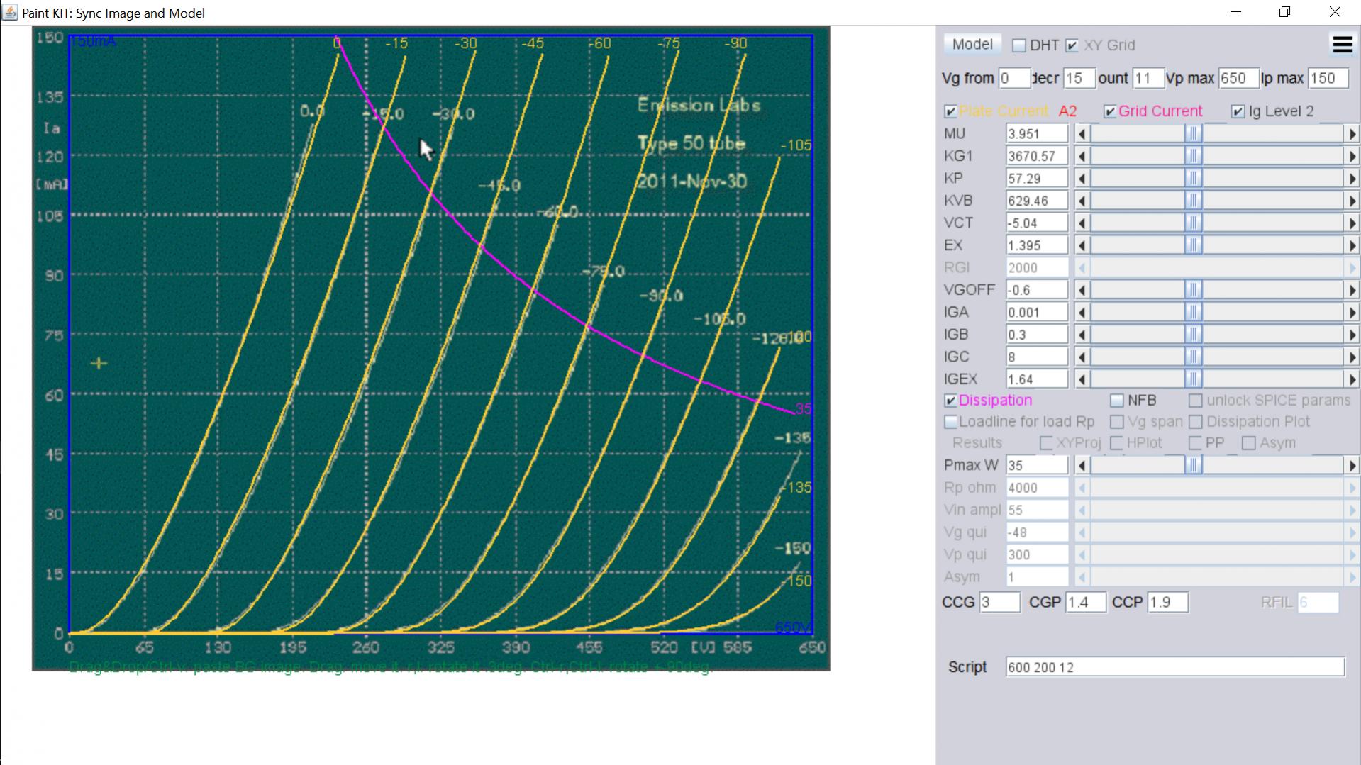

Type 50 EML model:
Type 50 Emission Labs Data Sheet
DHT model:
Code:
**** EML50 ** Advanced Grid Current **********************************
* Created on 09/19/2021 21:40 using paint_kit.jar 3.1
* Plate Curves image file: EML50.png
* Data source link: [url]http://www.emissionlabs.com/datasheets/50-curves.gif[/url]
.SUBCKT EML50 1 2 3 ; Plate Grid Cathode
+ PARAMS: CCG=3P CGP=1.4P CCP=1.9P
+ MU=3.951 KG1=3670.57 KP=57.29 KVB=629.46 VCT=-5.04 EX=1.395
+ VGOFF=-0.6 IGA=0.001 IGB=0.3 IGC=8 IGEX=1.64
* Vp_MAX=650 Ip_MAX=150 Vg_step=15 Vg_start=0 Vg_count=11
* Rp=4000 Vg_ac=55 P_max=35 Vg_qui=-48 Vp_qui=300
* X_MIN=65 Y_MIN=10 X_SIZE=699 Y_SIZE=563 FSZ_X=1296 FSZ_Y=736 XYGrid=false
RE2 2 0 1G
.ENDS
