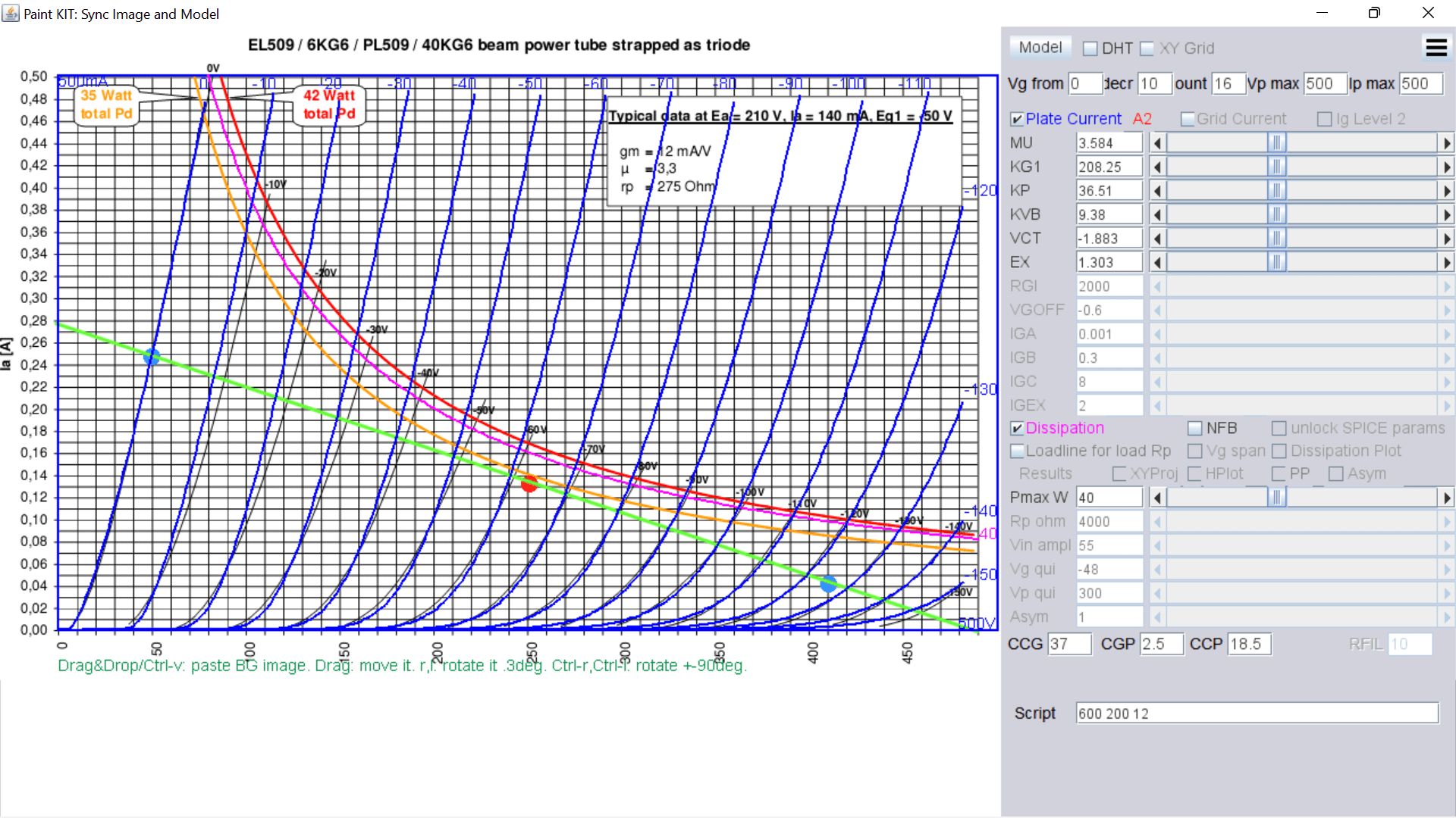

Vacuum Tube SPICE Models
Here is minor correction of bottom Vp scale 500V being slightly off, added inter-electrode capacitance and as quoted text. you can edit again if you have the actual value for your tubes. If you need advanced grid model then the grid1 current data is needed, other this model is only RGI grid model
Code:
**** EL509_T *************************updated*****************
* Created on 04/28/2022 10:49 using paint_kit.jar 3.1
* www.dmitrynizh.com/tubeparams_image.htm
* Plate Curves image file: EL509_TF-T.png
* Data source link:
.SUBCKT EL509_T 1 2 3 ; Plate Grid Cathode
+ PARAMS: CCG=37P  CGP=2.5P CCP=18.5P RGI=2000
+ MU=3.584 KG1=208.25 KP=36.51 KVB=9.38 VCT=-1.883 EX=1.303
* Vp_MAX=500 Ip_MAX=500 Vg_step=10 Vg_start=0 Vg_count=16
* Rp=4000 Vg_ac=55 P_max=40 Vg_qui=-48 Vp_qui=300
* X_MIN=51 Y_MIN=43 X_SIZE=826 Y_SIZE=488 FSZ_X=1296 FSZ_Y=736 XYGrid=false
* showLoadLine=n showIp=y isDHT=n isPP=n isAsymPP=n showDissipLimit=y
* showIg1=n gridLevel2=n isInputSnapped=n
* XYProjections=n harmonicPlot=n dissipPlot=n
E1 7 0 VALUE={V(1,3)/KP*LOG(1+EXP(KP*(1/MU+(VCT+V(2,3))/SQRT(KVB+V(1,3)*V(1,3)))))}
RE1 7 0 1G  ; TO AVOID FLOATING NODES
G1 1 3 VALUE={(PWR(V(7),EX)+PWRS(V(7),EX))/KG1}
RCP 1 3 1G   ; TO AVOID FLOATING NODES
C1 2 3 {CCG} ; CATHODE-GRID
C2 2 1 {CGP} ; GRID=PLATE
C3 1 3 {CCP} ; CATHODE-PLATE
D3 5 3 DX ; POSITIVE GRID CURRENT
R1 2 5 {RGI} ; POSITIVE GRID CURRENT
.MODEL DX D(IS=1N RS=1 CJO=10PF TT=1N)
.ENDS
Reactions: jcalvarez

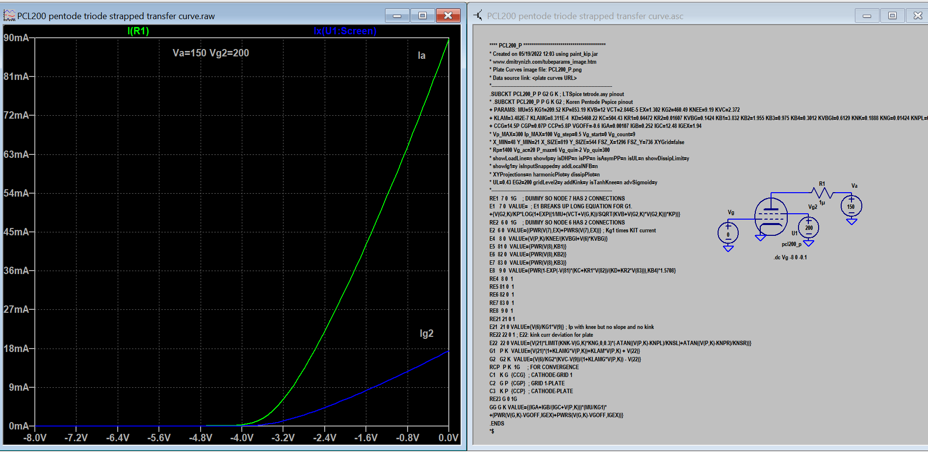

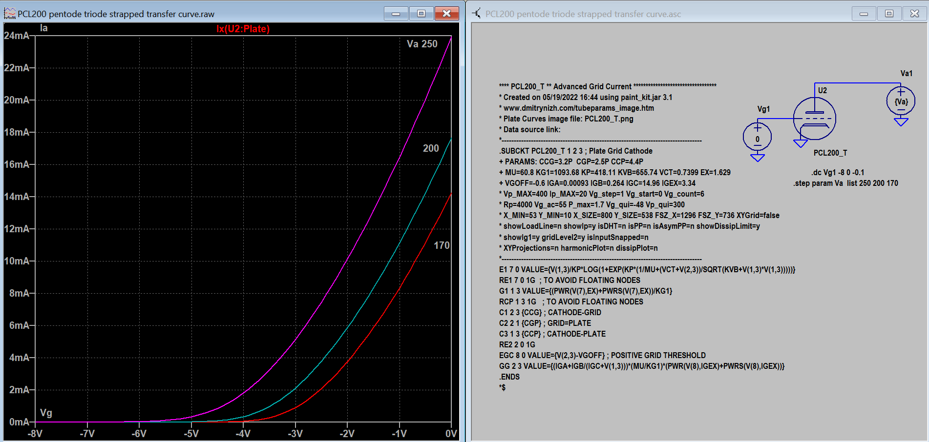

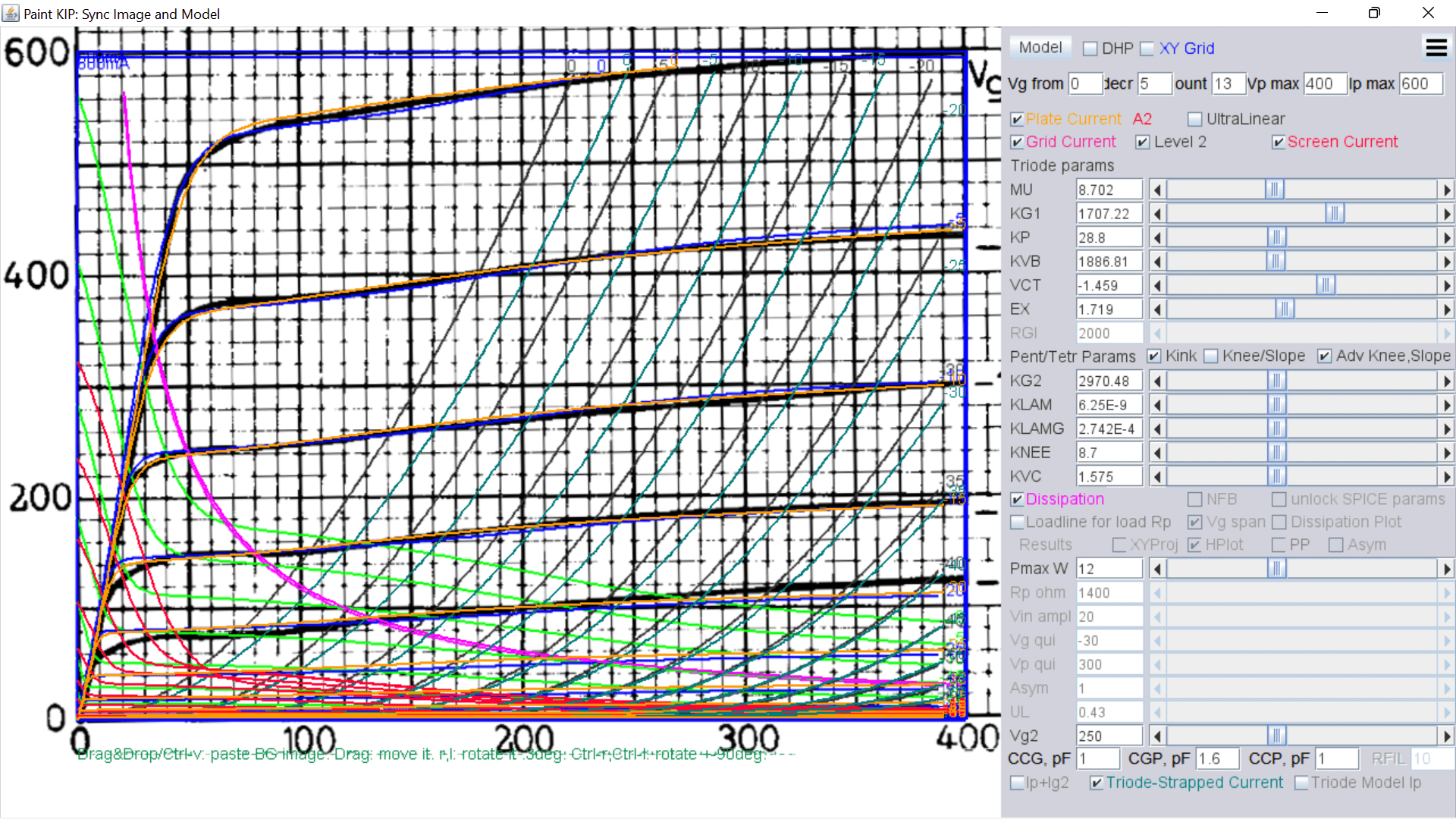

PCL200 pentode model, try it:
Code:
**** PCL200_P ******************************************
* Created on 05/19/2022 12:03 using paint_kip.jar
* Plate Curves image file: PCL200_P.png
* Data source link: <plate curves URL>
.SUBCKT PCL200_P P G2 G K ; LTSpice tetrode.asy pinout
* .SUBCKT PCL200_P P G K G2 ; Koren Pentode Pspice pinout
+ PARAMS: MU=55 KG1=209.52 KP=853.19 KVB=12 VCT=2.844E-5 EX=1.302 KG2=460.49 KNEE=9.19 KVC=2.372
+ KLAM=3.482E-7 KLAMG=8.311E-4  KD=5460.22 KC=504.43 KR1=0.04472 KR2=0.01607 KVBG=0.1424 KB1=3.832 KB2=1.955 KB3=0.975 KB4=0.3012 KVBGI=0.6129 KNK=0.1888 KNG=0.01424 KNPL=0.1918 KNSL=0.615 KNPR=0.5624 KNSR=9.37
+ CCG=14.5P CGP=0.07P CCP=5.8P VGOFF=-0.6 IGA=0.00107 IGB=0.252 IGC=12.48 IGEX=1.94
* Vp_MAX=300 Ip_MAX=100 Vg_step=0.5 Vg_start=0 Vg_count=9
* X_MIN=48 Y_MIN=21 X_SIZE=819 Y_SIZE=544 FSZ_X=1296 FSZ_Y=736 XYGrid=false
* Rp=1400 Vg_ac=20 P_max=6 Vg_qui=-2 Vp_qui=300
* showLoadLine=n showIp=y isDHP=n isPP=n isAsymPP=n isUL=n showDissipLimit=y
* showIg1=y isInputSnapped=y addLocalNFB=n
* XYProjections=n harmonicPlot=y dissipPlot=n
* UL=0.43 EG2=200 gridLevel2=y addKink=y isTanhKnee=n advSigmoid=y
RE1  7 0  1G    ; DUMMY SO NODE 7 HAS 2 CONNECTIONS
E1   7 0  VALUE=  ; E1 BREAKS UP LONG EQUATION FOR G1.
+{V(G2,K)/KP*LOG(1+EXP((1/MU+(VCT+V(G,K))/SQRT(KVB+V(G2,K)*V(G2,K)))*KP))}
RE2  6 0  1G    ; DUMMY SO NODE 6 HAS 2 CONNECTIONS
E2  6 0  VALUE={(PWR(V(7),EX)+PWRS(V(7),EX))} ; Kg1 times KIT current
E4   8 0  VALUE={V(P,K)/KNEE/(KVBGI+V(6)*KVBG)}
E5  81 0  VALUE={PWR(V(8),KB1)}
E6  82 0  VALUE={PWR(V(8),KB2)}
E7  83 0  VALUE={PWR(V(8),KB3)}
E8   9 0  VALUE={PWR(1-EXP(-V(81)*(KC+KR1*V(82))/(KD+KR2*V(83))),KB4)*1.5708}
RE4  8 0  1
RE5 81 0  1
RE6 82 0  1
RE7 83 0  1
RE8  9 0  1
RE21 21 0 1
E21  21 0 VALUE={V(6)/KG1*V(9)} ; Ip with knee but no slope and no kink
RE22 22 0 1 ; E22: kink curr deviation for plate
E22  22 0 VALUE={V(21)*LIMIT(KNK-V(G,K)*KNG,0,0.3)*(-ATAN((V(P,K)-KNPL)/KNSL)+ATAN((V(P,K)-KNPR)/KNSR))}
G1   P K  VALUE={V(21)*(1+KLAMG*V(P,K))+KLAM*V(P,K) + V(22)}
G2   G2 K  VALUE={V(6)/KG2*(KVC-V(9))/(1+KLAMG*V(P,K)) - V(22)}
RCP  P K  1G     ; FOR CONVERGENCE
C1   K G  {CCG}  ; CATHODE-GRID 1
C2   G P  {CGP}  ; GRID 1-PLATE
C3   K P  {CCP}  ; CATHODE-PLATE
RE23 G 0 1G
GG G K VALUE={(IGA+IGB/(IGC+V(P,K)))*(MU/KG1)*
+(PWR(V(G,K)-VGOFF,IGEX)+PWRS(V(G,K)-VGOFF,IGEX))}
.ENDS
PCl200 triode model:
Code:
**** PCL200_T ** Advanced Grid Current **********************************

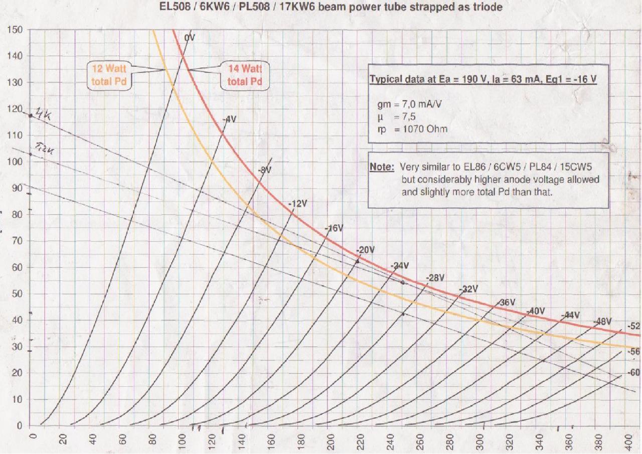

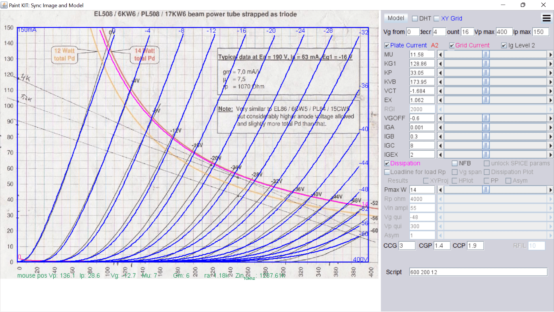

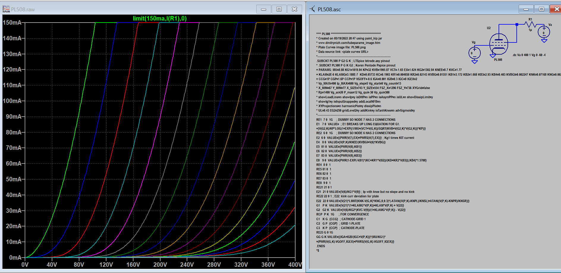

PL508 model to try, there is a triode plot here you can compare:
https://www.diyaudio.com/community/threads/pl508-triode-curves-help.281537/
Code:
**** PL508 ******************************************
* Created on 05/19/2022 20:55 using paint_kip.jar
* Plate Curves image file: PL508.png
.SUBCKT PL508 P G2 G K ; LTSpice tetrode.asy pinout
* .SUBCKT PL508 P G K G2 ; Koren Pentode Pspice pinout
+ PARAMS: MU=8.88 KG1=1019.84 KP=32 KVB=1905.87 VCT=-1.65 EX=1.624 KG2=1302.84 KNEE=8.7 KVC=1.77
+ KLAM=2E-6 KLAMG=3.188E-7  KD=0.05733 KC=0.1903 KR1=0.004858 KR2=0.02143 KVBG=0.01551 KB1=3.172 KB2=1.668 KB3=2.93 KB4=0.403 KVBGI=0.002247 KNK=0.07168 KNG=0.002825 KNPL=2.179E-8 KNSL=1.151E-4 KNPR=198.38 KNSR=119.32
+ CCG=1P CGP=1.6P CCP=1P VGOFF=-0.6 IGA=0.001 IGB=0.3 IGC=8 IGEX=2
* Vp_MAX=400 Ip_MAX=600 Vg_step=5 Vg_start=0 Vg_count=13
* X_MIN=67 Y_MIN=77 X_SIZE=743 Y_SIZE=554 FSZ_X=1296 FSZ_Y=736 XYGrid=false
* Rp=1400 Vg_ac=20 P_max=12 Vg_qui=-30 Vp_qui=300
* UL=0.43 EG2=250 gridLevel2=y addKink=y isTanhKnee=n advSigmoid=y
RE4  8 0  1
RE5 81 0  1
RE6 82 0  1
RE7 83 0  1
RE8  9 0  1
RE21 21 0 1
RE23 G 0 1G
.ENDS

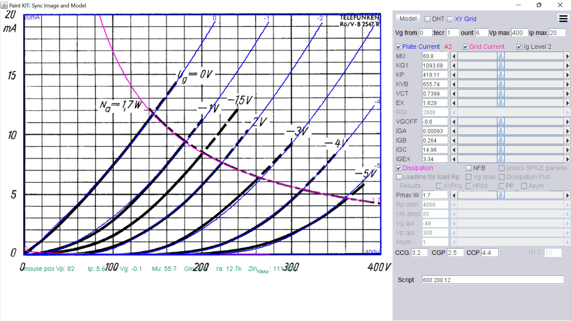

Speicific PL508 triode model:
Code:
**** PL508_T ** Advanced Grid Current **********************************
* Created on 05/19/2022 23:13 using paint_kit.jar 3.1
* Plate Curves image file: PL508-T.png
* Data source link:
.SUBCKT TRIODE_PL508_T 1 2 3 ; Plate Grid Cathode
+ PARAMS: CCG=3P  CGP=1.4P CCP=1.9P
+ MU=11.58 KG1=128.86 KP=33.05 KVB=173.95 VCT=-1.684 EX=1.062
+ VGOFF=-0.6 IGA=0.001 IGB=0.3 IGC=8 IGEX=2
* Vp_MAX=400 Ip_MAX=150 Vg_step=4 Vg_start=0 Vg_count=16
* Rp=4000 Vg_ac=55 P_max=14 Vg_qui=-48 Vp_qui=300
* X_MIN=40 Y_MIN=40 X_SIZE=811 Y_SIZE=541 FSZ_X=1296 FSZ_Y=736 XYGrid=false
* showIg1=y gridLevel2=y isInputSnapped=n
RE2 2 0 1G
EGC 8 0 VALUE={V(2,3)-VGOFF} ; POSITIVE GRID THRESHOLD
GG 2 3 VALUE={(IGA+IGB/(IGC+V(1,3)))*(MU/KG1)*(PWR(V(8),IGEX)+PWRS(V(8),IGEX))}
.ENDS

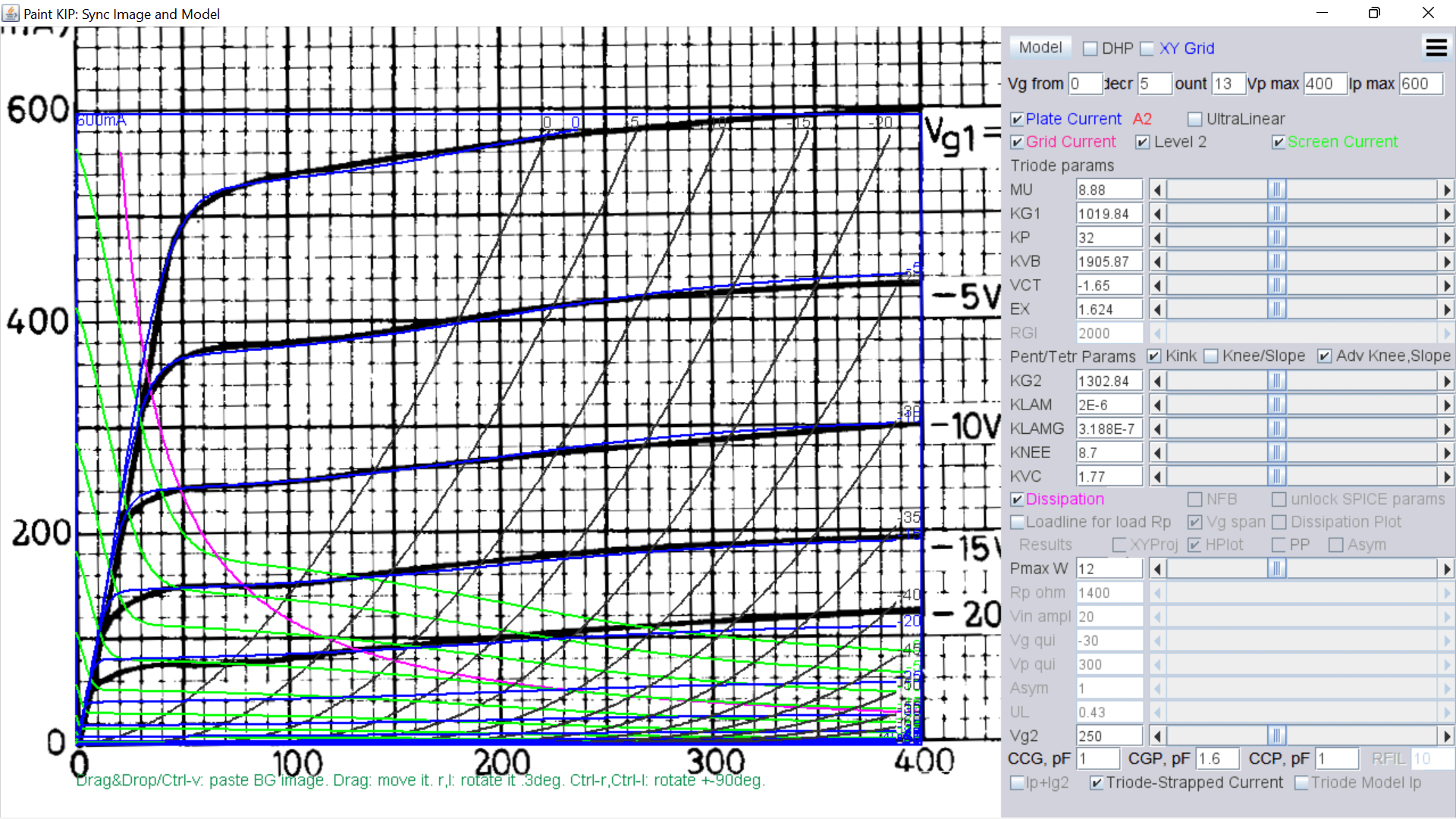

PL508 model to try
Code:

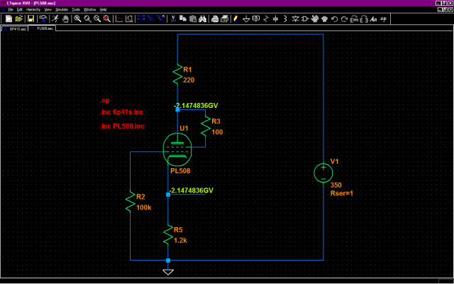

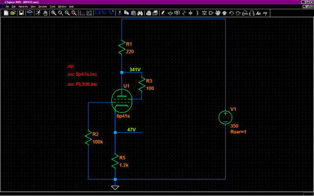

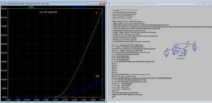

I do get strange results with the PL508 tetrode, though ...
I traced it down using a very simple basic grounded cathode circuit (see ZIP file):
In my good old LTSpice IV the DC OP point analysis runs some length in Damped Pseudo-Transient analysis but finally comes up with what may be a reasonable result.
In LTSpice XVII the DC OP point analysis fails right away showing negative gigavolts ...
When I do the same circuit with Ayjumi 6P41S model no problem ...
  • PL508.zip
    PL508.zip
Try to add the follower options and using Alternate resolver (Tools->Control Panel-> Spice Solver Alternate):
.option noopiter
.options GminSteps=0
.options SrcSteps=1000
This will start source stepping with srcstepmethod=1000, increase as will until it' successful. This condition is best for model created by Paint Tools some models are more complex than others so you need to set the favorable options and alternate solver.

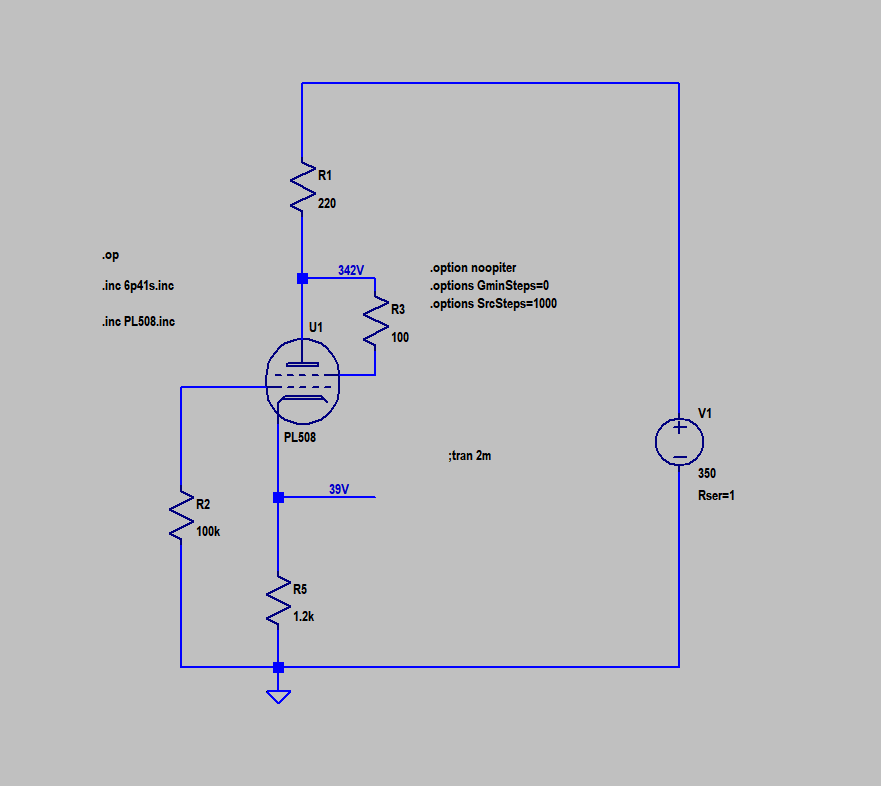

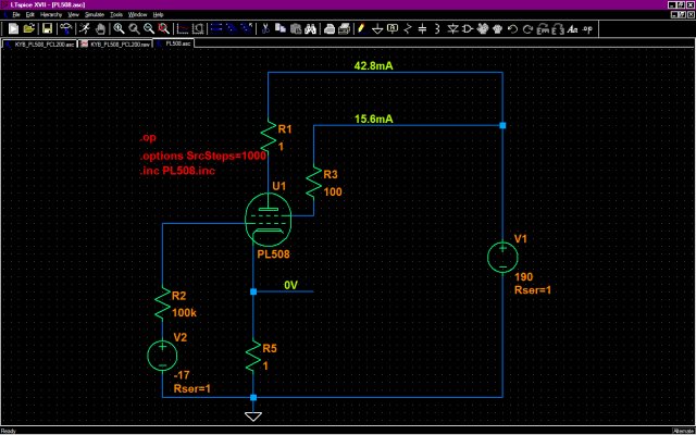

the SrcSteps option alone seems to do the trick.
but we also seem to have an issue with Ig2 now ...
the datasheet gives a characteristic operating point Va = Vg2 = 190V / Vg1 = -17V / Ia = 60mA / Ig2 = 5mA
when I sim that, I get Ia=43mA (lower) and Ig2=15mA ( ! three times the datasheet number !)
my intended application involves the PL508 or 6P41S in a dual drive (both g1 and g2 driven by a PCL200),
so g2 current is of the essence ...
New screen model: Va = Vg2 = 190V / Vg1 = -17V / Ia = 55mA / Ig2 = 5.8mA
Try, I remodeled screen current (based on the above), as no other references are found further alignment prove difficult.
Code:
**** PL508 *******************************2 good***********
* Created on 05/21/2022 13:55 using paint_kip.jar
+ PARAMS: MU=8.88 KG1=1167.52 KP=28.8 KVB=1905.87 VCT=-0.8137 EX=1.592 KG2=2970.48 KNEE=8.7 KVC=1.575
+ KLAM=6.25E-9 KLAMG=2.742E-4  KD=0.03726 KC=0.099 KR1=0.004858 KR2=0.02143 KVBG=0.01551 KB1=3.172 KB2=1.668 KB3=2.93 KB4=0.403 KVBGI=0.002247 KNK=0.02024 KNG=0.004633 KNPL=2.31E-8 KNSL=1.22E-4 KNPR=125.82 KNSR=103.49
* X_MIN=68 Y_MIN=22 X_SIZE=782 Y_SIZE=586 FSZ_X=1296 FSZ_Y=736 XYGrid=false
RE4  8 0  1
RE5 81 0  1
RE6 82 0  1
RE7 83 0  1
RE8  9 0  1
RE21 21 0 1
RE23 G 0 1G
.ENDS
concerning the PL508, looks good for now;
I think I can make some measurements of Ig2 vs Va / Vg2 to get a few more data points ...
