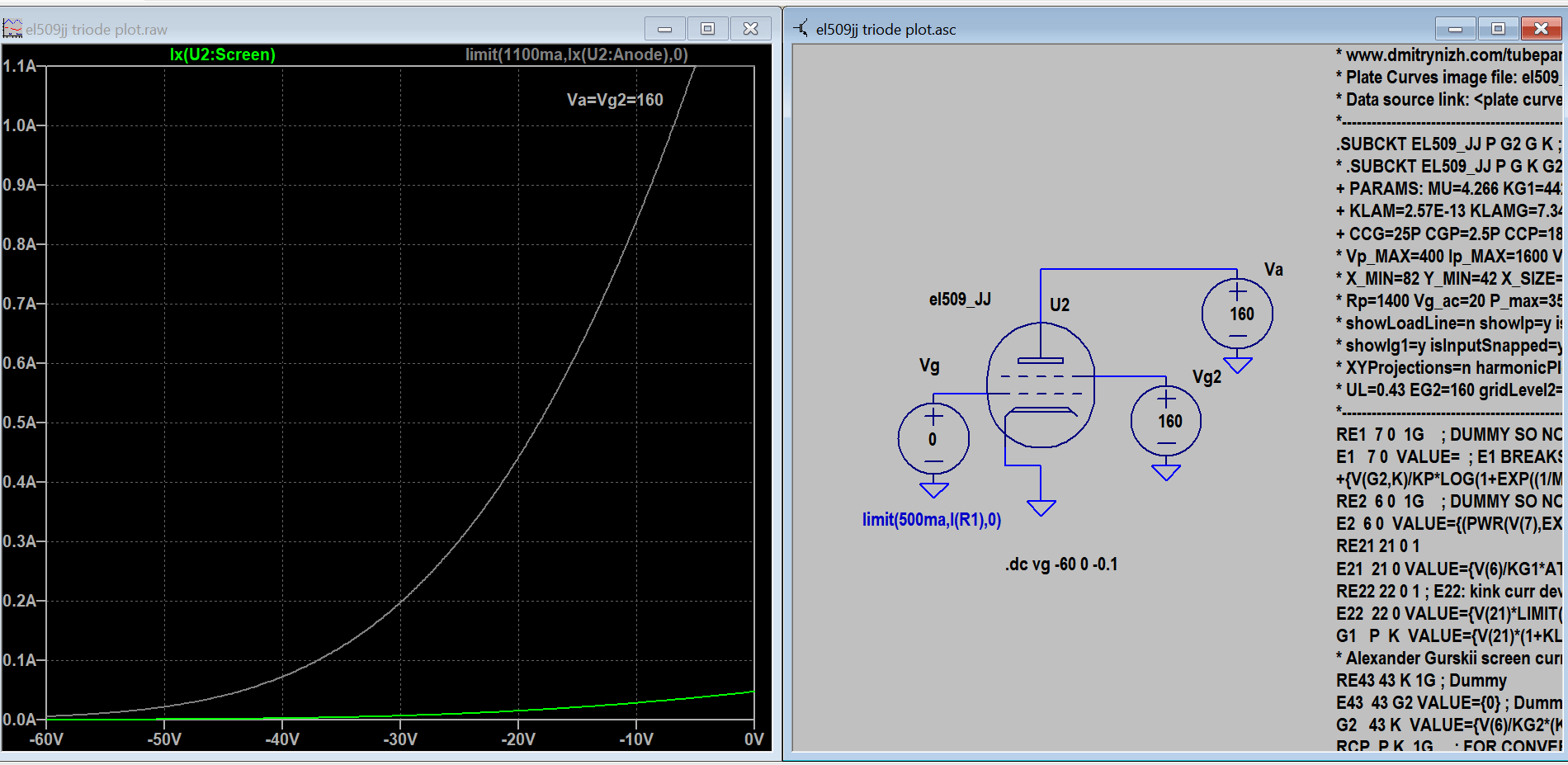

Vacuum Tube SPICE Models

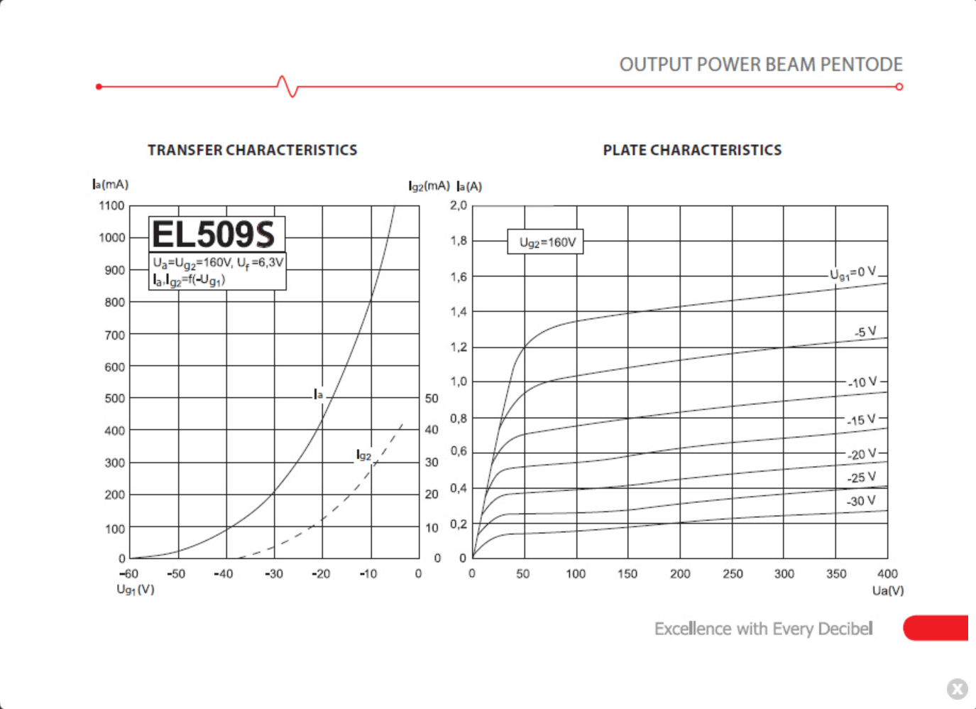

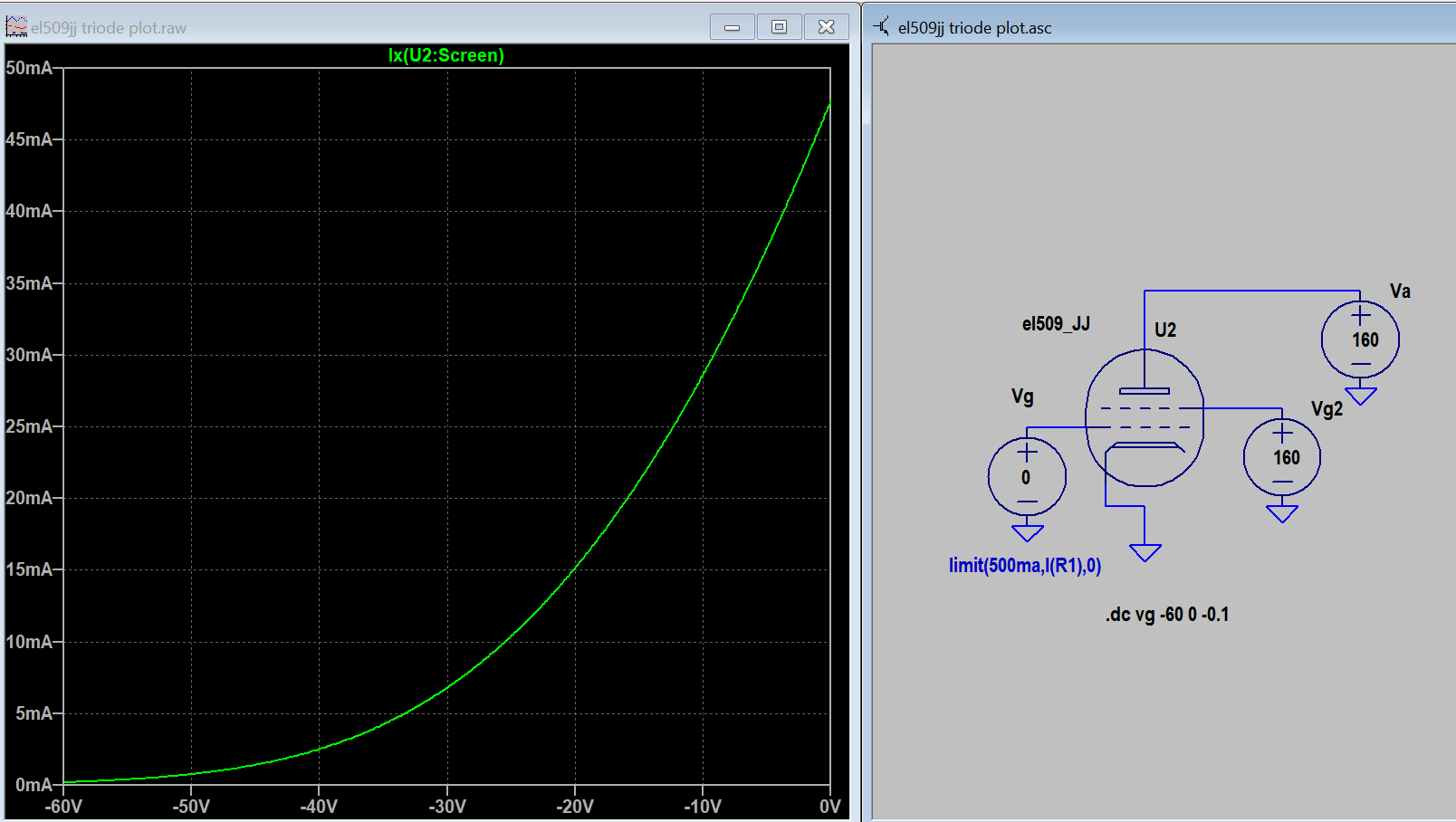

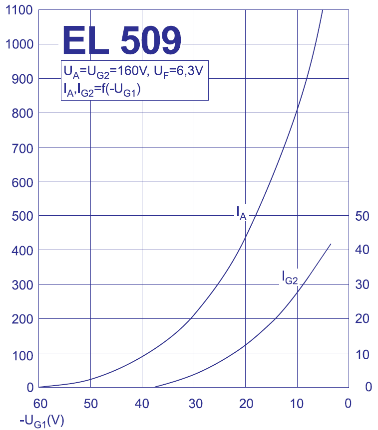

I got 10 pieces of JJ EL509S. Before use I would like to do a couple of simulations in LTspice. I wonder if this tube is 100% equivalent to the older EL / PL509?
if not, I would ask for an updated model.
New EL509-JJ model to correct a problem with screen current in previous model:

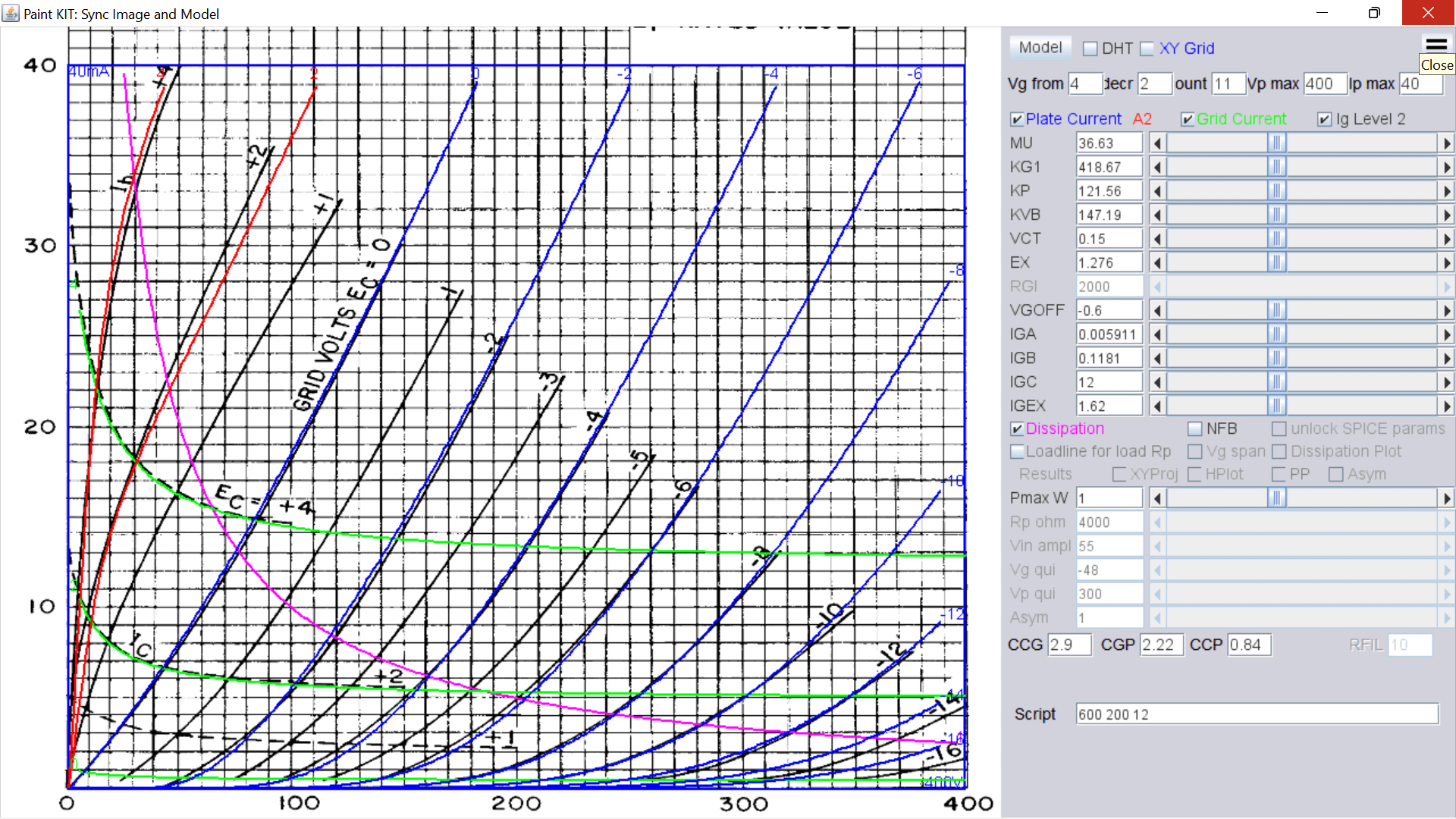

6211 model, try it:

Works well. Thanks.

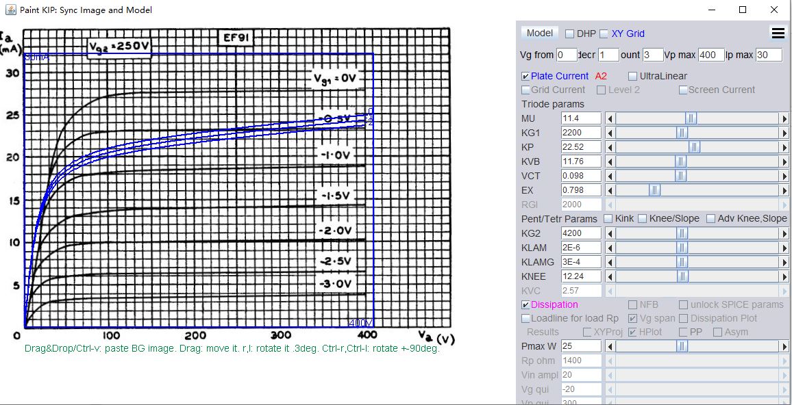

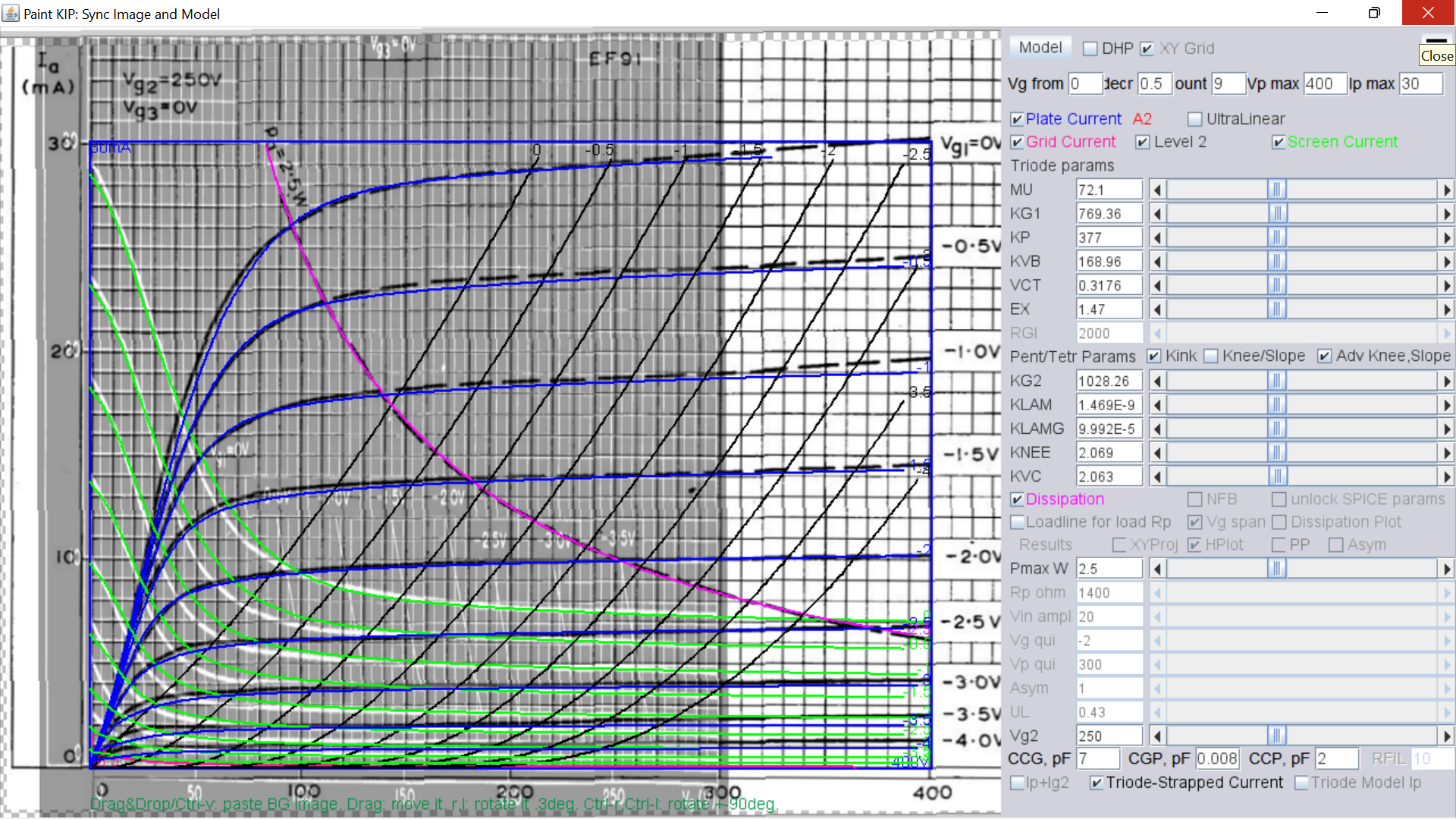

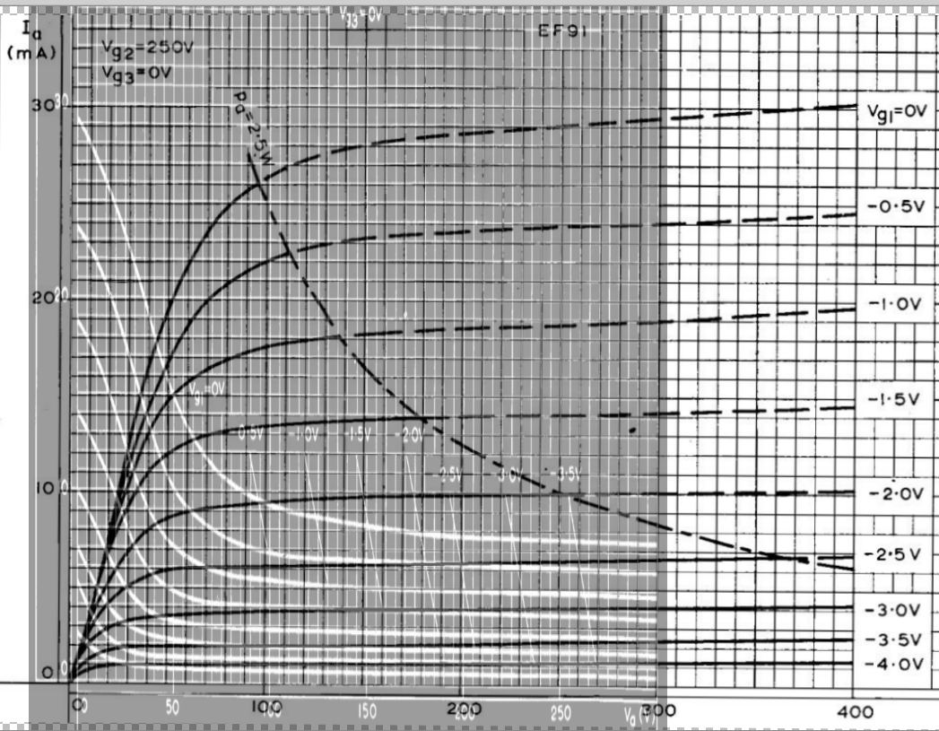

http://www.r-type.org/pdfs/ef91-1.pdf
This curve has screen current data.
The curve is based on Vg2=250V, so it must be set correctly. Mu=ug1-g2=70 (more or less), you're far off. Try to merge screen current curve so you can plot without much guessing. Check on Triode Strapped Current, if you have triode curve, merge it too. Pull "KP", "KLAM" for best fit pentode and triode curve. Pull Kg1, for fine alignment of distances between Vg1 and shape so on, use param "Kink", best fit use "Advance Knee,Slope". Try basic model first.
With triode curve one should be able to determine VCT, usually -Vg1, with KVB aligned the curve bottom to the left and on +Vg1.
EF91 model:
Code:
**** EF91_P ******************************************
* Created on 06/30/2022 00:09 using paint_kip.jar
* www.dmitrynizh.com/tubeparams_image.htm
* Plate Curves image file: ef91-p.png
* Data source link: <plate curves URL>
.SUBCKT EF91_P P G2 G K ; LTSpice tetrode.asy pinout
* .SUBCKT EF91_P P G K G2 ; Koren Pentode Pspice pinout
+ PARAMS: MU=72.1 KG1=769.36 KP=377 KVB=168.96 VCT=0.3176 EX=1.47 KG2=1028.26 KNEE=2.069 KVC=2.063

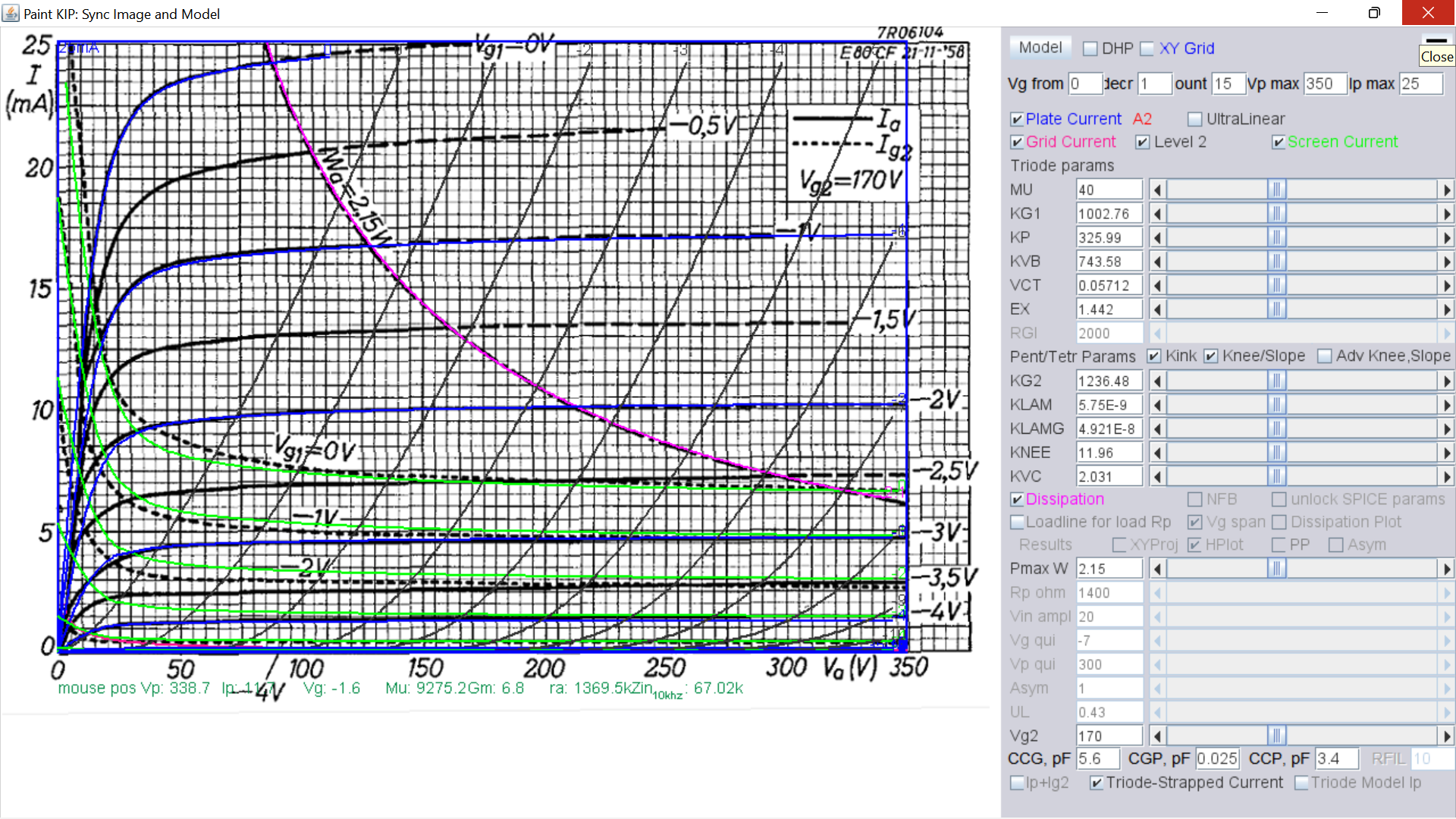

E80CF SQ model:
Code:
