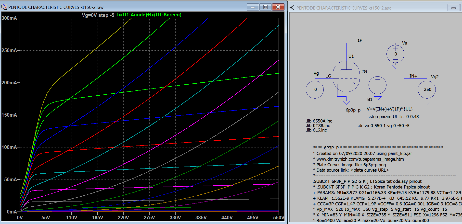

Vacuum Tube SPICE Models
I finished up the Excel pentode version -- but with 14 variables and 8 conditional statements it will be a challenge for MS Solver. Once again, the curves (Ayumi modeled via LTSpice compared to Excel) line up almost perfectly!

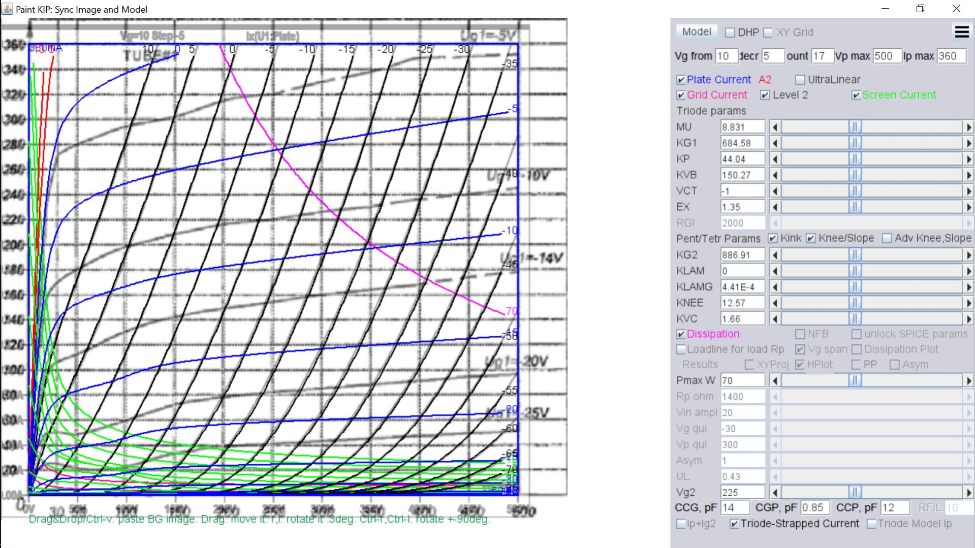

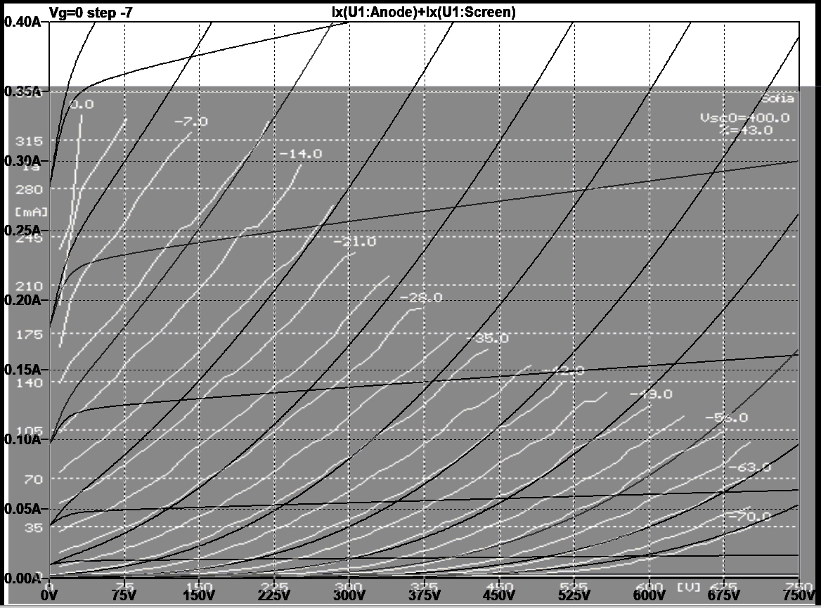

I have adjusted the above model using a traced triode curve: KT150 curves by Sofia - diyAudio, new code:
Code:
**** KT150 ******************************************
* Created on 09/06/2020 15:59 using paint_kip.jar
* [URL="http://www.dmitrynizh.com/tubeparams_image.htm"]Model Paint Tools: Trace Tube Parameters over Plate Curves, Interactively[/URL]
* Plate Curves image file: kt150.png
* Data source link: <plate curves URL>
.SUBCKT KT150 P G2 G K ; LTSpice tetrode.asy pinout
* .SUBCKT KT150 P G K G2 ; Koren Pentode Pspice pinout
+ PARAMS: MU=8.831 KG1=684.58 KP=44.04 KVB=150.27 VCT=-1 EX=1.35 KG2=886.91 KNEE=12.57 KVC=1.66
+ KLAMG=4.41E-4 KNEE2=14.49 KNEX=21.55  KNK=-0.06737 KNG=0.008037 KNPL=0.455 KNSL=5.465 KNPR=102 KNSR=26.97
+ CCG=14P CGP=0.85P CCP=12P VGOFF=-1.5 IGA=0.002788 IGB=0.156 IGC=6.16 IGEX=1.86
* Vp_MAX=500 Ip_MAX=360 Vg_step=5 Vg_start=10 Vg_count=17
* X_MIN=38 Y_MIN=34 X_SIZE=642 Y_SIZE=593 FSZ_X=1296 FSZ_Y=736 XYGrid=false
* Rp=1400 Vg_ac=20 P_max=70 Vg_qui=-30 Vp_qui=300
* showLoadLine=n showIp=y isDHP=n isPP=n isAsymPP=n isUL=n showDissipLimit=y
* showIg1=y isInputSnapped=y addLocalNFB=n
* XYProjections=n harmonicPlot=y dissipPlot=n
* UL=0.43 EG2=225 gridLevel2=y addKink=y isTanhKnee=y advSigmoid=n
RE1  7 0  1G    ; DUMMY SO NODE 7 HAS 2 CONNECTIONS
E1   7 0  VALUE=  ; E1 BREAKS UP LONG EQUATION FOR G1.
+{V(G2,K)/KP*LOG(1+EXP((1/MU+(VCT+V(G,K))/SQRT(KVB+V(G2,K)*V(G2,K)))*KP))}
RE2  6 0  1G    ; DUMMY SO NODE 6 HAS 2 CONNECTIONS
E2  6 0  VALUE={(PWR(V(7),EX)+PWRS(V(7),EX))} ; Kg1 times KIT current
RE21 21 0 1
E21  21 0 VALUE={V(6)/KG1*ATAN((V(P,K)+KNEX)/KNEE)*TANH(V(P,K)/KNEE2)} ; Ip with knee but no slope and no kink
RE22 22 0 1 ; E22: kink curr deviation for plate
E22  22 0 VALUE={V(21)*LIMIT(KNK-V(G,K)*KNG,0,0.3)*(-ATAN((V(P,K)-KNPL)/KNSL)+ATAN((V(P,K)-KNPR)/KNSR))}
G1   P  K  VALUE={V(21)*(1+KLAMG*V(P,K)) + V(22)}
* Alexander Gurskii screen current, see audioXpress 2/2011, with slope and kink added
RE43 43 K 1G ; Dummy
E43  43 G2 VALUE={0} ; Dummy
G2   43 K  VALUE={V(6)/KG2*(KVC-ATAN((V(P,K)+KNEX)/KNEE)*TANH(V(P,K)/KNEE2))/(1+KLAMG*V(P,K))-V(22)}
RCP  P K  1G     ; FOR CONVERGENCE
C1   K G  {CCG}  ; CATHODE-GRID 1
C2   G P  {CGP}  ; GRID 1-PLATE
C3   K P  {CCP}  ; CATHODE-PLATE
RE23 G 0 1G
GG G K VALUE={(IGA+IGB/(IGC+V(P,K)))*(MU/KG1)*
+(PWR(V(G,K)-VGOFF,IGEX)+PWRS(V(G,K)-VGOFF,IGEX))}
.ENDS

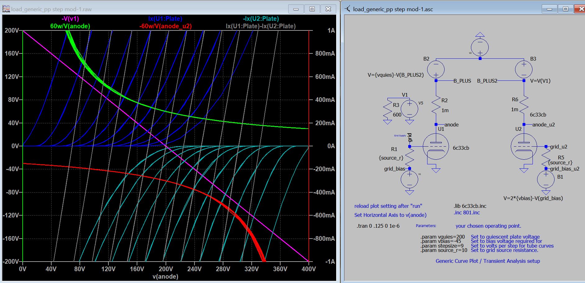

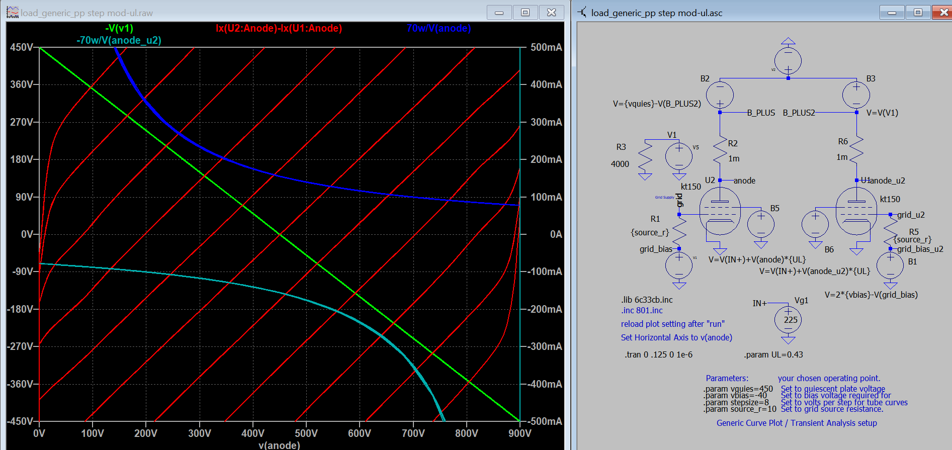

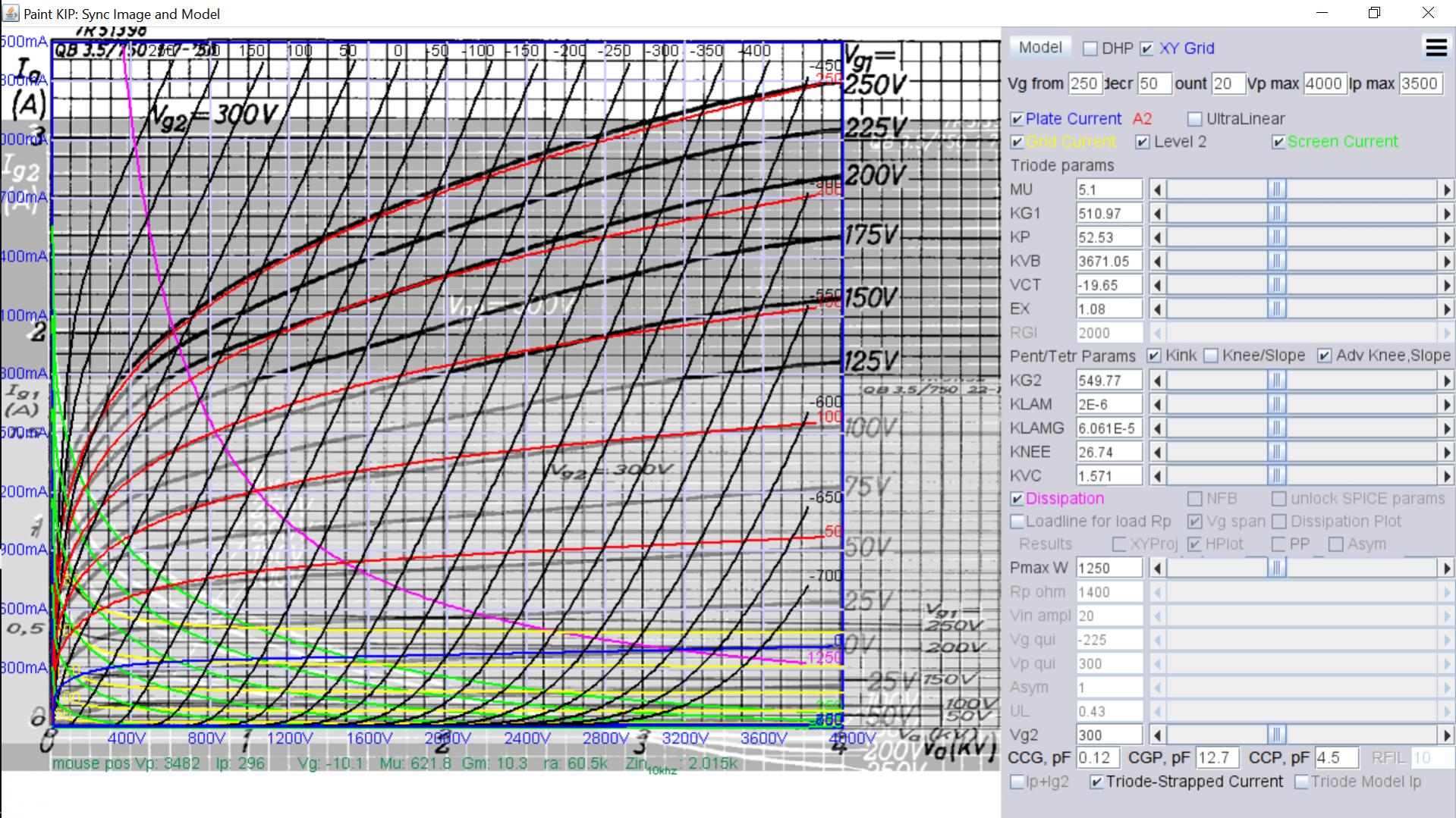

qb3.5-750 model:
Code:
* [url=http://www.dmitrynizh.com/tubeparams_image.htm]Model Paint Tools: Trace Tube Parameters over Plate Curves, Interactively[/url]
* Plate Curves image file: qb3.5-750_P.png
.SUBCKT QB3 P G2 G K ; LTSpice tetrode.asy pinout
* .SUBCKT QB3 P G K G2 ; Koren Pentode Pspice pinout
+ PARAMS: MU=5.1 KG1=510.97 KP=52.53 KVB=3671.05 VCT=-19.65 EX=1.08 KG2=549.77 KNEE=26.74 KVC=1.571
+ KLAM=2E-6 KLAMG=6.061E-5  KD=8.967E-5 KC=0.04329 KR1=6.5E-5 KR2=0.1216 KVBG=0.02385 KB1=0.92 KB2=2.1 KB3=0.02125 KB4=0.3025 KVBGI=0.00102 KNK=-1.5 KNG=0.006 KNPL=50 KNSL=11 KNPR=118.8 KNSR=26.72
+ CCG=0.12P CGP=12.7P CCP=4.5P VGOFF=-5 IGA=3.65E-4 IGB=0.027 IGC=8 IGEX=2
* Vp_MAX=4000 Ip_MAX=3500 Vg_step=50 Vg_start=250 Vg_count=20
* X_MIN=46 Y_MIN=14 X_SIZE=695 Y_SIZE=603 FSZ_X=1296 FSZ_Y=736 XYGrid=false
* Rp=1400 Vg_ac=20 P_max=1250 Vg_qui=-225 Vp_qui=300
* UL=0.43 EG2=300 gridLevel2=y addKink=y isTanhKnee=n advSigmoid=y
E4   8 0  VALUE={V(P,K)/KNEE/(KVBGI+V(6)*KVBG)}
E5  81 0  VALUE={PWR(V(8),KB1)}
E6  82 0  VALUE={PWR(V(8),KB2)}
E7  83 0  VALUE={PWR(V(8),KB3)}
E8   9 0  VALUE={PWR(1-EXP(-V(81)*(KC+KR1*V(82))/(KD+KR2*V(83))),KB4)*1.5708}
RE4  8 0  1
RE5 81 0  1
RE6 82 0  1
RE7 83 0  1
RE8  9 0  1
RE21 21 0 1
E21  21 0 VALUE={V(6)/KG1*V(9)} ; Ip with knee but no slope and no kink
G1   P K  VALUE={V(21)*(1+KLAMG*V(P,K))+KLAM*V(P,K) + V(22)}
G2   G2 K  VALUE={V(6)/KG2*(KVC-V(9))/(1+KLAMG*V(P,K)) - V(22)}
RE23 G 0 1G
.ENDS

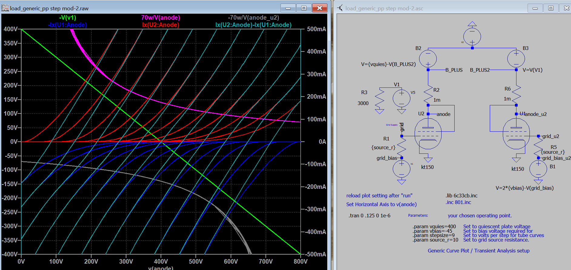

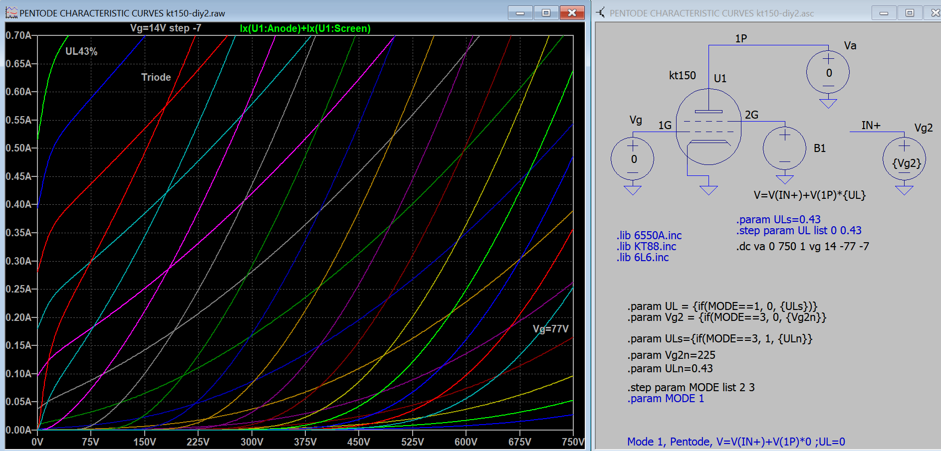

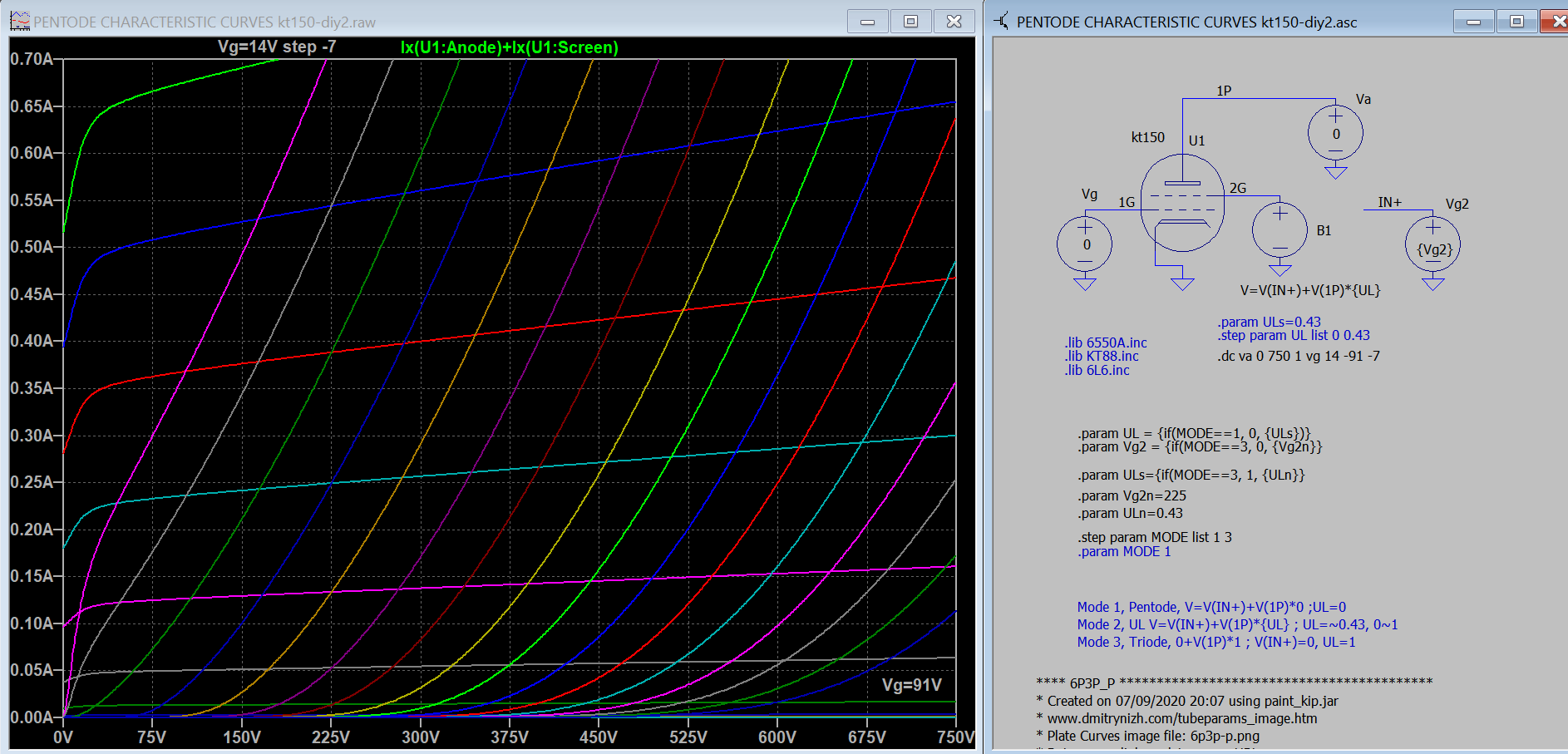

I have posted Pentode/UL mode before, now attached is Pentode/Tiode and UL/Triode curves, welcome any comment. Attached simulation asc will enable one to plot one or all of the pentode, UL and triode curves in one sheet.
  • PENTODE CHARACTERISTIC CURVES diy2.asc

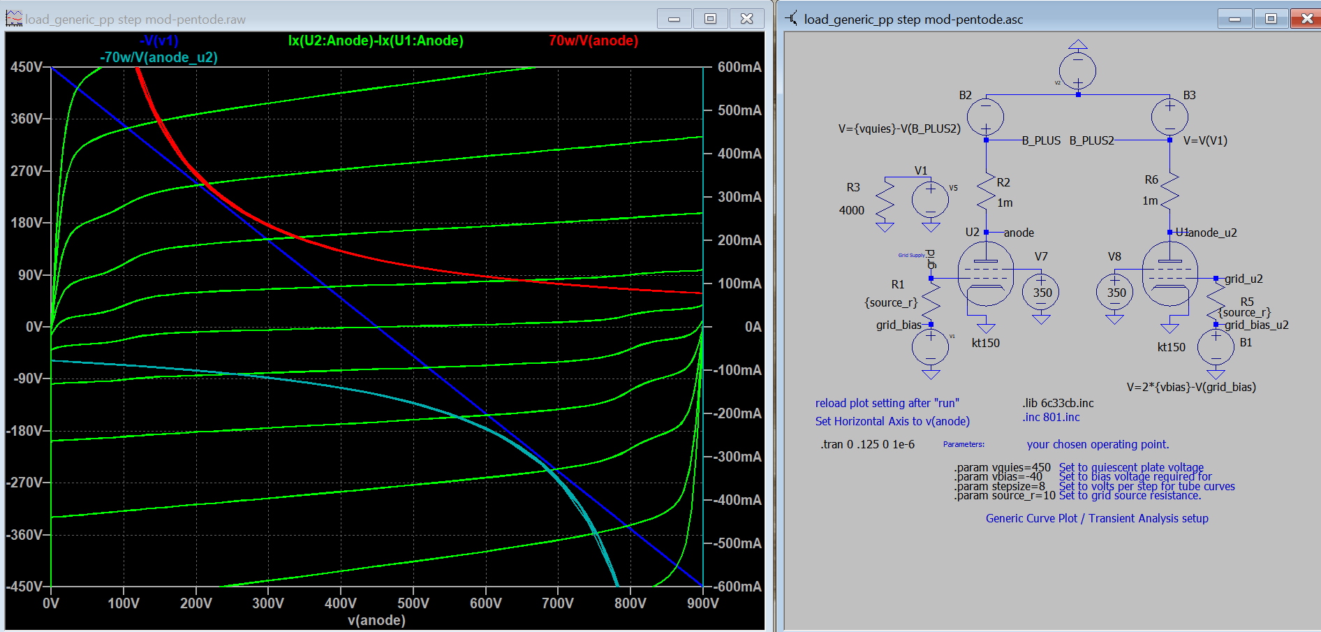

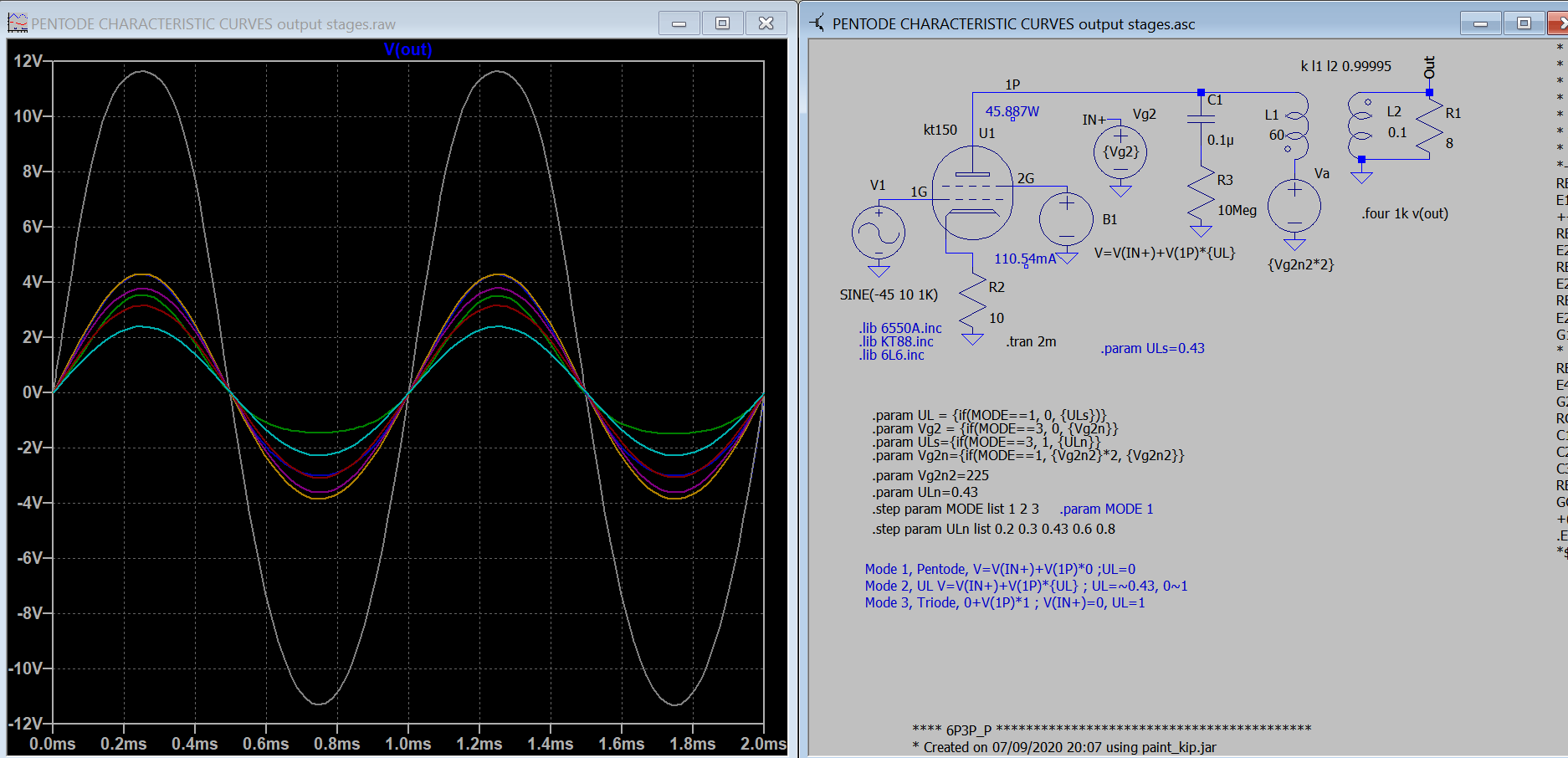

Here is another use of mode switch to determine overall THD and which UL% is least THD distortion.
  • PENTODE CHARACTERISTIC CURVES output stages.asc
  • PENTODE CHARACTERISTIC CURVES output stages-2.txt
  • PENTODE CHARACTERISTIC CURVES output stages-1.txt

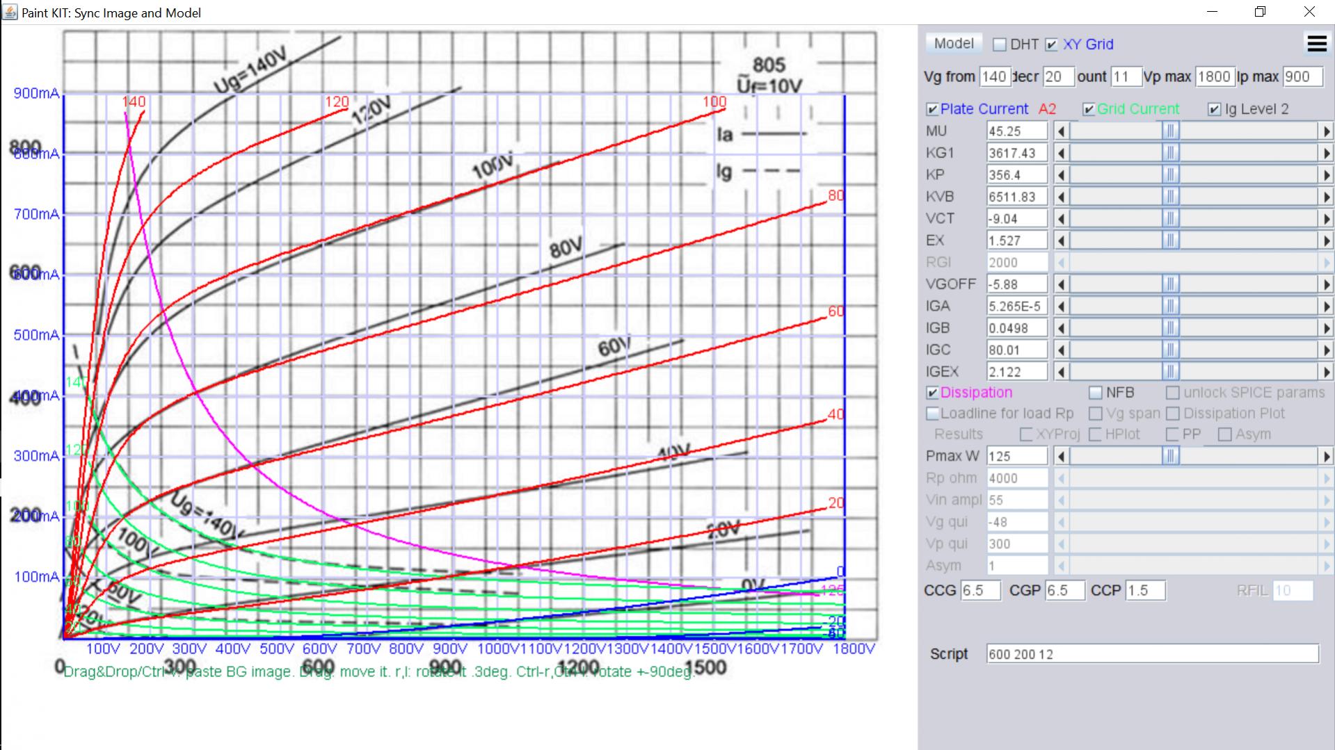

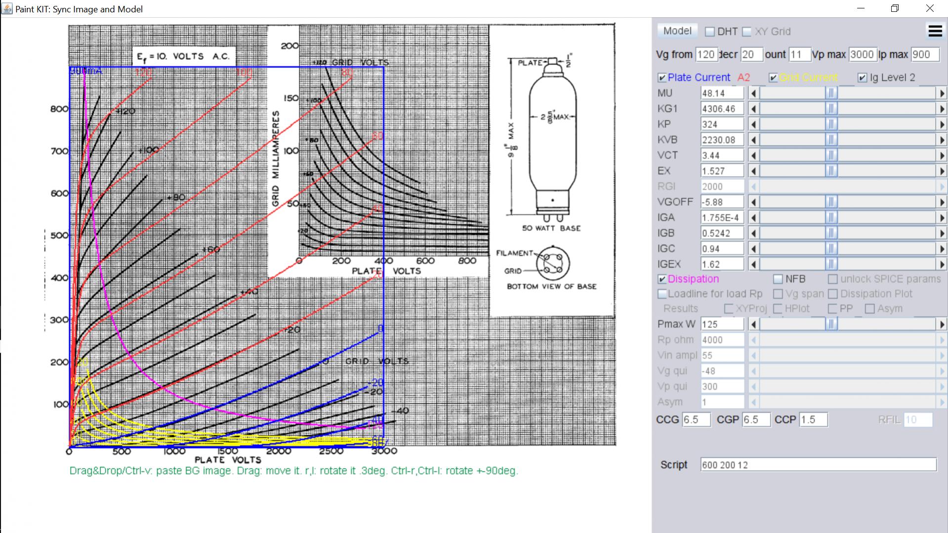

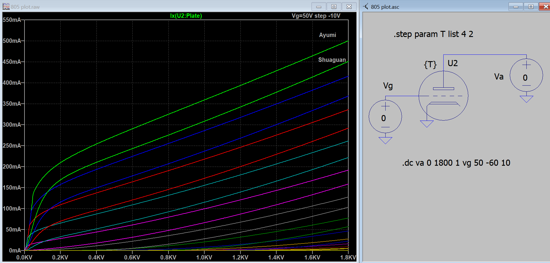

805 Amperex model:
Code:
**** 805 ** Advanced Grid Current **********************************
* Created on 09/10/2020 14:49 using paint_kit.jar 3.1
* Plate Curves image file: 805.png
* Data source link:
.SUBCKT TRIODE_805 1 2 3 ; Plate Grid Cathode

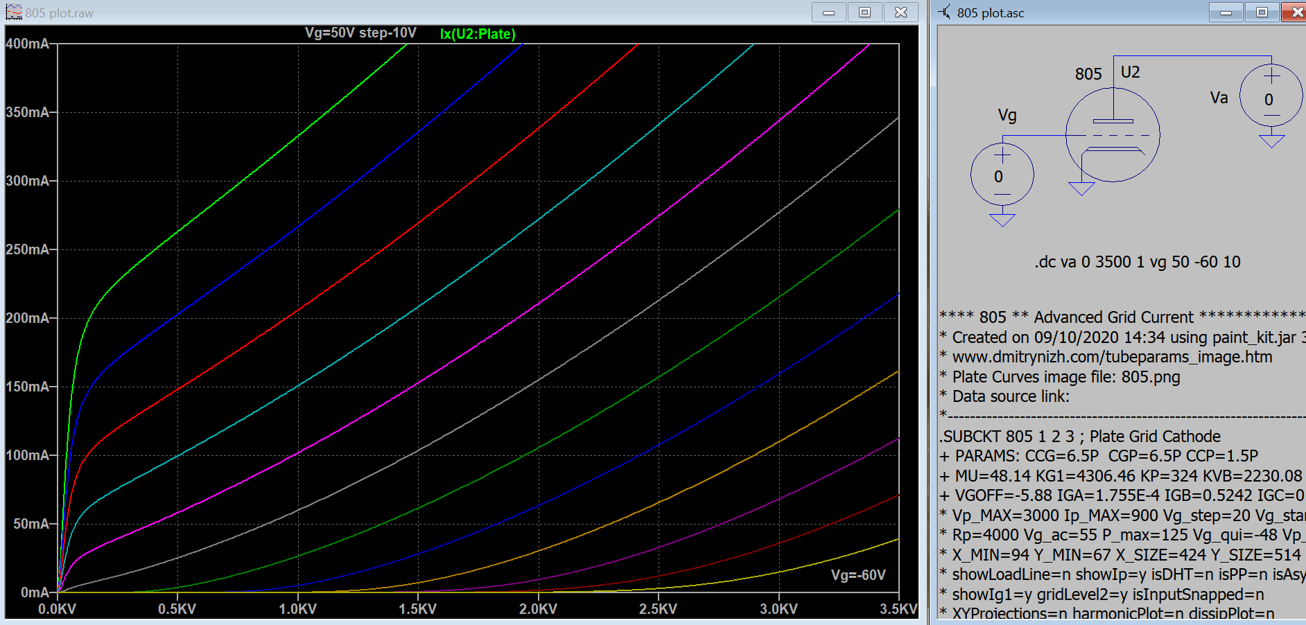

+ PARAMS: CCG=6.5P  CGP=6.5P CCP=1.5P
+ MU=48.14 KG1=4306.46 KP=324 KVB=2230.08 VCT=3.44 EX=1.527
+ VGOFF=-5.88 IGA=1.755E-4 IGB=0.5242 IGC=0.94 IGEX=1.62
* Vp_MAX=3000 Ip_MAX=900 Vg_step=20 Vg_start=120 Vg_count=11
* Rp=4000 Vg_ac=55 P_max=125 Vg_qui=-48 Vp_qui=300
* X_MIN=94 Y_MIN=67 X_SIZE=424 Y_SIZE=514 FSZ_X=1296 FSZ_Y=736 XYGrid=false
* showLoadLine=n showIp=y isDHT=n isPP=n isAsymPP=n showDissipLimit=y
* showIg1=y gridLevel2=y isInputSnapped=n
* XYProjections=n harmonicPlot=n dissipPlot=n
E1 7 0 VALUE={V(1,3)/KP*LOG(1+EXP(KP*(1/MU+(VCT+V(2,3))/SQRT(KVB+V(1,3)*V(1,3)))))}
RE1 7 0 1G  ; TO AVOID FLOATING NODES
G1 1 3 VALUE={(PWR(V(7),EX)+PWRS(V(7),EX))/KG1}
RCP 1 3 1G   ; TO AVOID FLOATING NODES
C1 2 3 {CCG} ; CATHODE-GRID
C2 2 1 {CGP} ; GRID=PLATE
C3 1 3 {CCP} ; CATHODE-PLATE
RE2 2 0 1G
EGC 8 0 VALUE={V(2,3)-VGOFF} ; POSITIVE GRID THRESHOLD
GG 2 3 VALUE={(IGA+IGB/(IGC+V(1,3)))*(MU/KG1)*(PWR(V(8),IGEX)+PWRS(V(8),IGEX))}
.ENDS

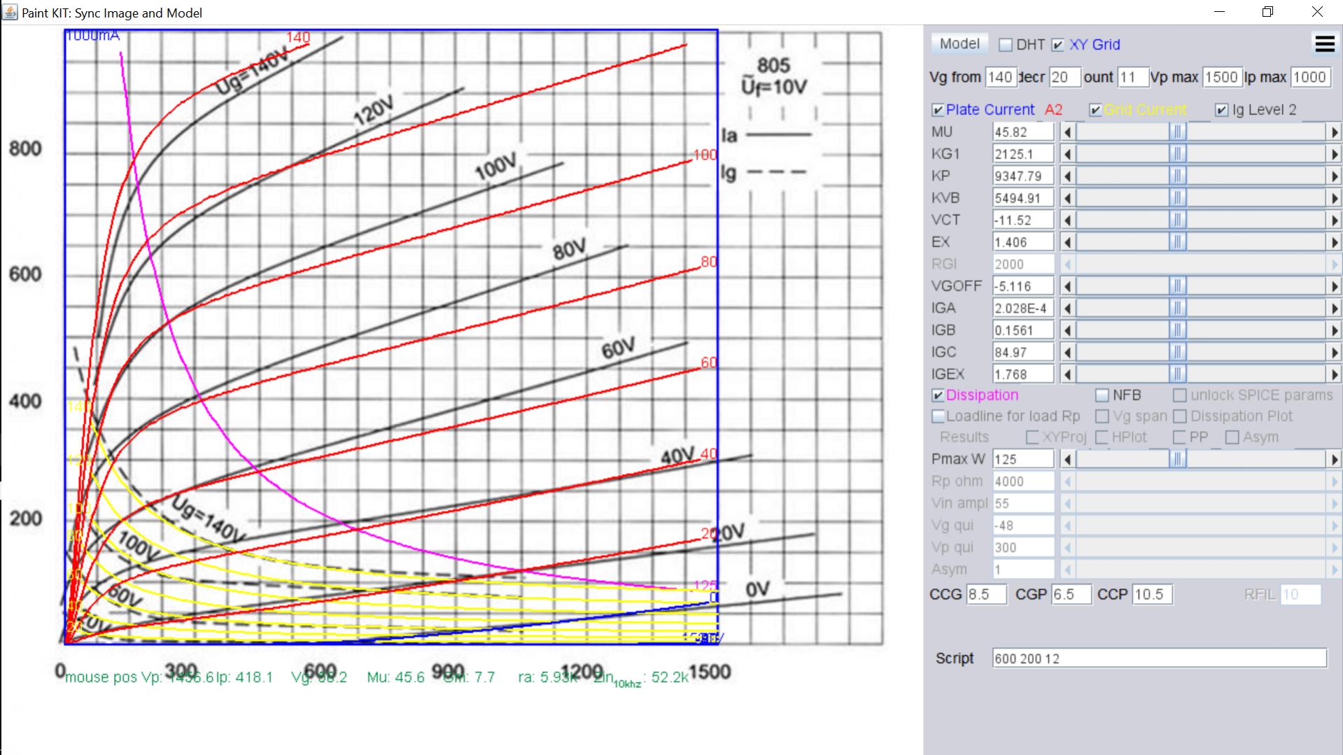

805 Chinese model:
Code:
* Created on 09/10/2020 16:15 using paint_kit.jar 3.1
* Plate Curves image file: 805-ch.png
* Data source link:
.SUBCKT 805_CH 1 2 3 ; Plate Grid Cathode
+ PARAMS: CCG=8.5P  CGP=6.5P CCP=10.5P
+ MU=45.82 KG1=2125.1 KP=9347.79 KVB=5494.91 VCT=-11.52 EX=1.406
+ VGOFF=-5.116 IGA=2.028E-4 IGB=0.1561 IGC=84.97 IGEX=1.768
* Vp_MAX=1500 Ip_MAX=1000 Vg_step=20 Vg_start=140 Vg_count=11
* X_MIN=62 Y_MIN=5 X_SIZE=622 Y_SIZE=586 FSZ_X=1296 FSZ_Y=736 XYGrid=false
RE2 2 0 1G
.ENDS
Disabled Account
Joined 2013
805 Chinese model does not plot properly I'll look into it. Here is Ayumi model, it's close to Amperex:

805_CH fixed:
Code:
**** 805_CH ** Advanced Grid Current **********************************
* Created on 09/10/2020 19:28 using paint_kit.jar 3.1
* Data source link:
+ MU=45.25 KG1=3617.43 KP=356.4 KVB=6511.83 VCT=-9.04 EX=1.527
+ VGOFF=-5.88 IGA=5.265E-5 IGB=0.0498 IGC=80.01 IGEX=2.122
* Vp_MAX=1800 Ip_MAX=900 Vg_step=20 Vg_start=140 Vg_count=11
* X_MIN=61 Y_MIN=67 X_SIZE=749 Y_SIZE=523 FSZ_X=1296 FSZ_Y=736 XYGrid=true
RE2 2 0 1G
.ENDS

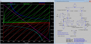

Here are generic push pull loadline of pentode, UL and triode mode for sharing.
  • load_generic_pp step mod-pentode.asc
  • load_generic_pp step mod-1.asc
  • load_generic_pp step mod-ul.asc

Disabled Account
Joined 2013

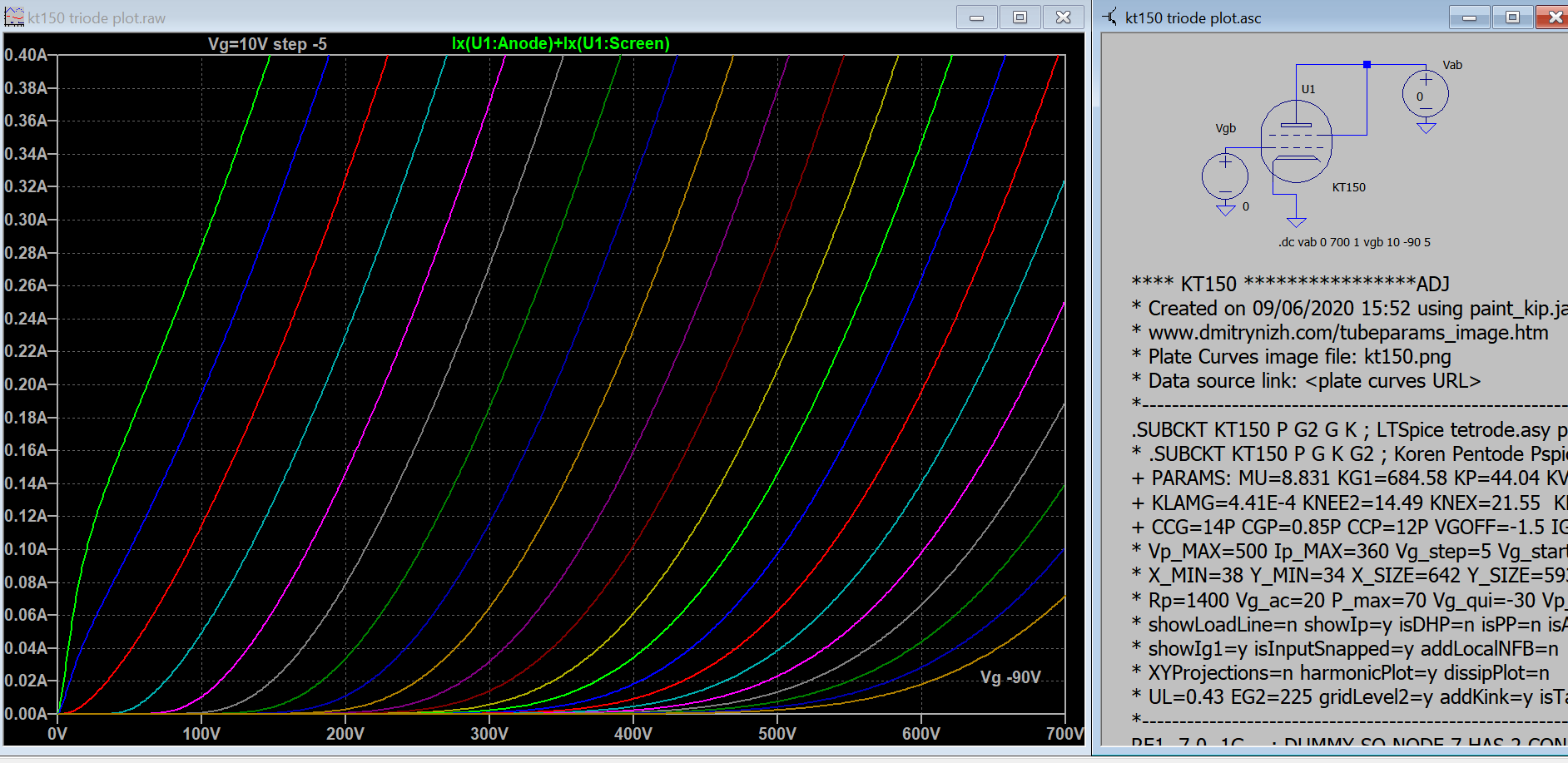

Code:
RE21 21 0 1
RE23 G 0 1G
.ENDS
I have adjusted the screen grid2 current down from previous model:
Code:
* X_MIN=73 Y_MIN=52 X_SIZE=586 Y_SIZE=544 FSZ_X=1296 FSZ_Y=736 XYGrid=false
RE21 21 0 1
RE23 G 0 1G
.ENDS
