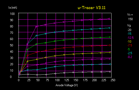

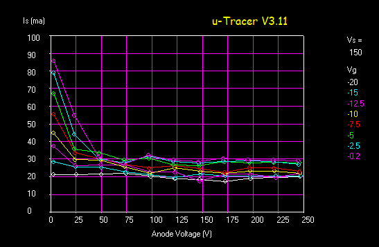

Hmm... may it be that something is wrong with your uTracer ig2 chanel?
The ig2 graph looks a bit disturbed...
Perhaps it is better to create a model based on the Telefunken datasheet. It even contains ig1 current curves!
What do you think?

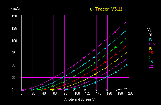

The IG2 curves on both datasheets are very compressed in the region of negative VG1 values. I've checked the current amplifers and voltage amplifers of both Va and Vg2 and they seem to be in close compliance.

Remember that G2 of both sections of the valve are interconnected. The tube, in my practice (in my youth) was used as an output tube @144MHz

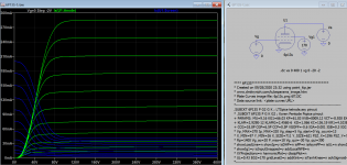

That is a problem for my generic tetrode model, which assumes independent sections. What I can offer is a model valid for both system driven in parallel (both plates connected, both g1 connected)G2 of both sections of the valve are interconnected
Is there a LTSpice tetrode model of the 6P13S tube? ThanksIt works partly. The anode current varies according to the grid voltage at .op-mode, but not at .tran-mode.

Hi zintoloThank you Adrian, I was searching tetrode mode model.
I had a short look into the datasheet. As supposed, there are no Ig1 traces (needed to generate a COMPLETE model). So some questions:
1) do you have a sample of this tube available
2) would it be possible to let you measure 7-8 working points of this tube?

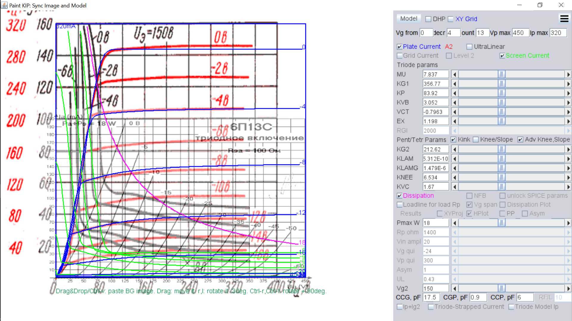

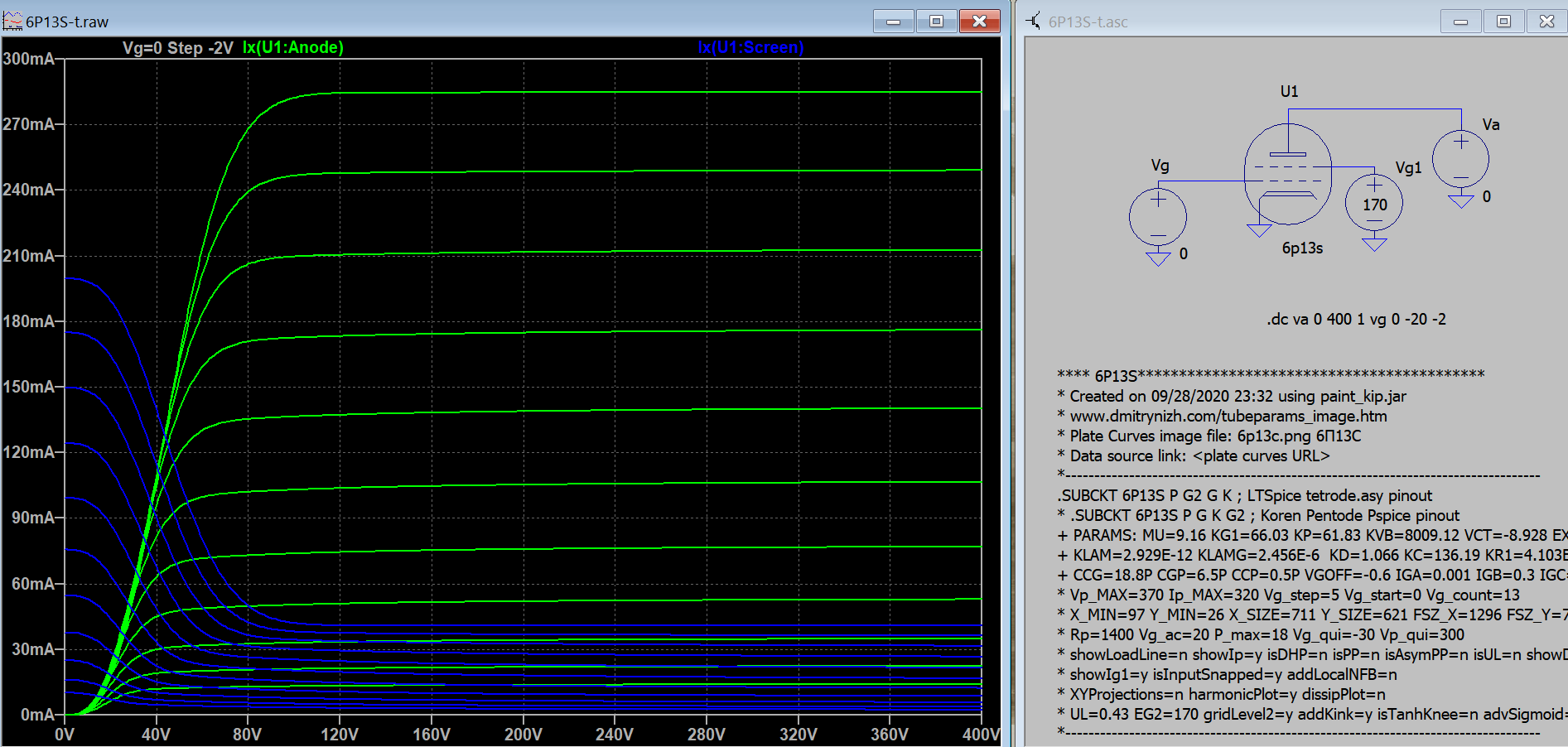

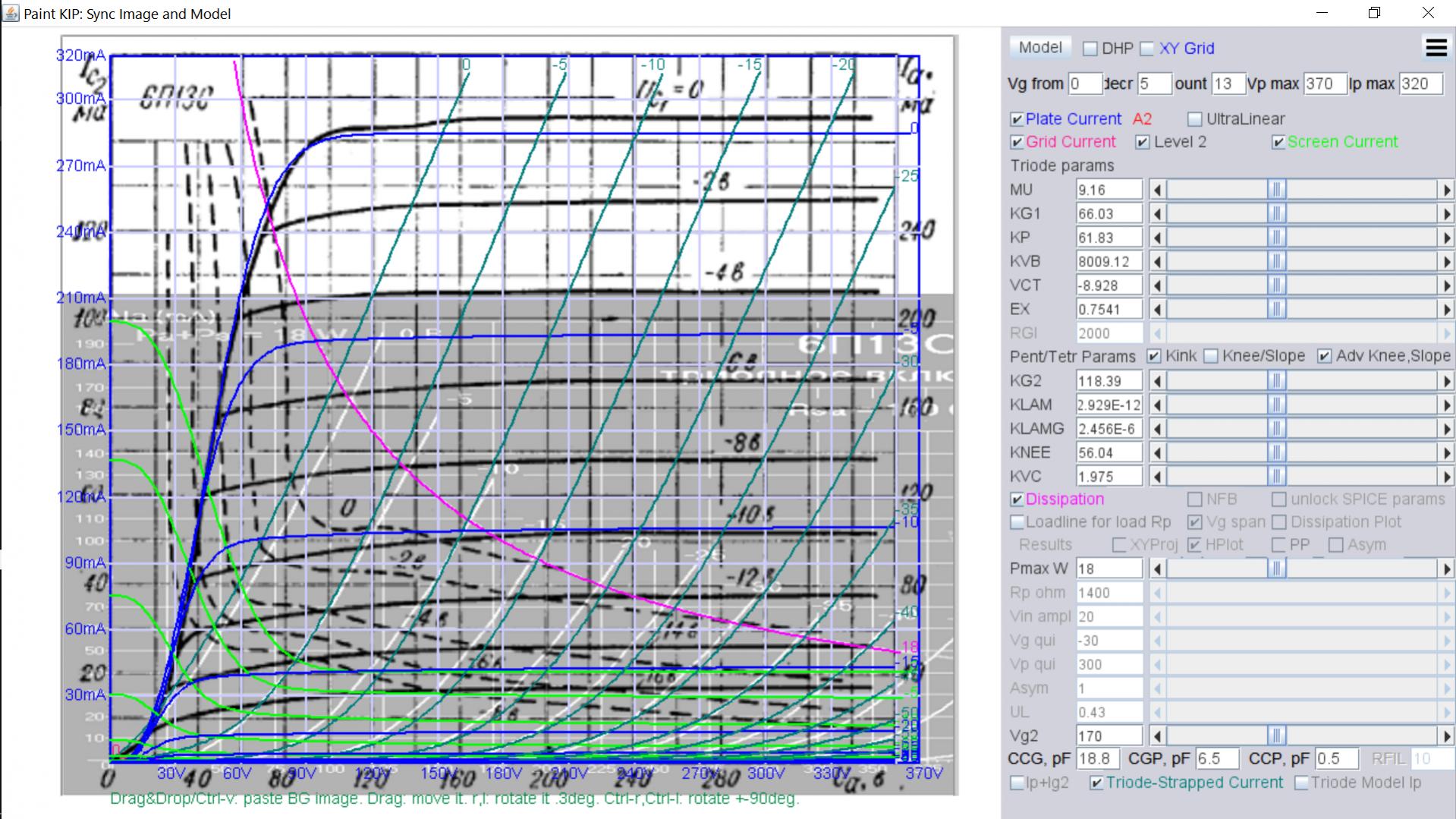

Here is the Paint tool model for 6П13С (6P3S) for sharing:

Thank you very much! I will use this model by now!Here is the Paint tool model for 6П13С (6P3S) for sharing:
Thank you Adrian, I will do like you suggest, indeed: simulate with the model proposed by Koonw and then arrange that Arduino system to get full data.Hi zintolo,
why not? Feel free, whatever is faster for you.
Code:**** 6P13S****************************************** * Created on 09/28/2020 23:32 using paint_kip.jar * [URL="http://www.dmitrynizh.com/tubeparams_image.htm"]Model Paint Tools: Trace Tube Parameters over Plate Curves, Interactively[/URL] * Plate Curves image file: 6p13c.png 6П13С * Data source link: <plate curves URL> *---------------------------------------------------------------------------------- .SUBCKT 6P13S P G2 G K ; LTSpice tetrode.asy pinout * .SUBCKT 6P13S P G K G2 ; Koren Pentode Pspice pinout + PARAMS: MU=9.16 KG1=66.03 KP=61.83 KVB=8009.12 VCT=-8.928 EX=0.7541 KG2=118.39 KNEE=56.04 KVC=1.975 + KLAM=2.929E-12 KLAMG=2.456E-6 KD=1.066 KC=136.19 KR1=4.103E-5 KR2=0.00278 KVBG=0.408 KB1=2.18 KB2=8028.16 KB3=0.2875 KB4=1.43 KVBGI=2.867 KNK=-0.003195 KNG=0.01106 KNPL=0.5676 KNSL=4.873 KNPR=0.5676 KNSR=49.57 + CCG=18.8P CGP=6.5P CCP=0.5P VGOFF=-0.6 IGA=0.001 IGB=0.3 IGC=8 IGEX=2 * Vp_MAX=370 Ip_MAX=320 Vg_step=5 Vg_start=0 Vg_count=13 * X_MIN=97 Y_MIN=26 X_SIZE=711 Y_SIZE=621 FSZ_X=1296 FSZ_Y=736 XYGrid=true * Rp=1400 Vg_ac=20 P_max=18 Vg_qui=-30 Vp_qui=300 * showLoadLine=n showIp=y isDHP=n isPP=n isAsymPP=n isUL=n showDissipLimit=y * showIg1=y isInputSnapped=y addLocalNFB=n * XYProjections=n harmonicPlot=y dissipPlot=n * UL=0.43 EG2=170 gridLevel2=y addKink=y isTanhKnee=n advSigmoid=y *---------------------------------------------------------------------------------- RE1 7 0 1G ; DUMMY SO NODE 7 HAS 2 CONNECTIONS E1 7 0 VALUE= ; E1 BREAKS UP LONG EQUATION FOR G1. +{V(G2,K)/KP*LOG(1+EXP((1/MU+(VCT+V(G,K))/SQRT(KVB+V(G2,K)*V(G2,K)))*KP))} RE2 6 0 1G ; DUMMY SO NODE 6 HAS 2 CONNECTIONS E2 6 0 VALUE={(PWR(V(7),EX)+PWRS(V(7),EX))} ; Kg1 times KIT current E4 8 0 VALUE={V(P,K)/KNEE/(KVBGI+V(6)*KVBG)} E5 81 0 VALUE={PWR(V(8),KB1)} E6 82 0 VALUE={PWR(V(8),KB2)} E7 83 0 VALUE={PWR(V(8),KB3)} E8 9 0 VALUE={PWR(1-EXP(-V(81)*(KC+KR1*V(82))/(KD+KR2*V(83))),KB4)*1.5708} RE4 8 0 1 RE5 81 0 1 RE6 82 0 1 RE7 83 0 1 RE8 9 0 1 RE21 21 0 1 E21 21 0 VALUE={V(6)/KG1*V(9)} ; Ip with knee but no slope and no kink RE22 22 0 1 ; E22: kink curr deviation for plate E22 22 0 VALUE={V(21)*LIMIT(KNK-V(G,K)*KNG,0,0.3)*(-ATAN((V(P,K)-KNPL)/KNSL)+ATAN((V(P,K)-KNPR)/KNSR))} G1 P K VALUE={V(21)*(1+KLAMG*V(P,K))+KLAM*V(P,K) + V(22)} G2 G2 K VALUE={V(6)/KG2*(KVC-V(9))/(1+KLAMG*V(P,K)) - V(22)} RCP P K 1G ; FOR CONVERGENCE C1 K G {CCG} ; CATHODE-GRID 1 C2 G P {CGP} ; GRID 1-PLATE C3 K P {CCP} ; CATHODE-PLATE RE23 G 0 1G GG G K VALUE={(IGA+IGB/(IGC+V(P,K)))*(MU/KG1)* +(PWR(V(G,K)-VGOFF,IGEX)+PWRS(V(G,K)-VGOFF,IGEX))} .ENDS *$
The above model lacks of convergence and terminate prematurely, here is the update model:
