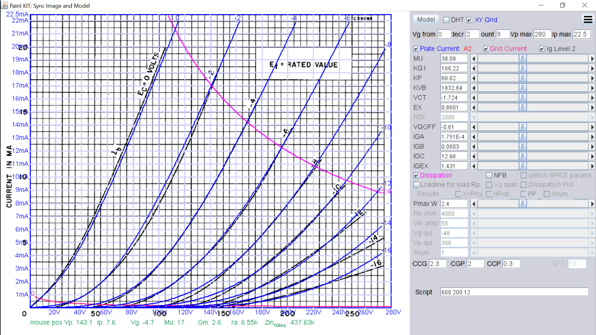

Here are the model for 7199 pentode and triode section:
Triode
Code:
 * [URL="http://www.dmitrynizh.com/tubeparams_image.htm"]www.dmitrynizh.com/tubeparams_image.htm[/URL]
* Plate Curves image file: 7199-t.png
* Data source link:
.SUBCKT 7199_T 1 2 3 ; Plate Grid Cathode
+ PARAMS: CCG=2.3P  CGP=2P CCP=0.3P
+ MU=38.09 KG1=166.22 KP=68.02 KVB=1832.64 VCT=-1.724 EX=0.8601
+ VGOFF=-0.61 IGA=1.751E-4 IGB=0.0603 IGC=12.96 IGEX=1.431
* Vp_MAX=280 Ip_MAX=22.5 Vg_step=2 Vg_start=0 Vg_count=9
* Rp=4000 Vg_ac=55 P_max=2.4 Vg_qui=-48 Vp_qui=300
* X_MIN=65 Y_MIN=8 X_SIZE=775 Y_SIZE=630 FSZ_X=1296 FSZ_Y=736 XYGrid=true
* showLoadLine=n showIp=y isDHT=n isPP=n isAsymPP=n showDissipLimit=y
* showIg1=y gridLevel2=y isInputSnapped=n
* XYProjections=n harmonicPlot=n dissipPlot=n

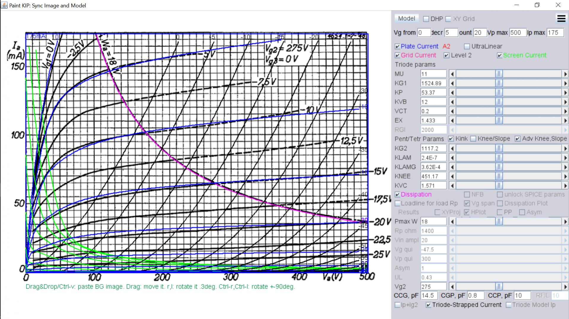

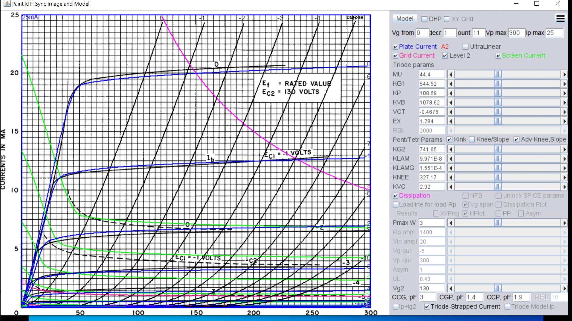

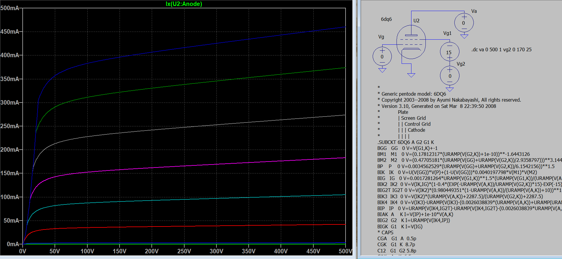

I run 6DQ6 model for screen-drive with zero grid voltage,
and the results are much different from data sheet or experiments.
Is there any tools or methods I can modify the parameter?

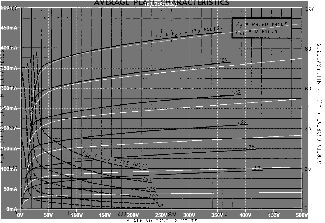

I can build a model of the tube you used if you want. Ayumi model does not matched GE or Tung Sol curves. It may become close when the screen voltage is adjusted depend on the tubes you use. E.g if the Vg2 difference is -15V (150v-135v) then you reduce screen drive by 15v. This is fudge factor for different Vg2 curve, I think. You'll need the IV curve for Vg2 as well, see if can plot it.
Here is comparison of IV curve for Vg2 of Ayumi 6dq6 model and Ge curve after Vg2 has been reduced by 15V, it's very close at top 175v and bottom 50v somewhat loose in between.

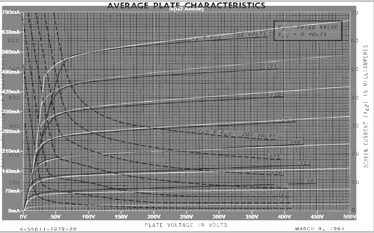

I made 2 mistakes, one is the scaling. the previous curve is Tung Sol which can't compensated even with screen voltage adjusted. But the Ayumi model actually matched quite well with GE curve without any adjustment, except the tilt a little to the left. If you want other models please request.

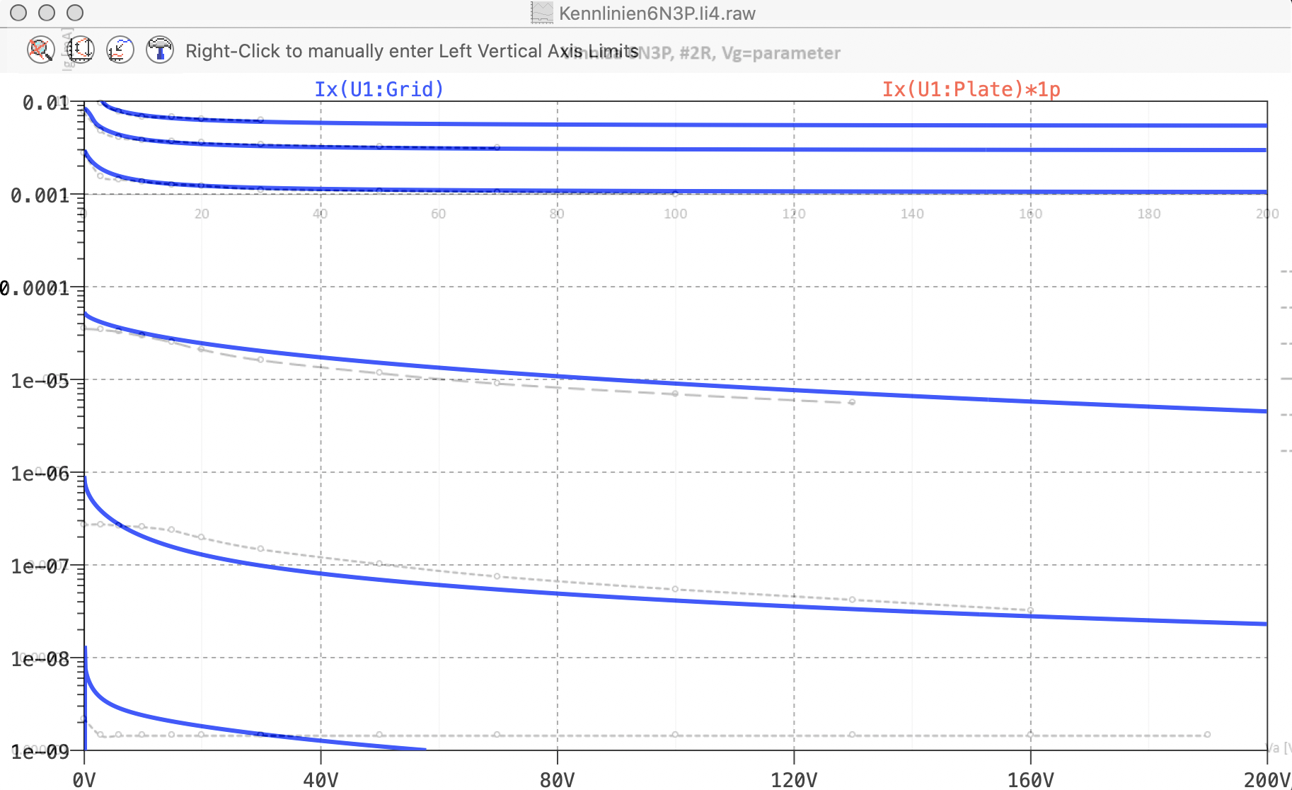

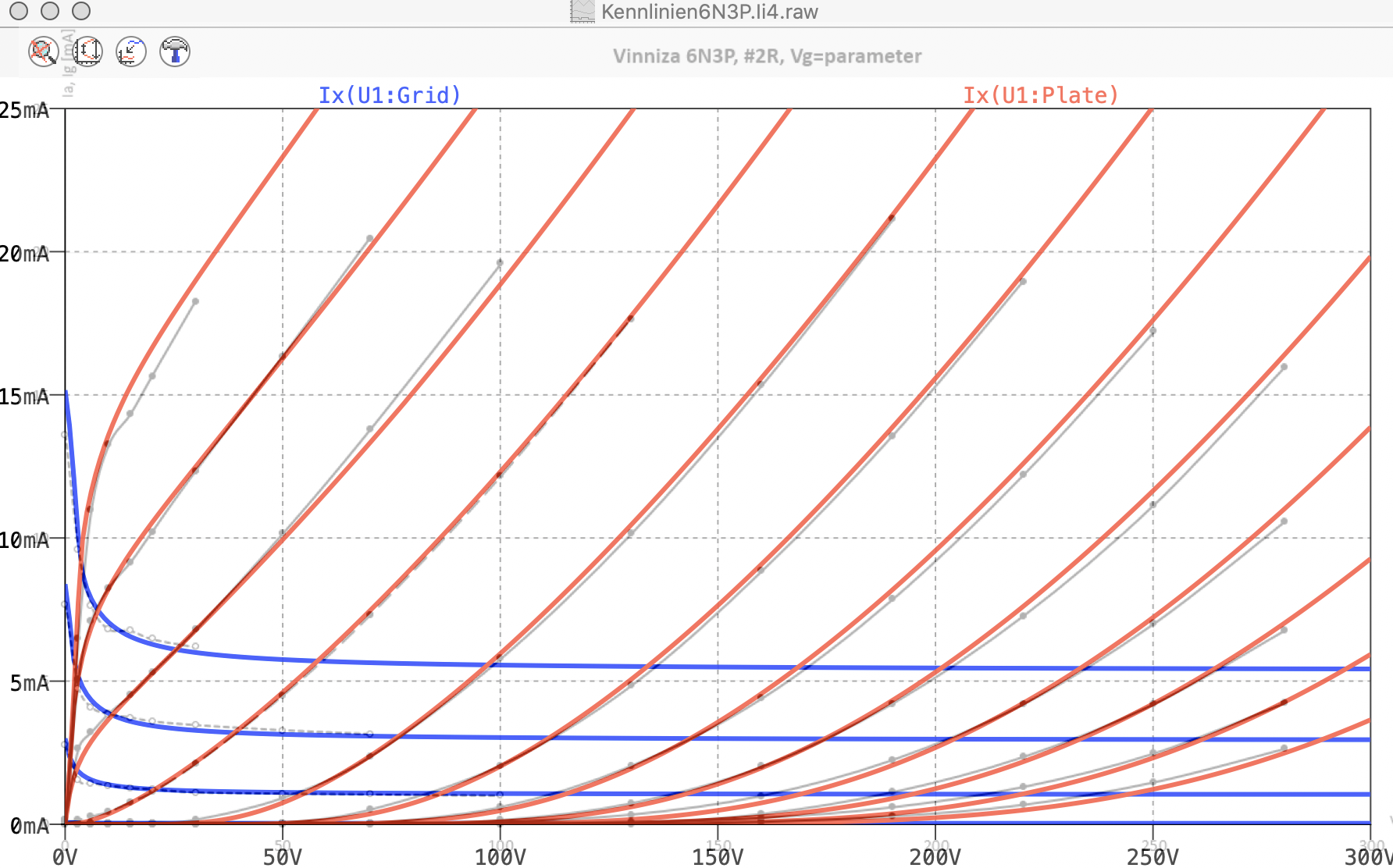

Here my model for the 6N3P.
My "golden Sample" is out of 5 tubes, each burned-in for 100 hours - so my model claimes to be pretty close to reality!
all the best, Adrian

*Space charge current model
Bggi GGi 0 V=v(Gi,K)+Vg0 ;Effective internal grid voltage.
Bahc Ahc 0 V=uramp(v(A,K)) ;Anode voltage, hard cut to zero @ neg. value
Bst   St 0 V=uramp(max(v(GGi)+v(A,K)/(mu), v(A,K)/kp*ln(1+exp(kp*(1/mu+v(GGi)/(1+v(Ahc)))))));Steering volt.
Bs    Ai K I=os/ks*pow(v(St),xs) ;Langmuir-Childs law for the space charge current Is
*Anode current limit @ small Va
.func smin(z,y,k) {pow(pow(z+1f, -k)+pow(y+1f, -k), -1/k)} ;Min-function with smooth trans.
Ra  A Ai 1
Bgl Gi A I=min(i(Ra)-smin(1/kl*pow(v(Ahc),xl),i(Ra),tsh),i(Bgvd)*exp(4*v(G,K))) ;Ia emission limit
*Grid model
Bvdg G Gi I=1/kvdg*pwrs(v(G,Gi),1.5) ;Reduces the internal effective grid voltage when Ig rises
Rgip G Gi 1G ;avoids some warnings
Cvdg G Gi 0p1;this small cap improves convergence
.func fVT() {VT*exp(-kVT*sqrt(v(A,K)))}
.func Ivd(Vvd, kvd, xvd, VTvd)  {if(Vvd < 3, 1/kvd*pow(VTvd*xvd*ln(1+exp(Vvd/VTvd/xvd)),xvd), 1/kvd*pow(Vvd, xvd))} ;Vacuum diode function
Bgvd Gi K I=Ivd(v(G,K) + Vctg, kg/os, xg, fVT())
.func ft2() {gft2*(1-tanh(3*(v(G,K)+Vft2)))} ;Finetuning-func. improves ig-fit @ Vg near -0.5V, low Va.
Bgr Gi Ai I=ivd(v(GGi),ks/os, xs, 1.1*VT)/(1+ft2()+kB*v(Ahc));Is reflection to grid when Va approaches zero
Bs0 Ai K  I=ivd(v(GGi),ks/os, xs, 1.1*VT)/(1+ft2()) - os/ks*pow(v(GGi),xs) ;Compensates neg Ia @ small Va and Vg near zero
*Caps
C1 A G {cag}
C2 A K {cak}
C3 G K {cgk}
.end
*Version log
*i1 :Initial version
*i2 :Pin order changed to the more common order „A G K“ (Thanks to Markus Gyger for his tip)
*i3 :bugfix of the Ivd-function: now also usable for larger Vvd
*i4: Rgi replaced by a virtual vacuum diode (better convergence). ft1 deleted (no longer needed)
;2 new prarams for Ig finetuning @ Va and Vg near zero. New emission skaling factor ke for aging etc.

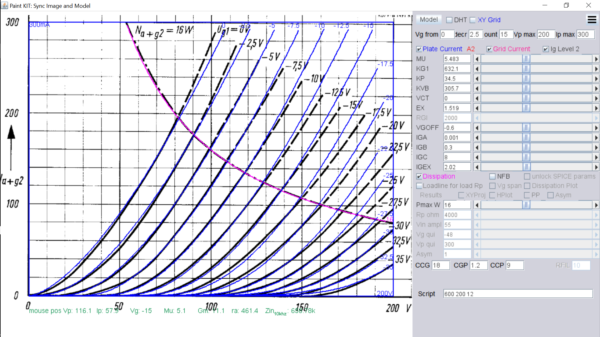

Here is 235L triode model:
Code:
**** 235L ** Advanced Grid Current **********************************
* Created on 11/02/2020 15:12 using paint_kit.jar 3.1
* [URL="http://www.dmitrynizh.com/tubeparams_image.htm"]Model Paint Tools: Trace Tube Parameters over Plate Curves, Interactively[/URL]
* Plate Curves image file: 235L.png
* Data source link:
.SUBCKT TRIODE_235L 1 2 3 ; Plate Grid Cathode
+ PARAMS: CCG=18P  CGP=1.2P CCP=9P
+ MU=5.483 KG1=632.1 KP=34.5 KVB=305.7 VCT=0 EX=1.519
+ VGOFF=-0.6 IGA=0.001 IGB=0.3 IGC=8 IGEX=2.02
* Vp_MAX=200 Ip_MAX=300 Vg_step=2.5 Vg_start=0 Vg_count=15
* Rp=4000 Vg_ac=55 P_max=16 Vg_qui=-48 Vp_qui=300
* X_MIN=62 Y_MIN=24 X_SIZE=777 Y_SIZE=585 FSZ_X=1296 FSZ_Y=736 XYGrid=false
E1 7 0 VALUE={V(1,3)/KP*LOG(1+EXP(KP*(1/MU+(VCT+V(2,3))/SQRT(KVB+V(1,3)*V(1,3)))))}
RE1 7 0 1G  ; TO AVOID FLOATING NODES
G1 1 3 VALUE={(PWR(V(7),EX)+PWRS(V(7),EX))/KG1}
RCP 1 3 1G   ; TO AVOID FLOATING NODES
C1 2 3 {CCG} ; CATHODE-GRID
C2 2 1 {CGP} ; GRID=PLATE
C3 1 3 {CCP} ; CATHODE-PLATE
RE2 2 0 1G
EGC 8 0 VALUE={V(2,3)-VGOFF} ; POSITIVE GRID THRESHOLD
GG 2 3 VALUE={(IGA+IGB/(IGC+V(1,3)))*(MU/KG1)*(PWR(V(8),IGEX)+PWRS(V(8),IGEX))}
.ENDS
This update improved convergence of 4654 model by readjusting the KNEE and aligned bottom line (-25V) closer to curve.
