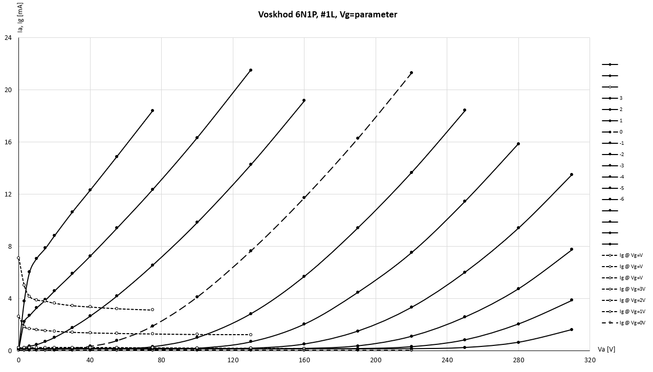

I have a 100 pcs. carton of 6N1P-EV.
Hi artosalo
My 5 6N1Ps have done their 100h burn-in, and I startet with the measurements. The first triode went well trough my measurement process, see picture.
But with the next, things went wrong - no idea what happened!
So I first have to find the root cause, and fix my iTracer.
I'll be busy the next days, so I cannot say when I can present a 6N1P model.
Sorry!
regards, Adrian

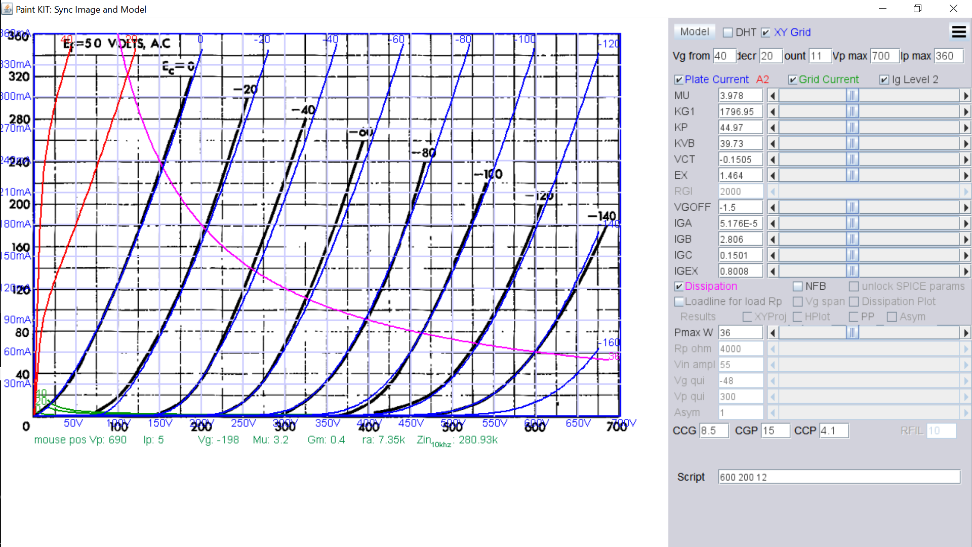

Here is 300B based on WE datasheet:
Code:
**** 300B_WE ** Advanced Grid Current **********************************
* Created on 11/16/2020 22:10 using paint_kit.jar 3.1
* [URL="http://www.dmitrynizh.com/tubeparams_image.htm"]www.dmitrynizh.com/tubeparams_image.htm[/URL]
* Plate Curves image file: 300b-we.png
* Data source link:
.SUBCKT 300B_WE 1 2 3 ; Plate Grid Cathode
+ PARAMS: CCG=8.5P CGP=15P CCP=4.1P
+ MU=3.978 KG1=1796.95 KP=44.97 KVB=39.73 VCT=-0.1505 EX=1.464
+ VGOFF=-1.5 IGA=5.176E-5 IGB=2.806 IGC=0.1501 IGEX=0.8008
* Vp_MAX=700 Ip_MAX=360 Vg_step=20 Vg_start=40 Vg_count=11
* Rp=4000 Vg_ac=55 P_max=36 Vg_qui=-48 Vp_qui=300
* X_MIN=45 Y_MIN=21 X_SIZE=772 Y_SIZE=503 FSZ_X=1296 FSZ_Y=736 XYGrid=true
* showLoadLine=n showIp=y isDHT=n isPP=n isAsymPP=n showDissipLimit=y
* showIg1=y gridLevel2=y isInputSnapped=n
* XYProjections=n harmonicPlot=n dissipPlot=n
E1 7 0 VALUE={V(1,3)/KP*LOG(1+EXP(KP*(1/MU+(VCT+V(2,3))/SQRT(KVB+V(1,3)*V(1,3)))))}
RE1 7 0 1G ; TO AVOID FLOATING NODES
G1 1 3 VALUE={(PWR(V(7),EX)+PWRS(V(7),EX))/KG1}
RCP 1 3 1G ; TO AVOID FLOATING NODES
C1 2 3 {CCG} ; CATHODE-GRID
C2 2 1 {CGP} ; GRID=PLATE
C3 1 3 {CCP} ; CATHODE-PLATE
RE2 2 0 1G
EGC 8 0 VALUE={V(2,3)-VGOFF} ; POSITIVE GRID THRESHOLD
GG 2 3 VALUE={(IGA+IGB/(IGC+V(1,3)))*(MU/KG1)*(PWR(V(8),IGEX)+PWRS(V(8),IGEX))}
.ENDS

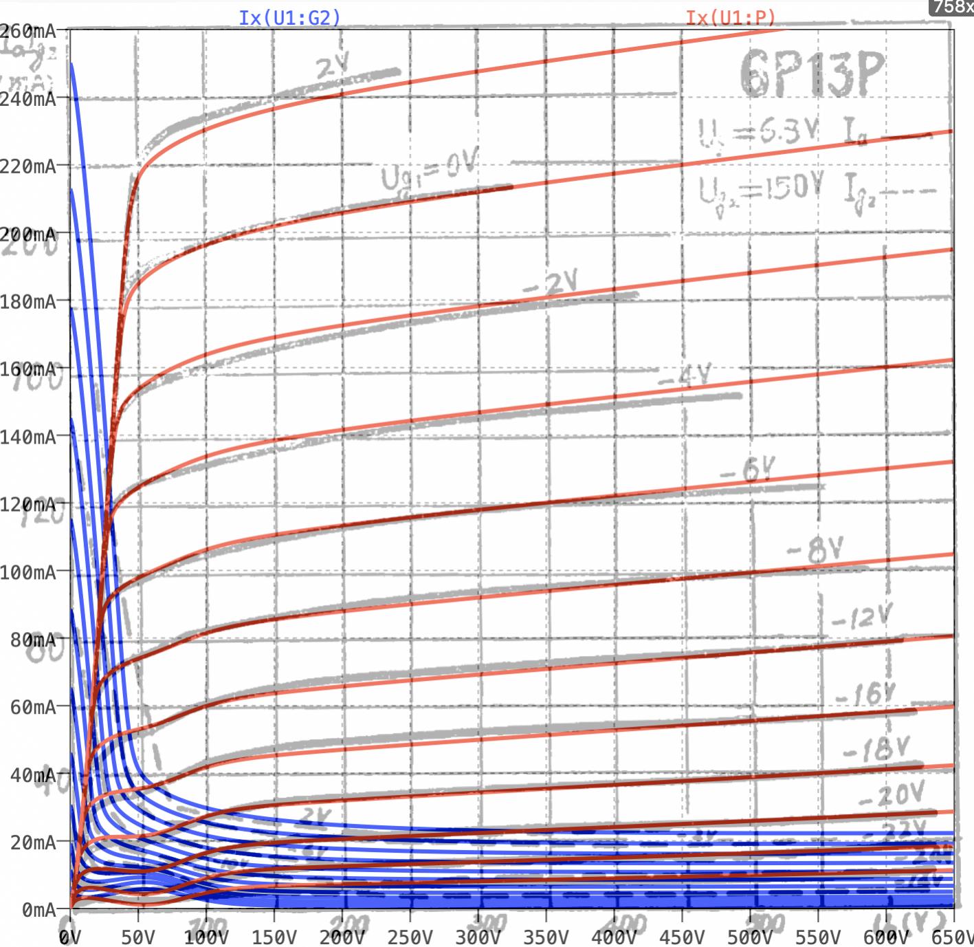

Dear all,
may I ask you a model fr this tube?
https://frank.pocnet.net/sheets/095/6/6P13P.pdf
Thank you in advance,
Kind Regards
Kind Regards
Hi zintolo
Freshly backed:
Enjoy!
cheers, Adrian
Freshly backed:
Code:
*6P13P LTspice model based on the generic tetrode/pentode model from Adrian Immler, version i4, Nov 2020
*Be aware that the iG1 model is just guessed due to lack of iG1 data!!
*A version log is at the end of this file
*Params fitted to chinese datasheet by Adrian Immler, Nov 2020
*This model is an enhancement of Adrians generic triode model to achieve tetrode/pentode behaviour.
*Hence, it is also suitable when the tetrode/pentode is "triode connected".
*Convenient for tetrodes, power beam tetrodes and g3-grounded pentodes.
*Copes secondary emission effect!
