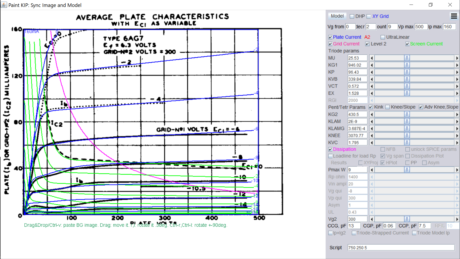

Here is 6AG7_RCA model, have briefly tried Transient in MicroCap it runs:\
Code:
**** 6AG7_RCA ******************************************
* Created on 12/17/2020 12:58 using paint_kip.jar
* [url=http://www.dmitrynizh.com/tubeparams_image.htm]Model Paint Tools: Trace Tube Parameters over Plate Curves, Interactively[/url]
* Plate Curves image file: 6ag7_rca.png

.SUBCKT 6AG7_RCA P G2 G K ; LTSpice tetrode.asy pinout
* .SUBCKT 6AG7_RCA P G K G2 ; Koren Pentode Pspice pinout
+ PARAMS: MU=25.53 KG1=946.02 KP=96.43 KVB=339.84 VCT=0.572 EX=1.528 KG2=430.5 KNEE=3070.77 KVC=1.795
+ KLAM=2E-9 KLAMG=3.687E-4  KD=0.1257 KC=1.232 KR1=3.965E-4 KR2=0.00104 KVBG=4.219E-4 KB1=1.29 KB2=3.44 KB3=2 KB4=1.63 KVBGI=0.0048 KNK=-1.109 KNG=0.1999 KNPL=5.197 KNSL=123.55 KNPR=54.17 KNSR=61.35
+ CCG=13P CGP=0.06P CCP=7.5P VGOFF=-0.9 IGA=1.4E-4 IGB=0.069 IGC=13.2 IGEX=1.32
* Vp_MAX=500 Ip_MAX=160 Vg_step=2 Vg_start=0 Vg_count=9
* X_MIN=72 Y_MIN=59 X_SIZE=698 Y_SIZE=551 FSZ_X=1389 FSZ_Y=789 XYGrid=false
* Rp=1400 Vg_ac=20 P_max=9 Vg_qui=-8 Vp_qui=300
* showLoadLine=n showIp=y isDHP=n isPP=n isAsymPP=n isUL=n showDissipLimit=y
* showIg1=y isInputSnapped=y addLocalNFB=n
* XYProjections=n harmonicPlot=y dissipPlot=n
* UL=0.43 EG2=300 gridLevel2=y addKink=y isTanhKnee=n advSigmoid=y
RE1  7 0  1G    ; DUMMY SO NODE 7 HAS 2 CONNECTIONS
E1   7 0  VALUE=  ; E1 BREAKS UP LONG EQUATION FOR G1.
+{V(G2,K)/KP*LOG(1+EXP((1/MU+(VCT+V(G,K))/SQRT(KVB+V(G2,K)*V(G2,K)))*KP))}
RE2  6 0  1G    ; DUMMY SO NODE 6 HAS 2 CONNECTIONS
E2  6 0  VALUE={(PWR(V(7),EX)+PWRS(V(7),EX))} ; Kg1 times KIT current
E4   8 0  VALUE={V(P,K)/KNEE/(KVBGI+V(6)*KVBG)}
E5  81 0  VALUE={PWR(V(8),KB1)}
E6  82 0  VALUE={PWR(V(8),KB2)}
E7  83 0  VALUE={PWR(V(8),KB3)}
E8   9 0  VALUE={PWR(1-EXP(-V(81)*(KC+KR1*V(82))/(KD+KR2*V(83))),KB4)*1.5708}
RE4  8 0  1
RE5 81 0  1
RE6 82 0  1
RE7 83 0  1
RE8  9 0  1
RE21 21 0 1
E21  21 0 VALUE={V(6)/KG1*V(9)} ; Ip with knee but no slope and no kink
RE22 22 0 1 ; E22: kink curr deviation for plate
E22  22 0 VALUE={V(21)*LIMIT(KNK-V(G,K)*KNG,0,0.3)*(-ATAN((V(P,K)-KNPL)/KNSL)+ATAN((V(P,K)-KNPR)/KNSR))}
G1   P K  VALUE={V(21)*(1+KLAMG*V(P,K))+KLAM*V(P,K) + V(22)}
G2   G2 K  VALUE={V(6)/KG2*(KVC-V(9))/(1+KLAMG*V(P,K)) - V(22)}
RCP  P K  1G     ; FOR CONVERGENCE
C1   K G  {CCG}  ; CATHODE-GRID 1
C2   G P  {CGP}  ; GRID 1-PLATE
C3   K P  {CCP}  ; CATHODE-PLATE
RE23 G 0 1G
GG G K VALUE={(IGA+IGB/(IGC+V(P,K)))*(MU/KG1)*
+(PWR(V(G,K)-VGOFF,IGEX)+PWRS(V(G,K)-VGOFF,IGEX))}
.ENDS

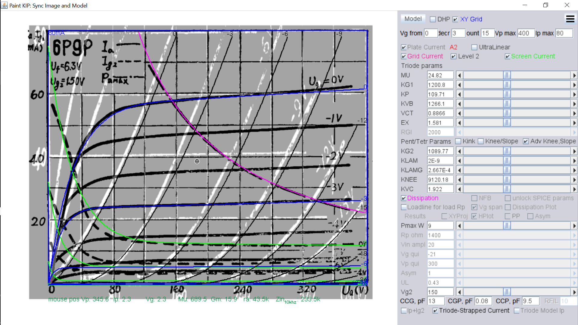

Here is update for Chinese 6P9P model, tested running on MicrCap:
Code:
**** 6P9P_CH ******************************************
* Created on 12/17/2020 17:06 using paint_kip.jar
* Plate Curves image file: 6p9p_ch.png
* Data source link: <plate curves URL>
.SUBCKT 6P9P_CH P G2 G K ; LTSpice tetrode.asy pinout
* .SUBCKT 6P9P_CH P G K G2 ; Koren Pentode Pspice pinout
+ PARAMS: MU=24.82 KG1=1200.8 KP=109.71 KVB=1266.1 VCT=0.8866 EX=1.581 KG2=1089.77 KNEE=9120.18 KVC=1.922
+ KLAM=2E-9 KLAMG=2.667E-4  KD=2.961E-7 KC=0.1907 KR1=5.928E-4 KR2=0.00104 KVBG=0.002261 KB1=4.134 KB2=4.134 KB3=2.2 KB4=0.2218 KVBGI=0.00995 KNK=-1.734 KNG=0.2821
+ CCG=13P CGP=0.08P CCP=9.5P VGOFF=-0.9 IGA=1.4E-4 IGB=0.069 IGC=13.2 IGEX=1.32

G1   P K  VALUE={V(6)/KG1*V(9)*(1+KLAMG*V(P,K))+KLAM*V(P,K)}
G2   G2 K  VALUE={V(6)/KG2*(KVC-V(9))/(1+KLAMG*V(P,K))}
RE23 G 0 1G
.ENDS

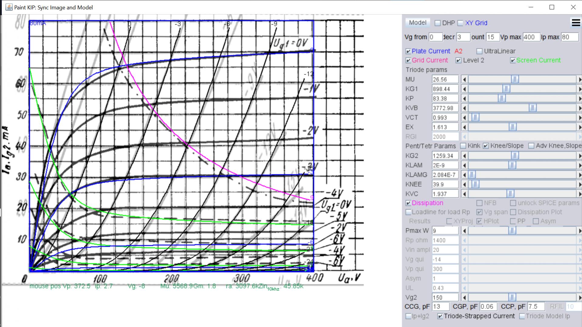

This is update for Russian 6Π9 model:
Code:
**** 6P9 ******************************************
* Created on 12/17/2020 18:43 using paint_kip.jar
* Plate Curves image file: 6p9.png
.SUBCKT 6P9 P G2 G K ; LTSpice tetrode.asy pinout
* .SUBCKT 6P9 P G K G2 ; Koren Pentode Pspice pinout
+ PARAMS: MU=26.56 KG1=898.44 KP=83.38 KVB=3772.98 VCT=0.993 EX=1.613 KG2=1259.34 KNEE=39.9 KVC=1.937
+ KLAM=2E-9 KLAMG=2.084E-7 KNEE2=40.07 KNEX=105.6  KNK=-0.5161 KNG=0.2257

* UL=0.43 EG2=150 gridLevel2=y addKink=n isTanhKnee=y advSigmoid=n

Here is update for 6AG7_GE, briefly tested ok in MicroCap.
Code:
*** 6AG7_GE ******************************************
* Created on 12/17/2020 15:47 using paint_kip.jar
* Plate Curves image file: 6ag7-GE.png
.SUBCKT 6AG7_GE P G2 G K ; LTSpice tetrode.asy pinout

Unfortunately it still gives me errors (Part and node have the same name X1 G2)
Disabled Account
Joined 2013
Yes, that is a only warning, it will continue to sim. Some are real errors like "Matrix is singular", I can't solve it, and it also appears in LTspice. These models using "Advance Knee" options is a little too much for Spice program to handle as explained in the errors messages of MicroCap.
