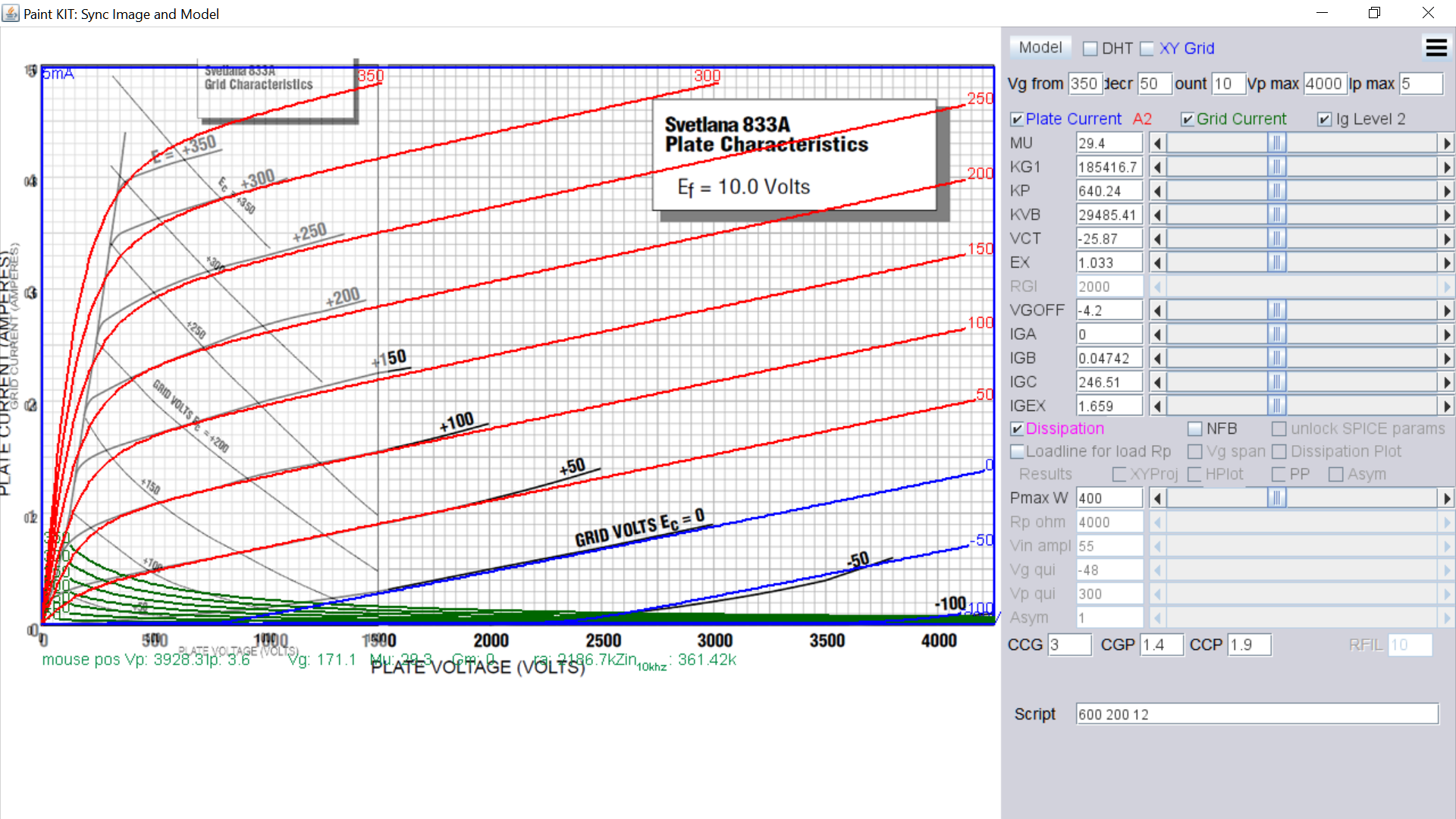

Vacuum Tube SPICE Models
Here is 833 model:
Code:
*** 833A_SOV ** Advanced Grid Current **********************************
* Created on 07/15/2020 19:44 using paint_kit.jar 3.1
* [URL="http://www.dmitrynizh.com/tubeparams_image.htm"]www.dmitrynizh.com/tubeparams_image.htm[/URL]
* Plate Curves image file: 833a-sov.png
* Data source link:
.SUBCKT 833A_SOV 1 2 3 ; Plate Grid Cathode
+ PARAMS: CCG=3P  CGP=1.4P CCP=1.9P
+ MU=35 KG1=92708.35 KP=757.68 KVB=53609.84 VCT=-23.31 EX=0.914
+ VGOFF=-4.2 IGA=0 IGB=0.089 IGC=876.62 IGEX=1.659
* Vp_MAX=4000 Ip_MAX=5 Vg_step=50 Vg_start=350 Vg_count=10
* Rp=4000 Vg_ac=55 P_max=400 Vg_qui=-48 Vp_qui=300
* X_MIN=37 Y_MIN=36 X_SIZE=837 Y_SIZE=489 FSZ_X=1296 FSZ_Y=736 XYGrid=false
* showLoadLine=n showIp=y isDHT=n isPP=n isAsymPP=n showDissipLimit=y
* showIg1=y gridLevel2=y isInputSnapped=n
* XYProjections=n harmonicPlot=n dissipPlot=n
E1 7 0 VALUE={V(1,3)/KP*LOG(1+EXP(KP*(1/MU+(VCT+V(2,3))/SQRT(KVB+V(1,3)*V(1,3)))))}
RE1 7 0 1G  ; TO AVOID FLOATING NODES
G1 1 3 VALUE={(PWR(V(7),EX)+PWRS(V(7),EX))/KG1}
RCP 1 3 1G   ; TO AVOID FLOATING NODES
C1 2 3 {CCG} ; CATHODE-GRID
C2 2 1 {CGP} ; GRID=PLATE
C3 1 3 {CCP} ; CATHODE-PLATE
RE2 2 0 1G
EGC 8 0 VALUE={V(2,3)-VGOFF} ; POSITIVE GRID THRESHOLD
GG 2 3 VALUE={(IGA+IGB/(IGC+V(1,3)))*(MU/KG1)*(PWR(V(8),IGEX)+PWRS(V(8),IGEX))}
.ENDS

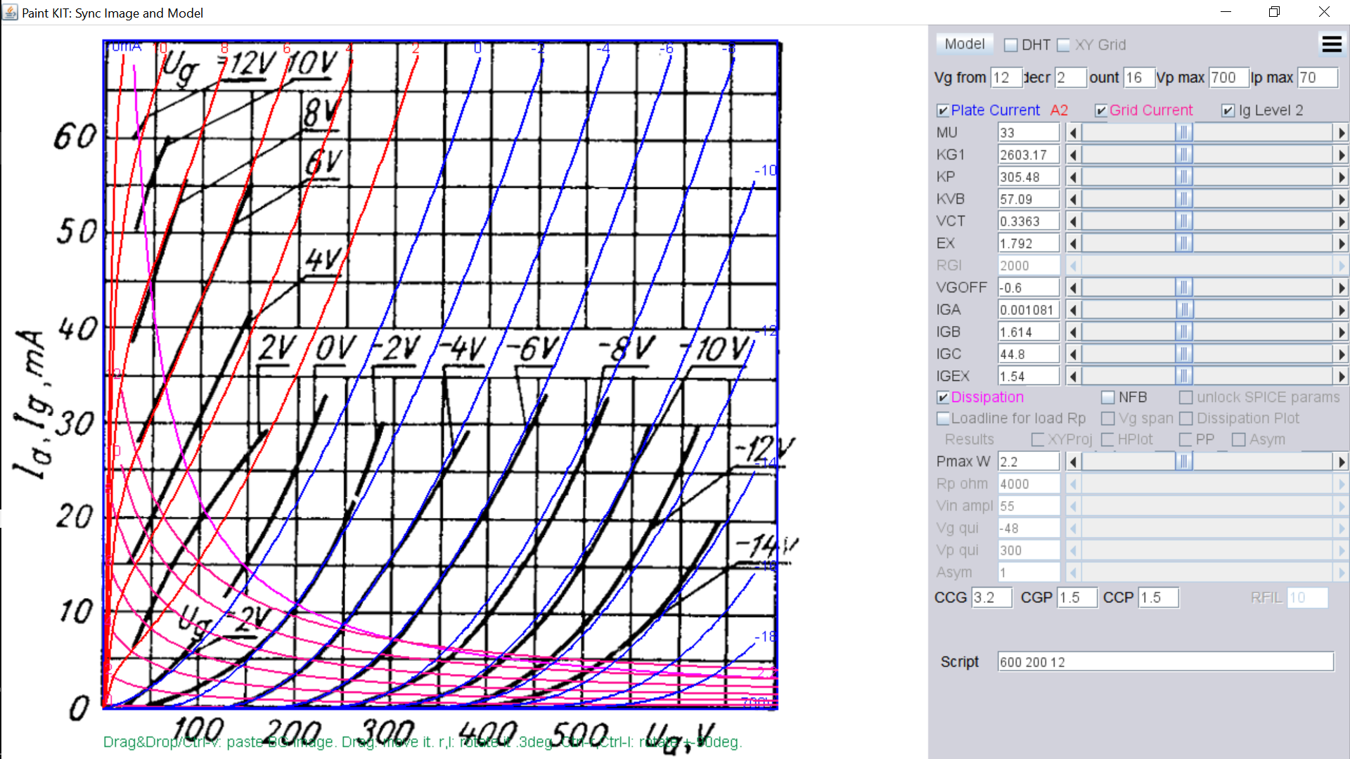

6n1p-ev model:
Code:
**** 6N1P_EV ** Advanced Grid Current **********************************
* Created on 11/12/2020 20:19 using paint_kit.jar 3.1
* [url=http://www.dmitrynizh.com/tubeparams_image.htm]Model Paint Tools: Trace Tube Parameters over Plate Curves, Interactively[/url]
* Plate Curves image file: 6n1p_ev.png
* Data source link:
.SUBCKT 6N1P_EV 1 2 3 ; Plate Grid Cathode
+ PARAMS: CCG=3.2P  CGP=1.5P CCP=1.5P
+ MU=33 KG1=2603.17 KP=305.48 KVB=57.09 VCT=0.3363 EX=1.792
+ VGOFF=-0.6 IGA=0.00107 IGB=1.614 IGC=44.8 IGEX=1.54
* Vp_MAX=700 Ip_MAX=70 Vg_step=2 Vg_start=12 Vg_count=16
* Rp=4000 Vg_ac=55 P_max=2.2 Vg_qui=-48 Vp_qui=300
* X_MIN=98 Y_MIN=15 X_SIZE=639 Y_SIZE=634 FSZ_X=1296 FSZ_Y=736 XYGrid=false
RE2 2 0 1G
.ENDS
Does anybody have modern (advanced) tube model for 6N1P-EV?
The model I have is some old by Koren.

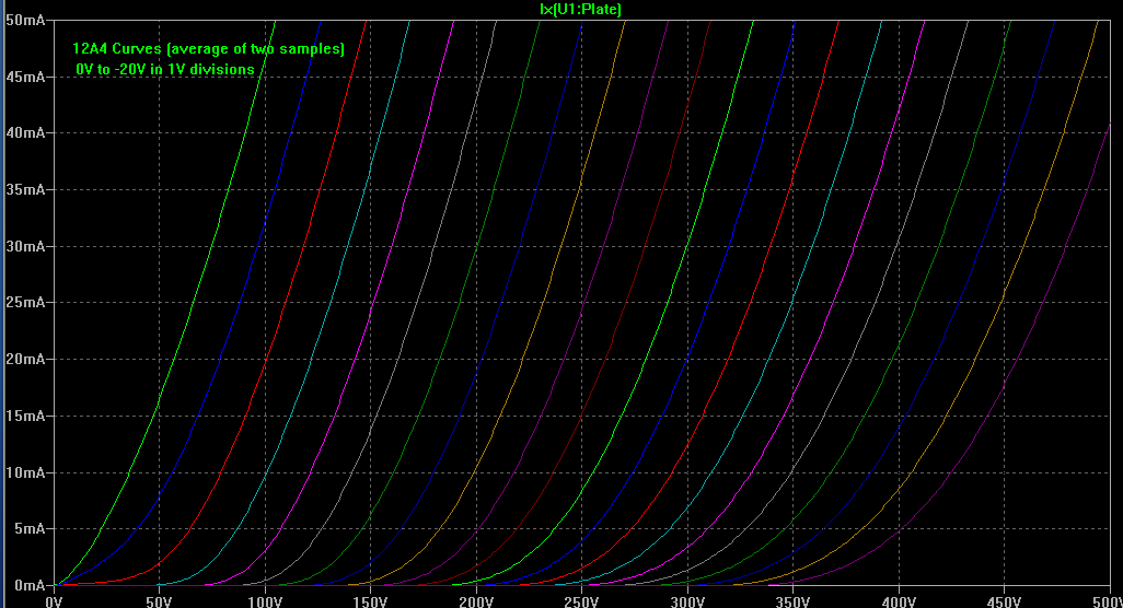

Hi everybody,
I found a set of curves for 12A4 triode. It looks pretty interesting. (Attached)
I'm wondering if anyone with a curve tracer might be kind enough to whip up an updated model based on these curves. If not, it's OK. Just a request. 🙂
  • 12A4.pdf
    12A4.pdf

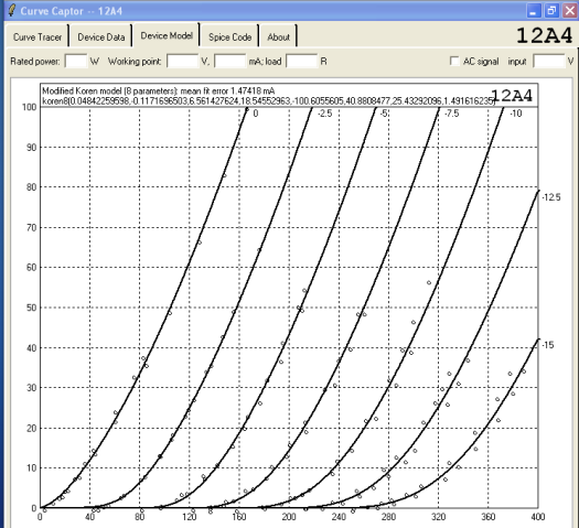

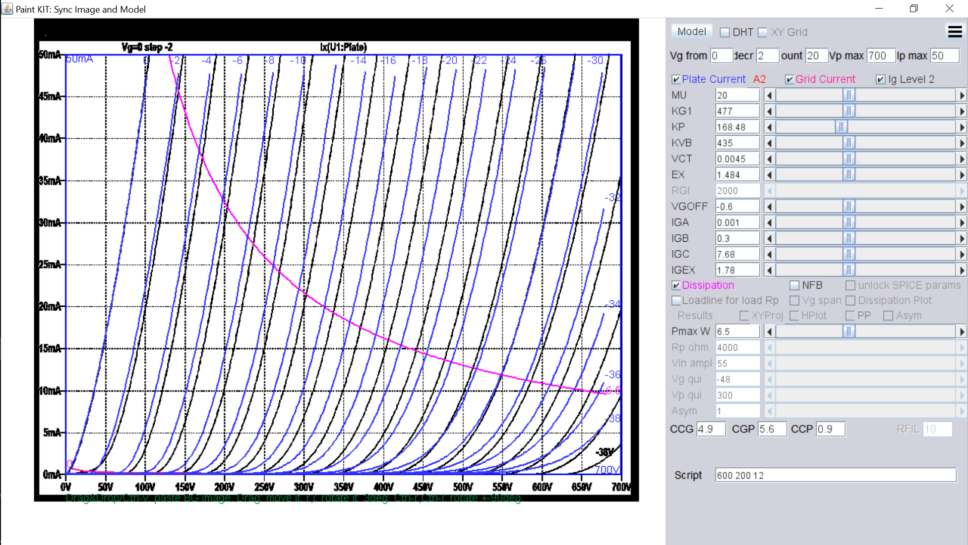

Hi everybody,
The trace model is up to 400V and missed the other data point in original curve: 500V Vg1=-33 Ig1=0.05mA. I make this appeared in this model:
Code:
**** 12A4 ** Advanced Grid Current **********************************
* Created on 11/15/2020 11:27 using paint_kit.jar 3.1
* Plate Curves image file: 12a4.gif
* Data source link:
.SUBCKT TRIODE_12A4 1 2 3 ; Plate Grid Cathode
+ PARAMS: CCG=4.9P  CGP=5.6P CCP=0.9P
+ MU=20 KG1=477 KP=168.48 KVB=435 VCT=0.0045 EX=1.484
+ VGOFF=-0.6 IGA=0.001 IGB=0.3 IGC=7.68 IGEX=1.78
* Vp_MAX=700 Ip_MAX=50 Vg_step=2 Vg_start=0 Vg_count=20
* Rp=4000 Vg_ac=55 P_max=6.5 Vg_qui=-48 Vp_qui=300
* X_MIN=87 Y_MIN=49 X_SIZE=734 Y_SIZE=554 FSZ_X=1296 FSZ_Y=736 XYGrid=false
RE2 2 0 1G
.ENDS

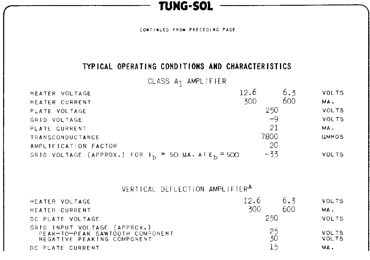

As accurate as data sheet which includes 2 operating points to refer to. The trace model is just one sample, unless you do a lot to be accurate enough and you have to own one of the tube being traced to be useful.

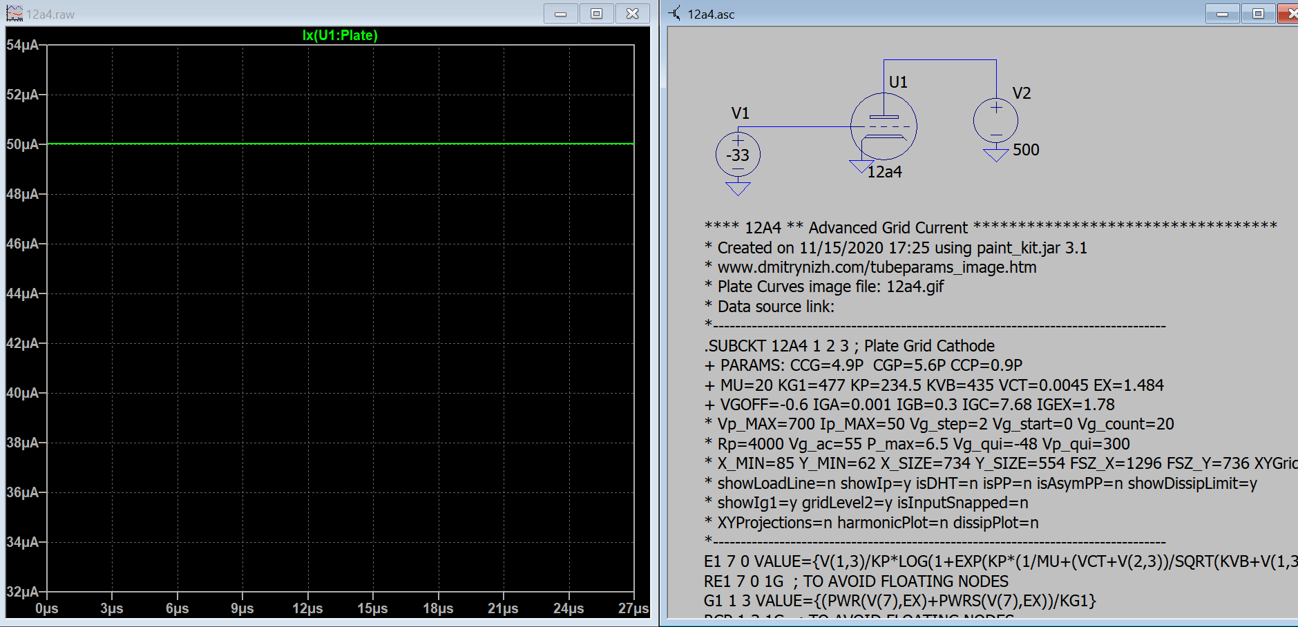

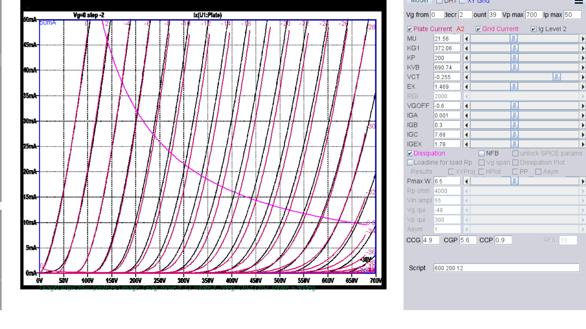

I have made a minor adjustment for 12A4 model so that @500V Vg-33v, Ig is 50uA(0.05mA) as specified in datasheet.
Code:
* Created on 11/15/2020 17:25 using paint_kit.jar 3.1
* Data source link:
.SUBCKT 12A4 1 2 3 ; Plate Grid Cathode
+ MU=20 KG1=477 KP=234.5 KVB=435 VCT=0.0045 EX=1.484
* X_MIN=85 Y_MIN=62 X_SIZE=734 Y_SIZE=554 FSZ_X=1296 FSZ_Y=736 XYGrid=false
RE2 2 0 1G
.ENDS
This model fit closely 2 operating points specified:
Code:
* Data source link:
+ MU=21.56 KG1=372.06 KP=203.5 KVB=690.74 VCT=-0.255 EX=1.469
* Vp_MAX=700 Ip_MAX=50 Vg_step=4.5 Vg_start=0 Vg_count=39
RE2 2 0 1G
.ENDS
Ah, I see that the two curves I found are too different to make one set of curves that adequately represents both. Since there are no published curves in the data sheets, there's some guesswork involved. We have no idea which of the two sets of found curves represents a 'bogey' 12A4, so there's no way to make a single truly representative model. So... Thank you Koonw for your efforts. What you've given us is certain to be useful.
