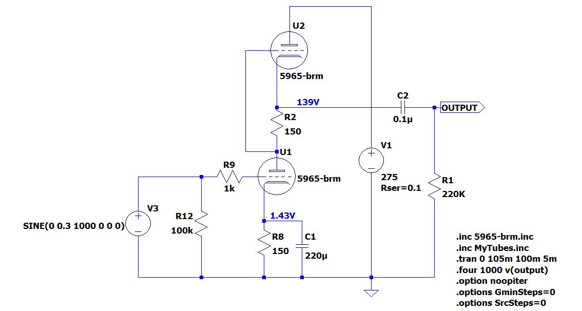

5965 model on #1449 has errors
I tried to use 5965 model posted on #1449. Can someone take a look and see what's wrong with the model? LTspice said the nodes 5 and 6 have no connection. I tried a few guesses to correct the error and each time got additional error messages.
There is no problem with model. Have a look in Spice err log, see what is the problem. Try one or all the following options, see it runs successfully.

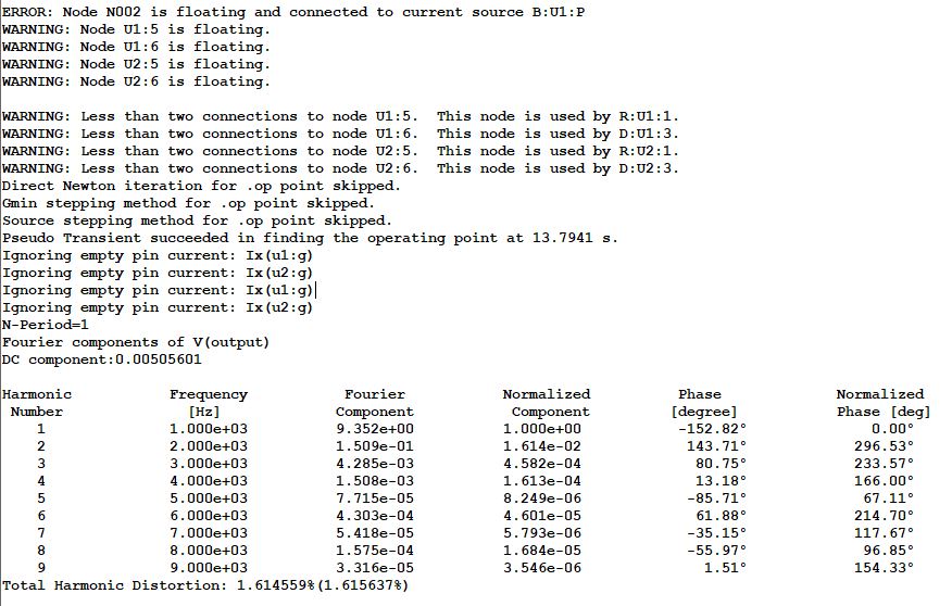

I have set up a SRPP circuit to check the distortion level. The schematic is attached. Below is the error and warning messages from LTspice with the 5965-brm model:
ERROR: Node N002 is floating and connected to current source B:U1😛
WARNING: Node U1:5 is floating.
WARNING: Node U1:6 is floating.
WARNING: Node U2:5 is floating.
WARNING: Node U2:6 is floating.
WARNING: Less than two connections to node U1:5. This node is used by R:U1:1.
WARNING: Less than two connections to node U1:6. This node is used by D:U1:3.
WARNING: Less than two connections to node U2:5. This node is used by R:U2:1.
WARNING: Less than two connections to node U2:6. This node is used by D:U2:3.
I can add a line to eliminate the floating error. But I am not sure that is the right way to do it. I am also not very comfortable with warning messages.

I used PIN name instead of PIN number seem to have solve the problem, thank you for bringing up the matter.

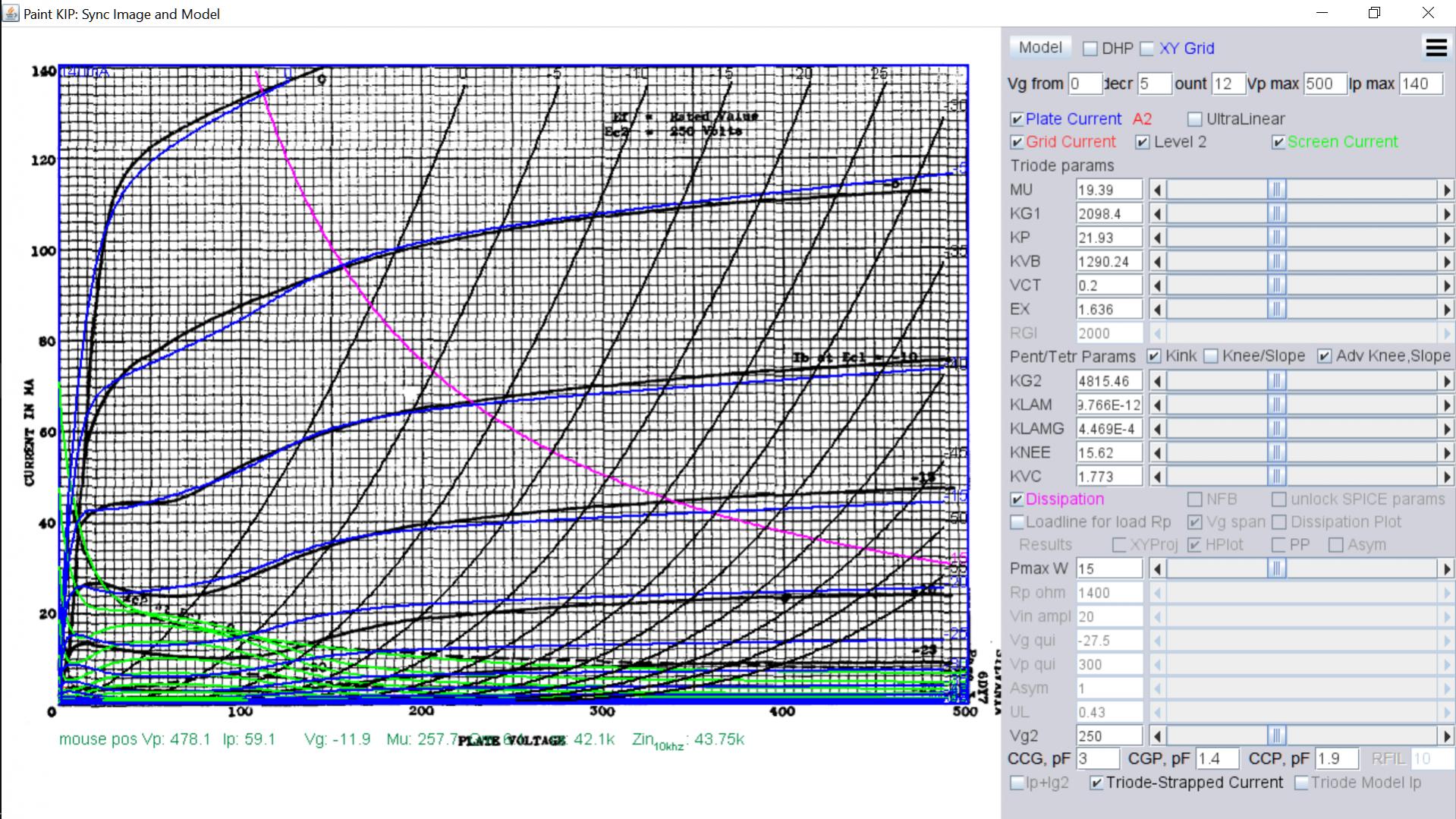

Another super long shot ... I managed to get ahold of some 6DY7 tubes. I might be the only person in the world interested in a model, but is there any chance there's one out there?
6DY7 model:

.SUBCKT 6DY7 P G2 G K ; LTSpice tetrode.asy pinout
* .SUBCKT 6DY7 P G K G2 ; Koren Pentode Pspice pinout
+ PARAMS: MU=19.39 KG1=2098.4 KP=21.93 KVB=1290.24 VCT=0.2 EX=1.636 KG2=4815.46 KNEE=15.62 KVC=1.773

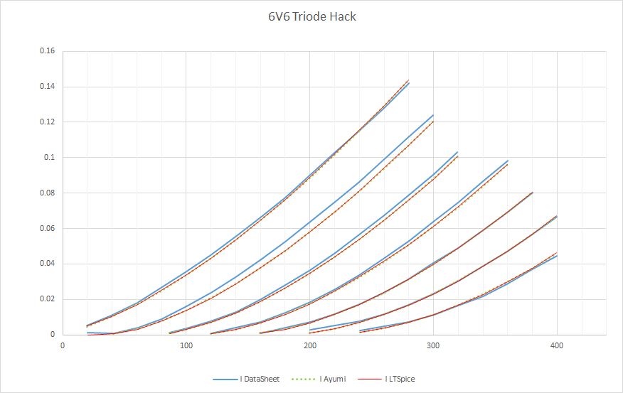

I spent some time massaging the Ayumi triode model, some of the nested parentheses are 7 deep. What spits out is an excel spreadsheet with 11 variables and several conditionals. I don't know the optimization program Ayumi was using, nor the data sheet from which he he derived the curves (I used the RCA data sheet from pocnet) but since most of the data sets were artfully drawn with a "french curve" it looks pretty good given the variability of tubes and data derived 60 years ago:
Hi jackinnj
It seems that we had the same idea at the same time - I'm working also on such an excel sheet for my triode model! 😉
It was quite tricky because the equations for Ia and Ig depends on each other (no problem for LTspice, but a challenge for excel)
How ever, it looks quite promissing now.
I hope to finish the beta Version in some days...
all the best, Adrian
If you use the full precision (8 significant digits in the constants) the Excel model and the LTSpice simulation match up very closely. The model author may have used a different data sheet or optimization program as we see a bit of variance from the GE datasheet (it's GE, not RCA).
At least when Excel and LTSpice line up there's more confidence you're going in the correct direction.
The PNG I posted before rounded the constants to 4 significant places.
