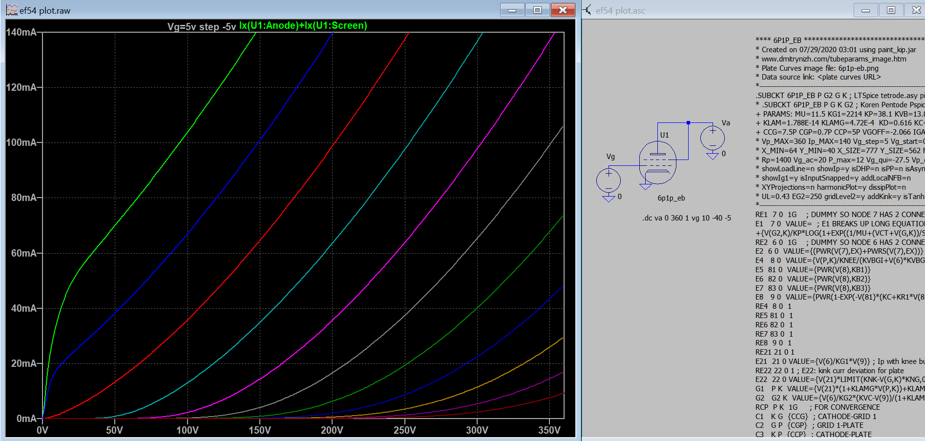

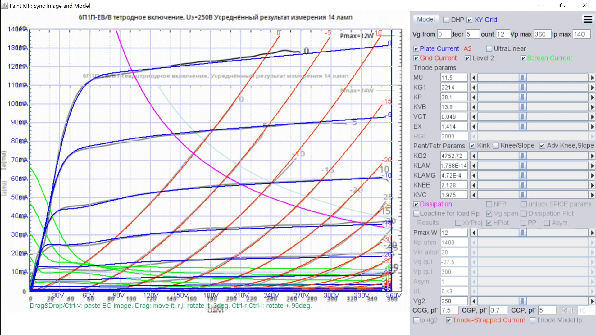

Found nice curves here:Hello !
I'm looking for russian pentode 6P1P, connected in triode mode
Thanks for any help
Снятие Вах Пентодов И Тетродов - Ламповая техника - Форум по радиоэлектронике
Code:
**** 6P1P_EB ******************************************
* Created on 07/29/2020 03:01 using paint_kip.jar
* [URL="http://www.dmitrynizh.com/tubeparams_image.htm"]Model Paint Tools: Trace Tube Parameters over Plate Curves, Interactively[/URL]
* Plate Curves image file: 6p1p-eb.png
* Data source link: <plate curves URL>
.SUBCKT 6P1P_EB P G2 G K ; LTSpice tetrode.asy pinout
* .SUBCKT 6P1P_EB P G K G2 ; Koren Pentode Pspice pinout
+ PARAMS: MU=11.5 KG1=2214 KP=38.1 KVB=13.8 VCT=0.049 EX=1.414 KG2=4752.72 KNEE=7.128 KVC=1.975
+ KLAM=1.788E-14 KLAMG=4.72E-4 KD=0.616 KC=0.182 KR1=0.001144 KR2=0.05632 KVBG=0.015 KB1=2.02 KB2=1.22 KB3=0.58 KB4=0.755 KVBGI=4.15E-4 KNK=-0.07024 KNG=0.03175 KNPL=20.37 KNSL=54.53 KNPR=59.13 KNSR=51.88
+ CCG=7.5P CGP=0.7P CCP=5P VGOFF=-2.066 IGA=0.00105 IGB=0.276 IGC=6.64 IGEX=1.7
* Vp_MAX=360 Ip_MAX=140 Vg_step=5 Vg_start=0 Vg_count=12
* X_MIN=64 Y_MIN=40 X_SIZE=777 Y_SIZE=562 FSZ_X=1296 FSZ_Y=736 XYGrid=true
* Rp=1400 Vg_ac=20 P_max=12 Vg_qui=-27.5 Vp_qui=300
* showLoadLine=n showIp=y isDHP=n isPP=n isAsymPP=n isUL=n showDissipLimit=y
* showIg1=y isInputSnapped=y addLocalNFB=n
* XYProjections=n harmonicPlot=y dissipPlot=n
* UL=0.43 EG2=250 gridLevel2=y addKink=y isTanhKnee=n advSigmoid=y
RE1 7 0 1G ; DUMMY SO NODE 7 HAS 2 CONNECTIONS
E1 7 0 VALUE= ; E1 BREAKS UP LONG EQUATION FOR G1.
+{V(G2,K)/KP*LOG(1+EXP((1/MU+(VCT+V(G,K))/SQRT(KVB+V(G2,K)*V(G2,K)))*KP))}
RE2 6 0 1G ; DUMMY SO NODE 6 HAS 2 CONNECTIONS
E2 6 0 VALUE={(PWR(V(7),EX)+PWRS(V(7),EX))} ; Kg1 times KIT current
E4 8 0 VALUE={V(P,K)/KNEE/(KVBGI+V(6)*KVBG)}
E5 81 0 VALUE={PWR(V(8),KB1)}
E6 82 0 VALUE={PWR(V(8),KB2)}
E7 83 0 VALUE={PWR(V(8),KB3)}
E8 9 0 VALUE={PWR(1-EXP(-V(81)*(KC+KR1*V(82))/(KD+KR2*V(83))),KB4)*1.5708}
RE4 8 0 1
RE5 81 0 1
RE6 82 0 1
RE7 83 0 1
RE8 9 0 1
RE21 21 0 1
E21 21 0 VALUE={V(6)/KG1*V(9)} ; Ip with knee but no slope and no kink
RE22 22 0 1 ; E22: kink curr deviation for plate
E22 22 0 VALUE={V(21)*LIMIT(KNK-V(G,K)*KNG,0,0.3)*(-ATAN((V(P,K)-KNPL)/KNSL)+ATAN((V(P,K)-KNPR)/KNSR))}
G1 P K VALUE={V(21)*(1+KLAMG*V(P,K))+KLAM*V(P,K) + V(22)}
G2 G2 K VALUE={V(6)/KG2*(KVC-V(9))/(1+KLAMG*V(P,K)) - V(22)}
RCP P K 1G ; FOR CONVERGENCE
C1 K G {CCG} ; CATHODE-GRID 1
C2 G P {CGP} ; GRID 1-PLATE
C3 K P {CCP} ; CATHODE-PLATE
RE23 G 0 1G
GG G K VALUE={(IGA+IGB/(IGC+V(P,K)))*(MU/KG1)*
+(PWR(V(G,K)-VGOFF,IGEX)+PWRS(V(G,K)-VGOFF,IGEX))}
.ENDS

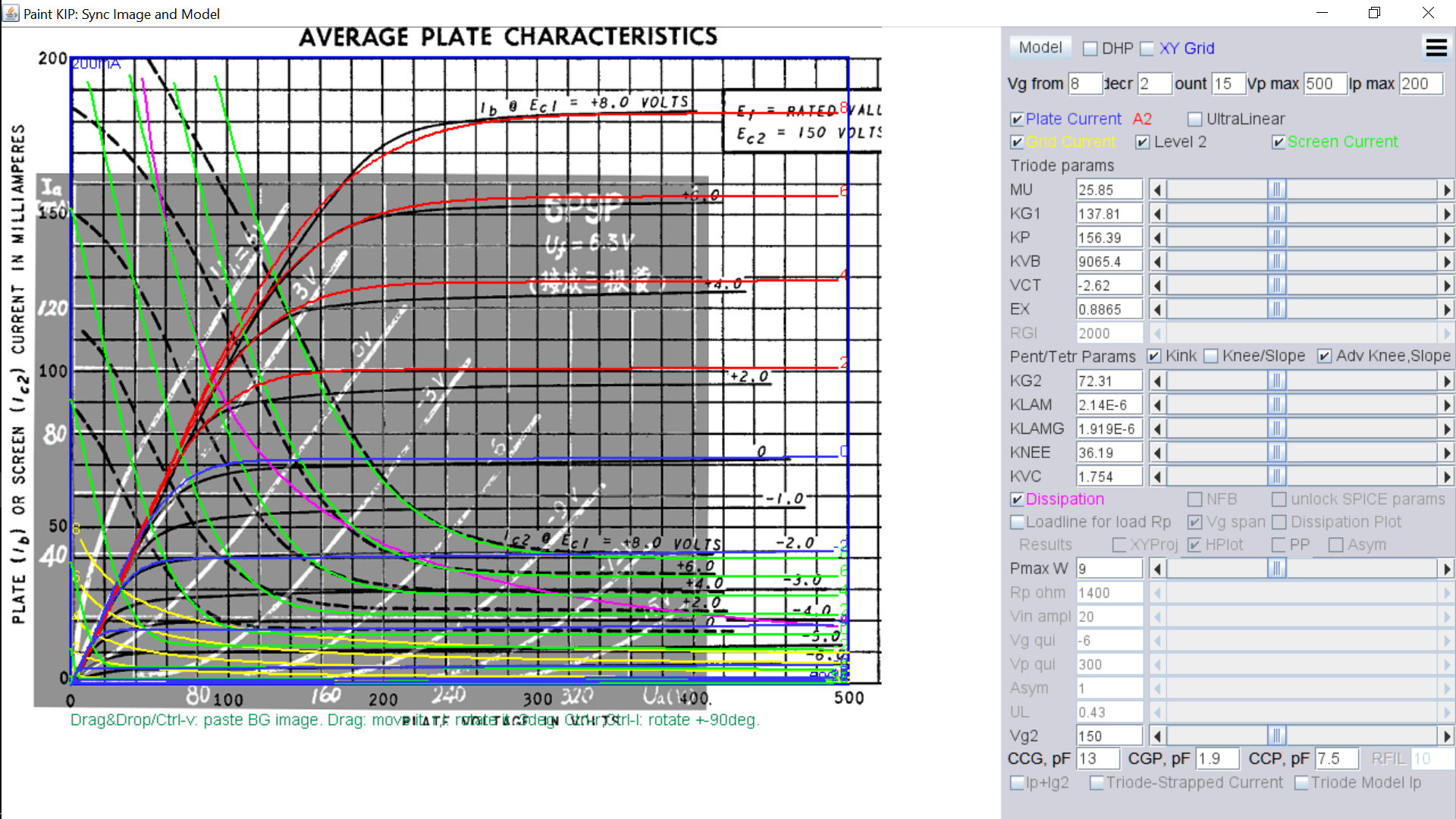

Here is 6ag7 and 6p9p model:
Code:
**** 6AG7_GE ******************************************
* Created on 08/02/2020 07:10 using paint_kip.jar
* [URL="http://www.dmitrynizh.com/tubeparams_image.htm"]www.dmitrynizh.com/tubeparams_image.htm[/URL]
* Plate Curves image file: 6ag7-ge.png
.SUBCKT 6AG7_GE P G2 G K ; LTSpice tetrode.asy pinout
* .SUBCKT 6AG7_GE P G K G2 ; Koren Pentode Pspice pinout
+ PARAMS: MU=25.85 KG1=137.81 KP=156.39 KVB=9065.4 VCT=-2.62 EX=0.8865 KG2=72.31 KNEE=36.19 KVC=1.754
+ KLAM=2.14E-6 KLAMG=1.919E-6 KD=1.849 KC=0.07463 KR1=0.01411 KR2=0.3479 KVBG=0.05471 KB1=2.261 KB2=0.01445 KB3=0.5701 KB4=0.5486 KVBGI=4.929E-4 KNK=-0.06196 KNG=0.2364 KNPL=7.185E-12 KNSL=340.37 KNPR=76.33 KNSR=360.51
+ CCG=13P CGP=1.9P CCP=7.5P VGOFF=-1.5 IGA=4.9E-4 IGB=0.1048 IGC=31.96 IGEX=1.619
* Vp_MAX=500 Ip_MAX=200 Vg_step=2 Vg_start=8 Vg_count=15
* X_MIN=62 Y_MIN=27 X_SIZE=684 Y_SIZE=551 FSZ_X=1296 FSZ_Y=736 XYGrid=false
* Rp=1400 Vg_ac=20 P_max=9 Vg_qui=-6 Vp_qui=300
* UL=0.43 EG2=150 gridLevel2=y addKink=y isTanhKnee=n advSigmoid=y
RE4 8 0 1
RE5 81 0 1
RE6 82 0 1
RE7 83 0 1
RE8 9 0 1
RE21 21 0 1
RE23 G 0 1G
.ENDS

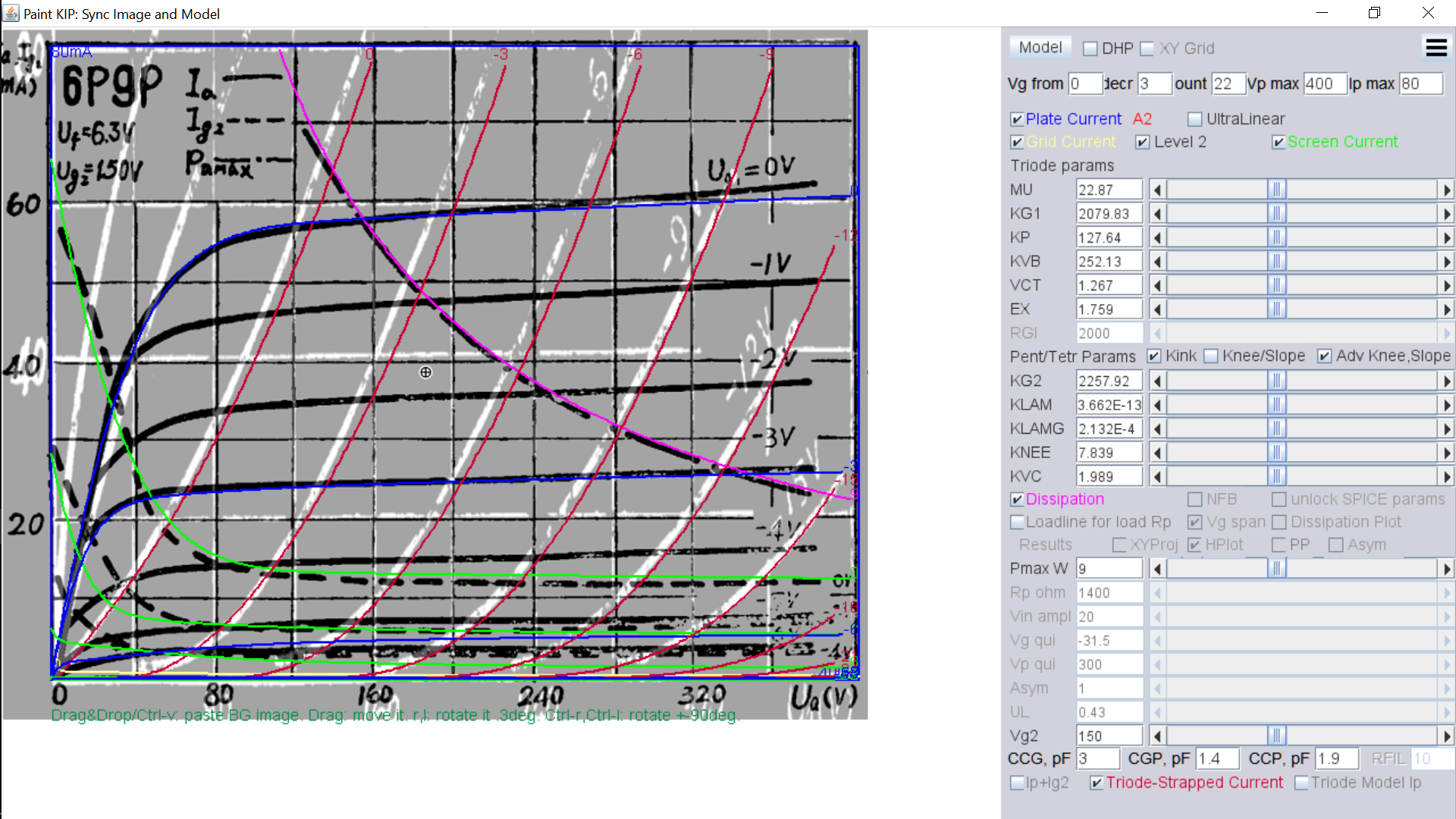

Code:
* Plate Curves image file: 6p9p-ch.png
.SUBCKT 6P9P_CH P G2 G K ; LTSpice tetrode.asy pinout
* .SUBCKT 6P9P_CH P G K G2 ; Koren Pentode Pspice pinout
+ PARAMS: MU=22.87 KG1=2079.83 KP=127.64 KVB=252.13 VCT=1.267 EX=1.759 KG2=2235.34 KNEE=7.682 KVC=1.969
+ KLAM=3.662E-13 KLAMG=2.132E-4 KD=27.95 KC=1.943 KR1=3.405E-6 KR2=0.05914 KVBG=0.01222 KB1=1.515 KB2=1.378 KB3=2.8E-5 KB4=0.6572 KVBGI=2.495E-4 KNK=-0.3213 KNG=0.1234 KNPL=0.07219 KNSL=0.02209 KNPR=34.8 KNSR=59.98
+ CCG=3P CGP=1.4P CCP=1.9P VGOFF=-1.5 IGA=0.005846 IGB=2.016 IGC=108.16 IGEX=1.66
* Vp_MAX=400 Ip_MAX=80 Vg_step=3 Vg_start=0 Vg_count=22
* X_MIN=45 Y_MIN=17 X_SIZE=710 Y_SIZE=557 FSZ_X=1296 FSZ_Y=736 XYGrid=false
* Rp=1400 Vg_ac=20 P_max=9 Vg_qui=-31.5 Vp_qui=300
RE4 8 0 1
RE5 81 0 1
RE6 82 0 1
RE7 83 0 1
RE8 9 0 1
RE21 21 0 1
RE23 G 0 1G
.ENDS

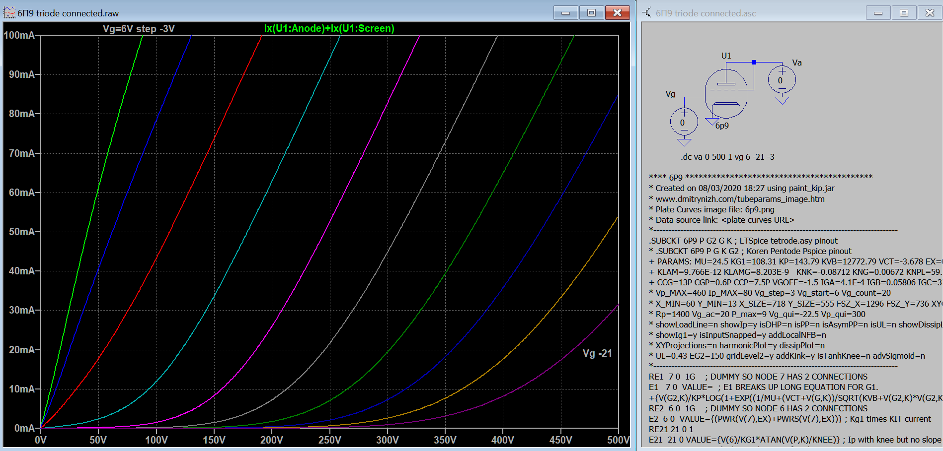

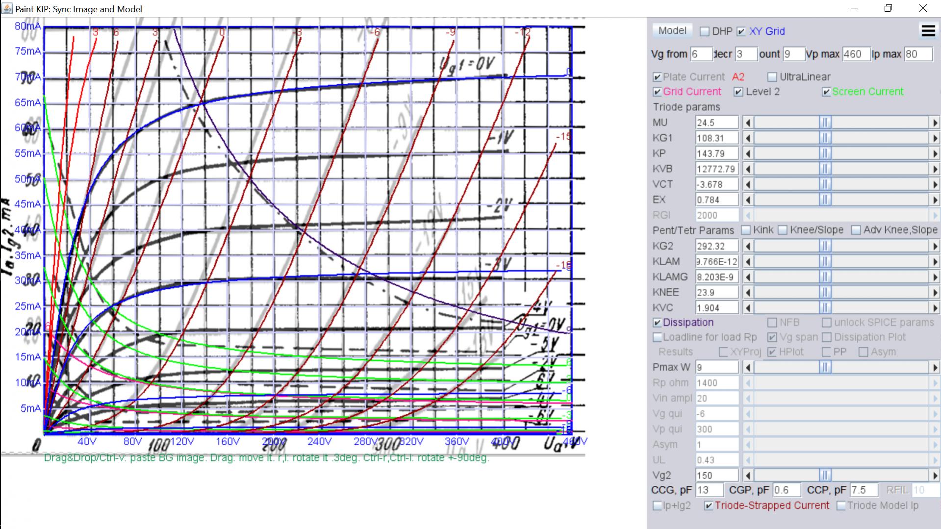

This is Russian 6Π9 model:
Code:
* [url=http://www.dmitrynizh.com/tubeparams_image.htm]Model Paint Tools: Trace Tube Parameters over Plate Curves, Interactively[/url]
* Plate Curves image file: 6p9.png
.SUBCKT 6P9 P G2 G K ; LTSpice tetrode.asy pinout
* .SUBCKT 6P9 P G K G2 ; Koren Pentode Pspice pinout
+ PARAMS: MU=24.5 KG1=108.31 KP=143.79 KVB=12772.79 VCT=-3.678 EX=0.784 KG2=292.32 KNEE=23.9 KVC=1.904
+ KLAM=9.766E-12 KLAMG=8.203E-9 KNK=-0.08712 KNG=0.00672 KNPL=59.5 KNSL=12.1 KNPR=133.2 KNSR=31.9
+ CCG=13P CGP=0.6P CCP=7.5P VGOFF=-1.5 IGA=4.1E-4 IGB=0.05806 IGC=37.92 IGEX=1.607
* Vp_MAX=460 Ip_MAX=80 Vg_step=3 Vg_start=6 Vg_count=20
* X_MIN=60 Y_MIN=13 X_SIZE=718 Y_SIZE=555 FSZ_X=1296 FSZ_Y=736 XYGrid=true
* Rp=1400 Vg_ac=20 P_max=9 Vg_qui=-22.5 Vp_qui=300
* UL=0.43 EG2=150 gridLevel2=y addKink=y isTanhKnee=n advSigmoid=n
RE21 21 0 1
E21 21 0 VALUE={V(6)/KG1*ATAN(V(P,K)/KNEE)} ; Ip with knee but no slope and no kink

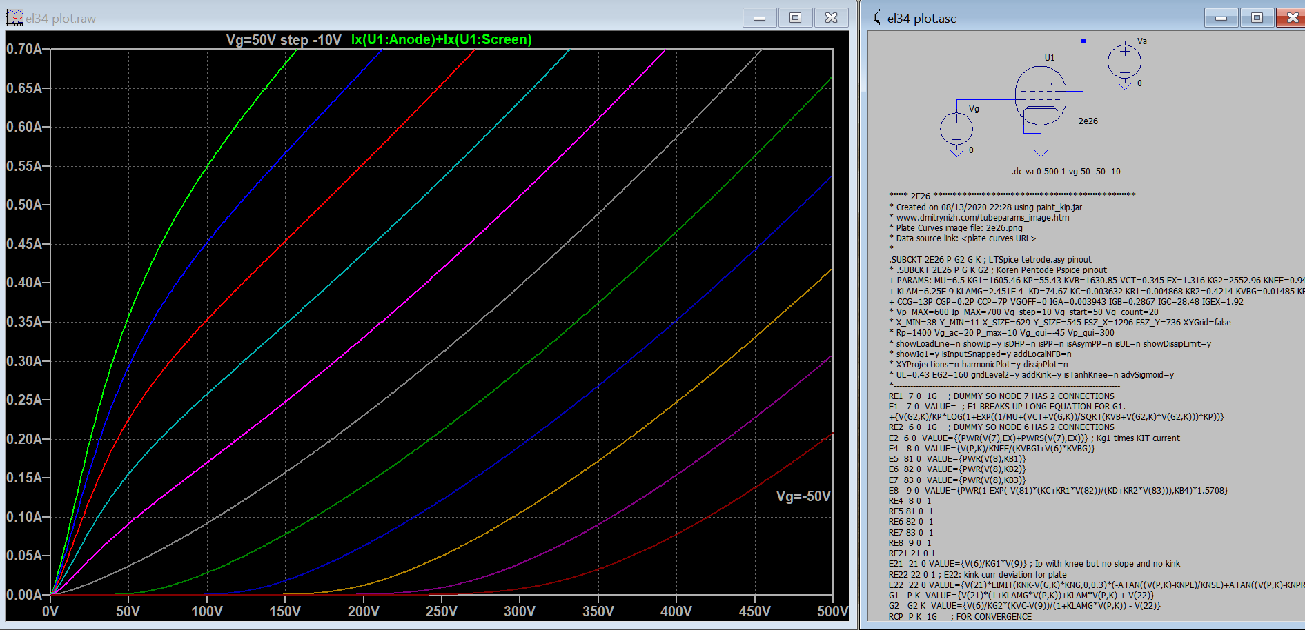

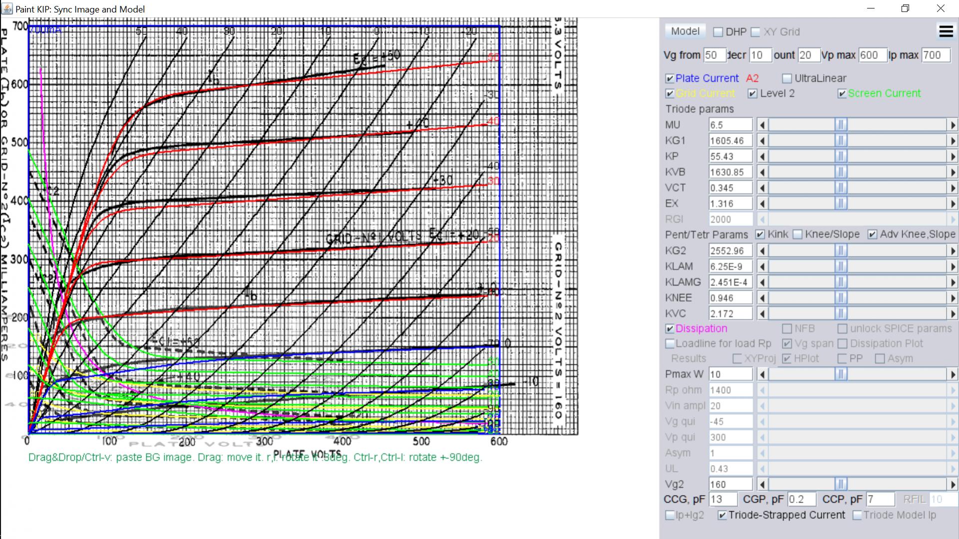

2e26 model:
Code:
**** 2E26 ******************************************
* Created on 08/13/2020 22:28 using paint_kip.jar
* Plate Curves image file: 2e26.png
.SUBCKT 2E26 P G2 G K ; LTSpice tetrode.asy pinout
* .SUBCKT 2E26 P G K G2 ; Koren Pentode Pspice pinout
+ PARAMS: MU=6.5 KG1=1605.46 KP=55.43 KVB=1630.85 VCT=0.345 EX=1.316 KG2=2552.96 KNEE=0.946 KVC=2.172
+ KLAM=6.25E-9 KLAMG=2.451E-4 KD=74.67 KC=0.003632 KR1=0.004868 KR2=0.4214 KVBG=0.01485 KB1=1.96 KB2=1.94 KB3=1.88 KB4=0.3072 KVBGI=0.00099 KNK=0.1517 KNG=0.01181 KNPL=0.06526 KNSL=0.005039 KNPR=118.51 KNSR=119.26
+ CCG=13P CGP=0.2P CCP=7P VGOFF=0 IGA=0.003943 IGB=0.2867 IGC=28.48 IGEX=1.92
* Vp_MAX=600 Ip_MAX=700 Vg_step=10 Vg_start=50 Vg_count=20
* X_MIN=38 Y_MIN=11 X_SIZE=629 Y_SIZE=545 FSZ_X=1296 FSZ_Y=736 XYGrid=false
* Rp=1400 Vg_ac=20 P_max=10 Vg_qui=-45 Vp_qui=300
* UL=0.43 EG2=160 gridLevel2=y addKink=y isTanhKnee=n advSigmoid=y
RE4 8 0 1
RE5 81 0 1
RE6 82 0 1
RE7 83 0 1
RE8 9 0 1
RE21 21 0 1
RE23 G 0 1G
.ENDS
2e26 model
Running into an issue. If I use a single instance of the tube, it appears to work fine (yes, I know this is not a realistic circuit):
But if I create a second instance, it gives a "1.#QNANV" error on anything connected to the plates:
I'm still learning my way around LTSpice, so I'm sure I'm doing something wrong. Any ideas how I can fix it?
So, problem solved. I had to use the alternate solver. But once I did that, I was able to draw up a complete PP output stage.
The model has a couple of limitations: The plate can't go over 450V (datasheet allows 500 for ICAS), and the plate-screen delta can't go over 250. But those are no big deal for me, because I'm targeting 470V on the plates and 190V on the screens. Close enough!
Thanks again!
Thanks again!
