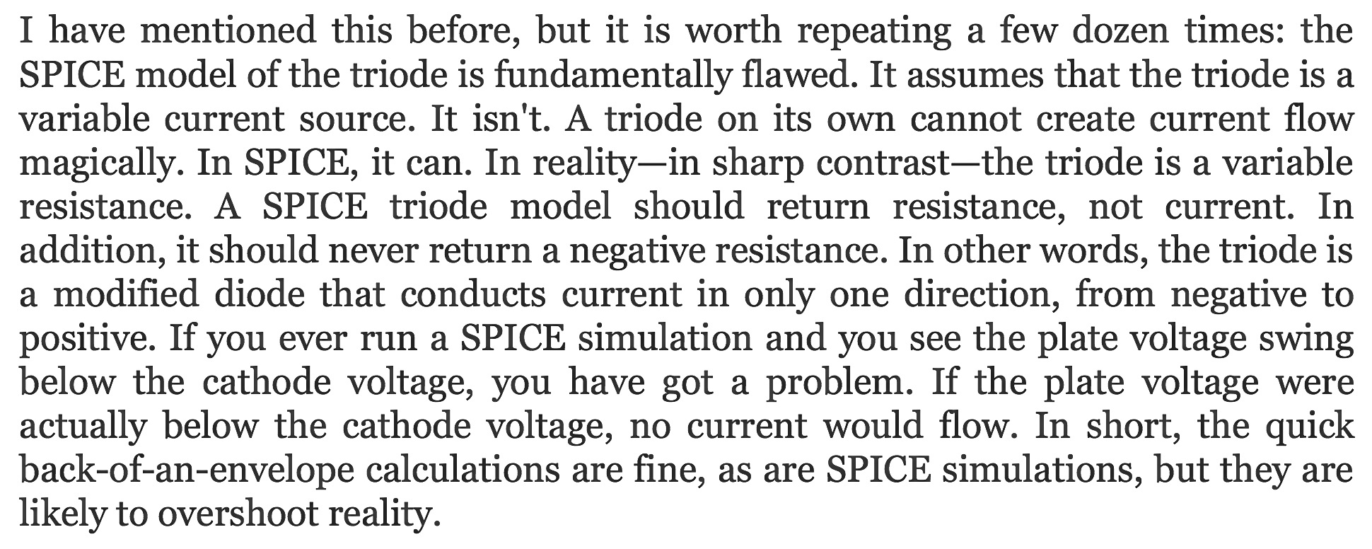

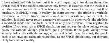

TubeCad blog article exctract from John Broskie about triodes in the Spice simulation
source link Tube CAD Journal

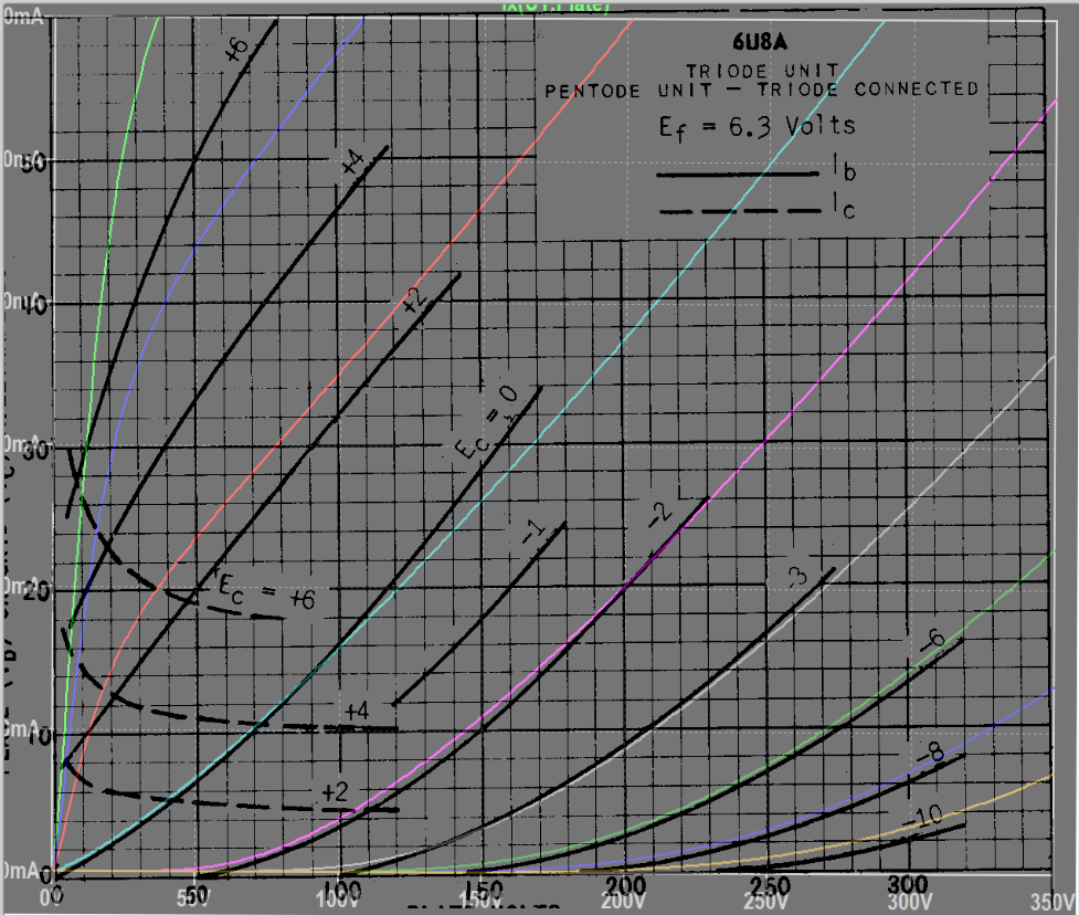

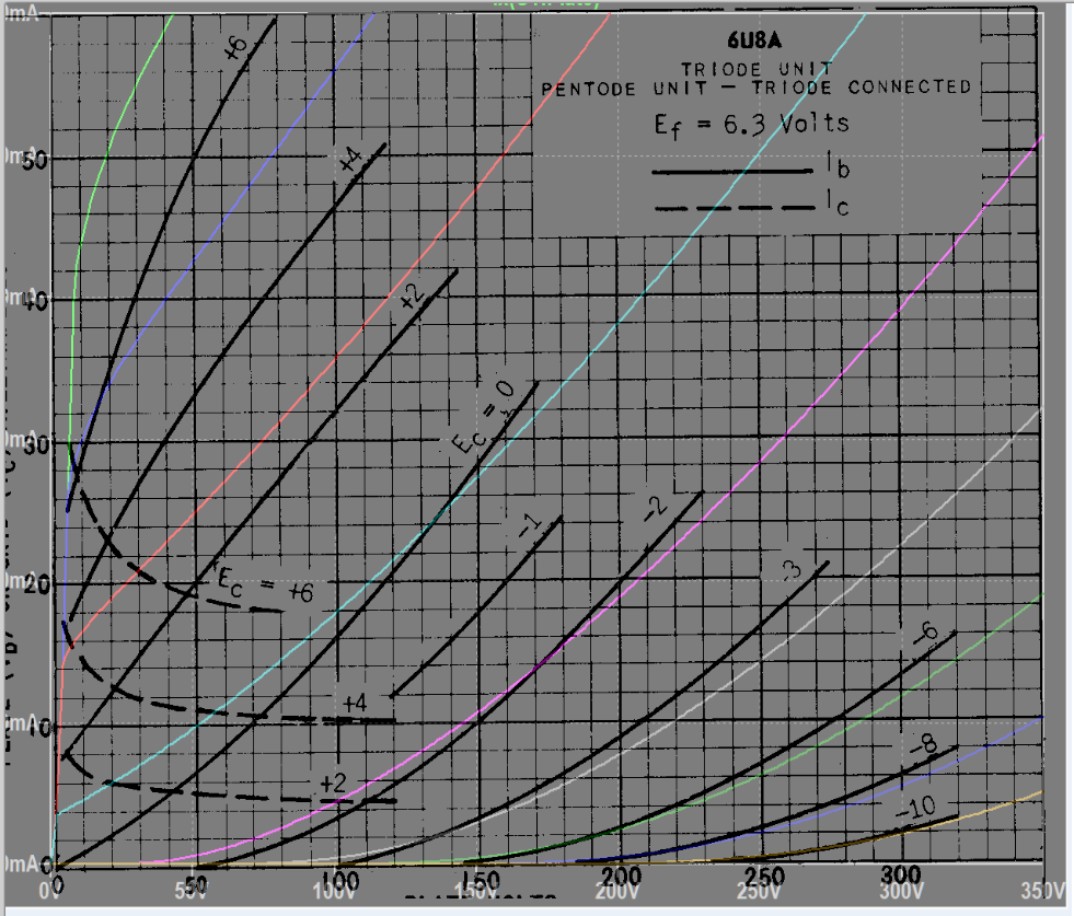

6u8a is glass version? You can use these models http://tubes.tubeampdesign.com/other/docs/Koren_Tubes.cir has better accuracy then one found in the Ayumi zip. The tube model name is either 6u8t or 6u8p. Other name is ecf82t and ecf82p. If not satisfied let us know, I can include grid current model

Here are the Ayumi models.
Triode Section:
Code:
* Generic triode model: 6U8T
* Copyright 2003--2008 by Ayumi Nakabayashi, All rights reserved.
* Version 3.10, Generated on Sat Mar  8 22:41:00 2008
*            Plate
*            | Grid
*            | | Cathode
.SUBCKT 6U8T A G K
BGG   GG   0 V=V(G,K)+0.99995916
BM1   M1   0 V=(0.035181787*(URAMP(V(A,K))+1e-10))**-2.5690962
BM2   M2   0 V=(0.36863223*(URAMP(V(GG)+URAMP(V(A,K))/17.94587)+1e-10))**4.0690962
BP    P    0 V=0.0033085897*(URAMP(V(GG)+URAMP(V(A,K))/48.682314)+1e-10)**1.5
BIK   IK   0 V=U(V(GG))*V(P)+(1-U(V(GG)))*0.013182953*V(M1)*V(M2)
BIG   IG   0 V=0.0016542949*URAMP(V(G,K))**1.5*(URAMP(V(G,K))/(URAMP(V(A,K))+URAMP(V(G,K)))*1.2+0.4)
BIAK  A    K I=URAMP(V(IK,IG)-URAMP(V(IK,IG)-(0.0017567609*URAMP(V(A,K))**1.5)))+1e-10*V(A,K)
BIGK  G    K I=V(IG)
* CAPS
CGA   G    A 1.8p
CGK   G    K 2.8p
CAK   A    K 2p
.ENDS

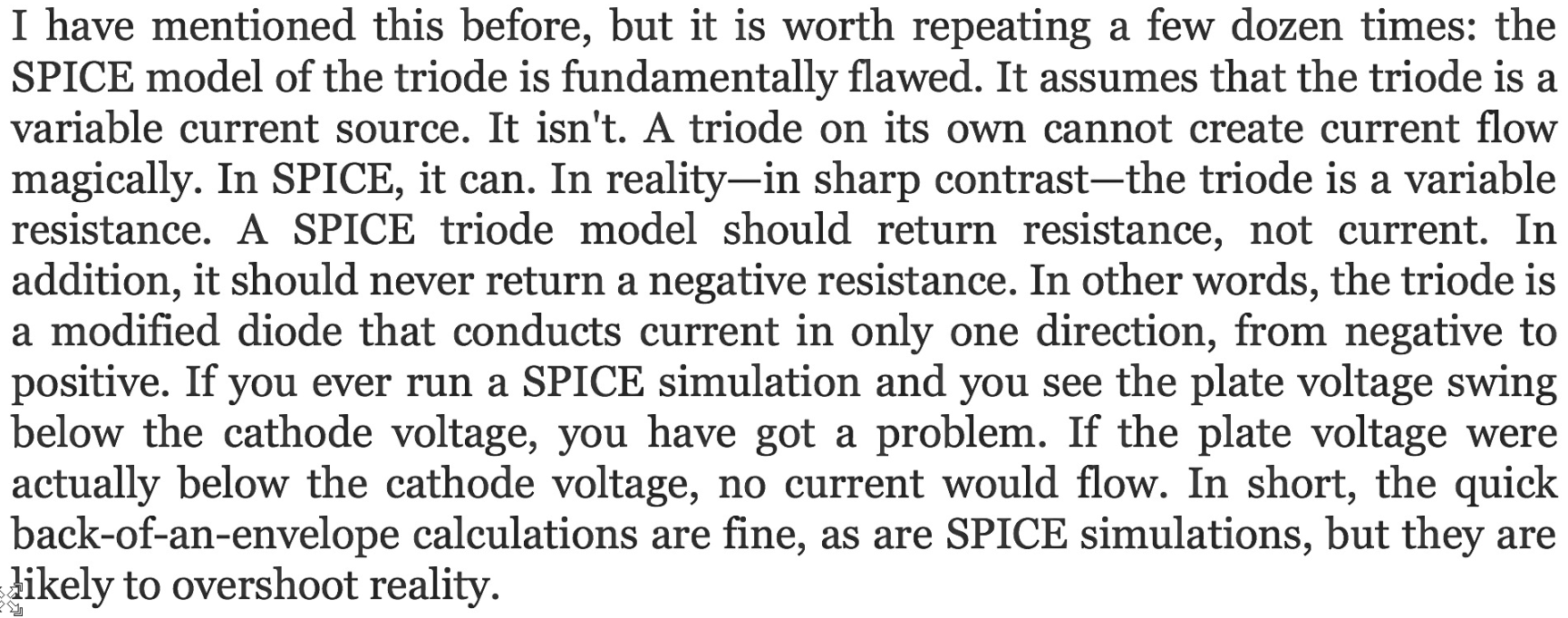

It is very important to know that there isn't just one triode spice model approach, like the article fragment may let suppose.
Instead, there are dozens of very different triode model approaches, all with different strenghs and drawbacks.

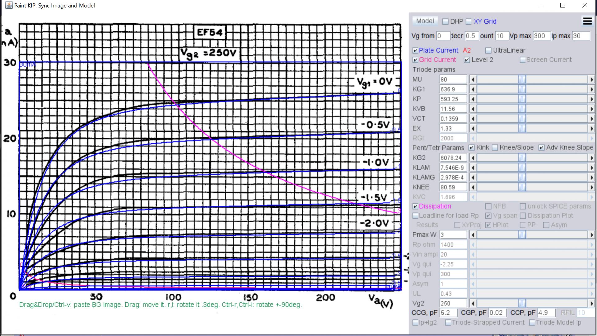

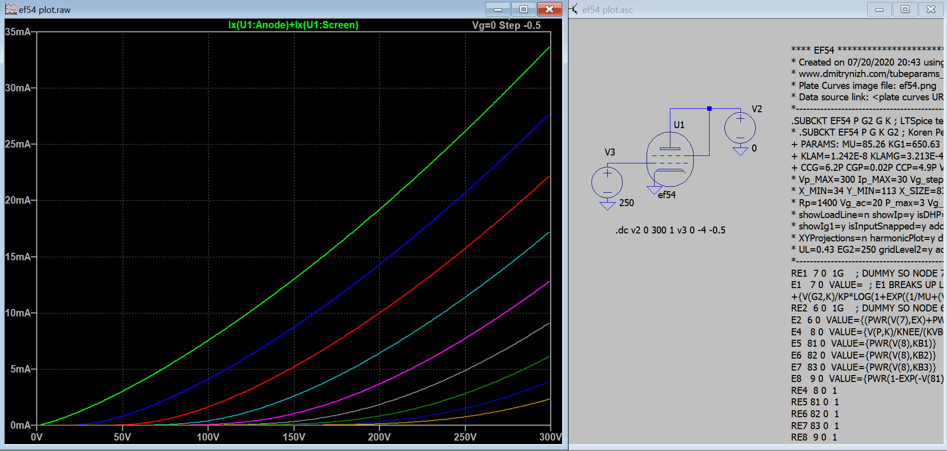

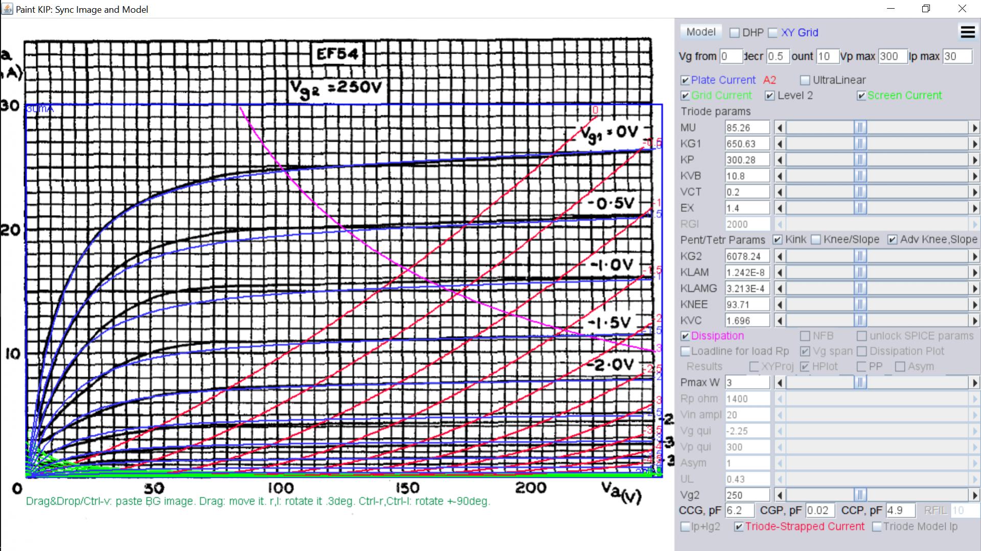

Try this:
Code:
* Created on 07/20/2020 20:43 using paint_kip.jar
* [URL="http://www.dmitrynizh.com/tubeparams_image.htm"]www.dmitrynizh.com/tubeparams_image.htm[/URL]
* Plate Curves image file: ef54.png
* Data source link: <plate curves URL>
.SUBCKT EF54 P G2 G K ; LTSpice tetrode.asy pinout
* .SUBCKT EF54 P G K G2 ; Koren Pentode Pspice pinout
+ PARAMS: MU=85.26 KG1=650.63 KP=300.28 KVB=10.8 VCT=0.2 EX=1.4 KG2=6078.24 KNEE=93.71 KVC=1.696
+ KLAM=1.242E-8 KLAMG=3.213E-4  KD=1.15E-4 KC=3.067 KR1=4.508E-6 KR2=1.739 KVBG=-0.004766 KB1=2.705 KB2=4.113 KB3=2.171 KB4=2.792 KVBGI=0.2282 KNK=-0.2271 KNG=0.005063 KNPL=54 KNSL=12.21 KNPR=128.4 KNSR=33.06
The horizontal axis of the image size is a bit off, it's corrected now:
Code:
**** EF54 ******************************************
* Created on 07/21/2020 03:32 using paint_kip.jar
* [URL="http://www.dmitrynizh.com/tubeparams_image.htm"]Model Paint Tools: Trace Tube Parameters over Plate Curves, Interactively[/URL]
+ PARAMS: MU=80 KG1=636.9 KP=593.25 KVB=11.56 VCT=0.1359 EX=1.33 KG2=6078.24 KNEE=80.59 KVC=1.696
+ KLAM=7.546E-9 KLAMG=2.978E-4  KD=-1.251E-5 KC=2.975 KR1=-8.301E-5 KR2=3.095 KVBG=-4.431E-5 KB1=3.598 KB2=1.316 KB3=2.974 KB4=2.066 KVBGI=0.1073 KNK=-0.2271 KNG=0.005063 KNPL=54 KNSL=12.21 KNPR=128.4 KNSR=33.06
+ CCG=6.2P CGP=0.02P CCP=4.9P VGOFF=-0.6 IGA=0.001 IGB=0.3 IGC=8 IGEX=1.88
