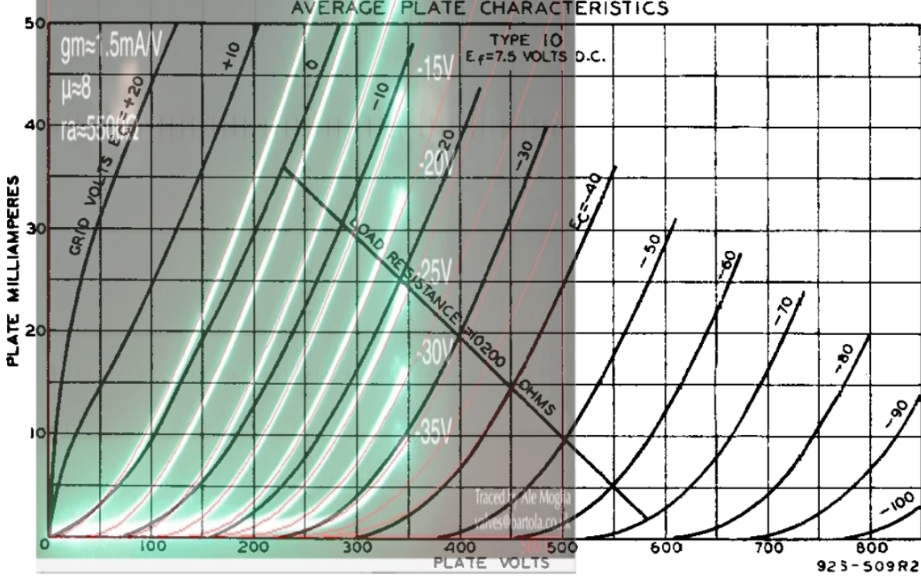

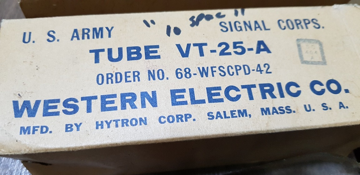

See there is Western Electric own made WE "VT-25" and "VT-25-A" in this image? The -A version is made also by Hytron for Wstern Electric, seems VT-25-A is not uplated VT-25 & just a VT-25 with oxide-coated filament .Some said the curve would be different, but curve is not updated? Practical test measurement can show the differences, I hope.
Here is the model with grid current based on original curve found on left bottom corner.
Code:**** 6N2P ** Advanced Grid Current ********************************** * Created on 05/28/2020 23:43 using paint_kit.jar 3.1 * [URL="http://www.dmitrynizh.com/tubeparams_image.htm"]Model Paint Tools: Trace Tube Parameters over Plate Curves, Interactively[/URL] * Plate Curves image file: 6n2p.png * Data source link: *---------------------------------------------------------------------------------- .SUBCKT 6N2P 1 2 3 ; Plate Grid Cathode + PARAMS: CCG=2P CGP=0.7P CCP=2.3P + MU=115.1 KG1=1406.05 KP=438.01 KVB=397.54 VCT=0.6005 EX=1.46 + VGOFF=-1.029 IGA=5.168E-4 IGB=0.07855 IGC=100.02 IGEX=1.958 * Vp_MAX=440 Ip_MAX=4 Vg_step=0.5 Vg_start=1 Vg_count=12 * Rp=4000 Vg_ac=55 P_max=1 Vg_qui=-48 Vp_qui=300 * X_MIN=130 Y_MIN=3 X_SIZE=1179 Y_SIZE=842 FSZ_X=1798 FSZ_Y=965 XYGrid=true * showLoadLine=n showIp=y isDHT=n isPP=n isAsymPP=n showDissipLimit=y * showIg1=y gridLevel2=y isInputSnapped=n * XYProjections=n harmonicPlot=n dissipPlot=n *---------------------------------------------------------------------------------- E1 7 0 VALUE={V(1,3)/KP*LOG(1+EXP(KP*(1/MU+(VCT+V(2,3))/SQRT(KVB+V(1,3)*V(1,3)))))} RE1 7 0 1G ; TO AVOID FLOATING NODES G1 1 3 VALUE={(PWR(V(7),EX)+PWRS(V(7),EX))/KG1} RCP 1 3 1G ; TO AVOID FLOATING NODES C1 2 3 {CCG} ; CATHODE-GRID C2 2 1 {CGP} ; GRID=PLATE C3 1 3 {CCP} ; CATHODE-PLATE RE2 2 0 1G EGC 8 0 VALUE={V(2,3)-VGOFF} ; POSITIVE GRID THRESHOLD GG 2 3 VALUE={(IGA+IGB/(IGC+V(1,3)))*(MU/KG1)*(PWR(V(8),IGEX)+PWRS(V(8),IGEX))} .ENDS *$

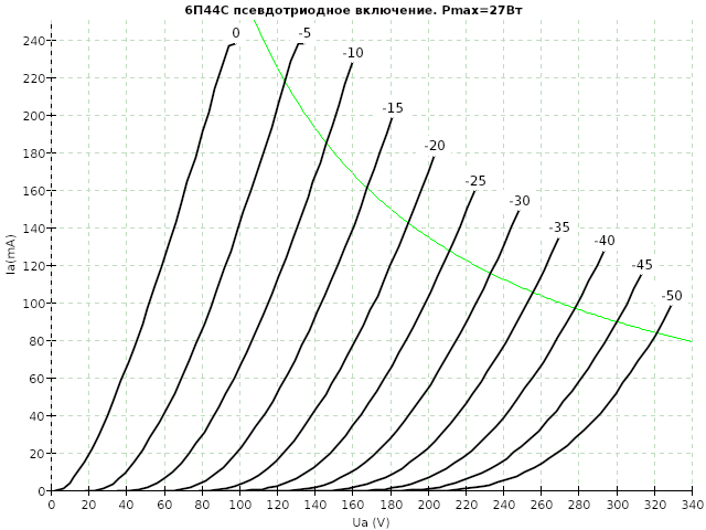

There is a 6p44c triode connected curve here:
Кабинетный SE на 6П44С

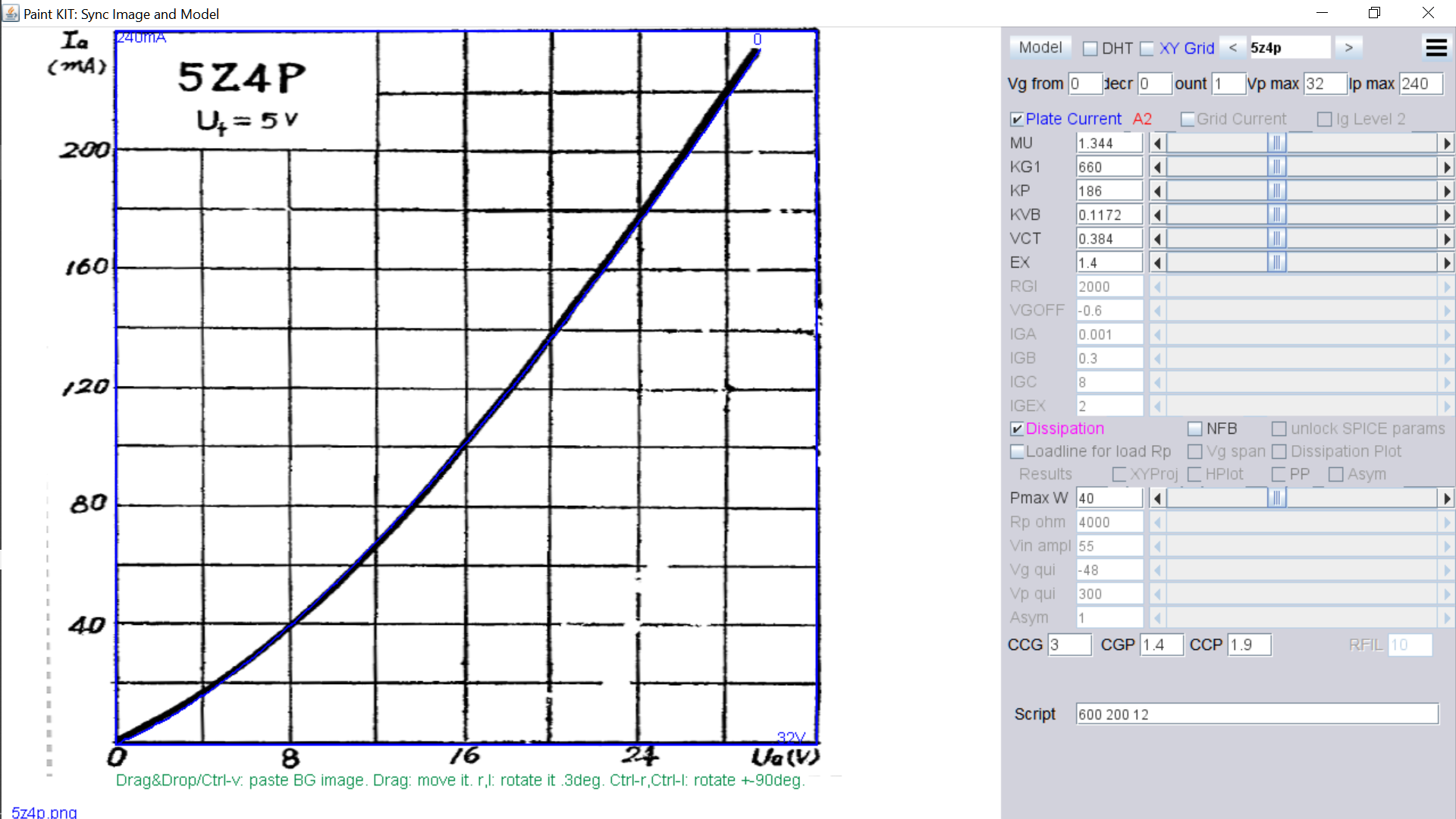

You need an account to retrieve it. This will help a lot, you use paint.net to make an curve image with pentode and triode overlapping and in Paint tool turn on triode connected mode to adjust against the triode curve of the image.

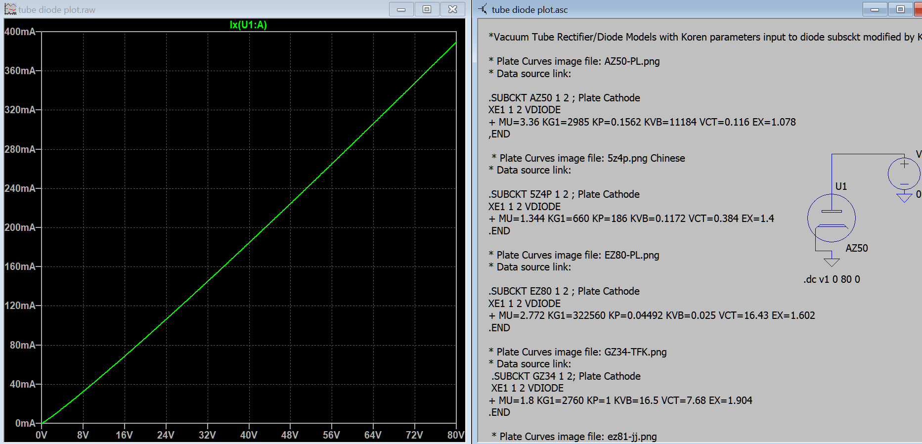

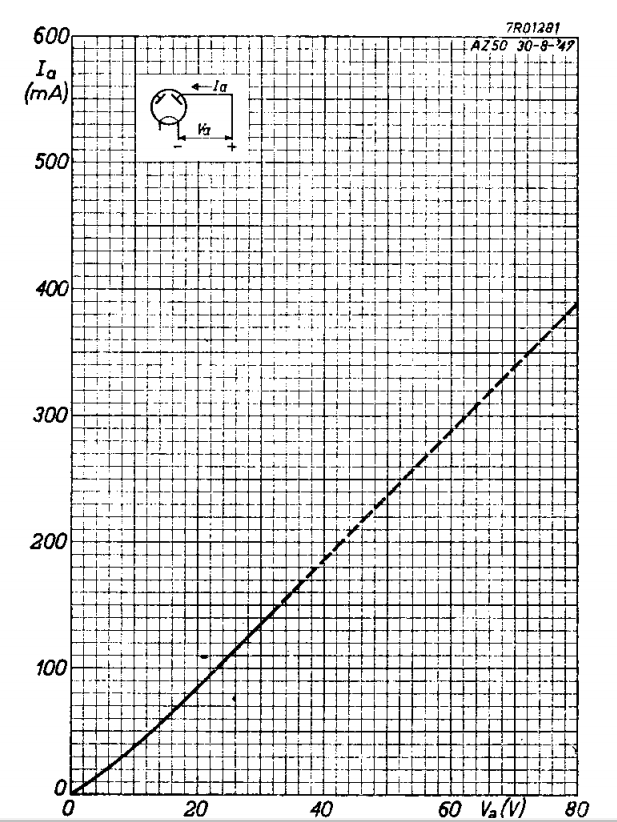

AZ50 spice model
Just maked spice model for Philips AZ50.
Next step is install it in my amp, because Siemens GZ34 was finished after a long time.
.model AZ50 D(Is=1e-2 RS=204 Cjo=30p vj=2 N=23 bv=1550 mfg=Philips type=vacuum )

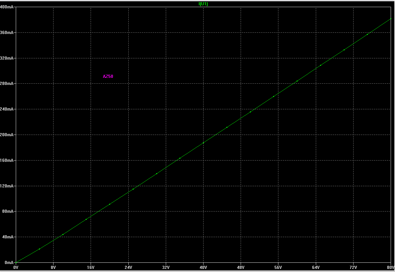

Nice work. Do you also have .MODEL definitions for other popular vacuum tube diodes? I'm looking for the GZ34/5AR4, 12X4/6X4, and 6CA4/EZ81. I have models for these but they are all .SUBCKT definitions.
Ray, here is:
.model GZ34 D(Is=1e-2 RS=36 Cjo=30p vj=2 N=80 bv=1500 mfg=TFK type=vacuum )
.model 6X4 D(Is=1e-2 RS=121 Cjo=20p vj=2 N=256 bv=1250 mfg=RCA type=vacuum )
.model 5R4GY D(Is=1e-2 RS=150 Cjo=30p vj=2 N=305 bv=3100 mfg=RCA type=vacuum )
.model EZ81 D(Is=1e-2 RS=53 Cjo=5p vj=2 N=163 bv=330 mfg=Mazda type=vacuum )

AZ50 has the smallest voltage drop after the GZ34 rectifier, as far as I know.
Ik is only 2 mA smaller through my =C= 300B.
Sound is great. Bass may be a little less defined, but the mids and highs are beautiful. I expect more improvements after my Philips AZ50 "sits down"
Guys, if you have a Philips AZ50, go ahead.
And yes, spice model is OK.
Moderators, if you think this post is unnecessary, delete it. No problem.

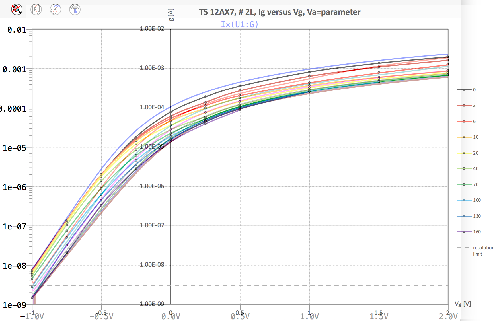

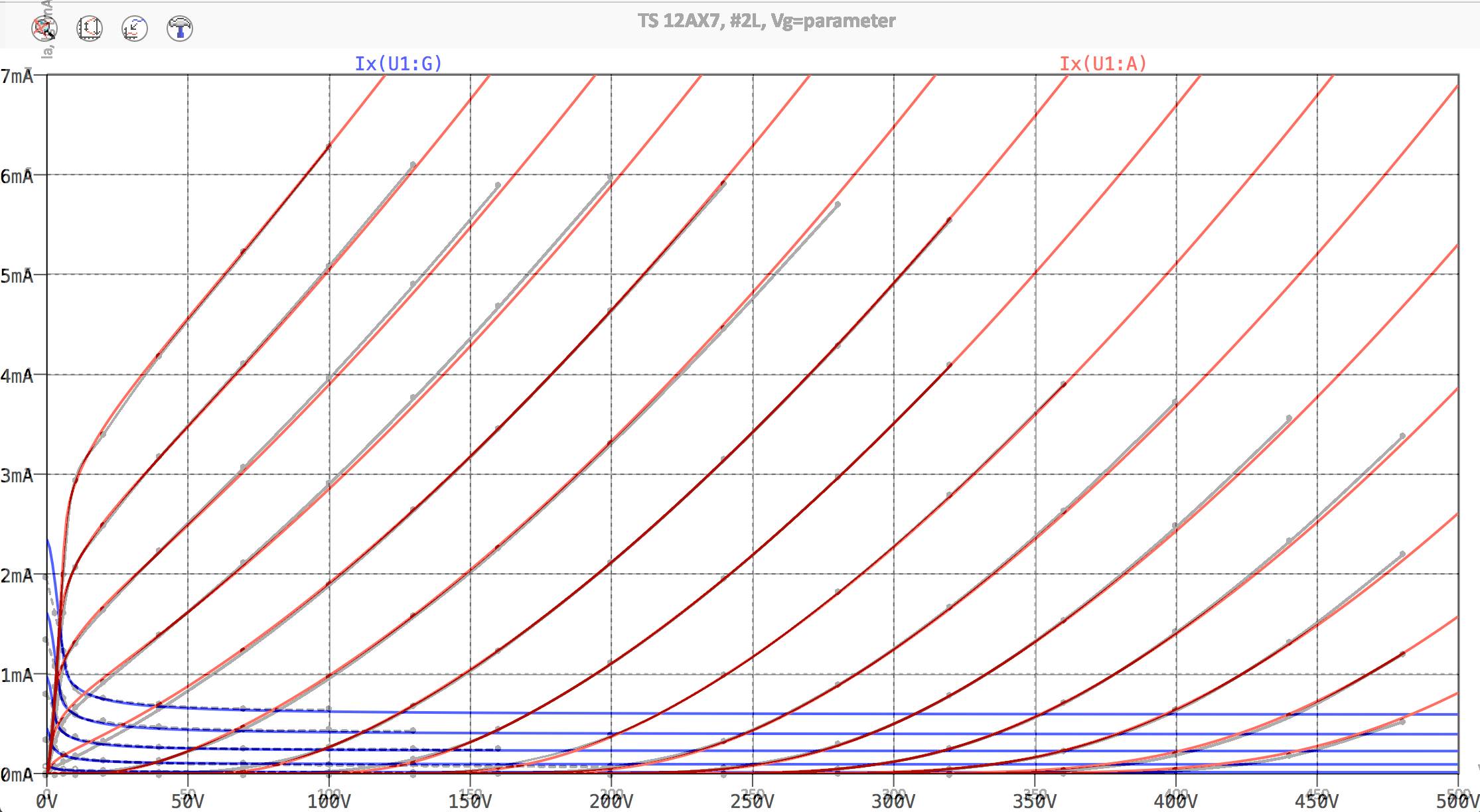

Hi cogsnogs
It took some time to create the Tung-Sol 12AX7 spice model, but the result has really not to be hidden! 😀
It is based on detailed measurements from a "golden sample" out of 5 burnt-in and quality-tested tubes. "golden Sample" means this triode, which showes best match to the data sheet.
As you can see in the log(Ig) graph, my model copes to mimic the initial velocity grid current (the linear slopes at the left side of the graph), so that means you will be able to simulate biasing with grid resistor (e.g. 20 MOhm or so).
Be aware that this kind of bias setting is NOT (!!) recommended with JJ ECC83S tubes - my measurements showed extreme grid current tolerances for this tubes.
all the best, Adrian

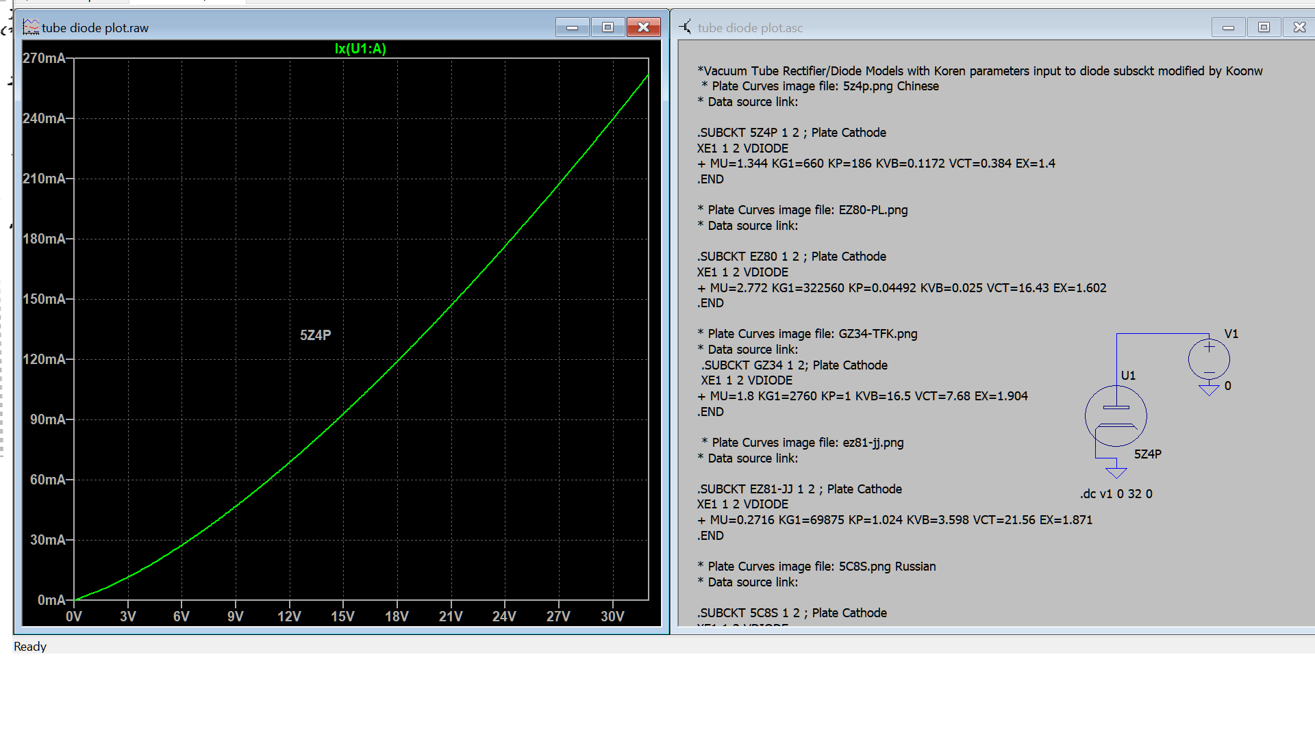

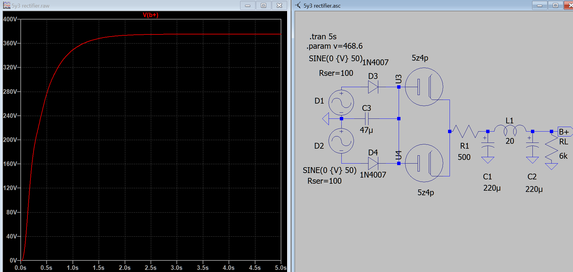

I wish to share with you all this new approach of mine to model vacuum rectifiers/diodes in attached VT-Diode.inc Vacuum Tube Rectifier/Diode modeled with Koren parameters input to diode sub-circuit adopted from triode model, i.e grid model is being excluded, left with only diode model, only Koren parameter is extracted from I/V rectifier curve using Paintool or ExtractModel.
Koonw.
Koonw.

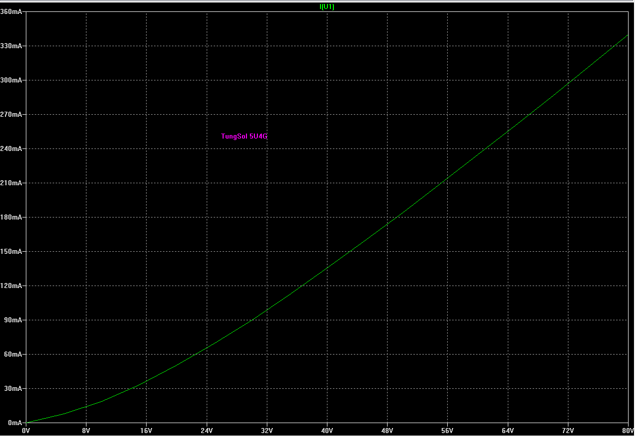

How to change PSUD2 model in LT spice model and vice versa.
Take for example the 6D22S tube rectifier.
PSUD2 model is:
VT, 0, 1.2646; 0.00677, 5000, 99, 1
In LT spice that model will be:
* 6D22S rectifier
.SUBCKT 6D22S 1 2
b1 1 2 i = 6.77E-3 * uramp (V (1,2)) ** 1.2646
Cpk 1 2 10P
.ends 6D22S
You can easily convert SUBCKT model in to PSUD2. Example with GZ30 (BTW, beautiful Mullard rectifier):
.SUBCKT GZ30 A K
* 3/2 power law, formulated as v * sqrt (v) for convergence
b1 A K i = 1.9e-3 * uramp (V (A, K)) ** 1.44
.ENDS GZ30
in to PSUD2 it will be:
VT, 0, 1.440, 0.00190, 1500, 99, 1
I hope I didn't make some typo. But I believe you understand me.
Mr Duncan, I hope you have nothing against this recommendation of mine.
Best DIYing

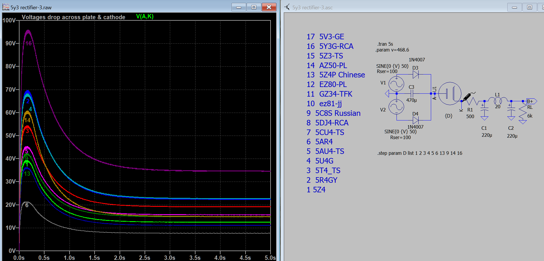

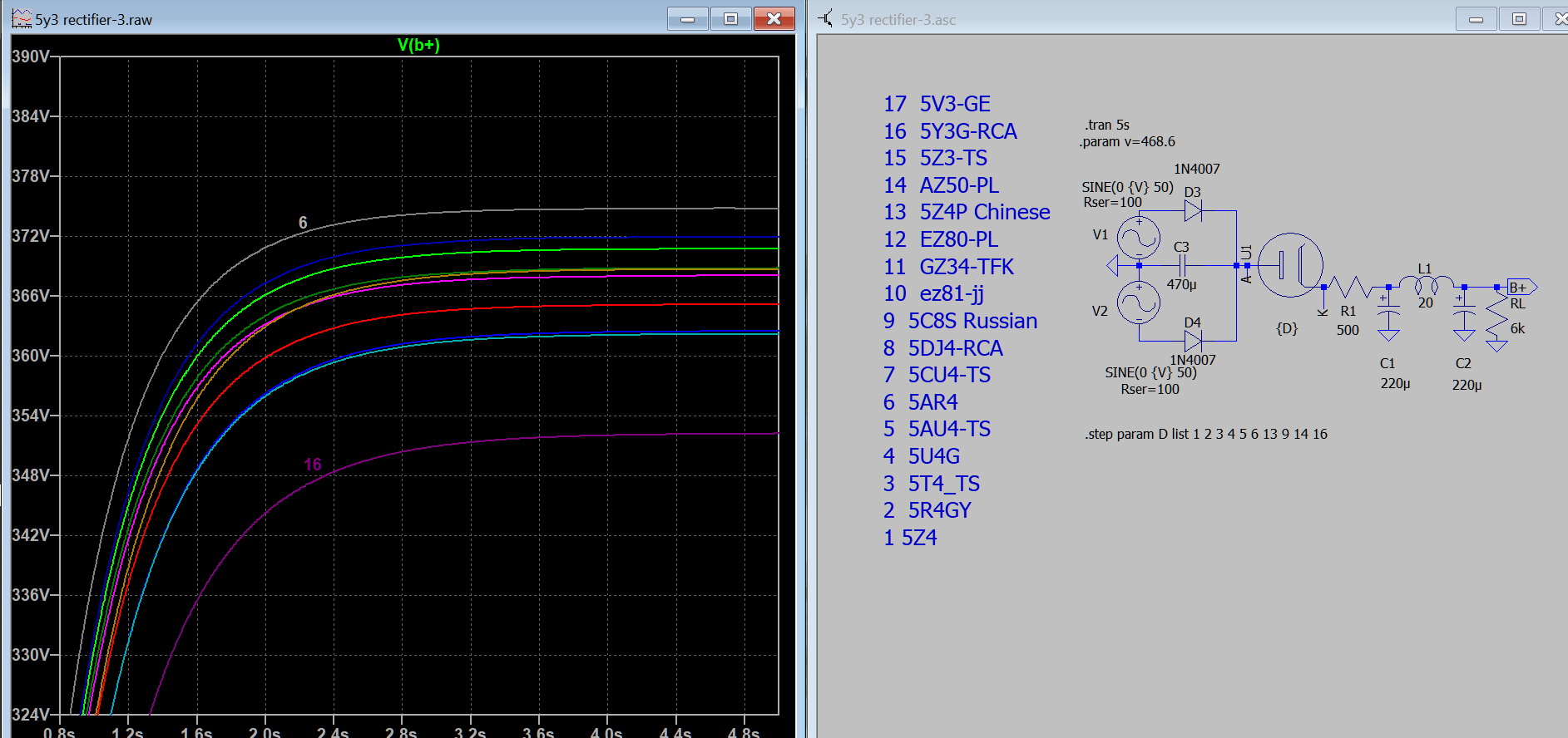

Some models run very slowly when sim, now I have used different value for the fitting the I/V curves, so here is the update version. I'll add more later so you can add any model as long as it has I/V curve in datasheet.I wish to share with you all this new approach of mine to model vacuum rectifiers/diodes in attached VT-Diode.inc Vacuum Tube Rectifier/Diode modeled with Koren parameters input to diode sub-circuit adopted from triode model, i.e grid model is being excluded, left with only diode model, only Koren parameter is extracted from I/V rectifier curve using Paintool or ExtractModel.
Koonw.
Convert /rectified AC to DC first using silicon, significantly speed up the simulation time.Some models run very slowly when sim, now I have used different value for the fitting the I/V curves, so here is the update version. I'll add more later so you can add any model as long as it has I/V curve in datasheet.
After gaining some speeds in simulation, I am finally able to plot something for sharing, hope you enjoy looking.
