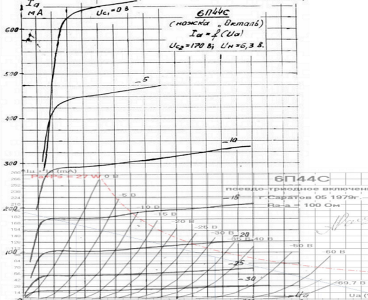

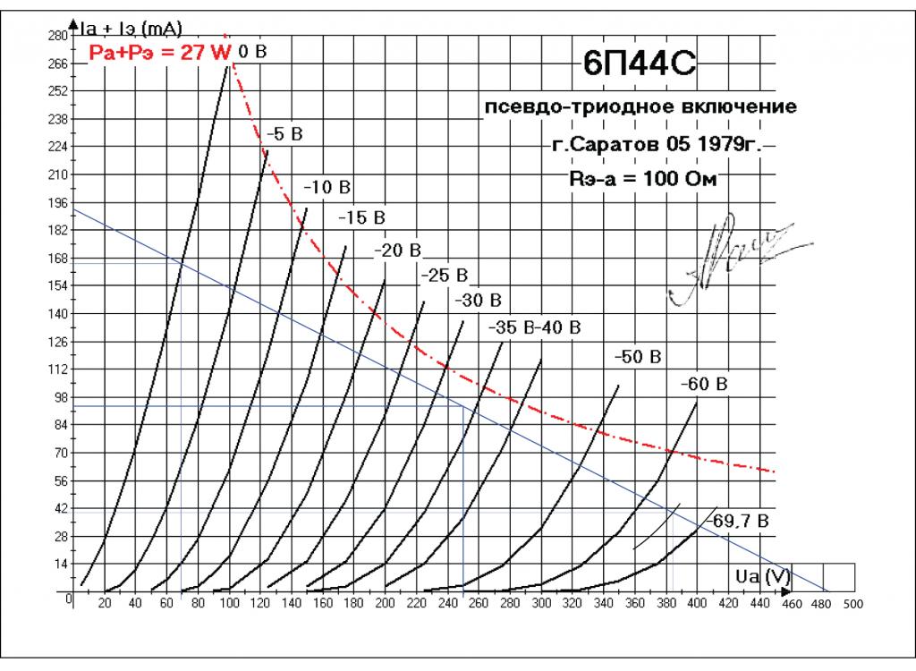

There is a 6p44c triode connected curve here:
Кабинетный SE на 6П44С
You need an account to retrieve it. This will help a lot, you use paint.net to make an curve image with pentode and triode overlapping and in Paint tool turn on triode connected mode to adjust against the triode curve of the image.

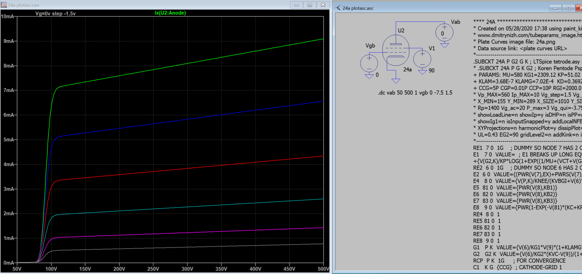

https://frank.pocnet.net/sheets/029/2/24A.pdfDoes anyone have data for UY-224 or 24A? Thank you.
Please test this model if interested, see how it goes.
Code:
**** 24A ******************************************
* Created on 05/28/2020 17:38 using paint_kip.jar
* [url=http://www.dmitrynizh.com/tubeparams_image.htm]Model Paint Tools: Trace Tube Parameters over Plate Curves, Interactively[/url]
* Plate Curves image file: 24a.png
* Data source link: [url]https://frank.pocnet.net/sheets/029/2/24A.pdf[/url]
.SUBCKT 24A P G2 G K ; LTSpice tetrode.asy pinout
* .SUBCKT 24A P G K G2 ; Koren Pentode Pspice pinout
+ PARAMS: MU=580 KG1=2309.12 KP=51.02 KVB=2.4 VCT=4.512 EX=1.008 KG2=2436 KNEE=53.76 KVC=1.748

RE1 7 0 1G ; DUMMY SO NODE 7 HAS 2 CONNECTIONS
E1 7 0 VALUE= ; E1 BREAKS UP LONG EQUATION FOR G1.
+{V(G2,K)/KP*LOG(1+EXP((1/MU+(VCT+V(G,K))/SQRT(KVB+V(G2,K)*V(G2,K)))*KP))}
RE2 6 0 1G ; DUMMY SO NODE 6 HAS 2 CONNECTIONS
E2 6 0 VALUE={(PWR(V(7),EX)+PWRS(V(7),EX))} ; Kg1 times KIT current
E4 8 0 VALUE={V(P,K)/KNEE/(KVBGI+V(6)*KVBG)}
E5 81 0 VALUE={PWR(V(8),KB1)}
E6 82 0 VALUE={PWR(V(8),KB2)}
E7 83 0 VALUE={PWR(V(8),KB3)}
E8 9 0 VALUE={PWR(1-EXP(-V(81)*(KC+KR1*V(82))/(KD+KR2*V(83))),KB4)*1.5708}
RE4 8 0 1
RE5 81 0 1
RE6 82 0 1
RE7 83 0 1
RE8 9 0 1
G1 P K VALUE={V(6)/KG1*V(9)*(1+KLAMG*V(P,K))+KLAM*V(P,K)}
G2 G2 K VALUE={V(6)/KG2*(KVC-V(9))/(1+KLAMG*V(P,K))}
RCP P K 1G ; FOR CONVERGENCE
C1 K G {CCG} ; CATHODE-GRID 1
C2 G P {CGP} ; GRID 1-PLATE
C3 K P {CCP} ; CATHODE-PLATE
R1 G 5 {RGI} ; FOR GRID CURRENT
D3 5 K DX ; FOR GRID CURRENT }
.MODEL DX D(IS=1N RS=1 CJO=10PF TT=1N)
.ENDS

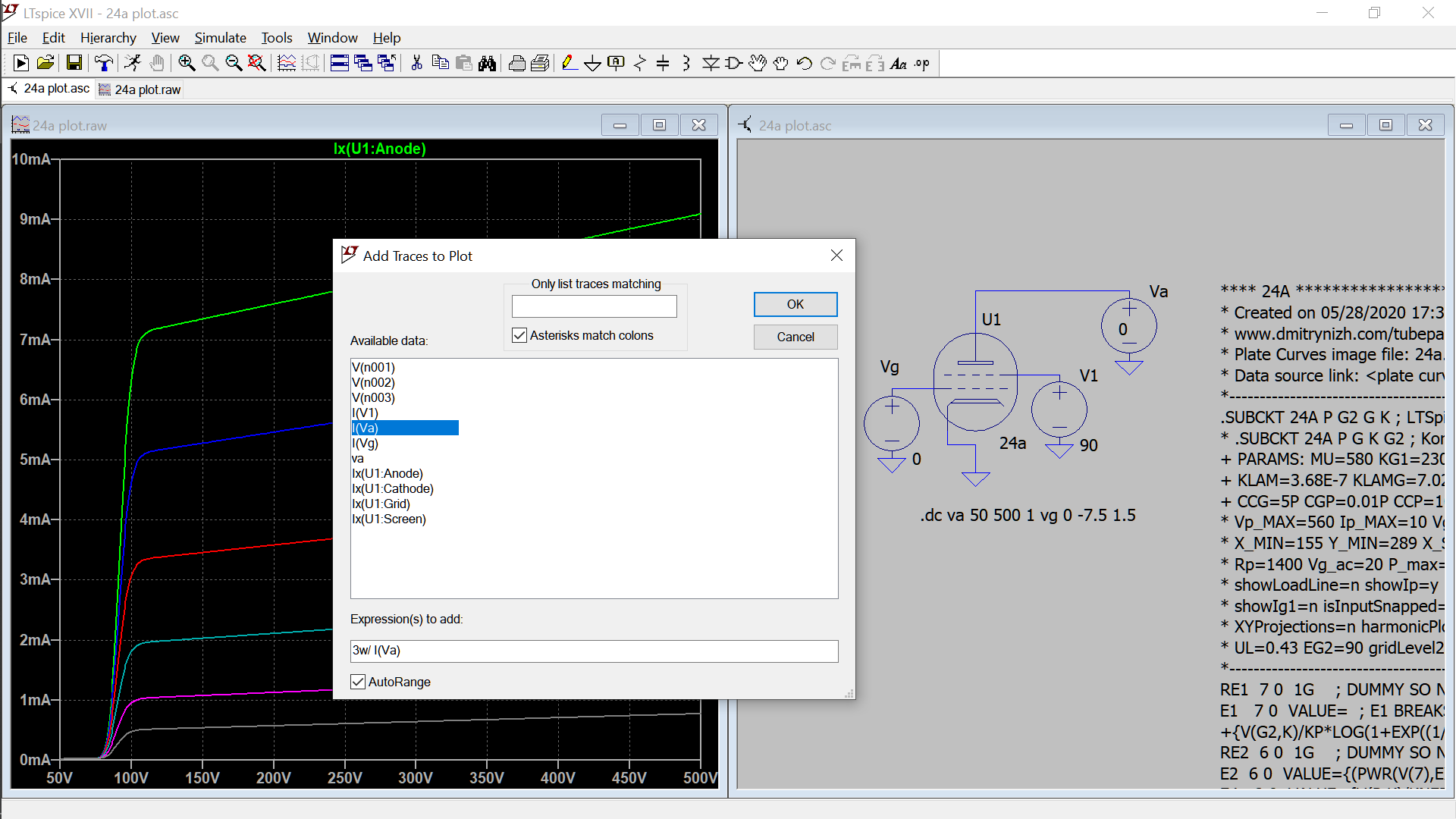

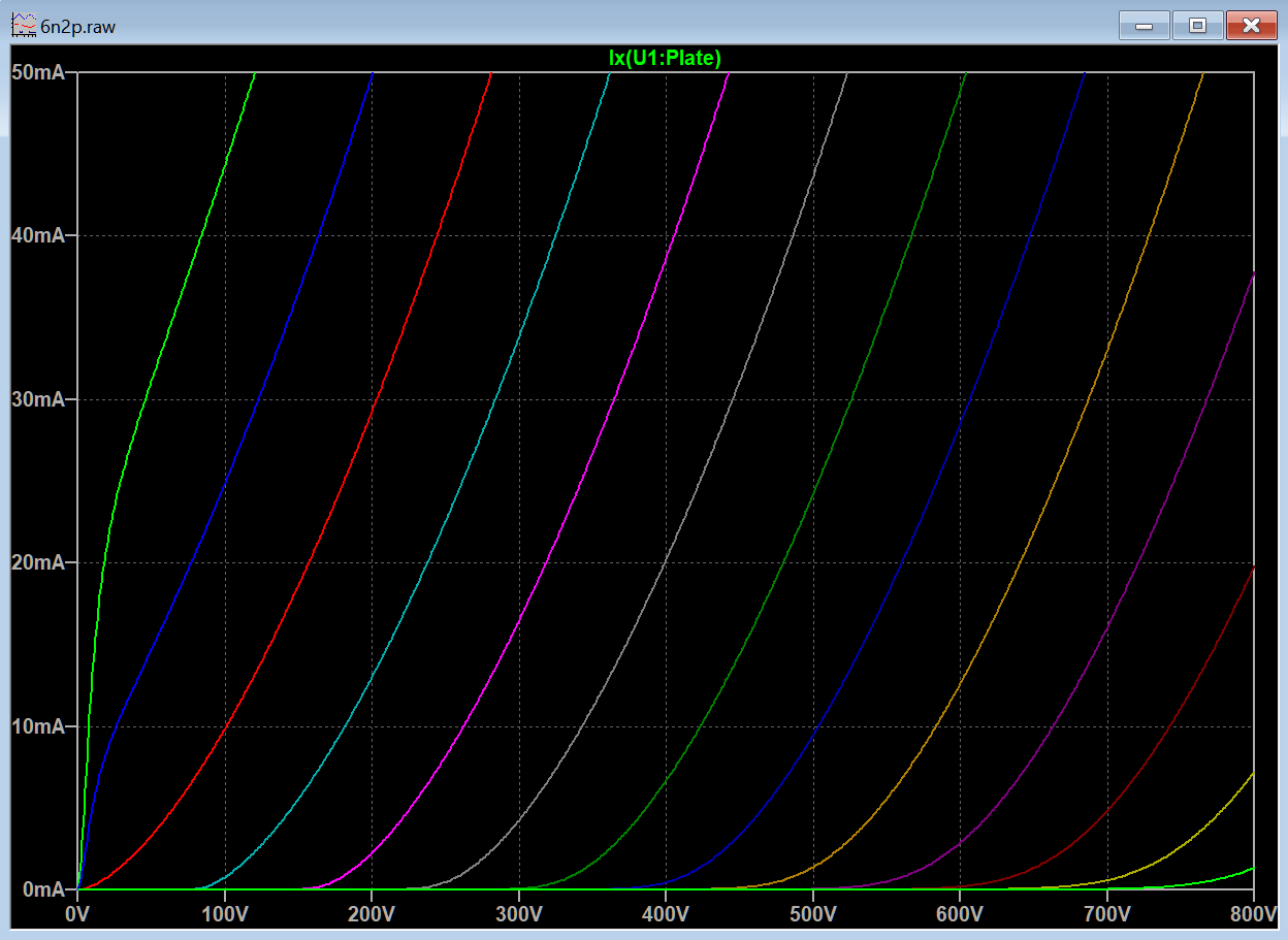

How do you generate the plate dissipation curves in LTspice? I replicated the diagram in the thumbnail picture (post #2405) but failed to produce the curves. How do I generate "lx(U2:anode)"?
Thanks,
Jeff
Thanks,
Jeff

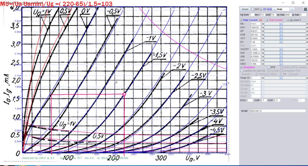

Can somebody here make a precise model of 6N2P and 6N2P-EV .....sorry for give work to do.....😀
Use dc sweep simulation, e.g .dc Va 0 500 1 vV 0 -8 -1 run it. Right click in the waveform window, click Add Trace in popup windows pick the data or enter expression. For dissipation it is PdMax/Va. If PdMax is 3w then expression is 3w/Va, where Va is the data display in data available. Right click the waveform window, click View->Manual Limits to set display limit, if not display correctly.Koonw,
Thanks,
Jeff

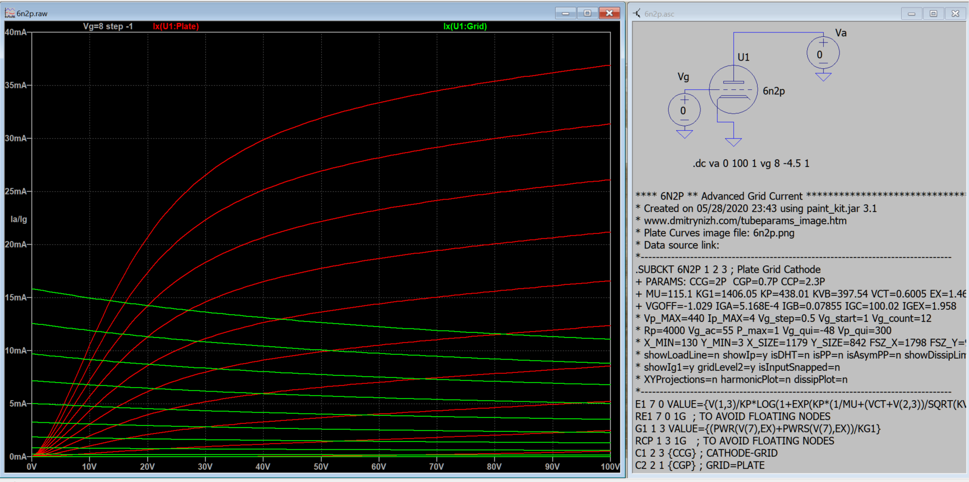

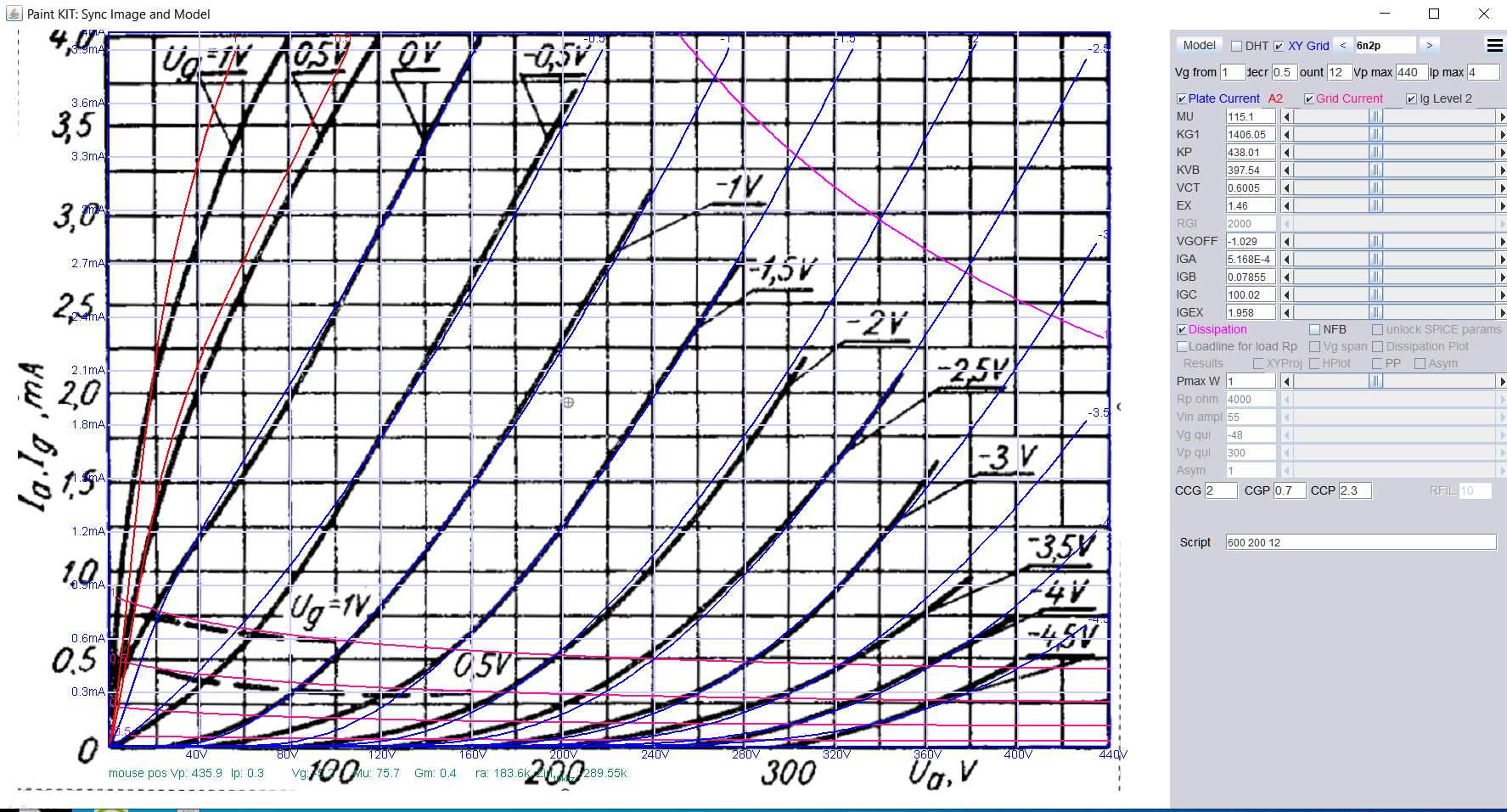

Here is the model with grid current based on original curve found on left bottom corner.Can somebody here make a precise model of 6N2P and 6N2P-EV .....sorry for give work to do.....😀
Code:
**** 6N2P ** Advanced Grid Current **********************************
* Created on 05/28/2020 23:43 using paint_kit.jar 3.1
* [URL="http://www.dmitrynizh.com/tubeparams_image.htm"]Model Paint Tools: Trace Tube Parameters over Plate Curves, Interactively[/URL]
* Plate Curves image file: 6n2p.png
* Data source link:
.SUBCKT 6N2P 1 2 3 ; Plate Grid Cathode
+ PARAMS: CCG=2P CGP=0.7P CCP=2.3P
+ MU=115.1 KG1=1406.05 KP=438.01 KVB=397.54 VCT=0.6005 EX=1.46
+ VGOFF=-1.029 IGA=5.168E-4 IGB=0.07855 IGC=100.02 IGEX=1.958
* Vp_MAX=440 Ip_MAX=4 Vg_step=0.5 Vg_start=1 Vg_count=12

E1 7 0 VALUE={V(1,3)/KP*LOG(1+EXP(KP*(1/MU+(VCT+V(2,3))/SQRT(KVB+V(1,3)*V(1,3)))))}
RE1 7 0 1G ; TO AVOID FLOATING NODES
G1 1 3 VALUE={(PWR(V(7),EX)+PWRS(V(7),EX))/KG1}
RCP 1 3 1G ; TO AVOID FLOATING NODES
C1 2 3 {CCG} ; CATHODE-GRID
C2 2 1 {CGP} ; GRID=PLATE
C3 1 3 {CCP} ; CATHODE-PLATE
RE2 2 0 1G
EGC 8 0 VALUE={V(2,3)-VGOFF} ; POSITIVE GRID THRESHOLD
GG 2 3 VALUE={(IGA+IGB/(IGC+V(1,3)))*(MU/KG1)*(PWR(V(8),IGEX)+PWRS(V(8),IGEX))}
.ENDS

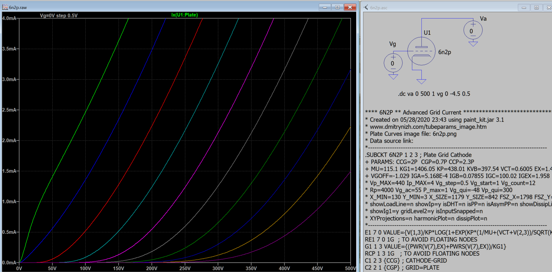

From 6N2P curves you posted here, MU is about 103.
NOT 116 as in your spice model. Sorry, but your spice model is unusable.
Dimitrij has an extraordinary tool for making spice models. You just need to be a little more careful when applying.

Thank for you advice. The u here is for best fit, because 6n2p is less linear towards the right extreme, the increase of u give it better fit. I also done 2 other 12ax7 Mazda and Philips the u is both 100 fit nicely. I tried a mu 60 for 12AT7, the best fit is 94, what say you ah?? That is if you point the mouse on screen, mu of all over the places there is no need to calculate like you did!. A small change cause big drift that is where one have to be judicial in making the choice. Anyhow the Mu is in the model does not matter a lot, for example a mu of 94 the gain is only slightly higher if model with mu of 60 for 12AT7, I can show u later why I begin to dislike the paint_kit.jar, but I like pentode paint_kip, it has more than 8 parameters! As long as you get best fit, it does not stick to fix parameters these are design to fit a wider ranges of curve.Koonw,

This is a bit harsh.
I doubt anyone will seriously want to run this valve at a range of +1v grid through to -4v grid at the same time and expect a linear result.
In this case, the curves are a very good match where grid voltage is minus 1 to 1.5 volts and at 0 volts above 2mA.
If you more sensibly bias your 6n2p where it is more linear, at 240v and 3mA, then mu is most certainly far higher than 103 and you avoid dealing with the 0v grid bias where there is an inflection in the grid curve - which is where you chose to measure your mu.
Feel free to post a better match.
kind regards
Marek
Post 678 in this thread is correct spice model for 6N2PEV.
And in my drawing I just showed how to graphically calculate MU. You can take an operating point eg 300V and 2mA and you will get a similar MU. Try it.

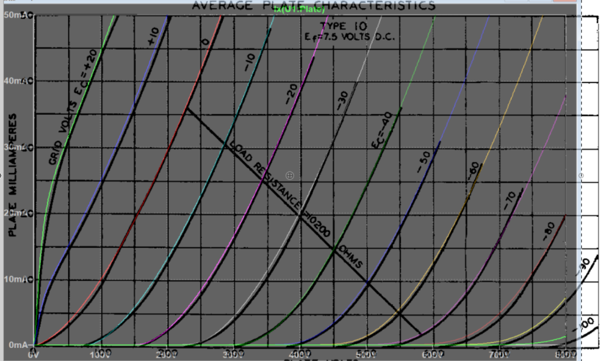

LTSPICE problems with 10Y model
https://frank.pocnet.net/sheets/021/1/10.pdf
This post #2 model (copy code as below) fitted well with 10y-RCA. No grid current modeled.
