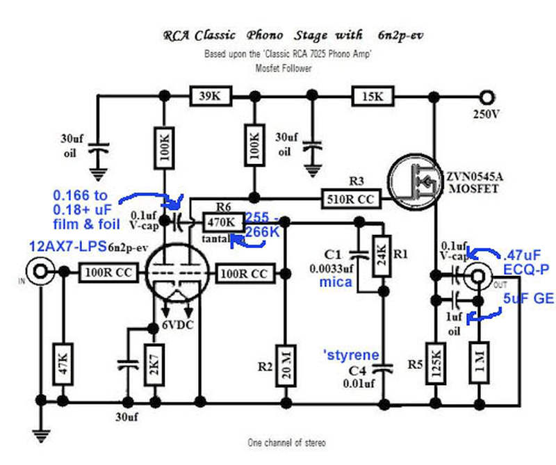

Do you think this 12AX7_MAZ model will be accurate for simulating contact-potential bias? For instance, Eli Duttman's RCA-style phono stage uses the second stage with contact-potential bias, with the 12AX7 cathode grounded and a large (20M) grid leak resistor. Would this model simulate that accurately?

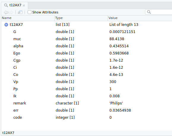

Looking in RStudio, it appears to be Philips.
Thanks for that Koonw.

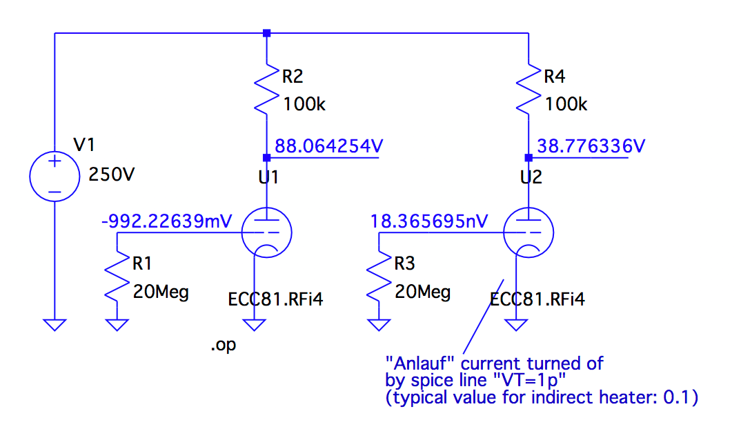

Hi rongon
I doubt that Koonw's 12AX7_MAZ model will deliver an accurate bias point. It does not consider the "Anlauf" current (initial velocity grid current), which leads to a voltage drop up to -1V across a 20 Mohm resistor.
See my graph attached, I did a short comparison with and without "Anlauf" current. I used a ECC81 as I have not generated an ECC83 model yet - but this will follow soon 😉.
cheers, Adrian

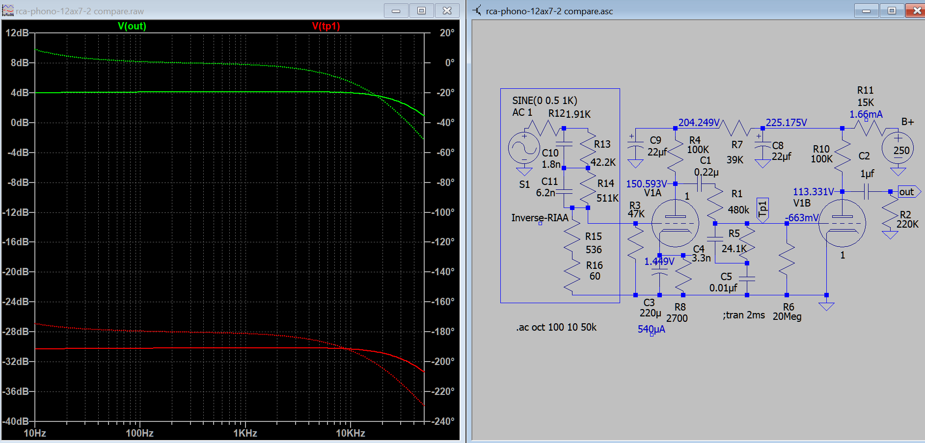

Riaa eq out is same for Ayumi and 12AX7_MAZ with original RCA riaa schematic and does not required any alteration of timing component value as in Eli's. This is true even with 2nd section is disconnected, the output of 1st stage is same. So this implied the output Z is no difference. If the cathode bias is used as in original 12AX7_MAX has about 0.7dbs higher that is all. But when you use grid leak bias the value of R2 resistor 20M in Eli need to be change 120Meg. This is because my model has much lower input impedance because grid current is model. Eli's need to alter riaa timing components I find that is not needed. In actual circuit R2 could be different also, but Eli altered the timing components (values depend on which tube in used) instead of increase R2 value that is all.
P/S The model is still under testing. I reduced VgOff from -0.7v to -0.1v then I can use 20M for R2, as the input impedance is increased so the combined Z is about 680k as original. The accuracy of input Z is important.
Huh.
It's amazing what you guys are doing for something as silly as vacuum tubes -- but I like it! 😀
I figure contact-potential bias has to be really difficult to model accurately.
I didn't think the RIAA eq would change much, but just getting a contact-potential biased model to show bias properly is definitely a challenge.
Keep up the great work you guys. Much appreciated by us tube aficionados.

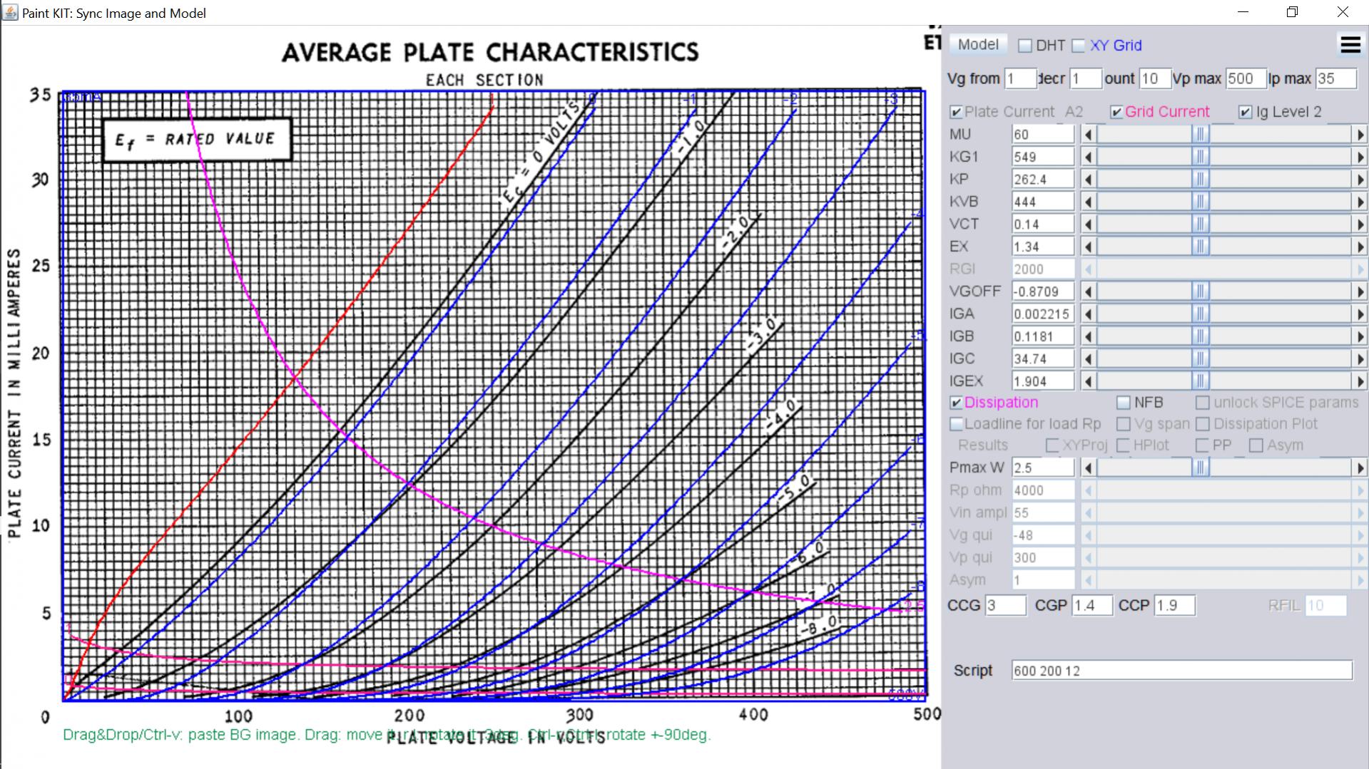

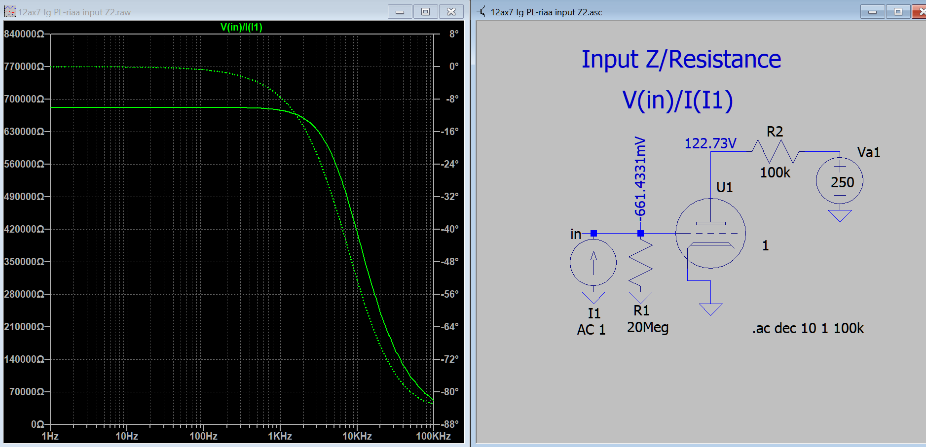

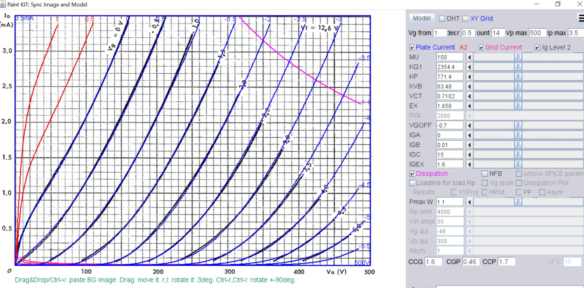

I have remodeled 12ax7_maz the grid current so that input impedance becomes more accurate. When 20M as grid resistor, the total input Z is about 680k (700k//20Meg=680k). VgOff is not changed to increase input Z as this is the grid contact bias that already assume to have correct plate voltage as found in practical circuit measurement. Instead other parameters such as IGA IGB and IGC and IGEX is changed to achieve the target Z.
Code:
**** 12AX7_MAZ ** Advanced Grid Current **********************************
* Created on 05/26/2020 09:28 using paint_kit.jar 3.1
* [URL="http://www.dmitrynizh.com/tubeparams_image.htm"]Model Paint Tools: Trace Tube Parameters over Plate Curves, Interactively[/URL]
* Plate Curves image file: 12ax7-maz.png
* Data source link:
.SUBCKT 12AX7_MAZ 1 2 3 ; Plate Grid Cathode
+ PARAMS: CCG=1.6P  CGP=0.46P CCP=1.7P
+ MU=100 KG1=2354.4 KP=771.4 KVB=63.48 VCT=0.7102 EX=1.658
+ VGOFF=-0.7 IGA=0 IGB=0.01 IGC=15 IGEX=1.6
* Vp_MAX=500 Ip_MAX=3.5 Vg_step=0.5 Vg_start=1 Vg_count=14
* Rp=4000 Vg_ac=55 P_max=1.1 Vg_qui=-48 Vp_qui=300
* X_MIN=37 Y_MIN=13 X_SIZE=767 Y_SIZE=538 FSZ_X=1296 FSZ_Y=736 XYGrid=false
* showLoadLine=n showIp=y isDHT=n isPP=n isAsymPP=n showDissipLimit=y
* showIg1=y gridLevel2=y isInputSnapped=n
* XYProjections=n harmonicPlot=n dissipPlot=n
E1 7 0 VALUE={V(1,3)/KP*LOG(1+EXP(KP*(1/MU+(VCT+V(2,3))/SQRT(KVB+V(1,3)*V(1,3)))))}
RE1 7 0 1G  ; TO AVOID FLOATING NODES
G1 1 3 VALUE={(PWR(V(7),EX)+PWRS(V(7),EX))/KG1}
RCP 1 3 1G   ; TO AVOID FLOATING NODES
C1 2 3 {CCG} ; CATHODE-GRID
C2 2 1 {CGP} ; GRID=PLATE
C3 1 3 {CCP} ; CATHODE-PLATE
RE2 2 0 1G
EGC 8 0 VALUE={V(2,3)-VGOFF} ; POSITIVE GRID THRESHOLD
GG 2 3 VALUE={(IGA+IGB/(IGC+V(1,3)))*(MU/KG1)*(PWR(V(8),IGEX)+PWRS(V(8),IGEX))}
.ENDS

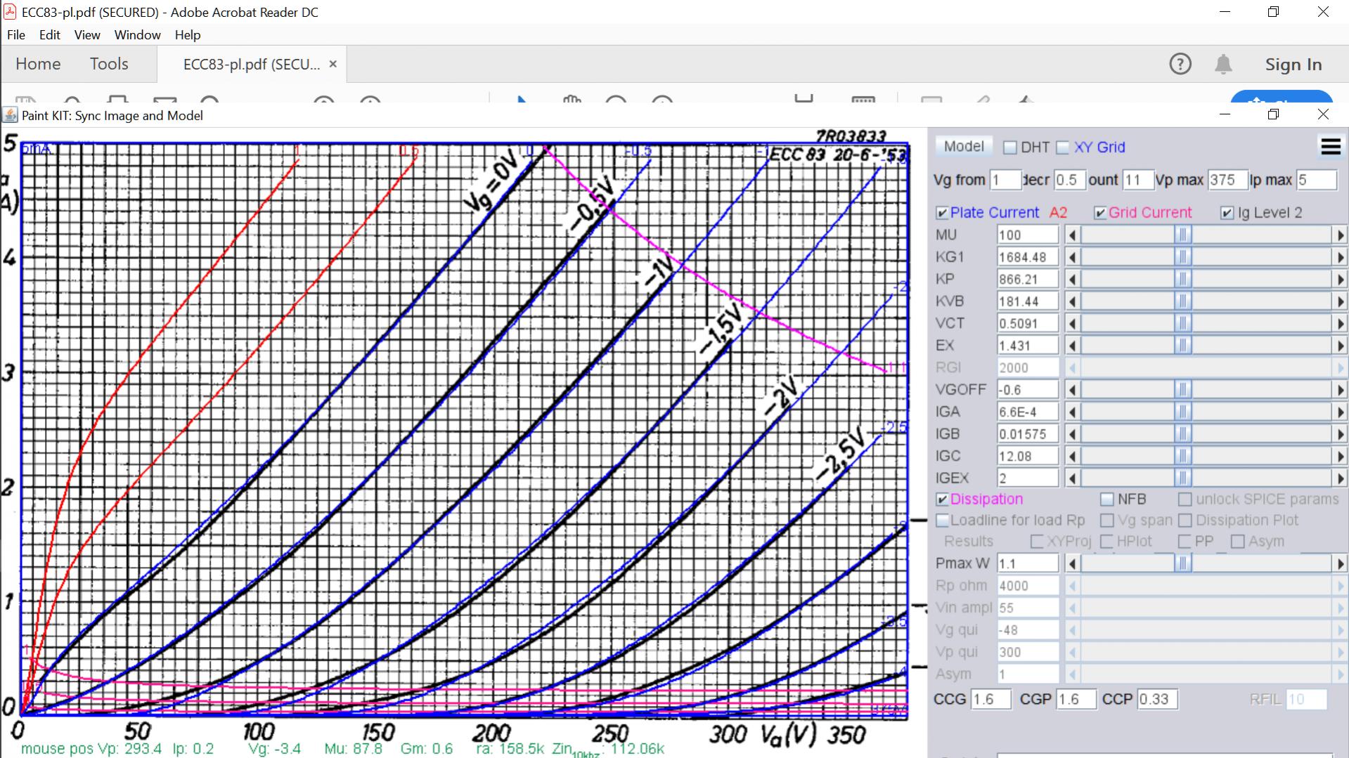

Here is the 12ax7 model based on Philips, grid current parameter is ported from Mazda's (with only minor adjustment) and it gives the same results. (Don't bother about grid parameters in Paint snapshot that was before the adjustment)

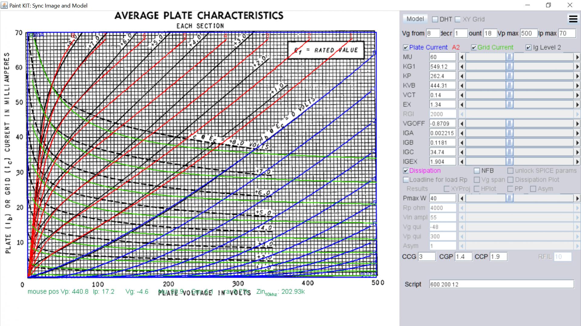

12AT7 proved to be a difficult challenge for Paint Tool as it's so non-linear with Mu range from 45 to 95, attached is snapshot with a single u=60 is a lot to be desired, anyone want the models?
Thanks! It would be nice to have some kind of description for all those parameters, but quite simple. For example, if you change X, it will move curves this or that way. This is too complicated for me 🙁
Also, did anyone tried to manually read values from datasheets and write them into text files, and then to feed that data to ExtractModel.exe from dos4ever.com? It is a software for making models from data read using their tube tester device called uTracer, but I suppose it can be used for manually entered data.
Read this article you may know what some of the Koren parameters do as well as how to manually digitize curve require for data extraction. There are many digitizer online but it may be not in format you required. You can also use Curvecaptor to digitize the curve and it will output a data file which you can further tailor to required format.
To fine tune kink, click on "kink" will pop up a small window you adjust it. Ex controls how much the entire curve is bent to left or right, while Kg1 control only the slope of curve. I have reduced the Ex and Kg1. Vg2 should be 175v, you can turn on the "Screen Current" and "Triode Mode" to make sure the current is not to high.
I can't get this pop up window for additional controls for kink???
The popup windows may be outside the display area, try to restore down and resize it, the small window open / close when kink icon checked / unchecked.
You're right! It shows when main window is not maximized. There is a bug - if the main windows gets maximized BEFORE you click on Kink, then this pop up window will not show. So one must click on it before maximizing the main window. :snowman2:
It's a hard one to fit, indeed! That's the best I could do, but the trouble is if I fit 0-5V fine, then 20-30 is too far from graph, and vice versa. So I tried to fit 20-30 range the most, because I presume that total error is smaller then.
